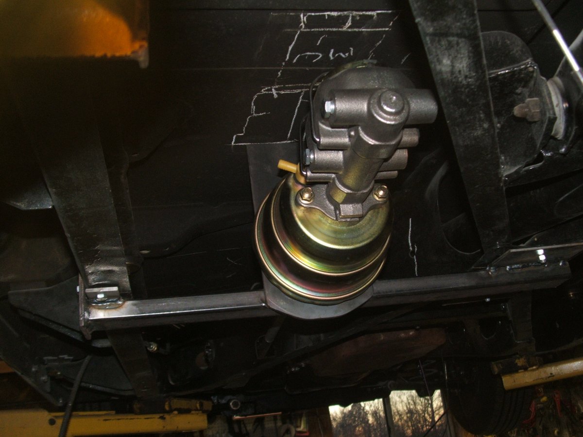

    DSCF2154.JPG A fellow HAMB member had a 50 Buick and contributed a stock brake pedal and mount that goes through the frame. Bolted right up to the 49, so they must be the same. Originally the MC was on the engine side of the mount but with the 455 installed there is no room left to put a booster and MC in front of the pedal mount. Since the pedal attached on one side of the frame on a splined shaft and the actuator rod on the other side on the same splined shaft I rotated the actuator arm 180 degrees so the MC/booster can be mounted behind the pivot. I cut a hole in the X member to allow the actuator rod to run back into the space between the X member and the frame rail.
    Then the problem became the MC placement left it under the front seat, making service/fluid checking and adding complicated. So, next step is to lengthen the actuator arm and mount the MC further back so it can be accessed through a removal plate between the front and back seat. I roughed out the placement on underside of the floor with chalk so I could get an approximation of how long I would have to make the new actuator arm. Comes out to about 31 inches. DSCF2159.JPG
    The original actuator arm was 5/8" with one end flattened with a hole through it to slip over the pin on the pivot arm. The other end had a threaded hole (3/8's by 24) that would screw onto the original MC rod. A friend had several old steering columns for some Studebakers and one of them was the approximate length I needed and it was solid like the original shorter arm and was 3/4 so it had a little more meat. We cut off the worm gear that went into the steering box so I now had a 34" long solid rod. Another friend set up his metal lathe and we drilled and tapped the former steering column rod. Once I have the booster/MC mounted I can get a precise measurement on how long the actuator rod has to be, cut it to fit and heat, flatten and drill the other end to slip over the pedal arm peg.
    I also had some 1/4" plate over in the s**** pile that I set up to make a mounting bracket for the booster/MC. The next picture shows the original actuator rod, the new rod from the reclaimed steering column and the plate I am going to use for the mount (I already drilled the holes for attaching the booster). DSCF2161.JPG

    It's been awhile, but I'm back on the Buick project. I think I have the MC/Booster mounting issue solved. I would have used an aftermarket bracket setup if I could have found one that would work, but as explained earlier I wanted to use the original brake pedal and I had to make some adaptations in order to have access in the floorboard to the MC without having to remove the front seat. I did think about a remote fill set up but given the proximity of the planned exhaust system and some other logistic issues it didn't seem feasible. So, here is what I did: As I mentioned previously, I made a longer actuator rod which allowed me to move the MC mounting point further back. I had to cut a hole in the X member to run the rod back to the MC.
    Once I had the approximate location for mounting the MC I made a bracket out of 1x2 box tubing that would bolt between the outer frame rail and the plate where the arms of the X member join. I cut the mounting plate that I had drilled out (earlier picture) down to a size that would fit under the floorboard, rounded the bottom edge, leaving enough to protect the booster, and tack welded it to the bracket. I threaded the actuator arm that I had made out of an old steering column, onto the booster, leaving enough threads to adjust it, and cut the actuator shaft to the desired length.
    The next view is from the back of the car looking forward toward the engine to give you a better perspective.
    While the mounting bracket might have been strong enough, once I finished welding the parts together, I didn't want to chance that the top of the mounting plate might eventually start to tip back and cause binding where the actuator rod threads into the booster. Plus, I was worried that the weight of the long actuator rod (31 inches) and its weight, given that the only two points of connection were at the front where it slips over the pedal peg and the back where it threads onto the booster might also cause eventual binding. So, I made another bracket further forward towards the engine. It's on the right side of the picture with the rounded plate in the center of the 1x1 box tubing that mounts to the top of the outer frame rail (two bolts) running on a level to the X member about 15 inches forward of the MC/booster bracket . I had some s**** 2" wide 1/4" plate (yellow piece) that I put a 90 bend on one end and mounted it to the top of the MC mounting plate(at the back) and drilled the 1/2 moon plate on the forward bracket to bold it there. The same friend that had taped the front of the actuator rod also made me a sleeve with a grease cert that the rod could slide through and I welded it to a tab that bolts to the yellow plate. This set up should keep the actuator rod in place and the top of the MC mounting plate from tipping back. So, there are three pieces that bolt together, allowing them to be dis***embled if necessary, that should keep everything in place and allow the MC to be accessed via a cover plate behind the front seat.

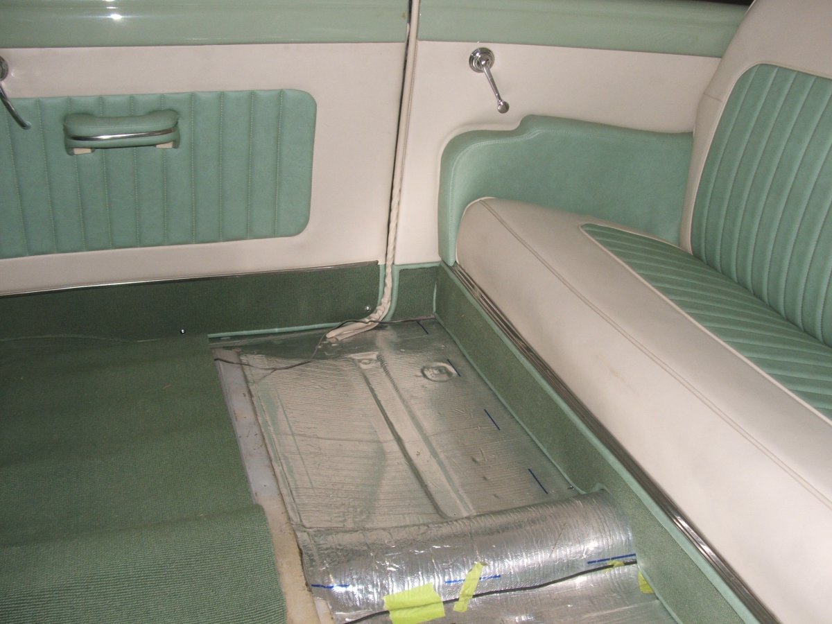

    Tried to find it but, what did you use on the floor under the carpeting for insulation/sound deading?

    59 Nomad-----I think I covered it earlier in this thread but maybe not. I have a friend who was duct/pipe wrapper who used the material in big commercial jobs. He had used it for years in his builds. His son now owns a business doing the same thing and I was able to get rolls of it from him. I think they are 36" wide. Like Dynamatt, which I used on the roof, this product has a self sticking underside. I have also used Peel and Seal from Lowe's but it only comes in 6" wide rolls.

    Bruce A Lyke
    Thanks, do you know what the the stuff you used s called?
