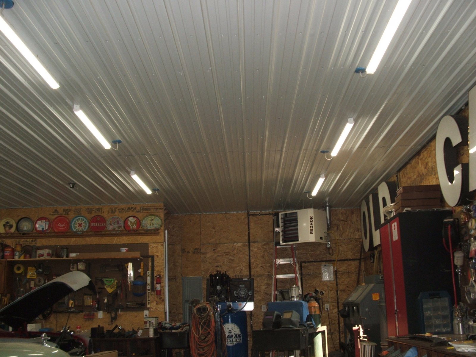

    It's been a long time between posts but I finally got the new shop operational.
    There is an HOA so I had to build a shop in keeping with the house. Meant I had to put up a brick building. I found the original builder of the house and, while he wasn't interested in building the shop, he had a couple of retired guys that worked on the house he convinced to come back to work for this project. They put up the exterior and I spent the last year doing the interior.
    2Blue2, pwschuh, 40FORDPU and 7 others like this.

    I think you should get the fanciest shop award. That building looks amazing, and should be a pleasure to work in. How are you heating it?

    BJR: I hung a 100,000 BTU heater in the far corner. You can see it in the third picture. So far it seems to do the job. I insulated the heck out of the walls and ceiling before I put up the OSB board and steel panels. There is a loft room over the first 2/3rds of the building(See steps in picture 2) that acts as storage and more work room. It's also insulated and has a steel ceiling.

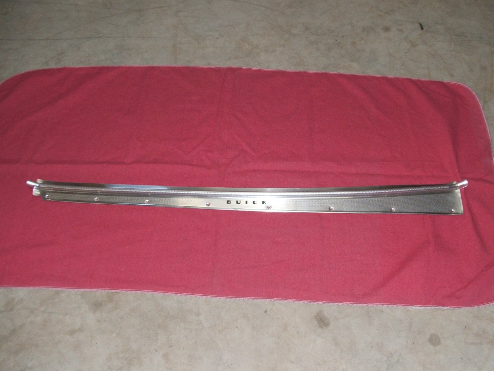

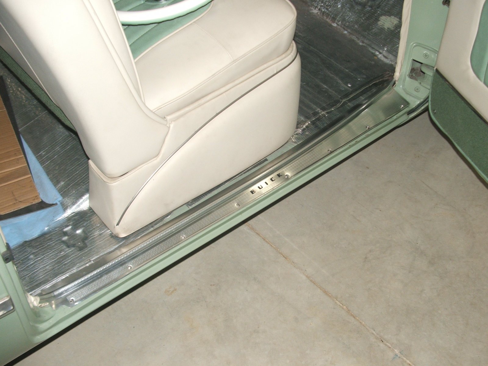

    Ran across another HAMB member, Tetanus, who had five 49 Buick rims in great shape, that he had no use for and give them to me. I drove to Wis. last weekend and picked them up. Great contribution to the project by Tetanus. While I had four originals, I did need one for a spare and all of his were in better shape than a couple of mine. Thanks to Tetanus.

    I did locate an upholsterer but can't get in until mid-July. Gives me time to catch up on the little items. I am still having trouble getting the engine to idle down. Also need to find out why it is heating up so quickly. May be a bad thermostat.
    Thanks to RockAble for recommending a guy that was reproducing rocker panel covers.

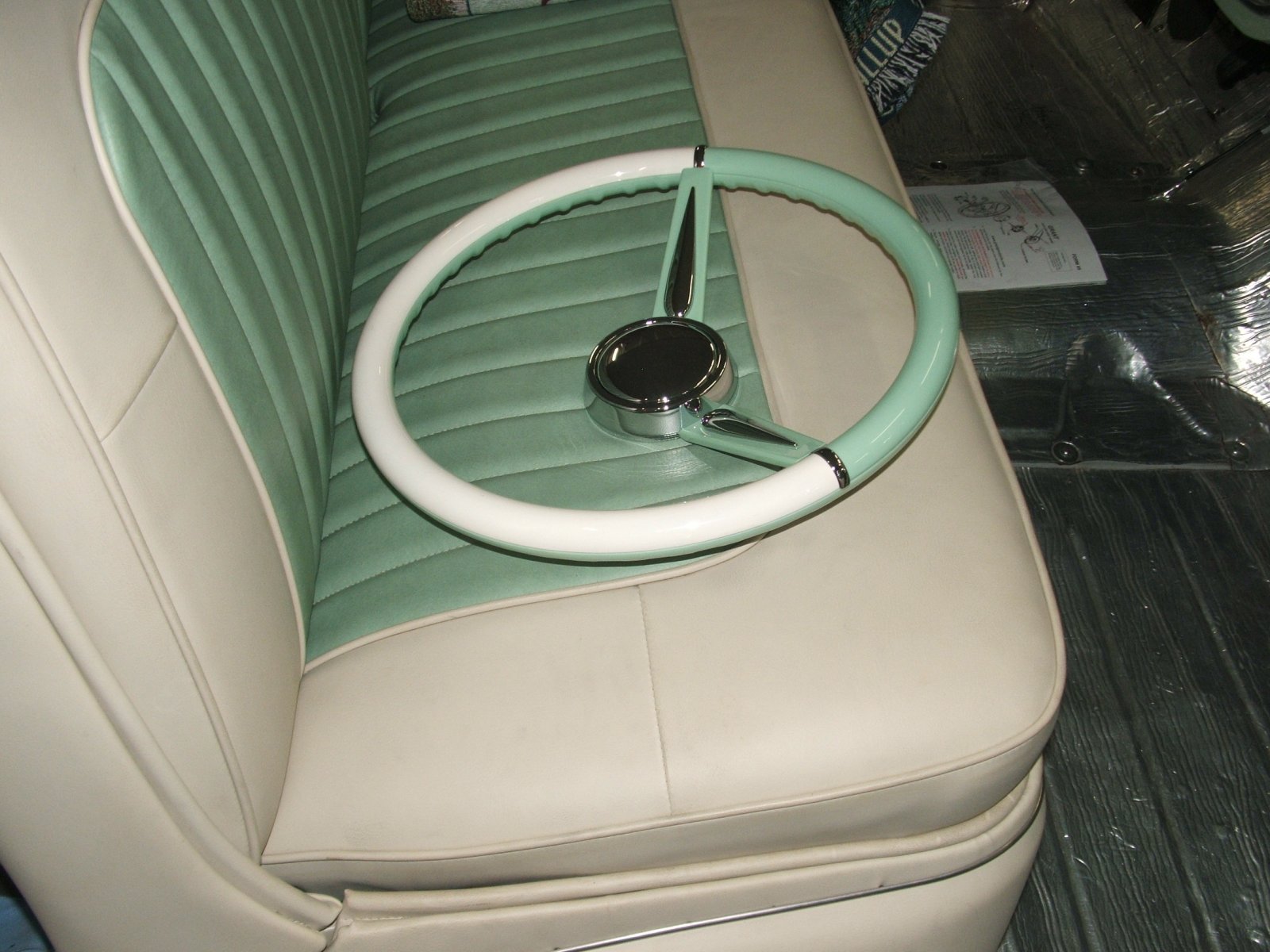

    Also picked up a new steering wheel from CON2R.

    That Con2R steering wheel looks great!

    Looking great!!!! what steering column did you use?

    BJR, The steering column was one I pulled out of a late 70's to mid-80's Chevy box van 8-10 years ago while visiting a friend in Michigan. I think it's the same one you would find in a van during that period. No Key on the column. Later one's have the key integral to the column. There were, and I think still are, a couple of good wrecking yards in Muskegon. Over the years I have picked a lot of parts there for various projects. One even had a couple of 49 Buick four doors.
