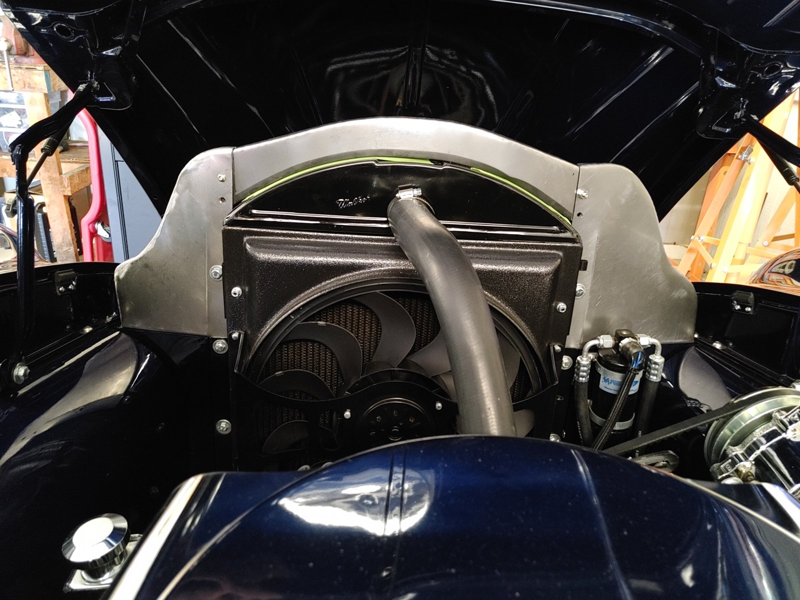

    Good luck, Walt. The root problem with cooling these cars is getting the hot air out. The hood is a big dome that collects heat and since hot air rises, it wants to stay there. I installed a couple of small pushers at the rear of the inner fenders and have them set to come on at 220. I built a shroud for my mechanical fan and now it cools just fine on the road. The temp will rise when sitting still, however and then the pushers come on and help out. I have my condensor mounted right in front of the radiator.

    Something else to look at is fitting a piece of sheet metal above the radiator shaped like the inside of the hood. I believe that if that is not blocked off, the hot air gets pulled back above the radiator to the front and sucked back through. I don't have a fan shroud on my 49 with the 472 Cad. I cools fine, but with the air on, if I am not moving, it gets too hot for the air conditioner to cool the inside. If I am moving it cools the inside fine. The engine never overheats, even sitting. I will be adding a fan shroud, and block off the air coming back over the top of my radiator also. Good luck, these are very cool cars when done.

    Walt, I may have those two pieces that go on either side of the radiator to help seal the outside air from the inside air. Let me know if you need them and I will try to round them up. Since I converted to front tilt on my hood, I had to make my own.

    I have the two side pieces next to the radiator already installed. Don't have the one directly over the radiator and may look into making that one. Installing some smaller pushers on the inner fender panels back by the firewall is a great idea. I am going to try a pusher in front of the radiator first and then, if that doesn't help I will go the small pushers on the inner fender wells.
