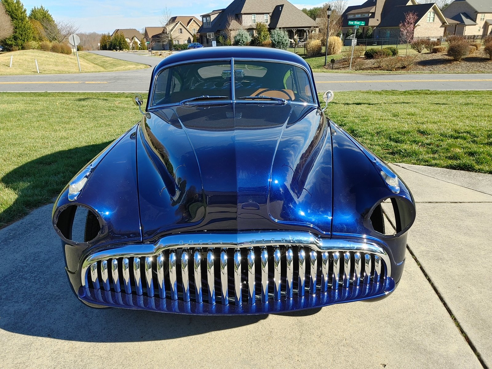

    0225221528a_HDR.jpg 0225221528_HDR.jpg Now we're getting somewhere!

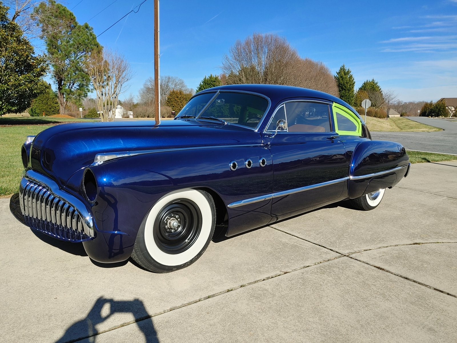

    7495.jpeg I posted this as a separate thread, hoping to gather more input. It doesn't appear my Sombreros are going to work out. Its a shame, I like them but they are throwing the tires out of balance at cruising speeds.
    Here's a shot after installing the front bumper.

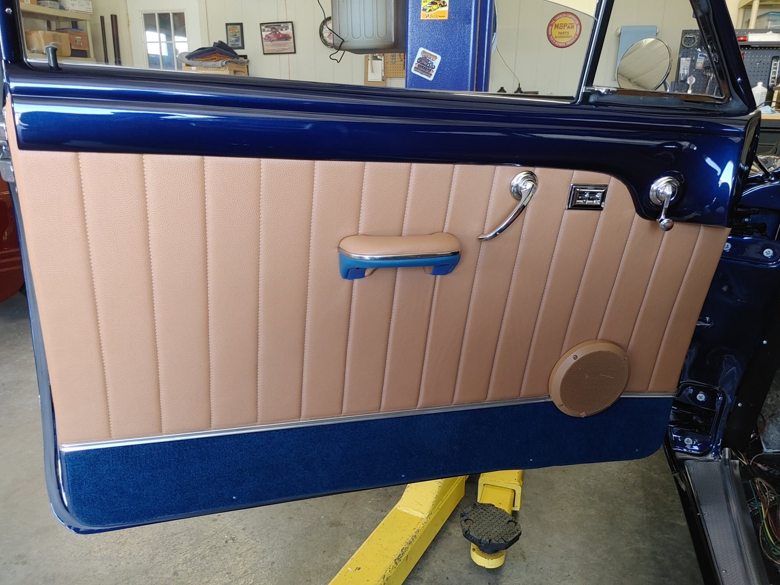

    Little by little, bit by bit. Its coming together. Upholsterer said mid April before we arendone with the interior. I did get the balance situation resolved...i think. So, I'm putting some miles on it and m***aging out small bugs.

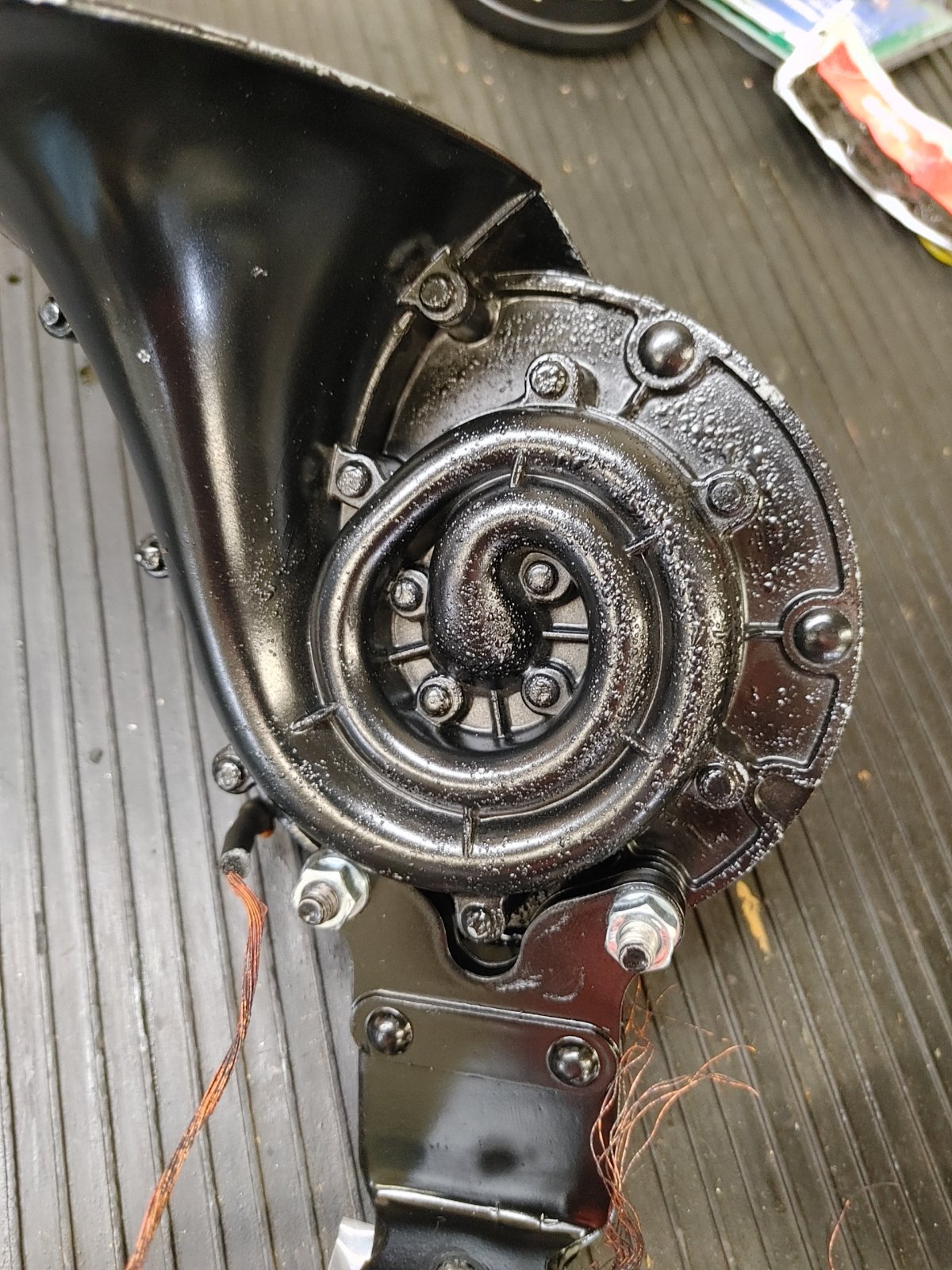

    Well, the horn circuit shorted and caused the fire. The wiring panel had the horn relay on the panel but it was not fused....and I did not catch that. So, I guess my horn ****on triggered the horns but I did not hear them. Maybe when I was getting out of the car, I depressed the horn ring. I don't know but the DS horn got really hot, so I'm guessing it shorted. So much for using the original horns that I cleaned and adjusted.
    It won't take me too long to replace the panel since all of the wires are terminated at the panel with screws. I did not have a master cutoff but I have seen the error of my ways and will remedy that, too. Dang, that was scary!

    0306220901_HDR.jpg 0306220822.jpg After checking the horn ****on today, I am certain it did not stick. What likely happened is I hit it when getting out of the car and the relay contacts welded themselves together. There was no fuse. Also, I was using the OE 6v horns which would draw high current. When I asked American Autowire why there was no fuse, they said that's the way GM did it for decades. Lesson learned.
