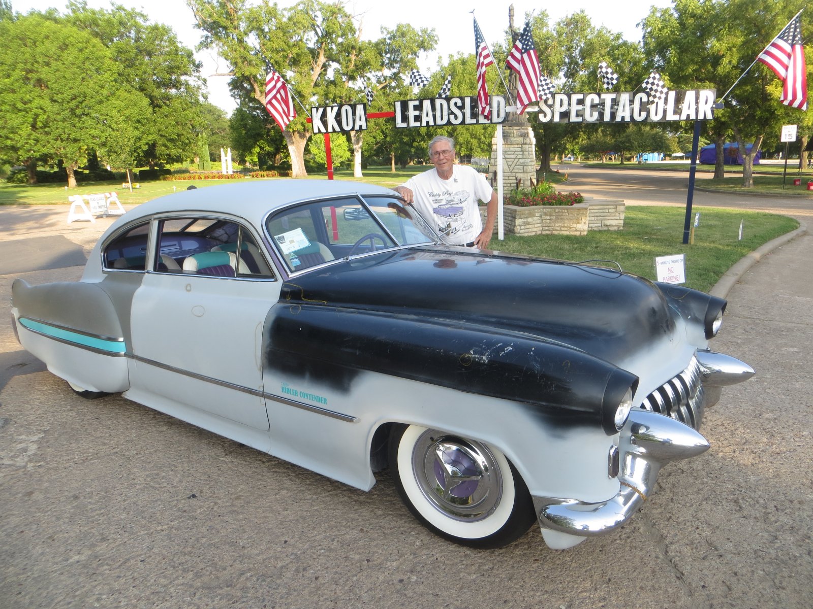

    I think the problem with Cokers is that they are mnufactured out of this country, there is no 'quality control' on them when they are made. I had a set of Cokers on my '55 Caddy that a friend gave me--they lasted three weeks simply because they leaked under the whitewall. I've run DB's for well over 15 years now (I'm on my second set on the '55) - I put the old ones on my '48 Caddy now and STILL NEVER have problems with them...!!! Took the Cad to Salina last year with them on it...!!!

    Not to get us off track, but I was checking out your 48 at Salina and didn’t even realize it was yours! Very cool car! :cool: I hadn’t been to Salina in 10 years and have pics of your 55 somewhere from that one.

    Good to know, Roger. Thanks. Have you posted a build thread or any updates on the '48?
