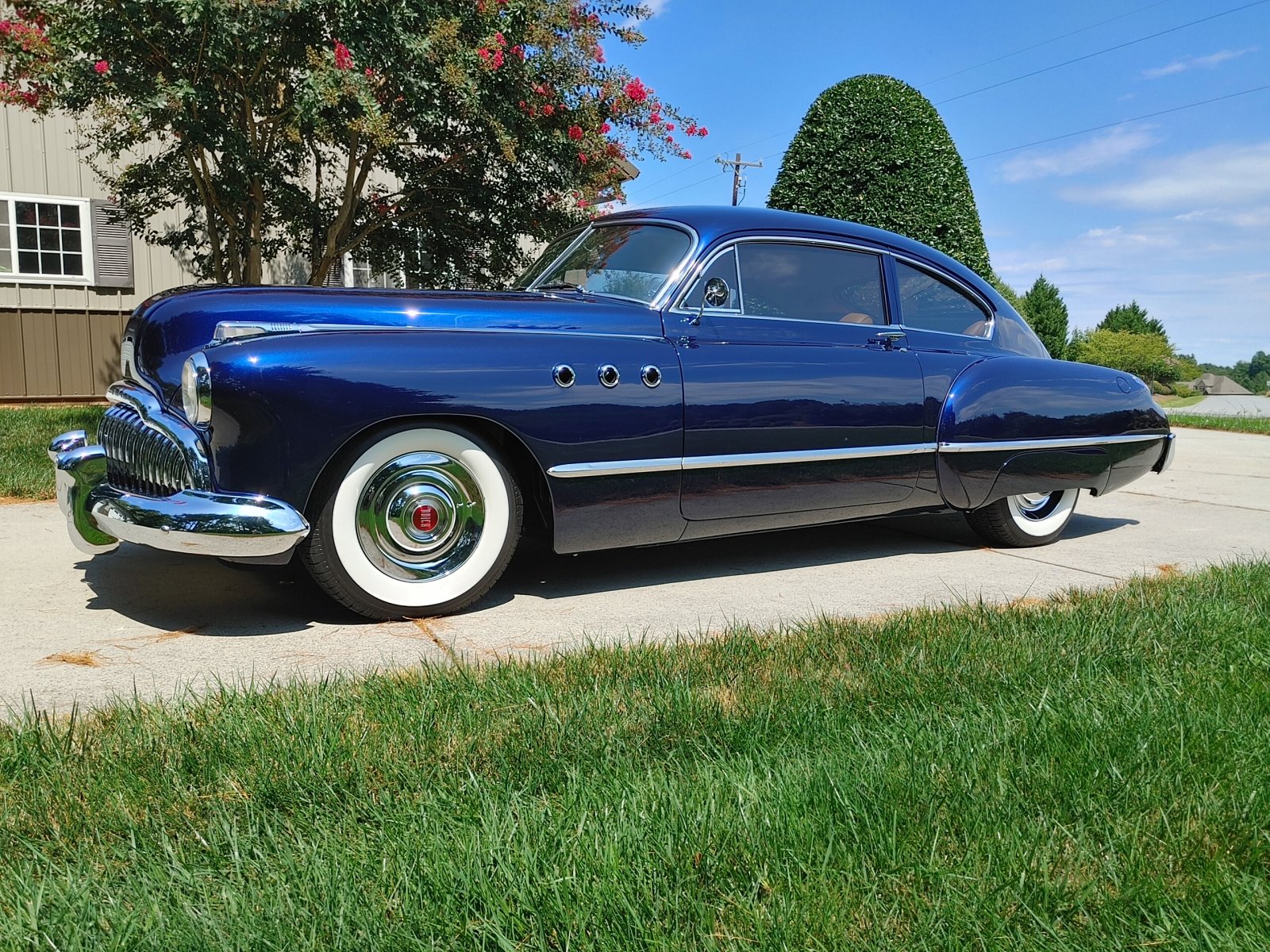

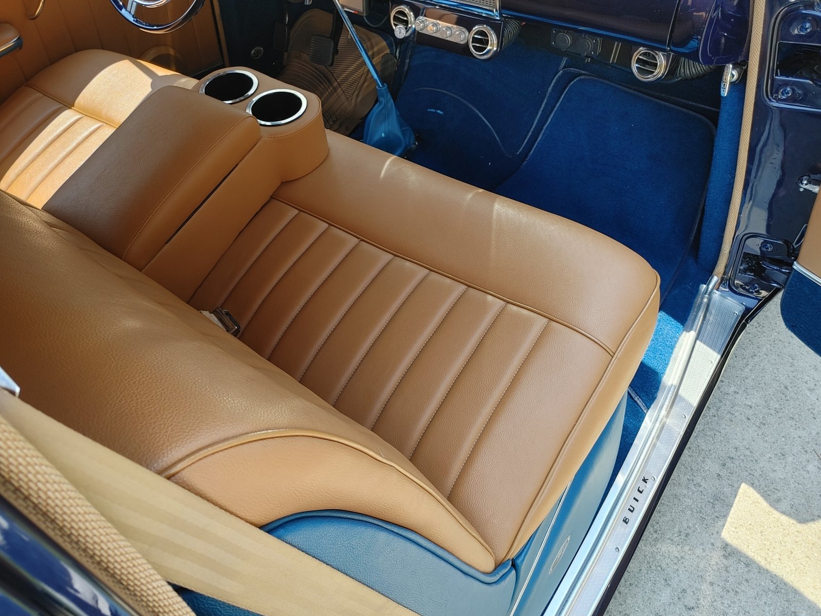

    I also decided it's about as finished as it's going to get, so it was picture time. The light was less than ideal but you can get a pretty good idea of how the car looks. I've taken it to a couple of local cruise-ins and it has drawn quite a bit of attention. I'm pretty happy with how it turned out. Now, I'm ready to road trip this ****er!

    Lepus, Chris Nantus, SS327 and 40 others like this.

    You should be very proud of it. That is one awesome build.jmho. Snowman ⛄️

    Roc that is absolutely gorgeous. You knocked it out of the park. I hope all your h***les fade away and you enjoy cruising in it. Brian

    Great looking Buick! I took the one in my avatar from Kansas to the west coast when I got it to what I called done. Somewhat eventful trip but overall a good trip. Have fun driving that beauty.
