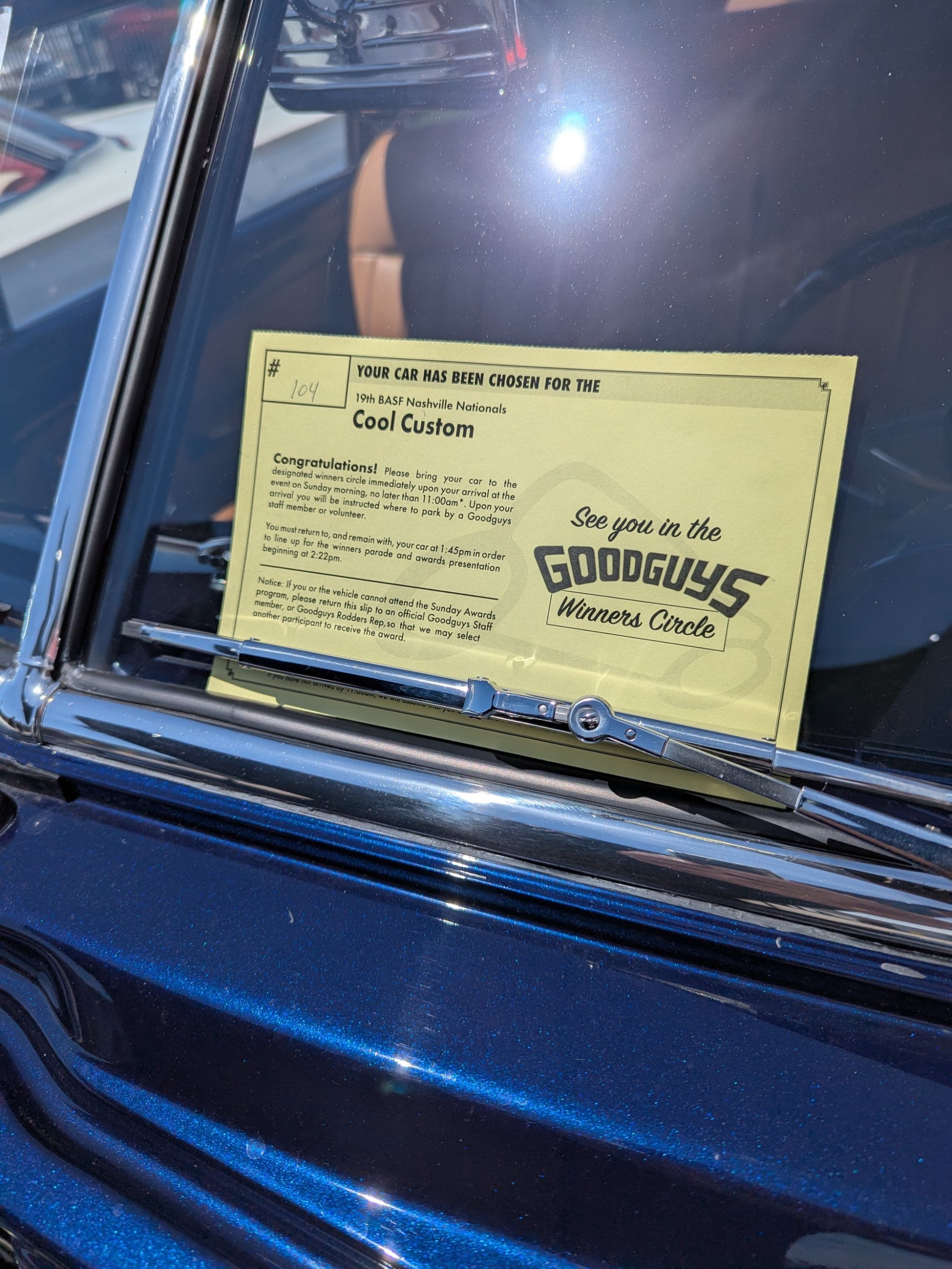

    PXL_20250517_165614170.jpg Got lucky again!

    That's really great, congrats! You certainly earned it.
  24. Fat47
    Joined: Nov 10, 2007
    Posts: 1,593
    Fat47
    Congrats, you deserve it.
    rockable and BJR like this.
  25. Thor1
    Joined: Jun 6, 2005
    Posts: 1,695
    Thor1
    rockable,
    Luck had nothing to do with it! You have a beautiful car!
