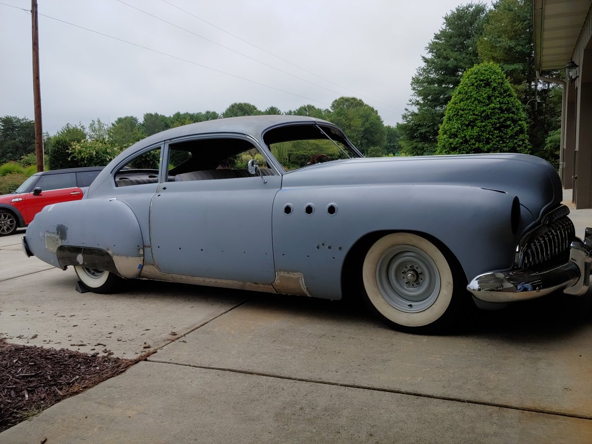

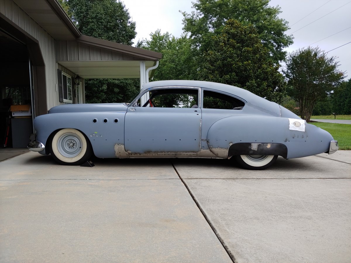

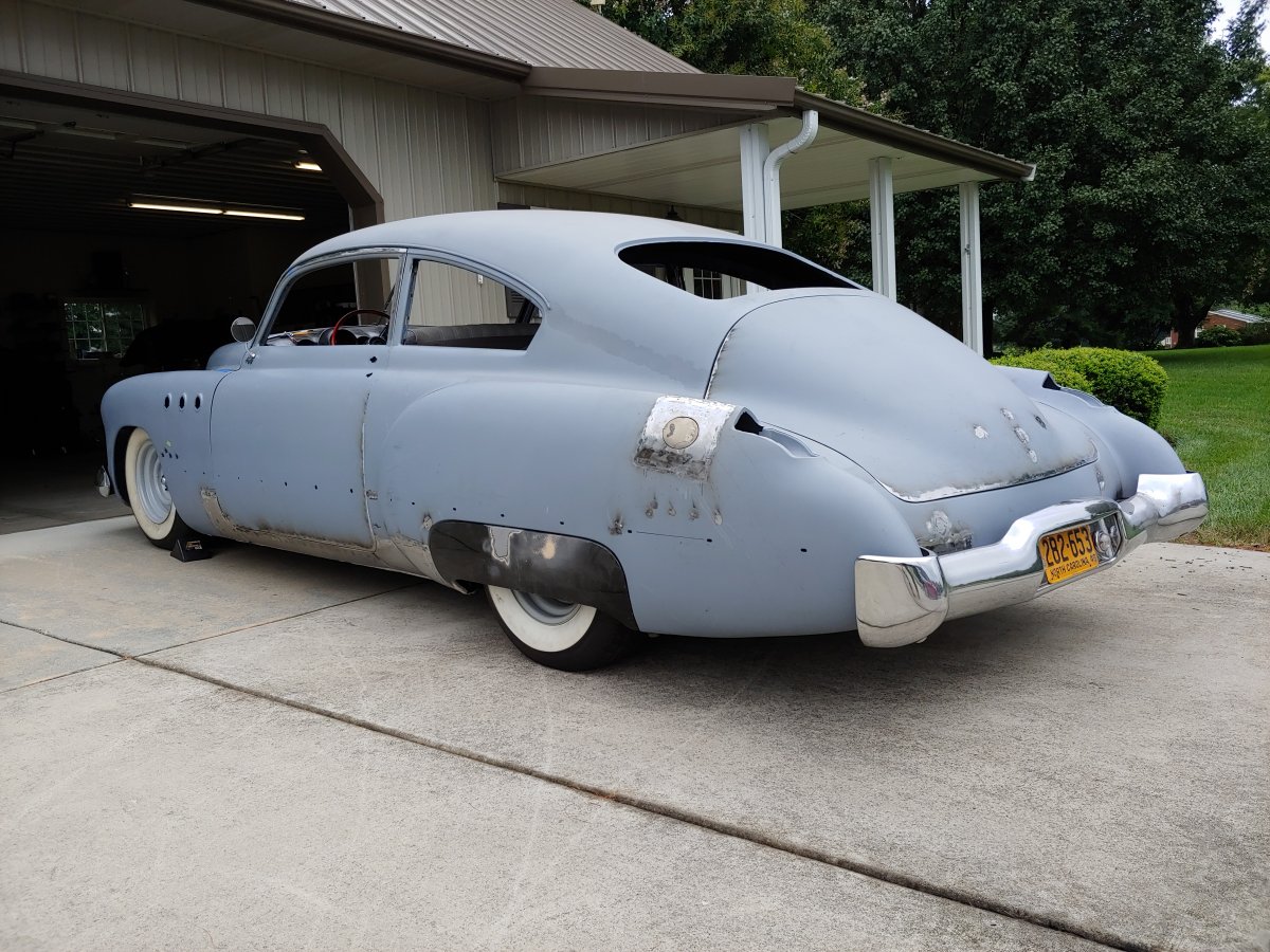

    Took it down off the stands and,moved it,outside to see how it sits. I'm liking it!

    lippy
    from Ks
    Man that looks great!! Lippy
  3. Corvette Fever
    Joined: Feb 18, 2014
    Posts: 142
    Corvette Fever
    from Michigan
    That is one great looking Buick you’re doing. Very nice work and attention to detail, good job. They really do make excellent customs. [​IMG]I had a 47 convertible years ago. I do have an original power window switch if you should need I t.
  4. BJR
    Joined: Mar 11, 2005
    Posts: 11,367
    BJR
    That looks great, nice stance!

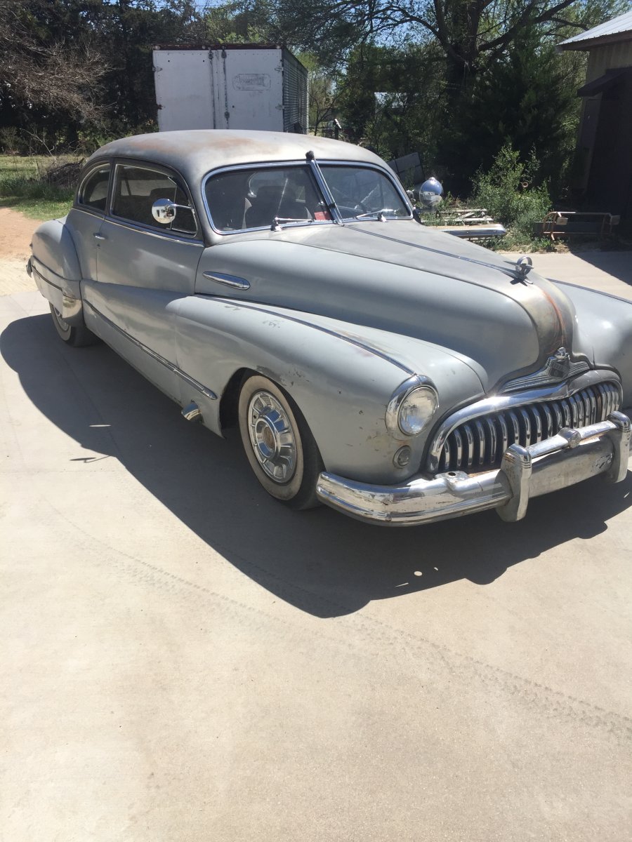

    Mine kinda fits but it's original and the latches are tweaked. In fact I think two of them on opposite sides aren't even't working. I don't take it over a hundred. IMG_4890.JPG

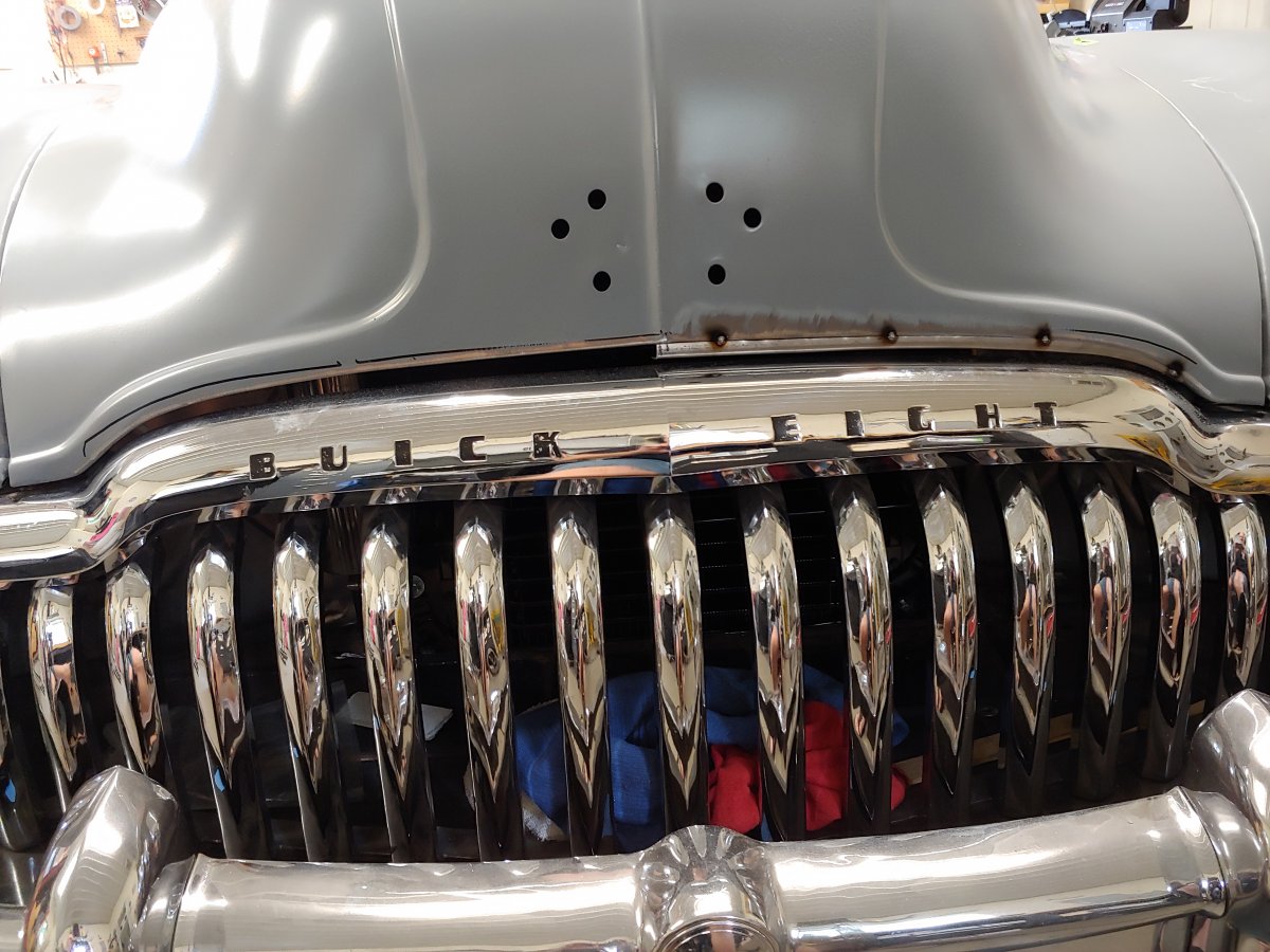

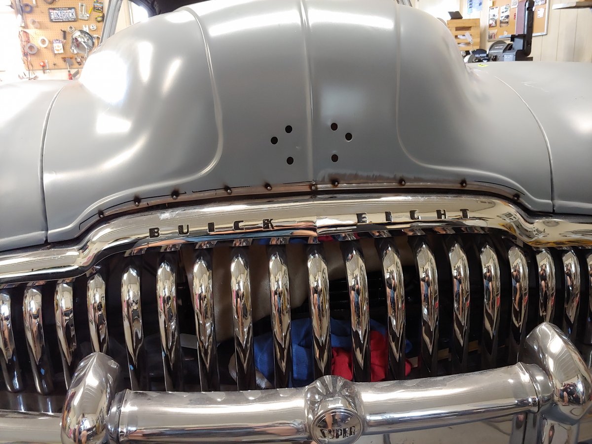

    0807201110.jpg 0807201119.jpg Dang! Trying to get the hood gaps close and NOT RUBBING is proving difficult....but I'm not done yet. I did take a diversionary trip and closed the hood gap above the grill. I could get my fingers,in there before. Now, I have a nice 3/16" gap.

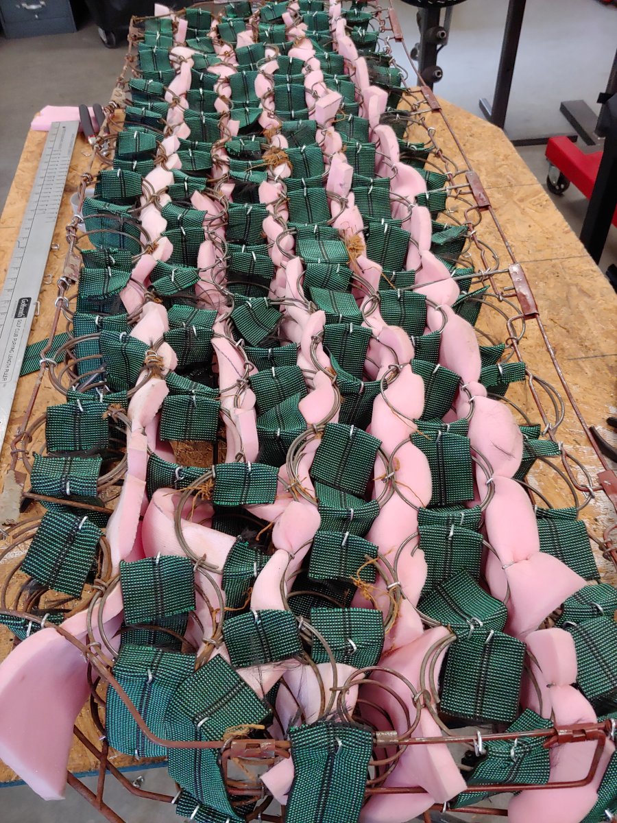

    This damned rear seat was something I just had to digest a little at a time. If I got cut or stuck by a hog ring once.....you know the rest. I placed sew foam in between the coils laterally and then ties them down with some webbing I had. LOTS of hog rings and lots of cursing. I'm never going to complain about what upholstery costs again.
