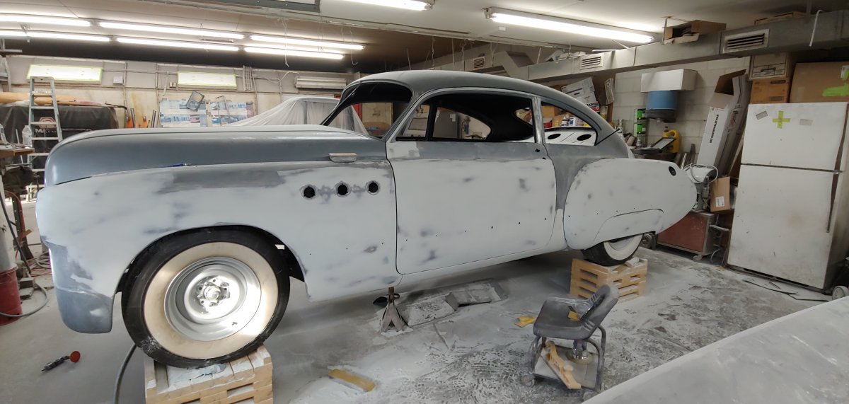

    The car is in the paint shop and I am working with my buddy, Steve, doing grunt work and learning what goes into a quality paint job. So far, we have filled the worst low spots and paid a lot more attention to panel gaps and fit. We are starting to sand filler and will probably spend most of this week just skimming and sanding.
    So far, I have learned at least four things.
    1. Weld ALL pinholes and finish all grinds. ALL of them.
    2. Get the metal smooth as possible. Shrink any knots and raise any small low spots.
    3. You can move door edges, fender corners, etc if you try. Get all the edges lined up with the rest of the body so that you don't end up with any "fat" edges.
    4. Sanding filler is a skill that can be learned and I am learning. I'm also learning that it is an extremely messy process! Jesus, that dust piles up and gets everywhere!

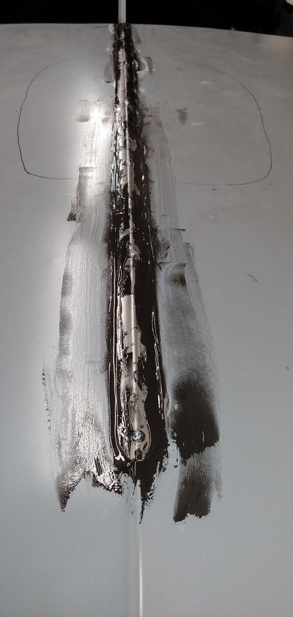

    1202201132.jpg 1119201456.jpg 1119201523.jpg The peak was formed by breaking a 3 " wide piece of 18 ga. sheet metal and then partially flattening it in my press. I trimmed it to fit in the trough and shaped it so that it laid flat in the trough. The adhesive is not very viscous, so don't count on any resistance from it to help straighten the peak.

    You might have a ghosting seam problem from bonding the peak in.

    Hope not. We're letting it dry a long time and then skim coating it. Its possible, I guess. Ugh!

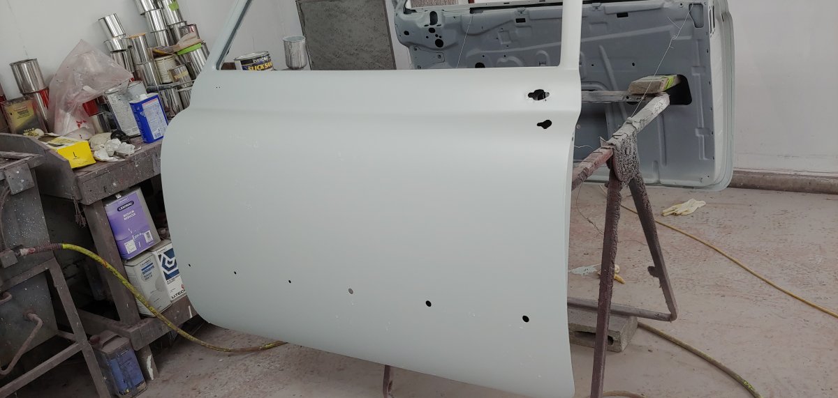

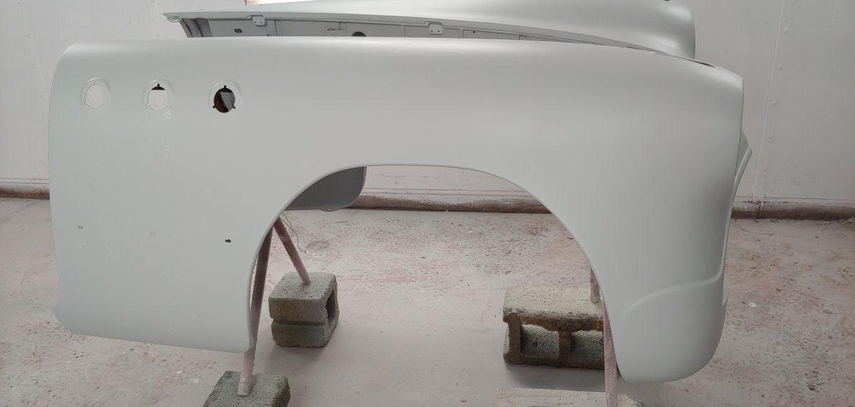

    1210201505a.jpg 1210201504.jpg 1210201504a.jpg 1210201505.jpg As I said before, I am helping my buddy Steve, who is painting Big Bertha. I am doing grunt work mostly. If you have never worked with someone who knows how to get a car smoothed out, you need to try to do that. You also should sand down some body filler so that you not only appreciate the experience and talent required to get a smooth finish but also the hard physical work and time required. Then you would have a greater appreciation for why a nice paint job costs so much.
    This car is all curves. No nearly flat surfaces anywhere except the doors. We have got the rear end, the fenders and the doors worked out. Next up is the hood and the roof. The paint WILL be slick, I guarantee it.

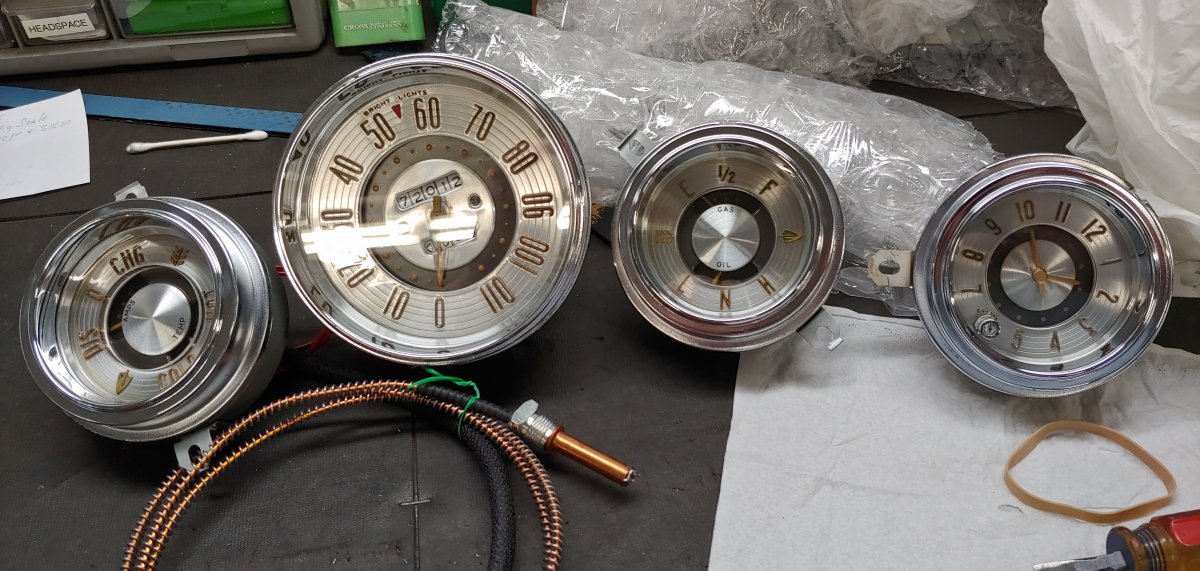

    Got my instruments back and ***embled the bezels onto them. They look great but the guy forgot to zero the odometer. How do I do that?
  13. brokedownbiker
    Joined: Jun 7, 2016
    Posts: 700
    brokedownbiker
    Pretty sure you're going to have to open the speedo housing back up. If it was mine it would be going back to the guy, too much chance of messing up the little fiddly bits inside.

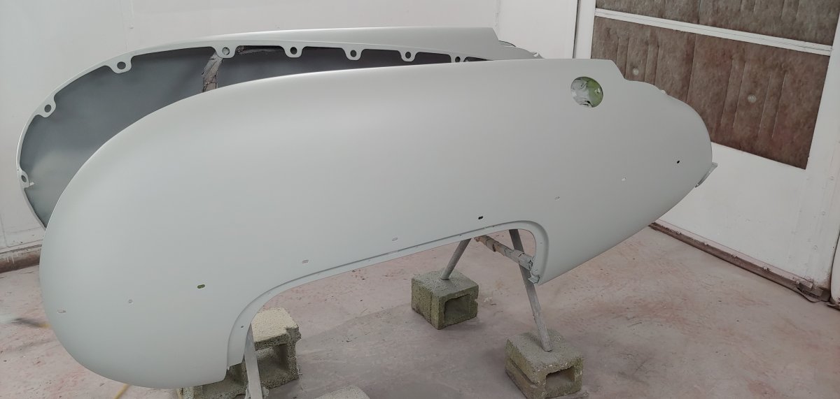

    It will probably be March or so before we put final paint on it. (Wait for warm weather.) We did get all of the many piece parts primers today. So, all parts are primers and the exterior is in Slick Sand, high build primer.

    Car and all parts are in final urethane primer and just sitting and waiting for warm weather. Steve's paint booth ****s all the warm air out of his shop in a hurry, so that is the reason for waiting until it gets warm.
