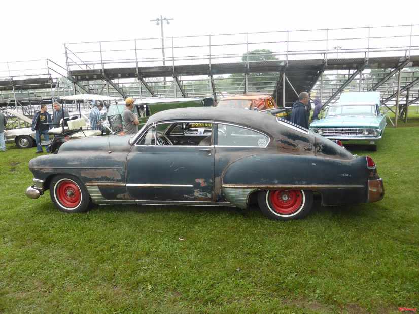

    I would section in a hinge pillar from a parts car rather then try to straighten that one. Also grab the door hinges from the parts car as yours are most likely bent.

    That took some hard hit. If you can find an old crash guide or body manual for it you'll have all the information to do measurements to see how bad it really is.

    Definitely caddy-o I have found someone who would let me cut out the part I need for $200 even though I know a good body man I would rather just go the simple route and replace the hinges and pillar

    You're going to need a body man to hook up to the damaged A-pillar and pull it back to where it needs to be before cutting it out and replacing it with one from a donor car.
    Doing the job right just may involve the services of a body man, simply cutting it out and replacing it without pulling the structure out first isn't going to produce the desired results.

    Oh totally, I agree draggingto I work at a row yard and luckily we have a large table for pulling frames and body panels straight.

    The point of pulling first before cutting out the bad pillar is to straighten out the adjoining structure so the new piece you're adding will go in correctly.
    If you don't pull it back into shape before cutting out the old pillar the new one will not fit right.
    Ask any experienced body or frame man, they always do it that way.

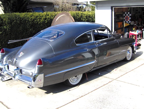

    Why don't you post a couple of pics of yours so we can have an idea of what his might look like in a few months?

    It's not purty, but I like it ....

    Pull it first like everyone is advising. Pull all the structure until your new door and hinges fit then replace what you need to. Because once you cut it out there is nothing left to pull with. This is 60+ years of heavy collision repair experience.
