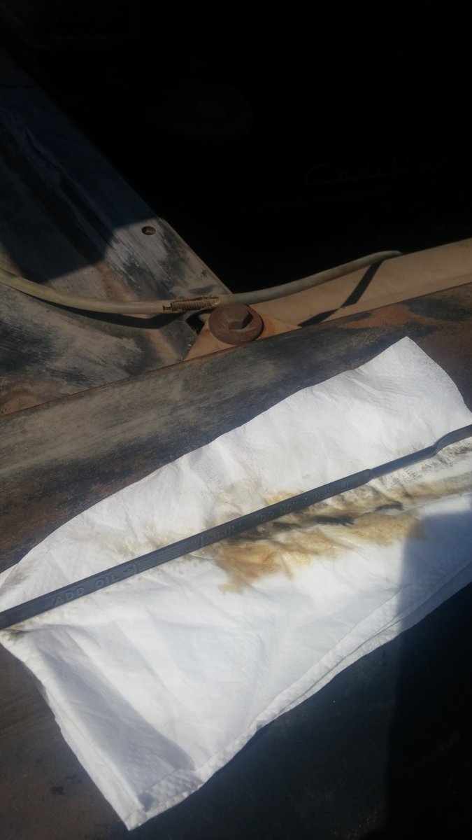

    Just an update. Today I bought everything to start the Magical Mystery Oil and 2 turn it over by hand. When I checked the oil it was actually still good but had some black dirty particles in it comma overall I am happy to see that it's not slushy or solidified. Even though this is a good sign I am still going to be cautious and take everyone's advice this doesn't mean that the engine is not stuck or there might be another problem but I'm very happy to see the oil in a good state. It kind of defies explanation that the oil would last 53 years so I'm going to call the previous owner and ask him if he added any oil

    Oil usually looks good in an engine that has sat a long time. The dirt and water settles out and the oil looks like new.

    Haha ok Thanks Rusty. Damn thought I got lucky but what you said makes a lot of sense

    Take the pan off, all the goop will be in the bottom with the clean oil on the top of it.

    I drained the oil out of a long-sitting engine years ago... the water comes out first.
