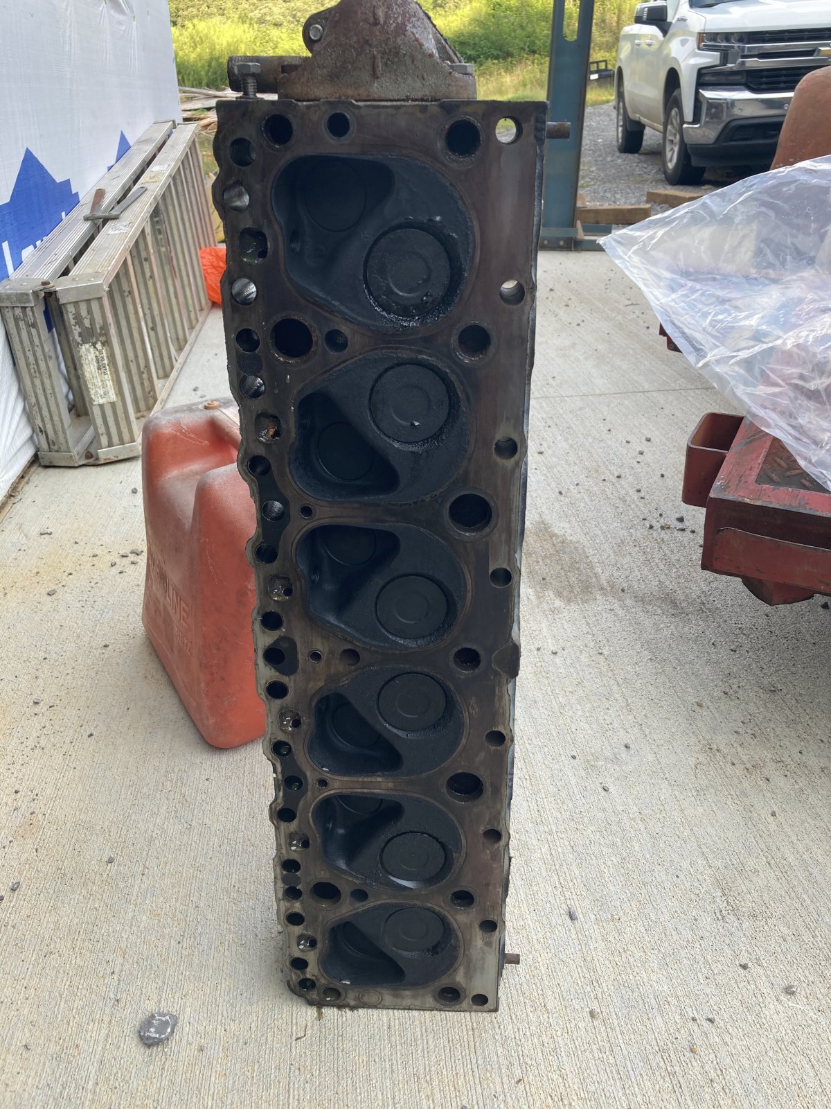

    Valves wouldn’t free up enough for comfort so off with its head. Cylinders look great. Having the machine shop tank the head and give the valves a once over. She’s bored .060 over and looks fresh just sitting a while. Letting the cylinders soak and spin over every day.

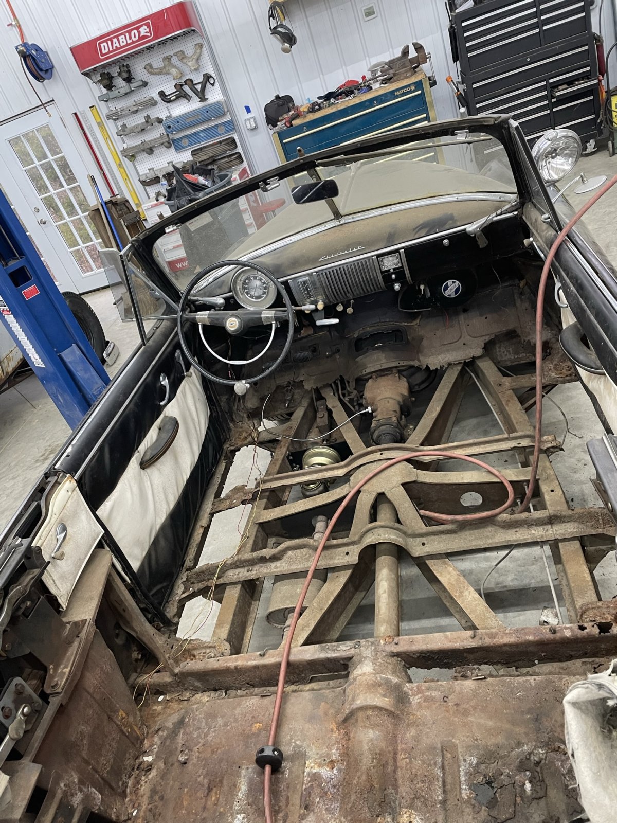

    Post 6 shows a HT. Is that yours also? If so you could've done a BobK and made that your convert

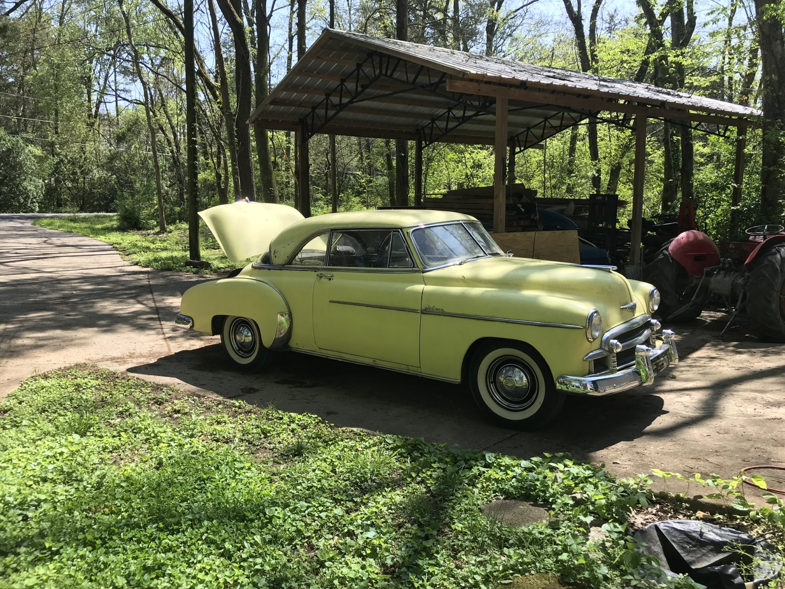

    I bought that purple hardtop to use as a donor and couldn’t do it and sold it. Then I bought this yellow hardtop to do the same thing and fell in love with it!! I just can’t cut one up like everyone else on here, I wuss out. I’ll keep the hardtop now and the convertible will sit next to her. It’s a disease.

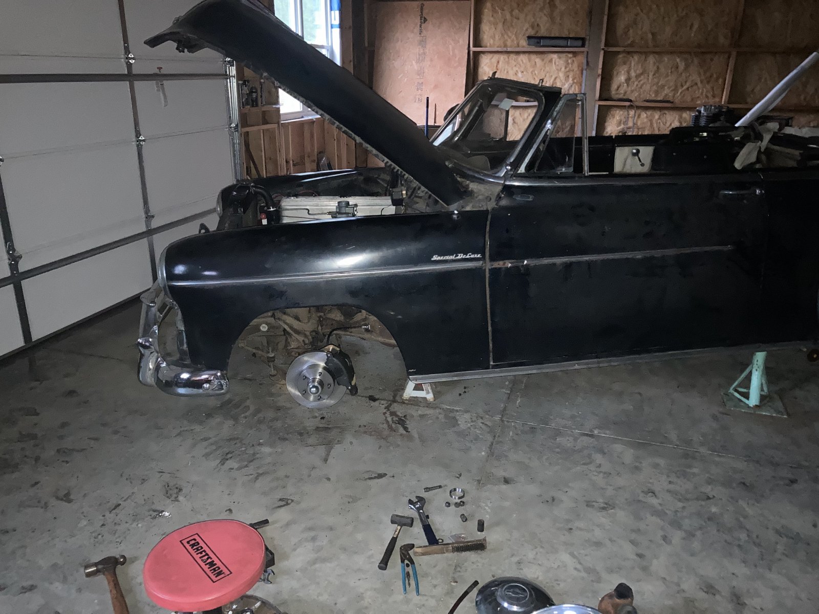

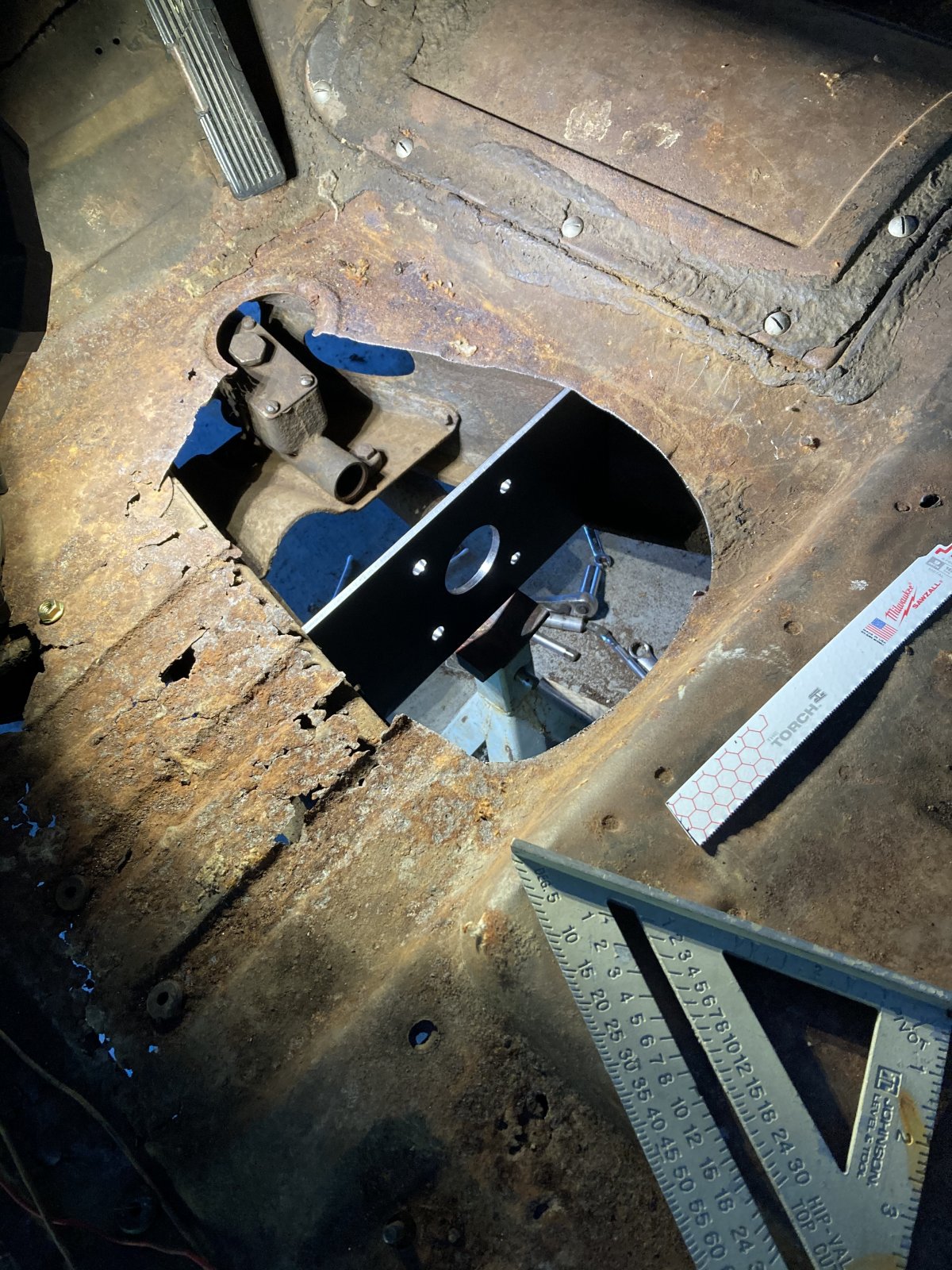

    Disk brakes are on. Power master under the floor fabrication can hopefully start this weekend.

    Nice score and I like what you are doing with your "new" car. But before you buy any more parts do yourself a huge favour and get some better/safer jack stands! The ones in th epic can collapse...

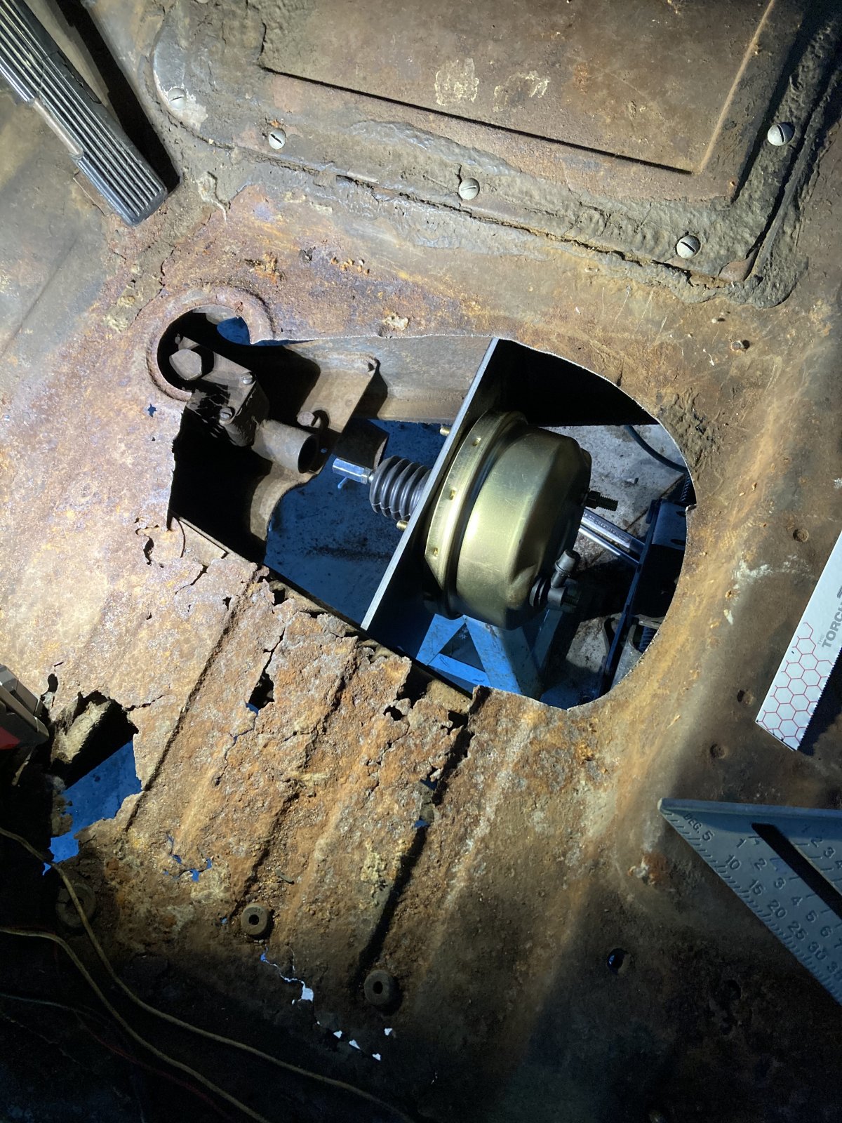

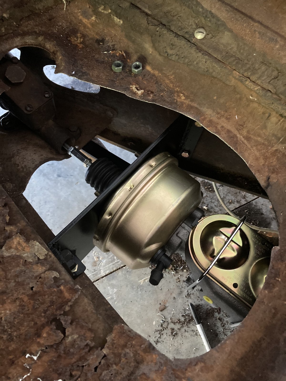

    Working on a bracket to mount the booster and master behind the original one. That master area sure is tight on the convertible frames.

    Master/ booster mount done. Now to replace the entire floor.

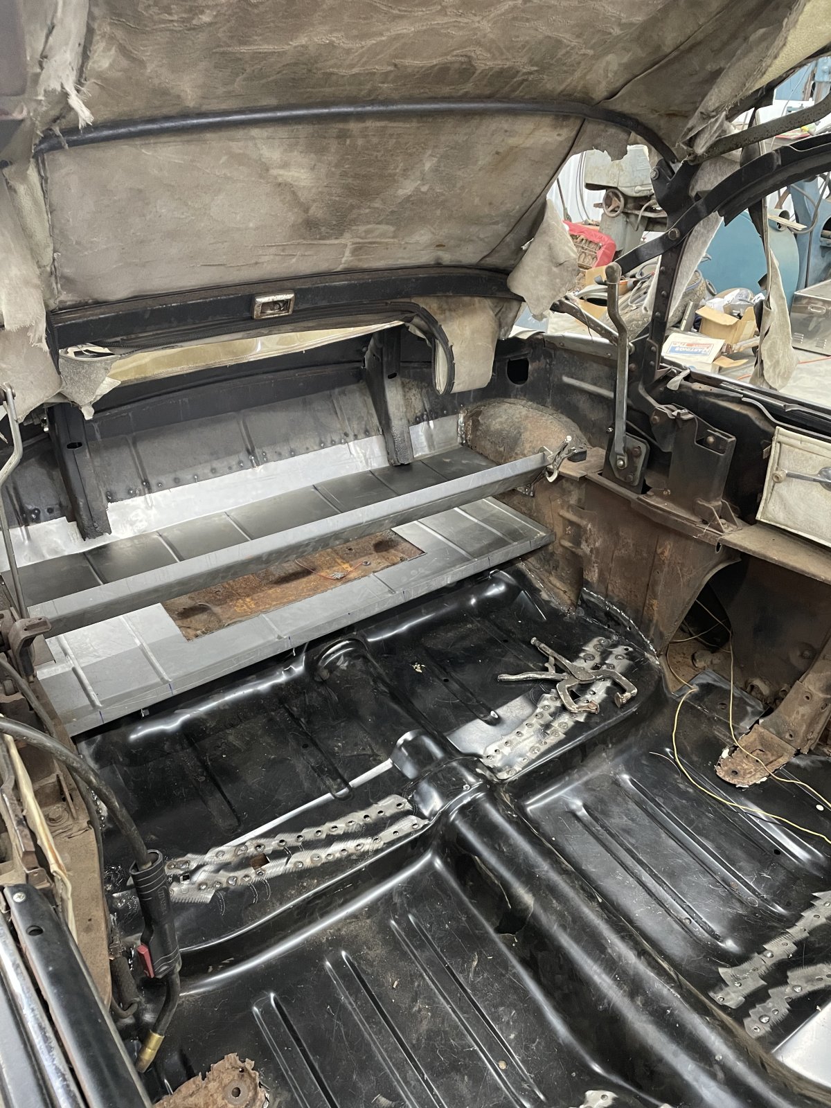

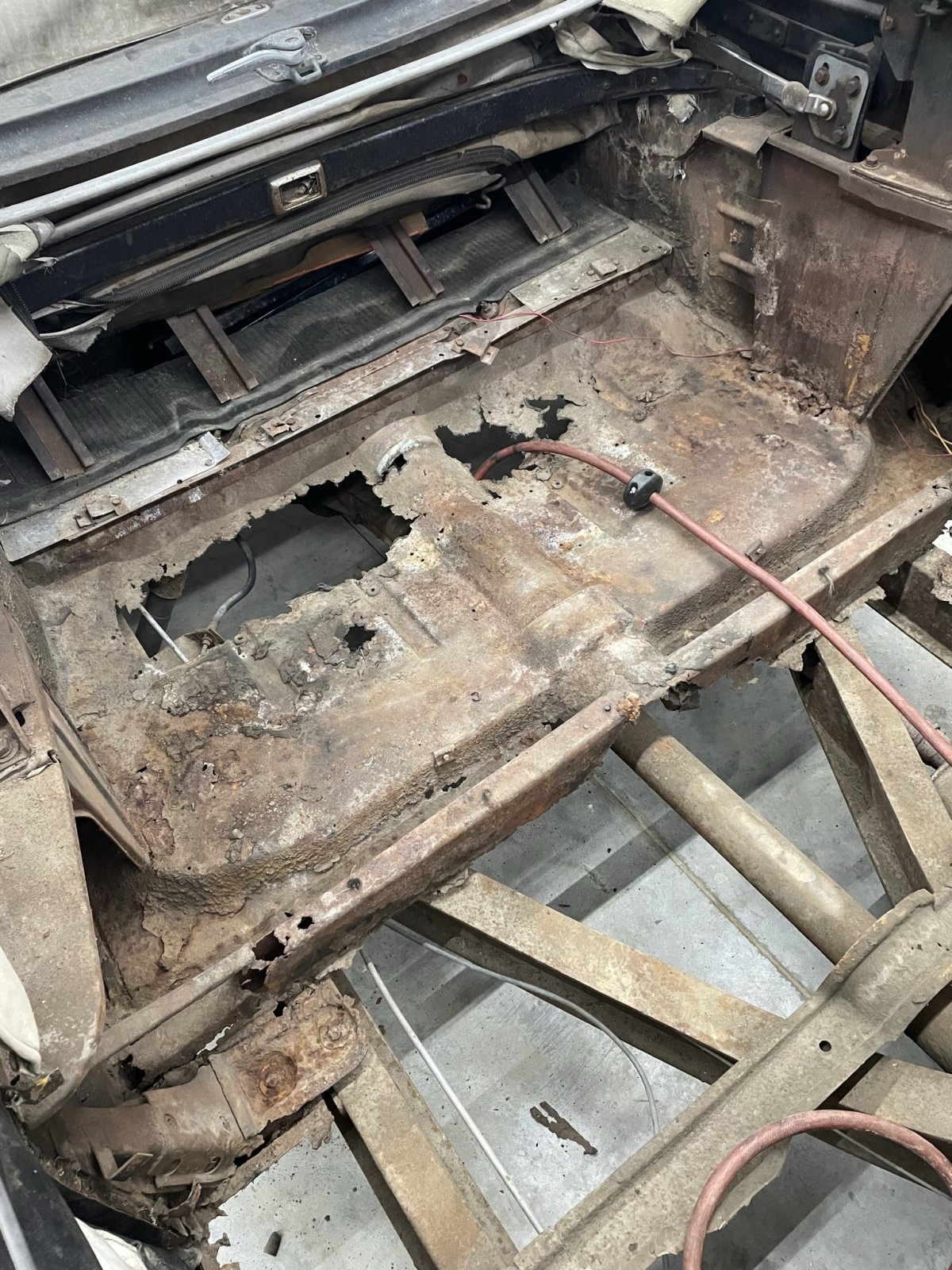

    I’m back on the convertible after a long break. Had a baby, started a new job, building a house, all that good real world stuff.

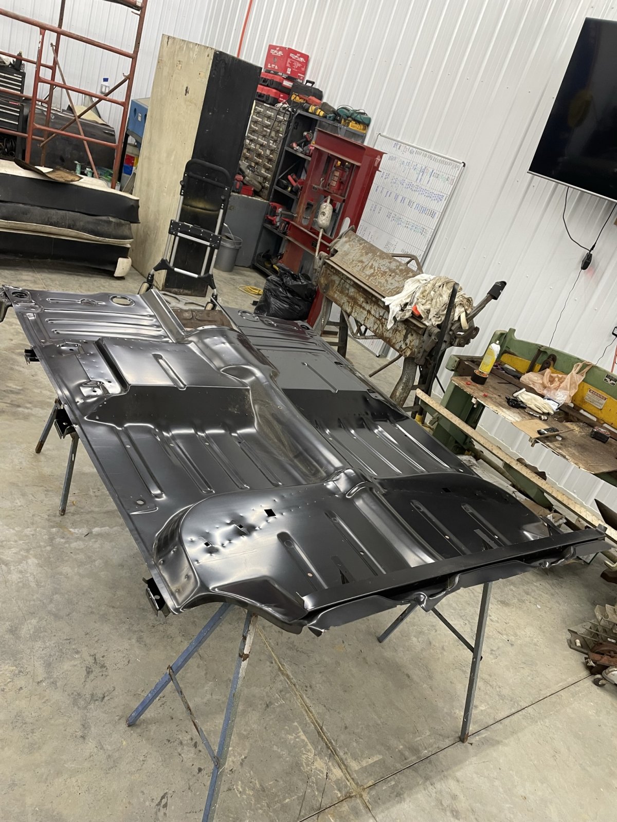

    The more I dug in the worse things got. So a new floor pan was in order along with rebuilding the convertible top well.

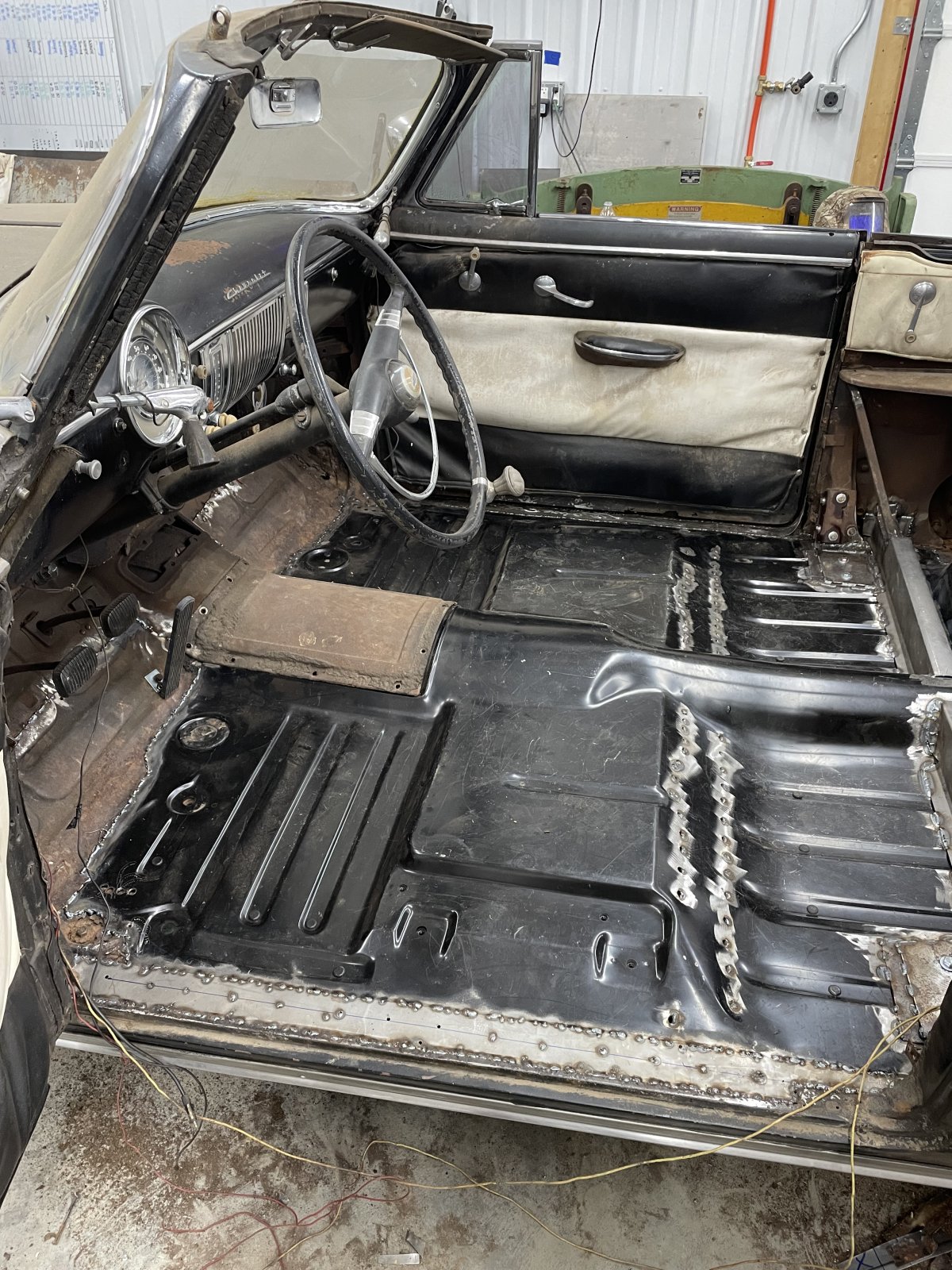

    The floor and new pan

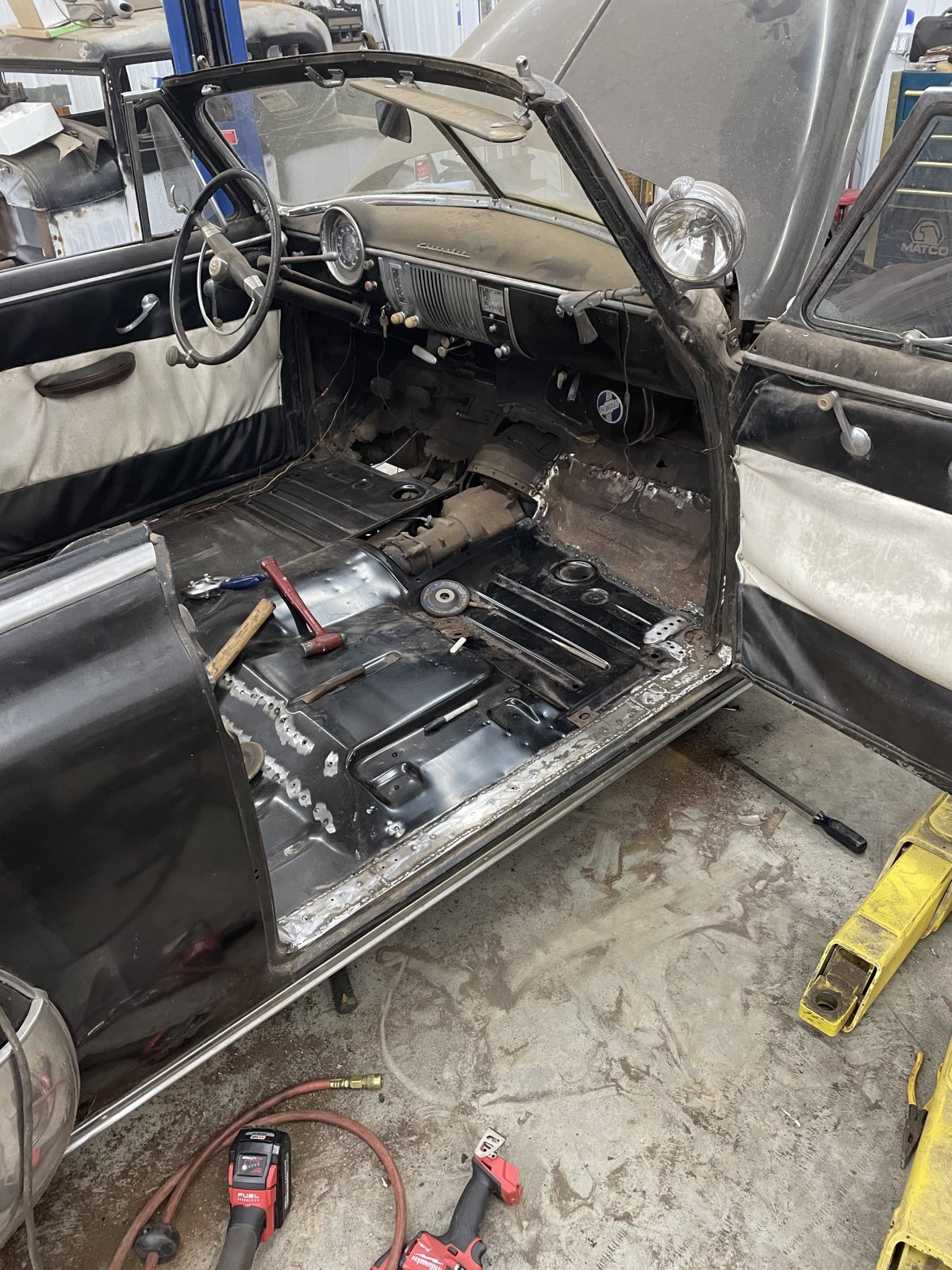

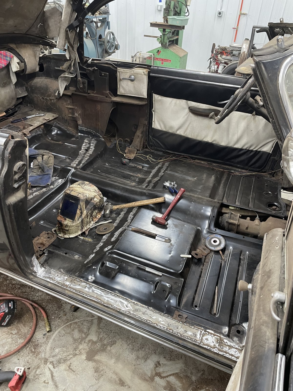

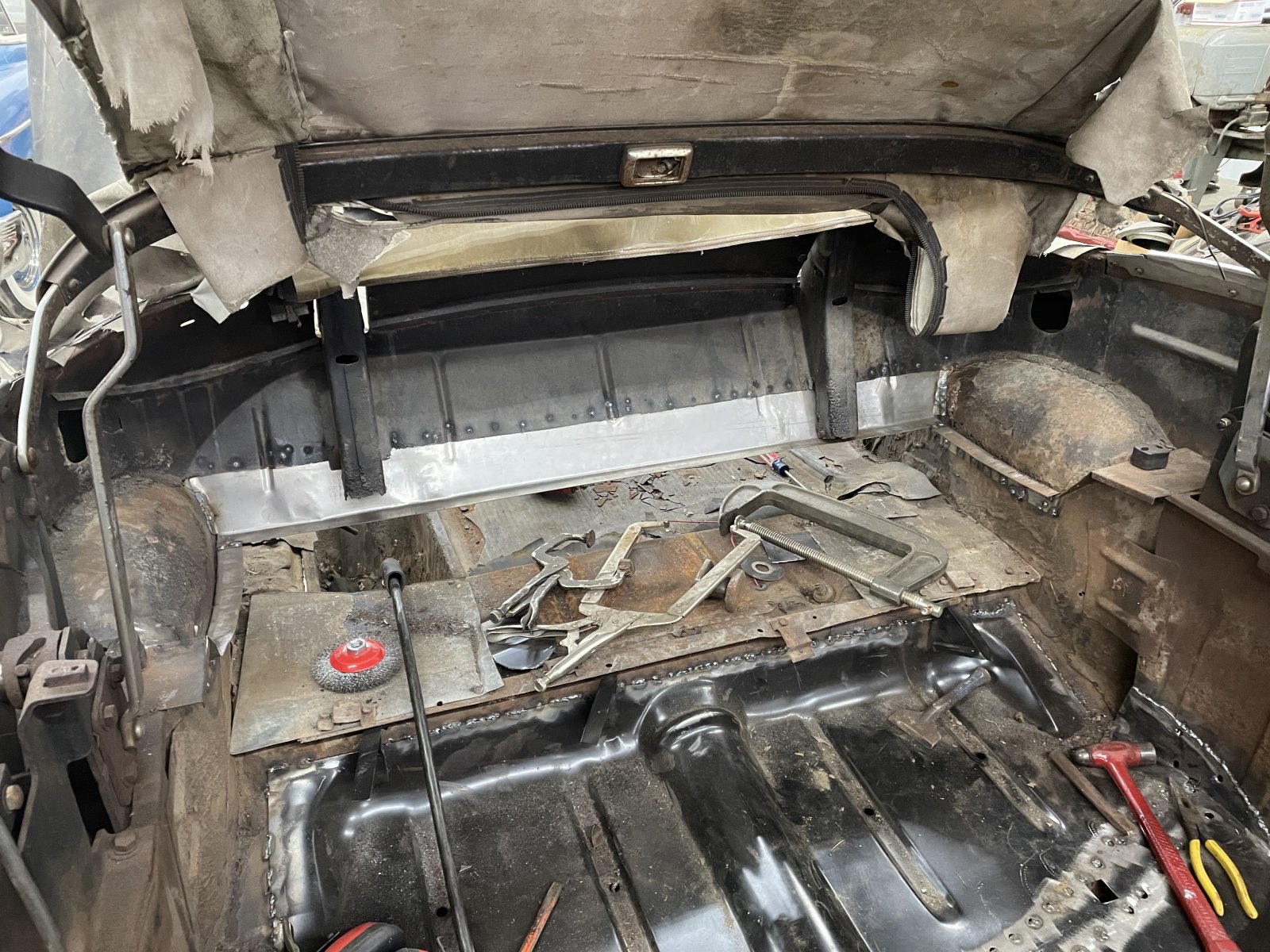

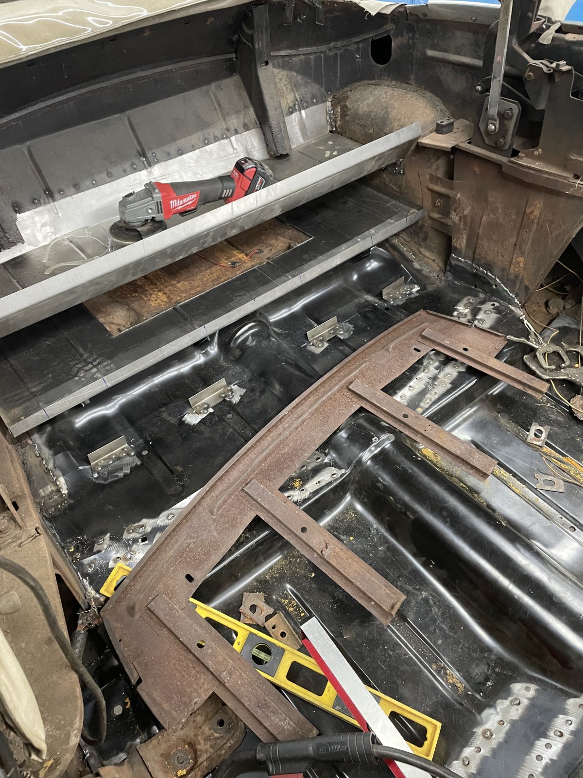

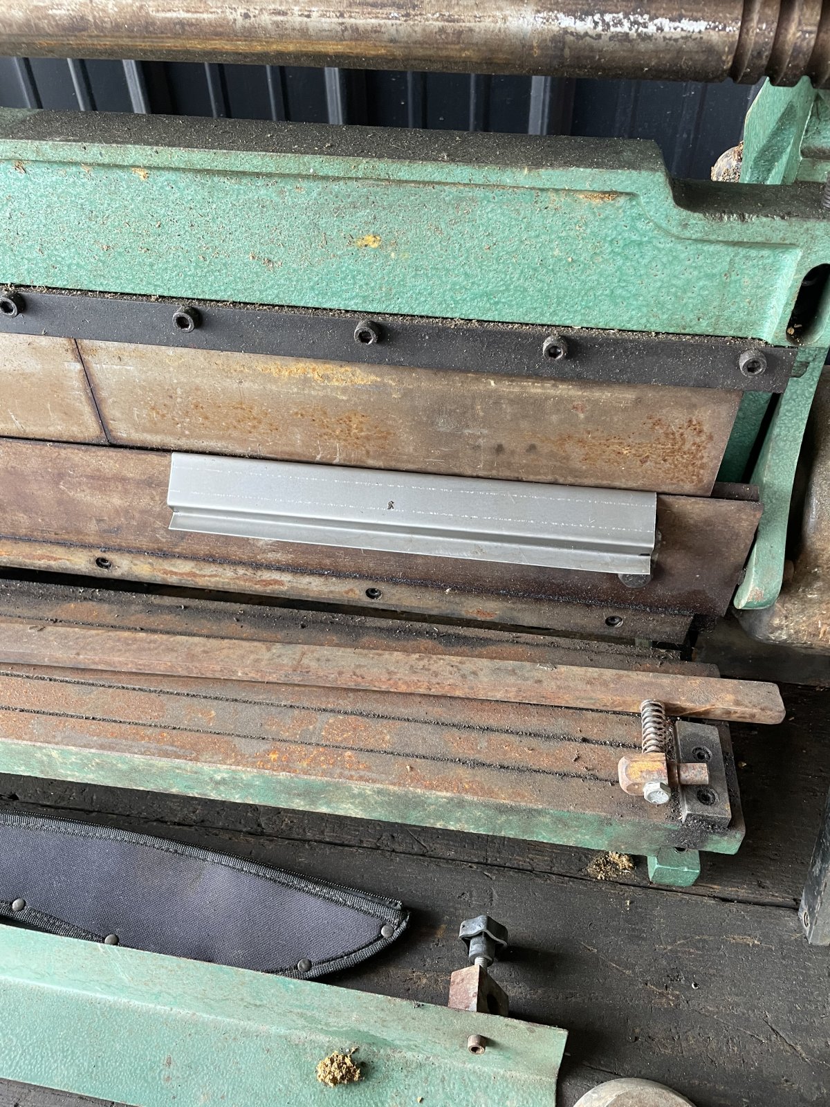

    Here’s more. I don’t have the skills that a lot of y’all do but this should be good after some seam sealer and a coat of paint.

    flying53gmc
    from M-boro, TN

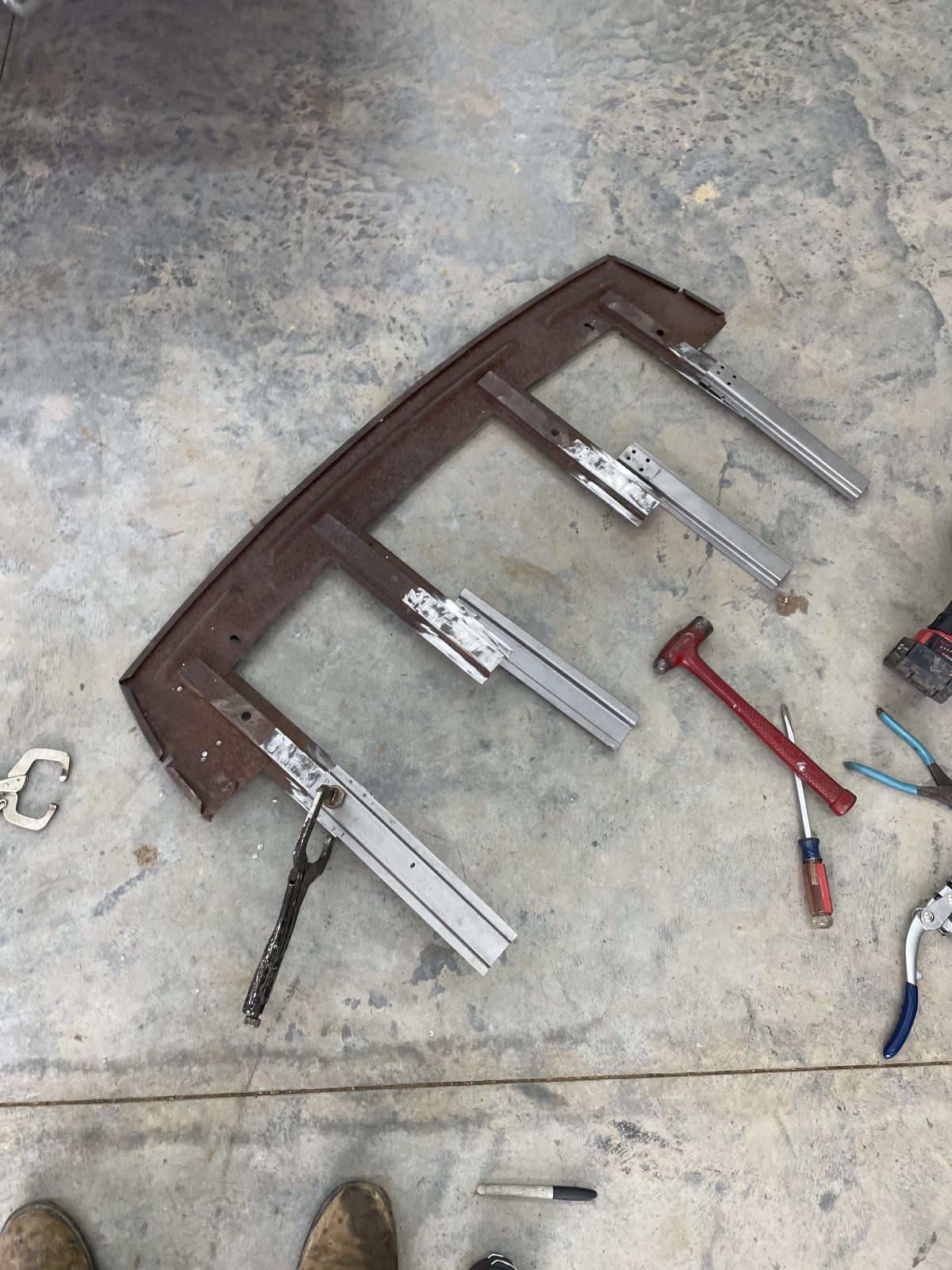

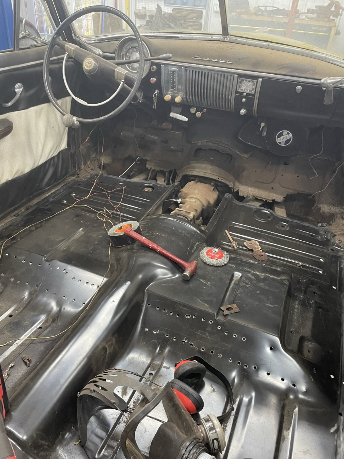

    More

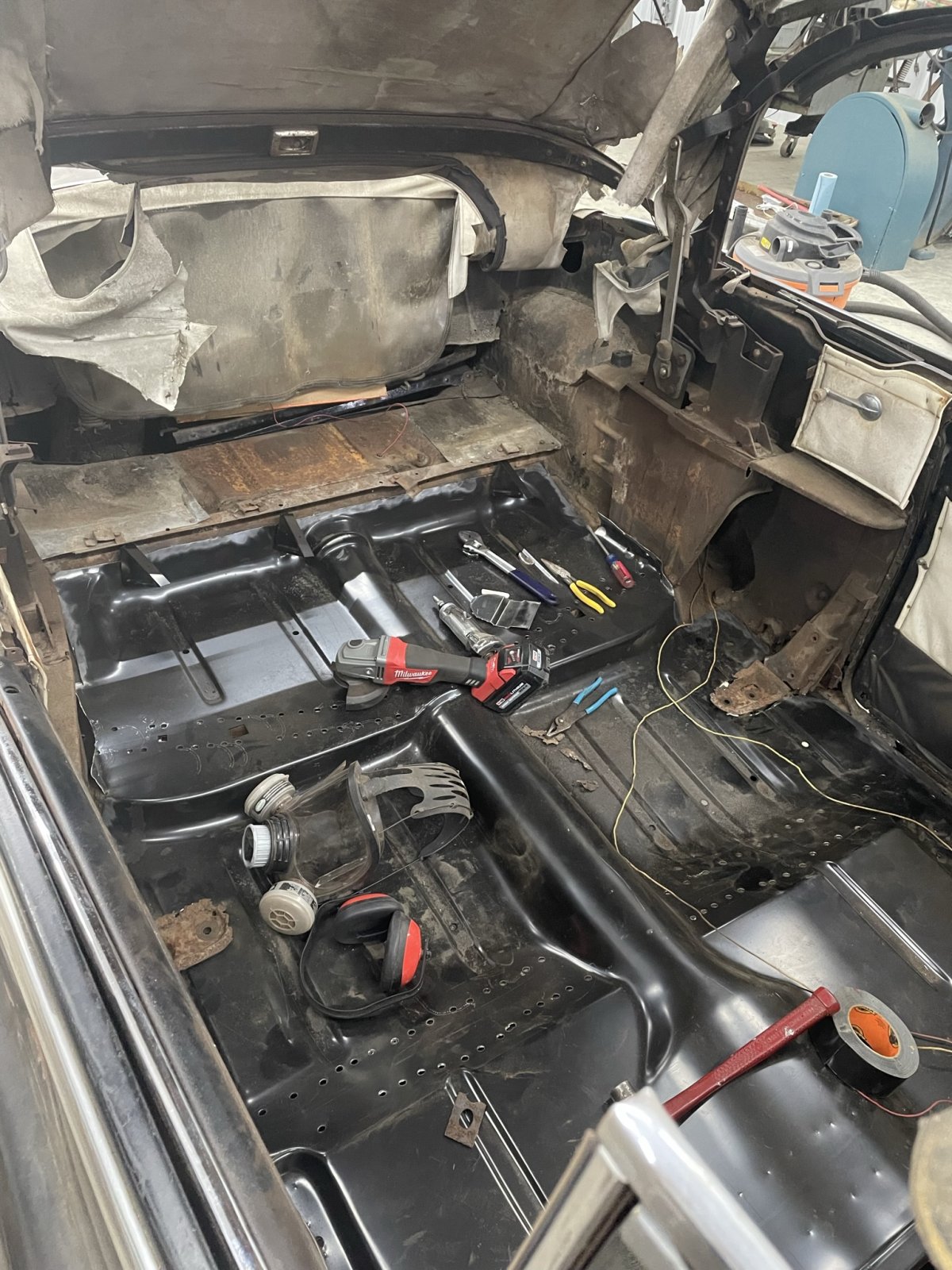

  21. flying53gmc
    Joined: Mar 2, 2005
    Posts: 419
    flying53gmc
    from M-boro, TN

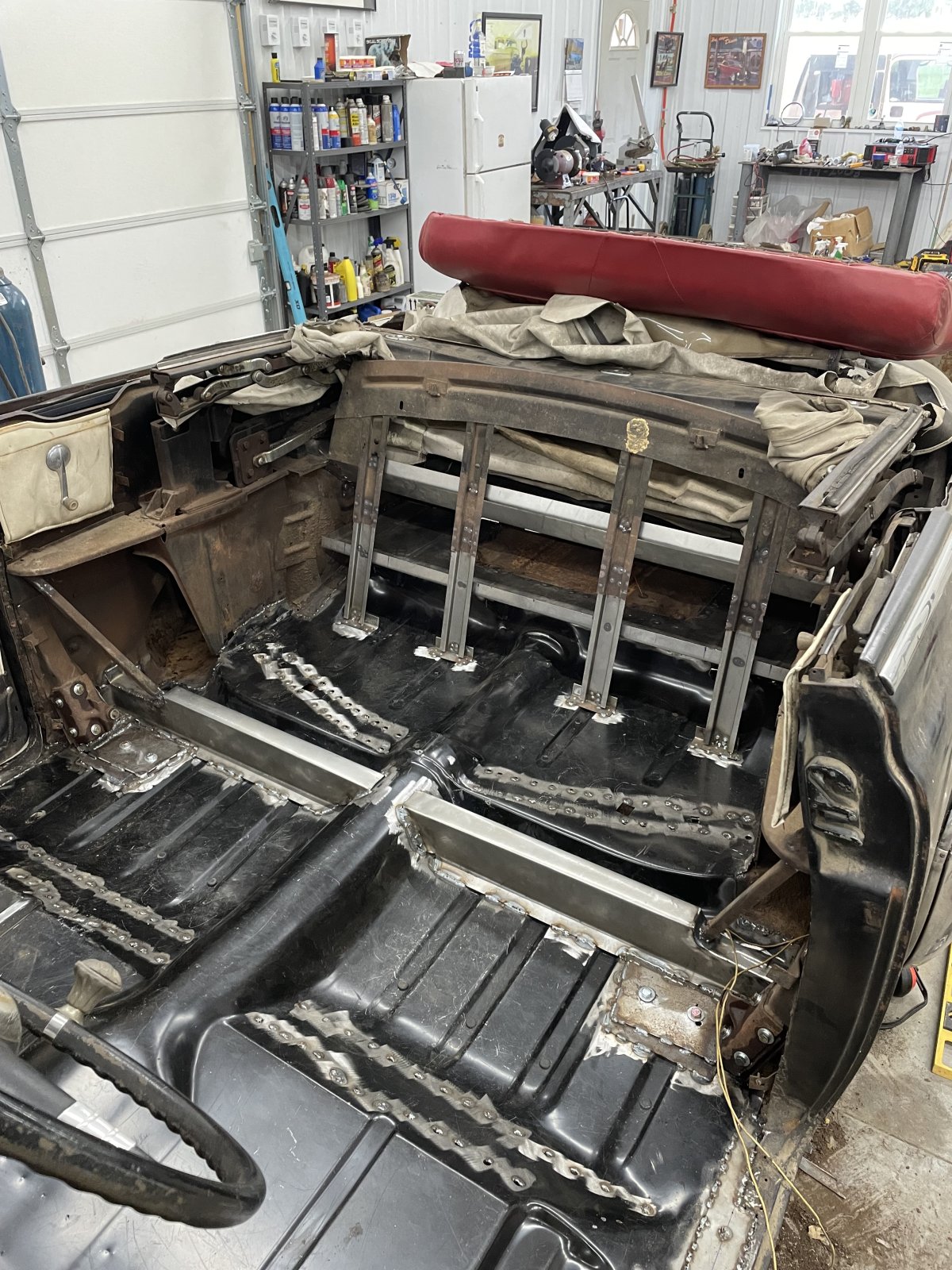

    Almost done with the floor and top well

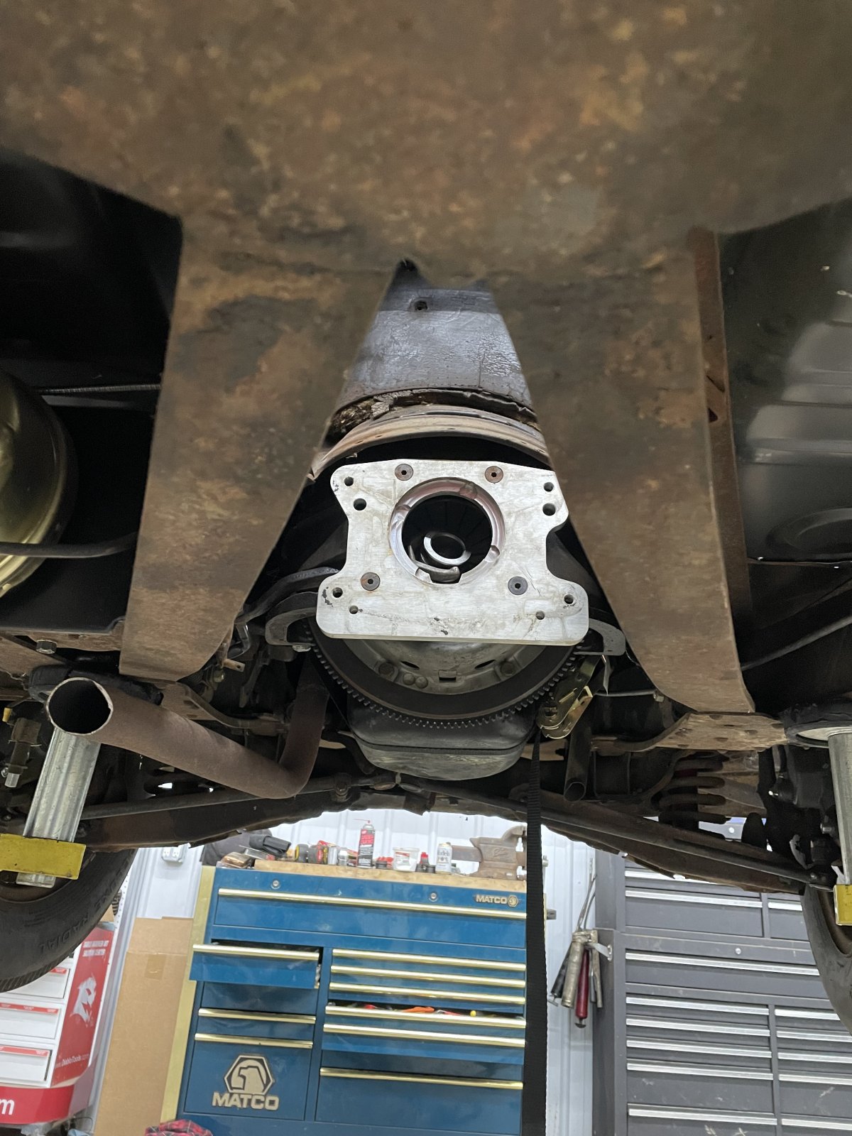

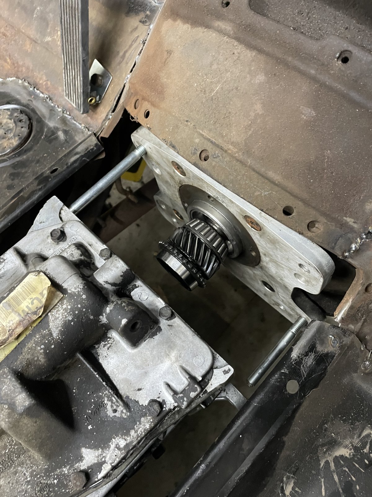

    So I couldn’t find any info on if a t5 would fit in a convertible frame with the huge x member. Turns out it will fit but you need to pull the engine. Or do one of the dumber things I’ve tried. I pulled the input shaft out, lined everything up perfect and slid the input from out of the bell housing and back into the trans. I can’t believe I got the needle bearings back in there without a catastrophe. I should have just pulled the engine forward.
