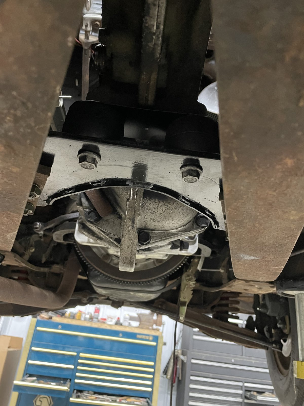

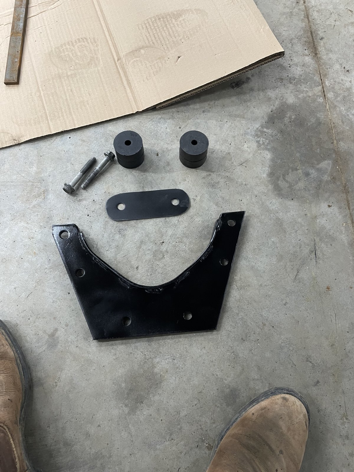

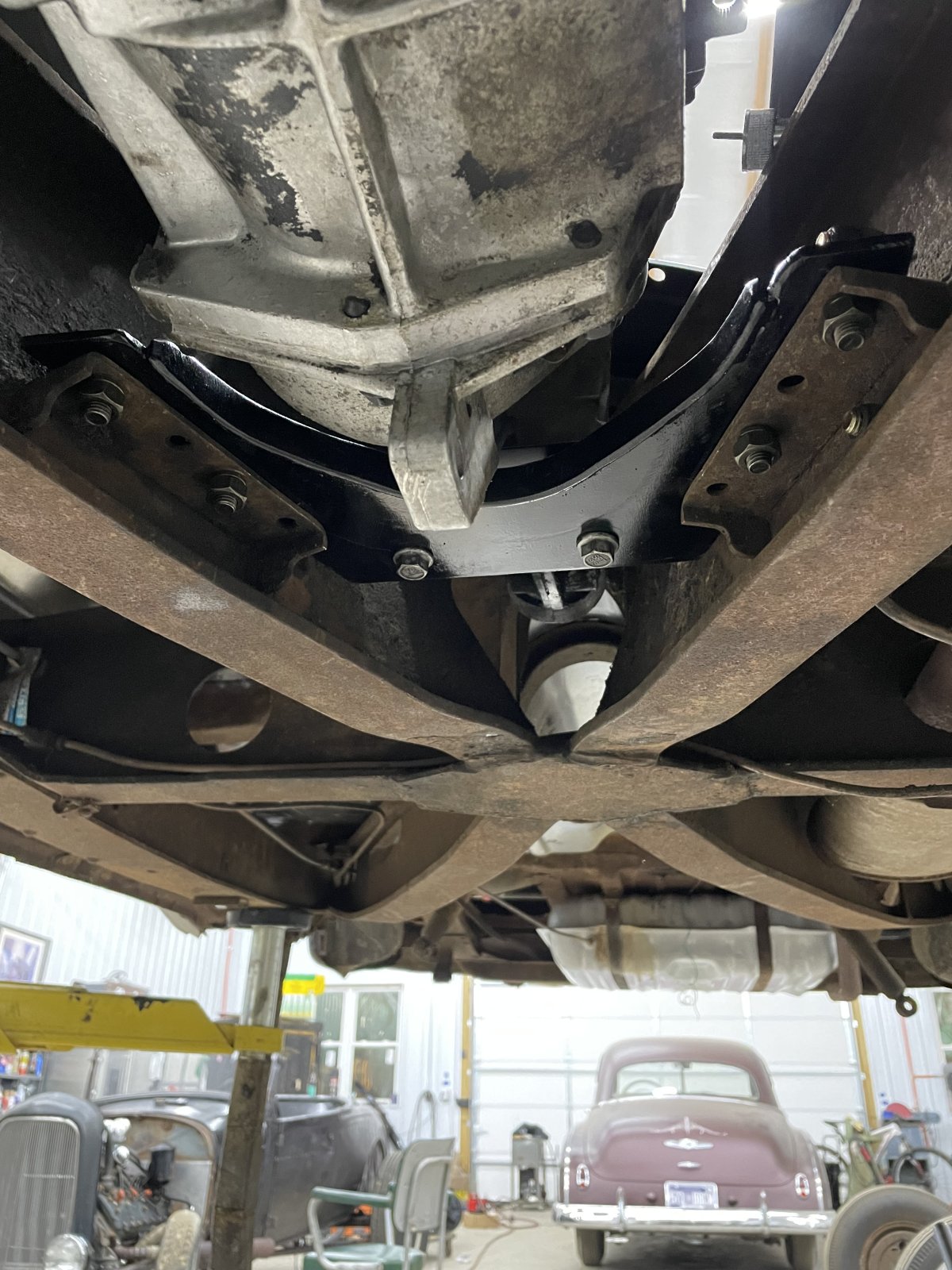

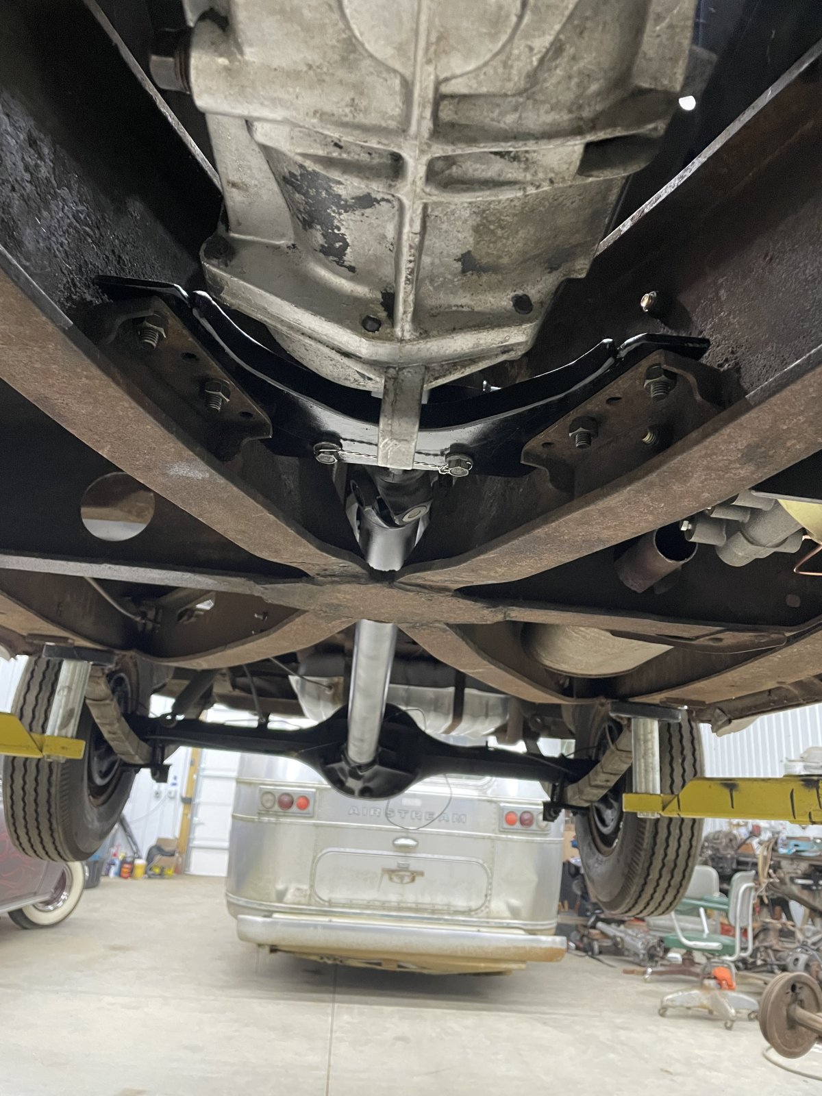

    Here is the trans mount for the t5 I made up.

    IMG_5311.jpeg IMG_5312.jpeg Driveshaft in. Junkyard driveshaft with a ******* joint someone in the hamb helped me figure out. Starting to run brake lines now. Thinking I may remove a few of this stuff I installed so I can spray the frame and floorboards.

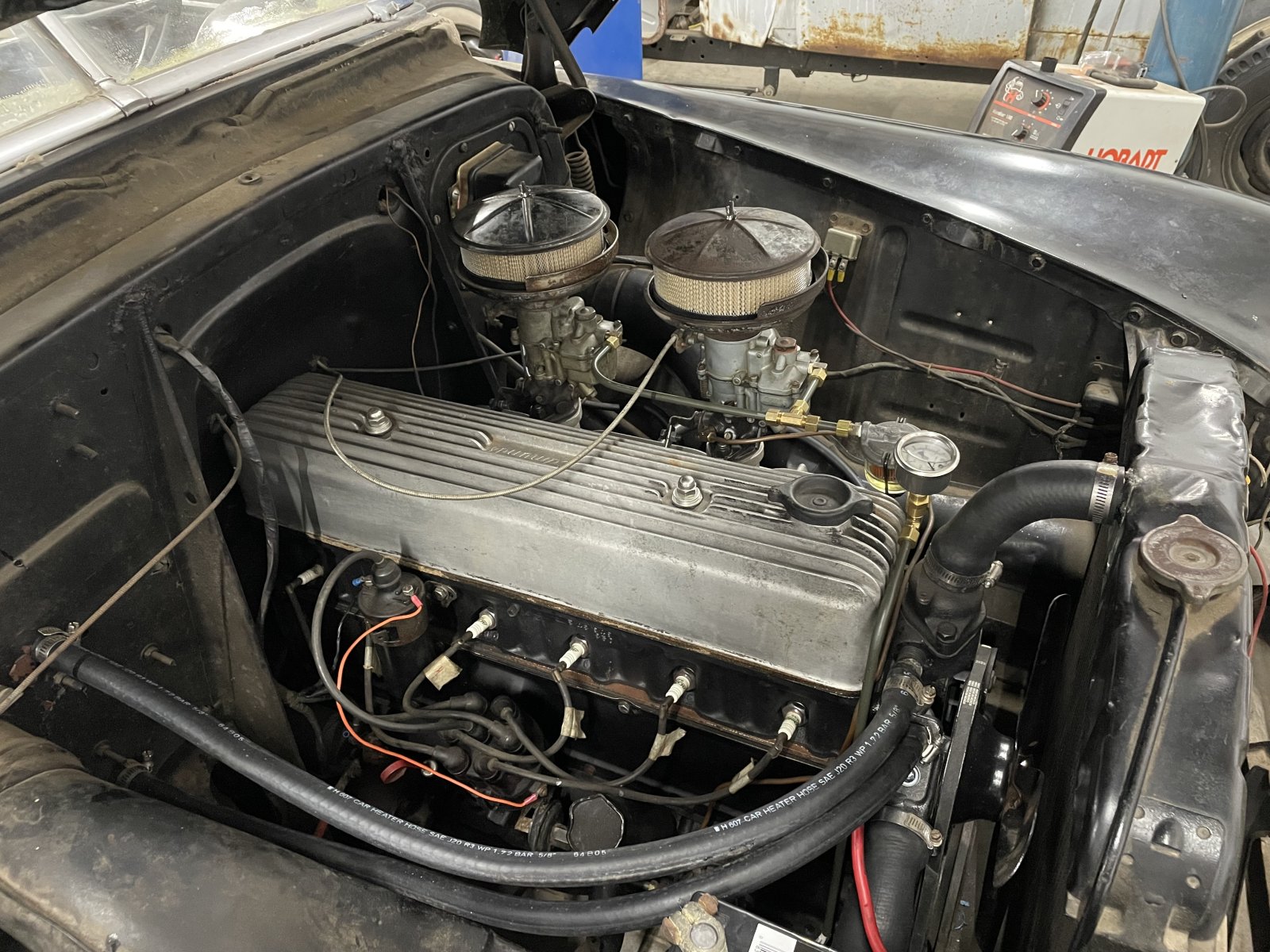

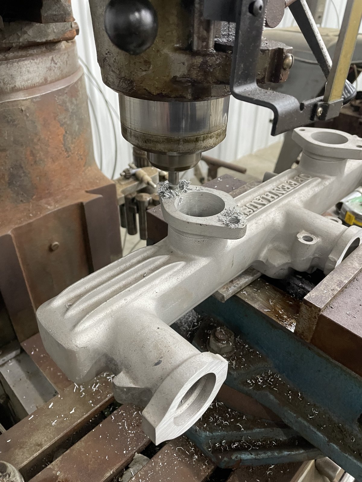

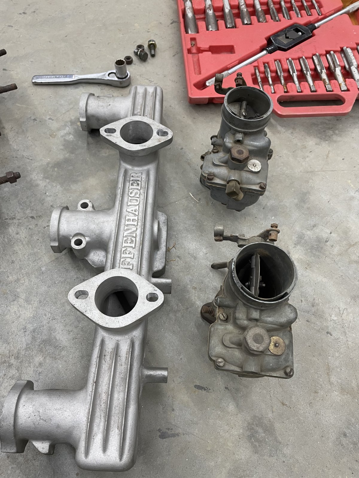

    Moving to the engine now. Had to run the intake exhaust surfaces across the belt sander. The intake runners stuck out 3/16” past the exhaust runners. Next up I slotted the mounts on the intake so I can run the smaller carb bases for the zenith carbs.
  8. flying53gmc
    Joined: Mar 2, 2005
    Posts: 415
    flying53gmc
    from M-boro, TN

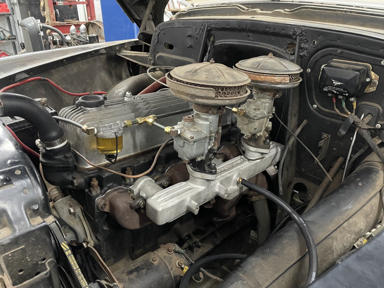

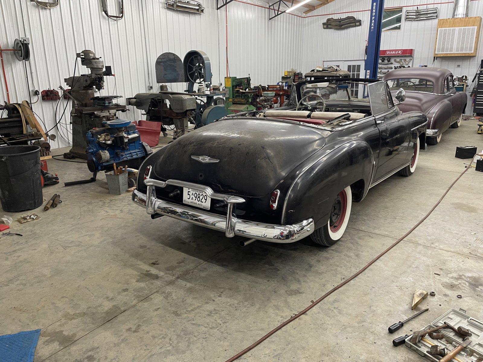

    Coming together. Fired it up on 2 carbs today. I still need to build linkage and rebuild the carbs and run exhaust. Front carb was leaking out the throttle shaft. Might just be a dirty float needle. A lot of fine tuning still to go.

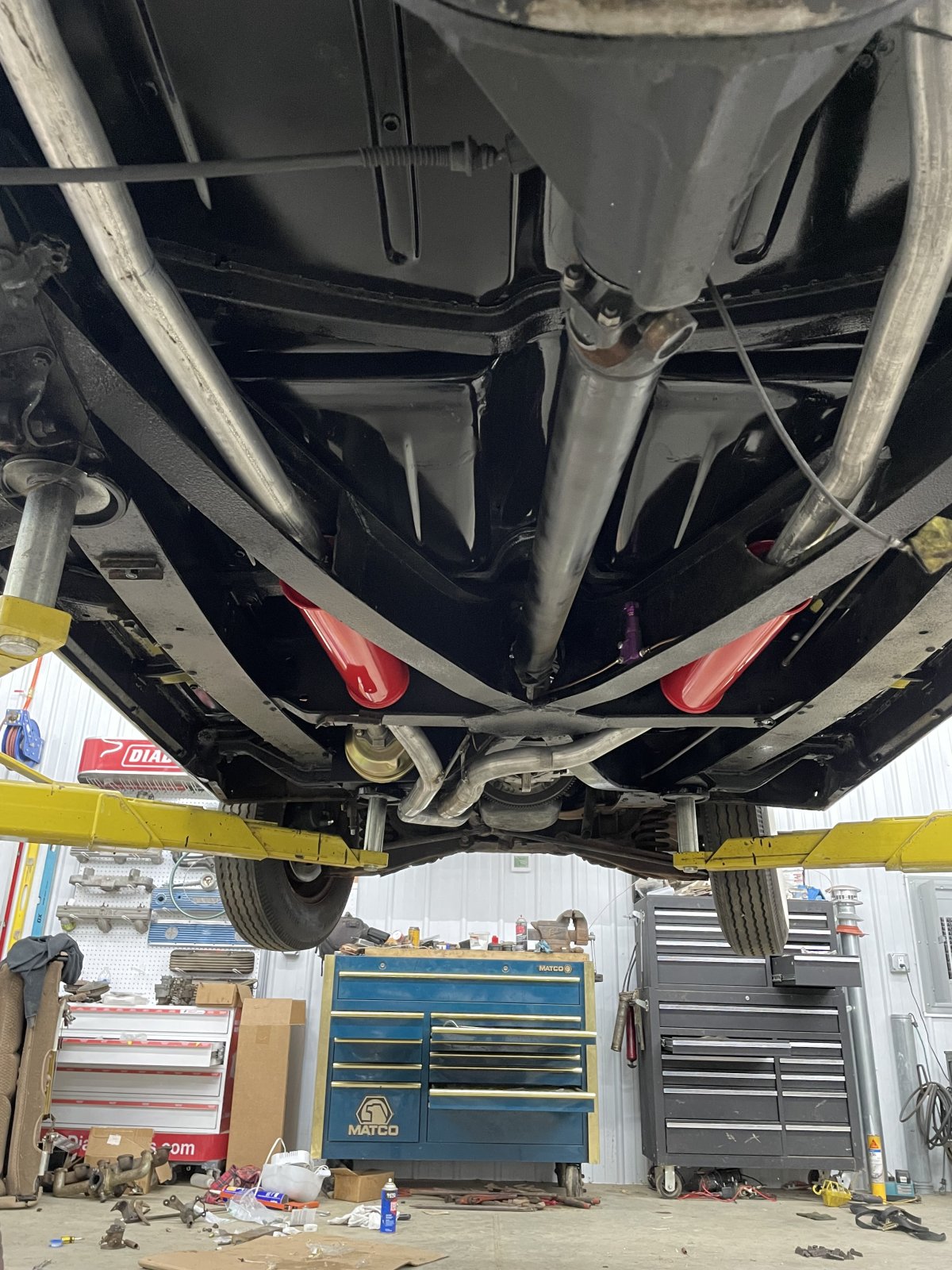

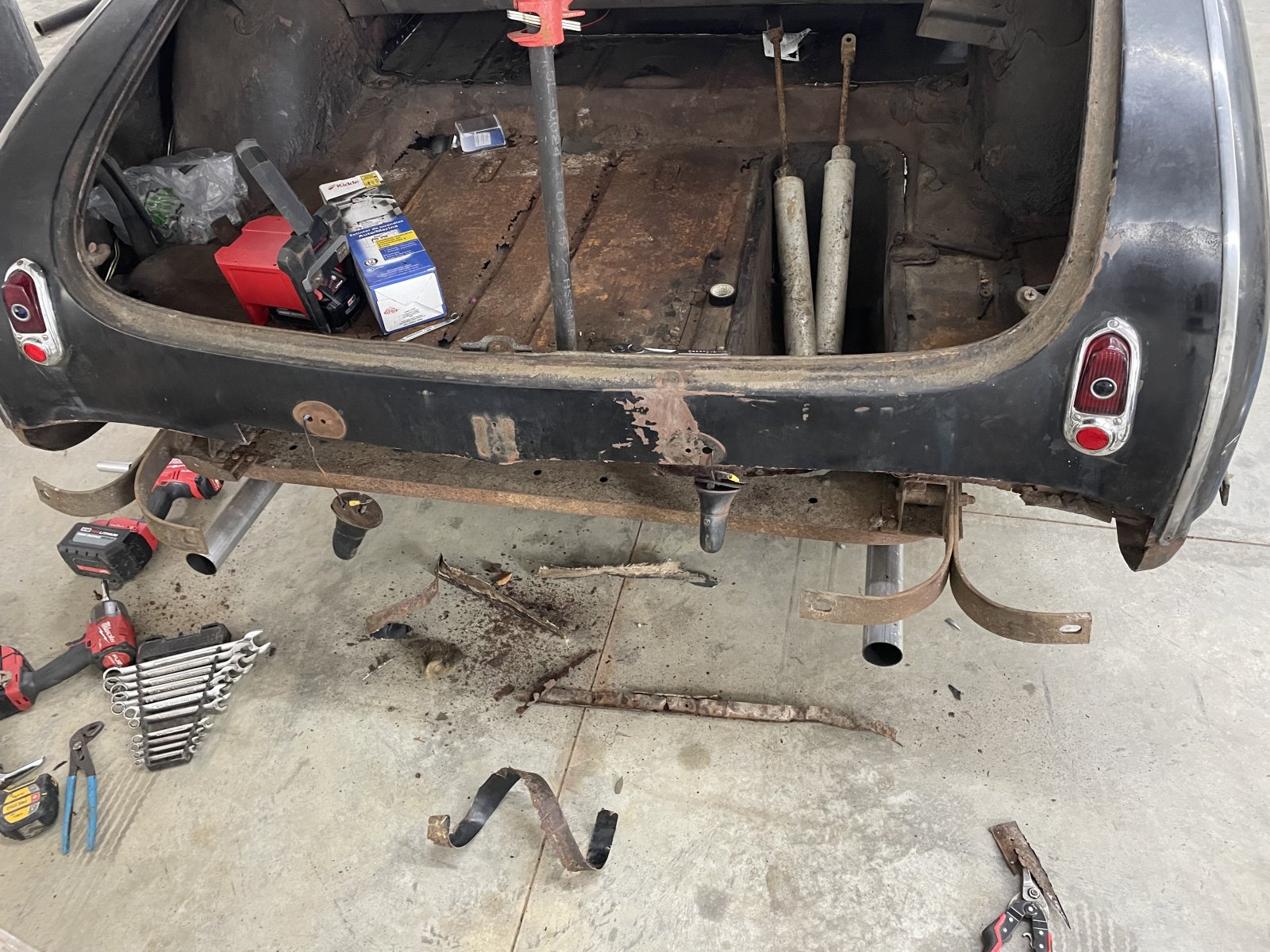

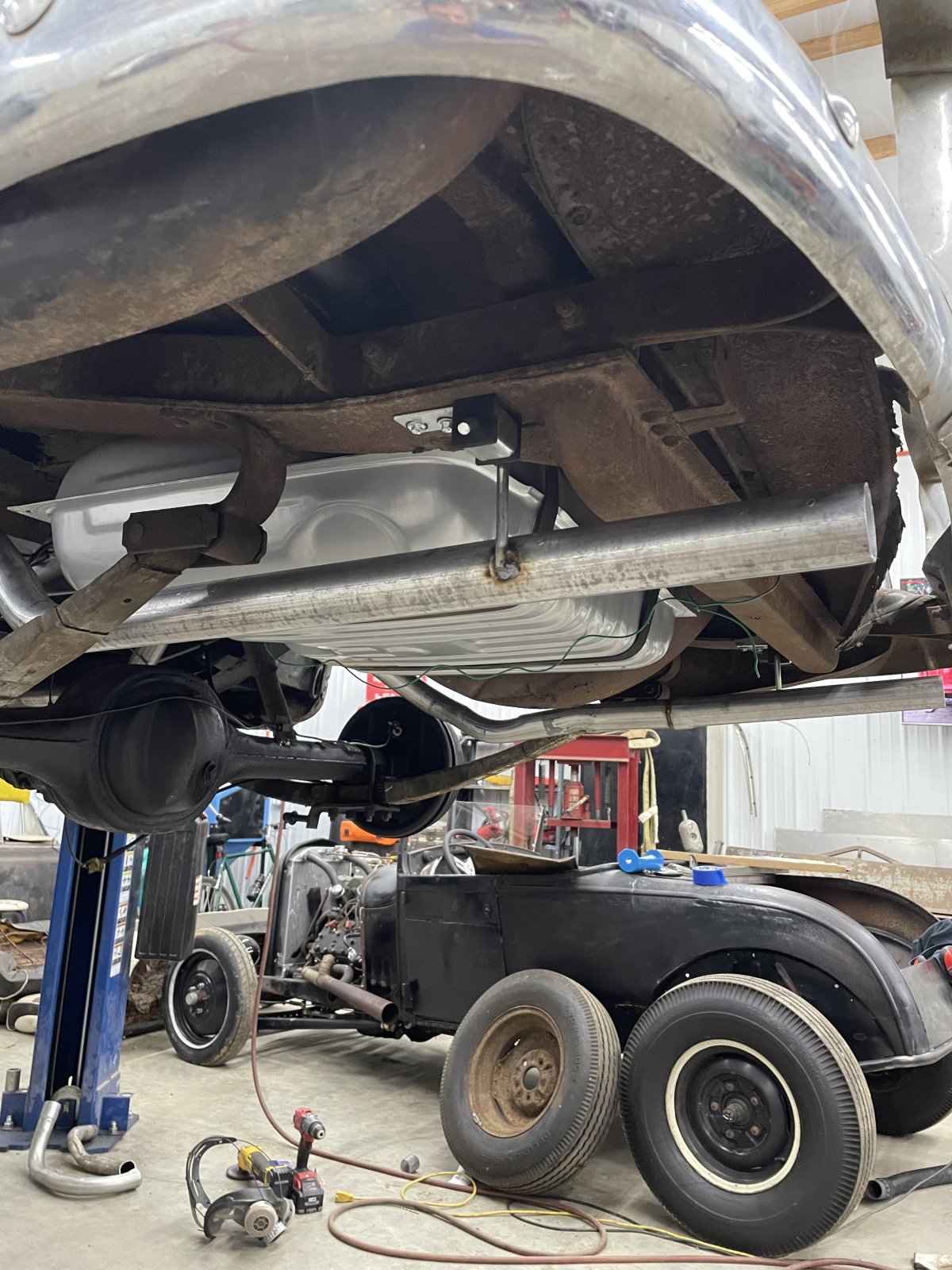

    Don’t laugh, I traded for an exhaust bender a couple years ago and finally fired it up. No idea what I’m doing, but I ran the exhaust the last few days. Also got the floor sprayed top and bottom and ran the rest of the brake lines.

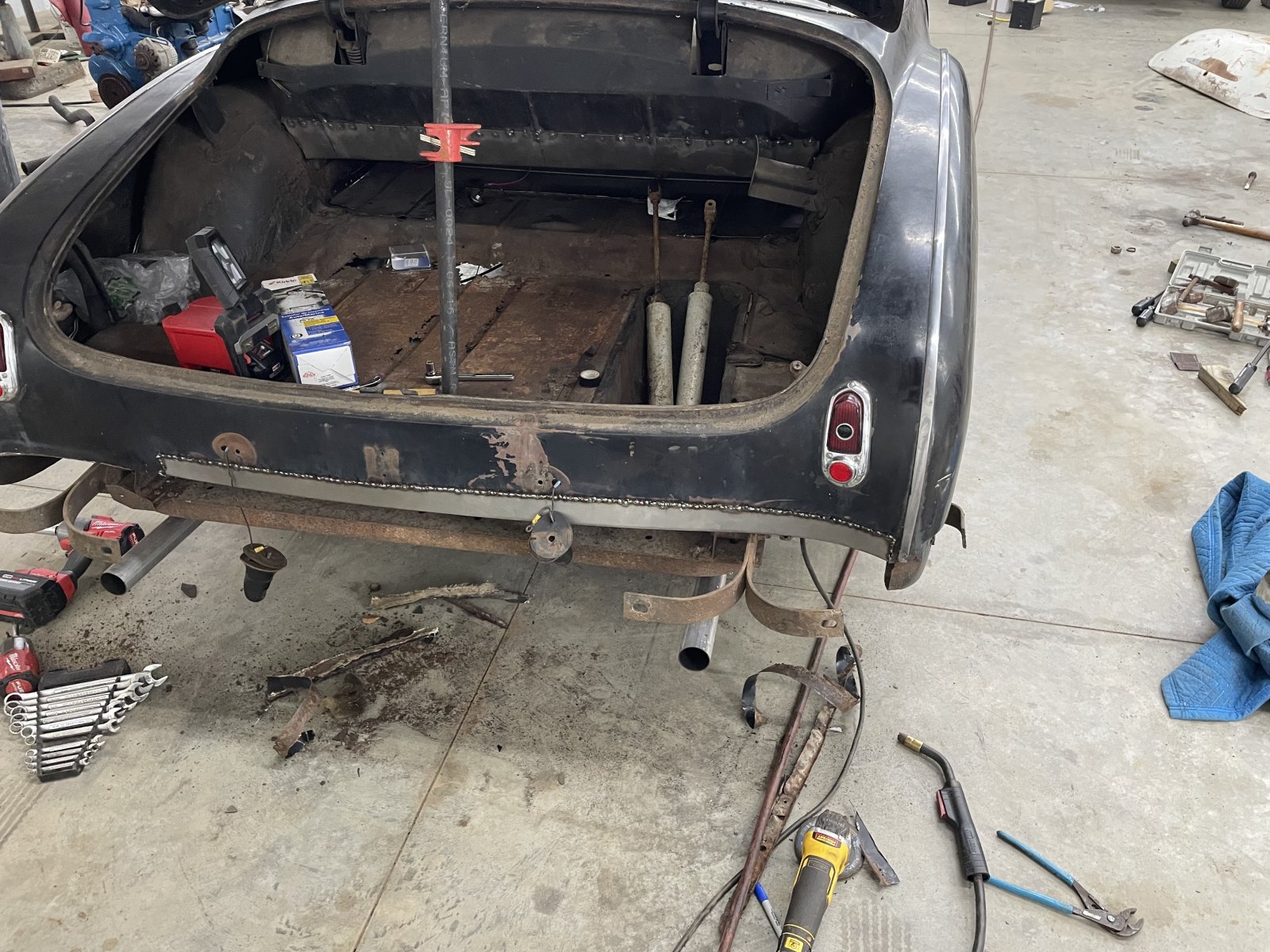

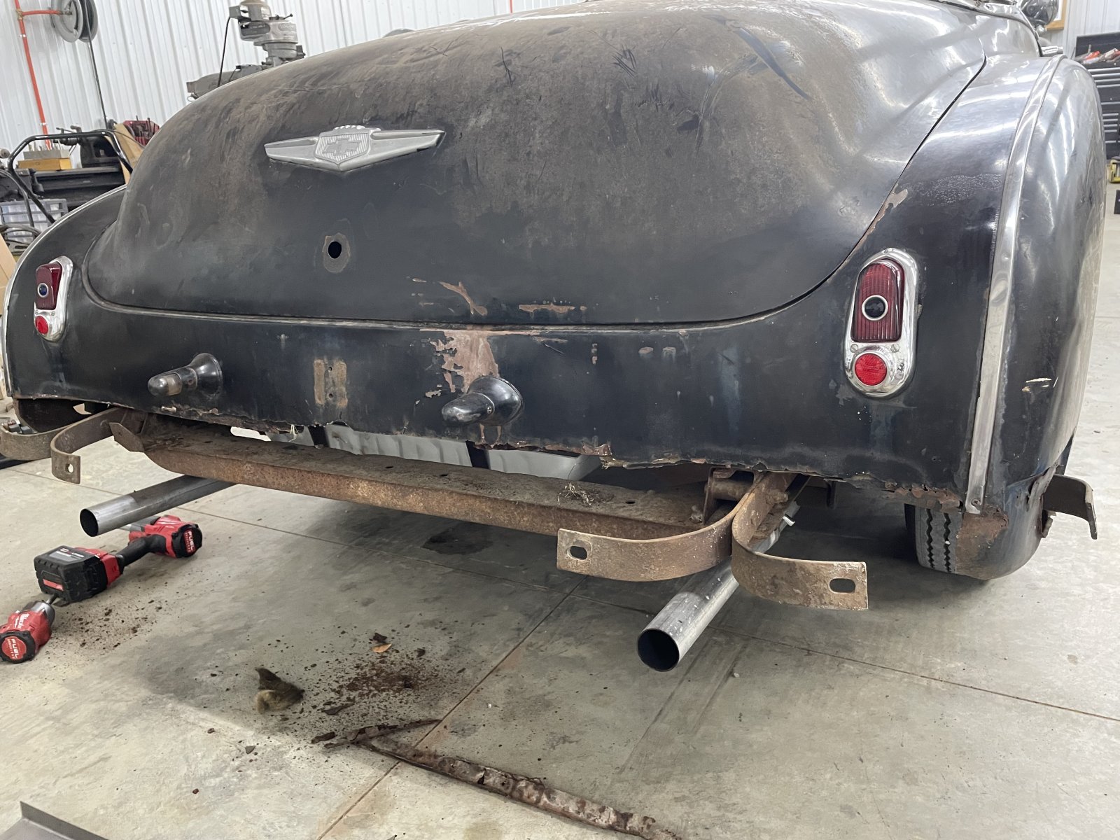

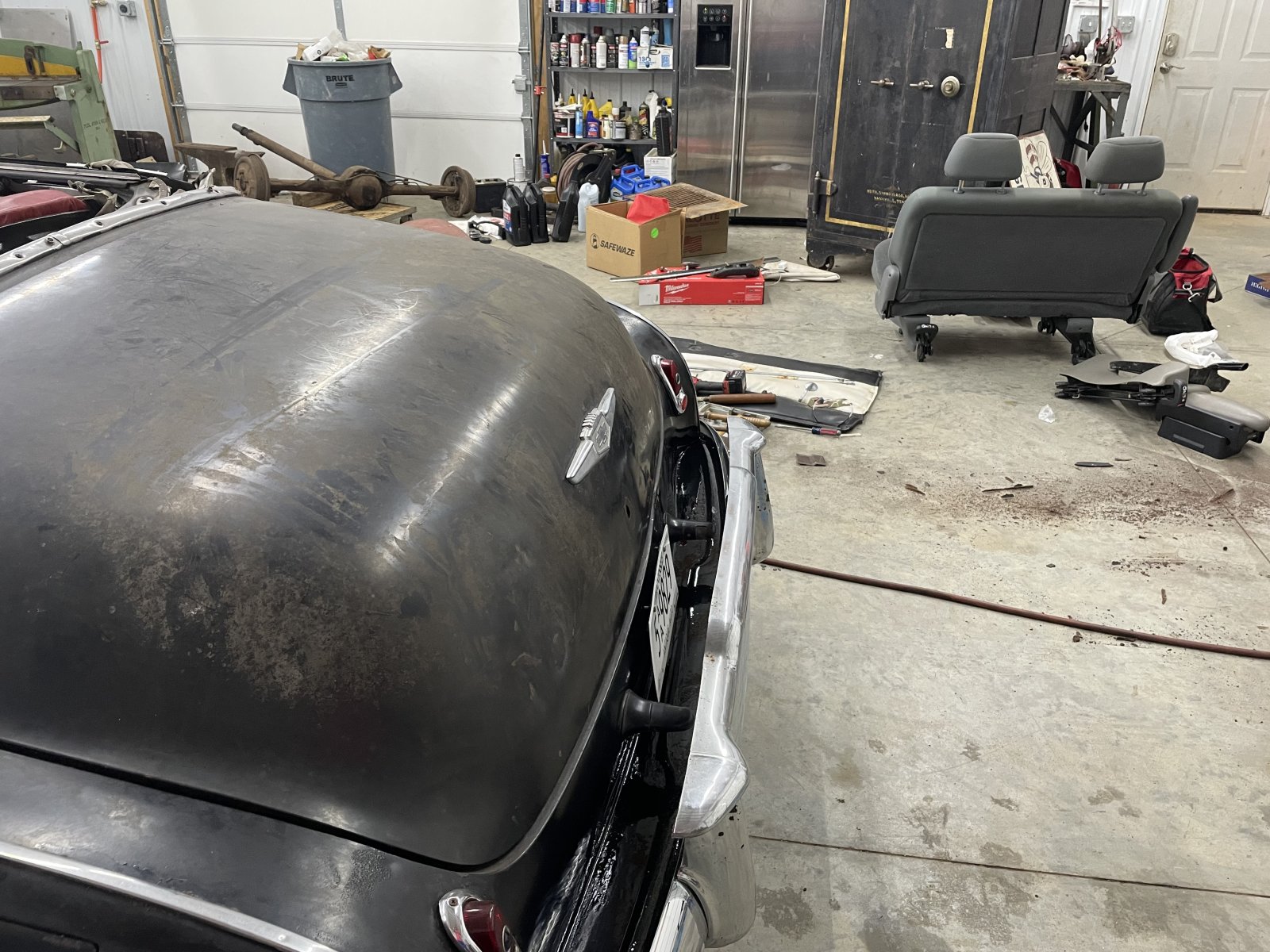

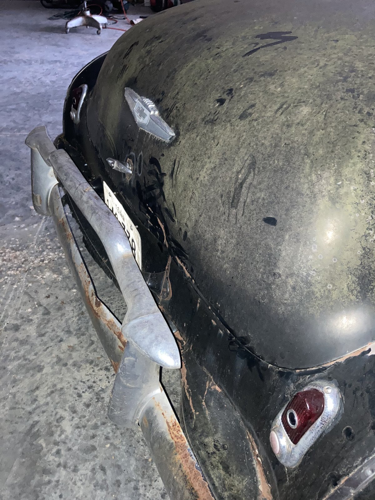

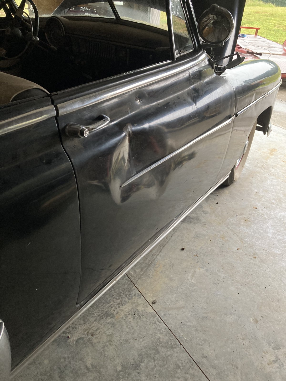

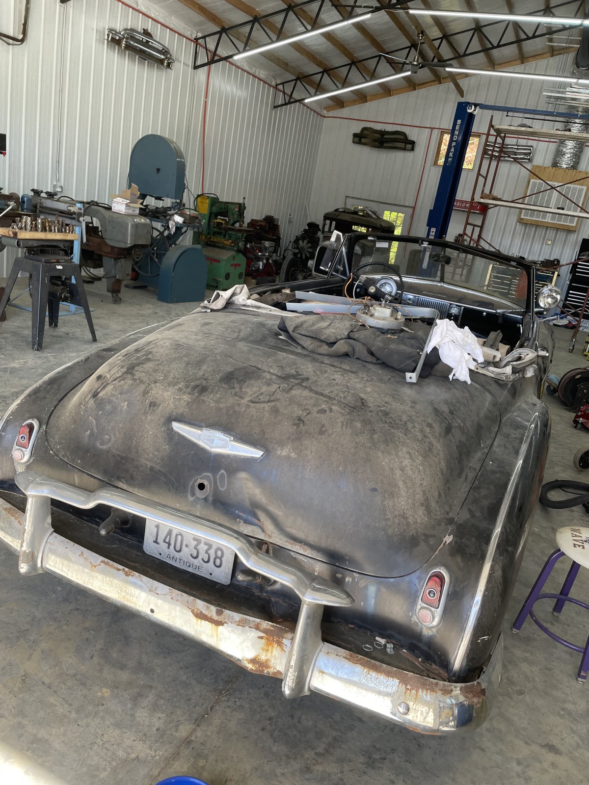

    She took a hit in the back and p***enger door at some point while being stored before I got it. I’m not up for the time and money it would take to get a repaint on her. I did try to m***age some of the dents today. I’m obviously no body man. Here are some befores
    68746298574__1427CE6A-9513-4F8A-A52E-852717FBE0FC.jpeg 68746298574__1427CE6A-9513-4F8A-A52E-852717FBE0FC.jpeg IMG_0424.jpeg IMG_0423.jpeg IMG_0424.jpeg IMG_0423.jpeg 68746298574__1427CE6A-9513-4F8A-A52E-852717FBE0FC.jpeg IMG_0424.jpeg IMG_0423.jpeg

    This will have to be good enough until she one day gets stripped down for a paint job. IMG_6006.jpeg IMG_6008.jpeg IMG_6007.jpeg IMG_6009.jpeg IMG_6011.jpeg IMG_6012.jpeg
