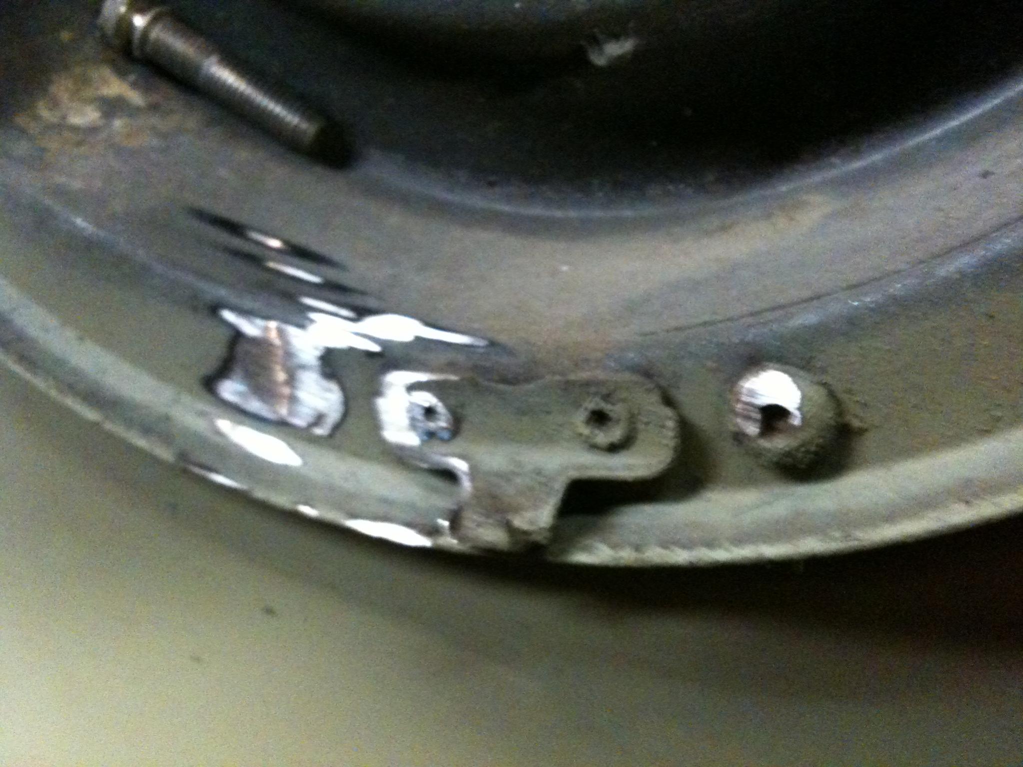

    started frenching the headlights. im exited because this is my first kustomization on the car and im doing it all by myself without my dads help. i had to grind the old screws off, then ground the ring around the bucket off. now it will be mounted behind the fender instead of the front. this will recess the headlight about a quarter of a inch. then i will weld the headlight bezel on witch will extend the fender around the headlight. there's a pic with stock headlights and one of how it sist into the fender now after frenching without the bezels welded on yet.

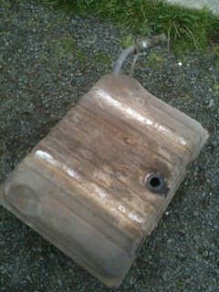

    I bought new plugs and points and checked the firing order and the timing and it still ran like **** but then I byp***ed the tank and hooked it up to a can of fresh gas and it ran like a top. So I drained the tank and took the gas tank out to try to clean it out. Anyone know of a good cleaning agent to clean the tank? ImageUploadedByTJJ1369068260.222933.jpg ImageUploadedByTJJ1369068271.919221.jpg

    I used lacquer thinner a half gallon at a time but do be careful. Add some river rocks and agitate it a bit.... drain, repeat 3 or 4 times. And let it dry out a few days

  11. johnwd98
    Joined: Jul 21, 2010
    Posts: 74
    johnwd98
    from Minnesota
    I used pressure washer soap with phosphatizer and a couple hands full of marble sized rocks in the tank. I then jacked up one side of my lawn tractor and, ratchet strapped it to the wheel and let it idle. A friend stopped by and had to take pictures. He thought it was pretty funny!
  12. GassersGarage
    Joined: Jul 1, 2007
    Posts: 4,726
    GassersGarage
    Take it to a radiator shop. They can clean it out.

    updates: got the trunk in and tank flushed, need to undercoat the bottom of the trunk and put the tank in and that will wrap that up

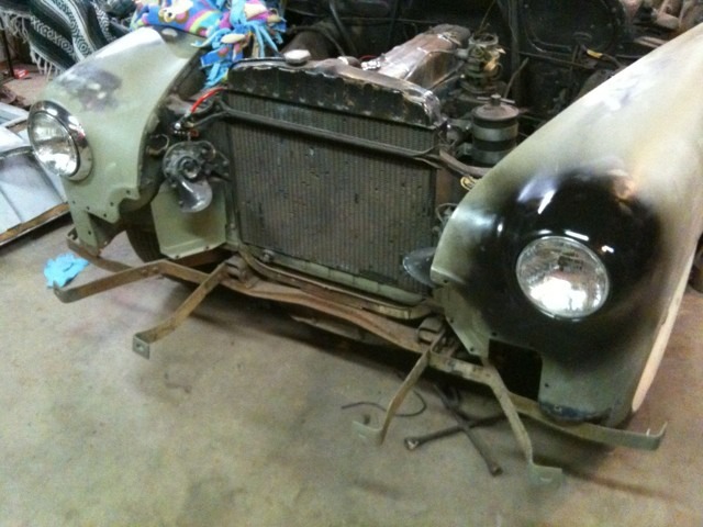

    Now for the fun stuff, I've got the headlight rings mostly welded in il finish once we get some more wire. It ain't pretty but I'm using flux core mig so its not too smooth. eventually I wanna get a tig.
    Pics:
    I gotta stop leaning on freshly welded metal this is the second tipe this month!
    And here's what I've got now
  17. 49styleline

    Today I undercoated the bottom on the new truck pans and I finished the welding on the headlight. I ground down the welds and put some fiber gl*** filler on.

    its starting to come together:) cant wait to get it back in primer so i can see it all smooth and nice.

    Took the fender of to French the headlight and found the the inner fender and heater box all rotted away from the battery tray down. Nothing like some un expected rust repare ImageUploadedByH.A.M.B.1372525773.977893.jpg
