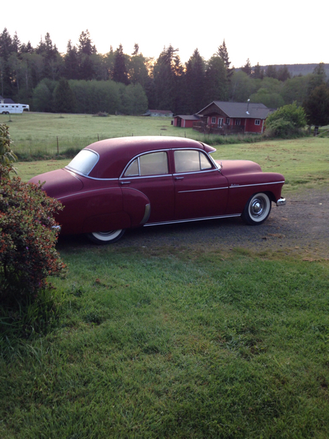

    These pictures are taken one year apart.. Big difference. ImageUploadedByH.A.M.B.1424483874.774299.jpg

    This damn car is******** me off! I've bled the***** out of the brakes, and there's no air in the lines, and I've adjusted all the brakes and the Pedal still takes 3 pumps to get any kind of brakes! Anyone have ideas?

    Hey, this has turned out brilliant, you should be so proud, im gonna go back and read through what you have done again, my initial thoughts on brakes, are they standard with the master under the floor, i havent looked if you have installed discs up front but you may have to install those pressure valves that keep a bit of pressure in the system, but thats my first thought lol. I havent been on here for ages so ill update my thread a bit later after looking through yours, im a way behind you but hopefully have mine driveable this year....fingers crossed.

    Still no brakes.. Idk what to do. ImageUploadedByH.A.M.B.1430503279.900583.jpg

    you could try fitting those residual valves they sorted out the brakes on my mates mustang, because you masters lower than your cylinders (if its mounted below floor still) you might be getting fluid drain back. I think you use 10psi ones for drums.

    Are you using stock 49 brakes?

    Yes they are.

    I used the MP (Master Power) Kit for the caliper conversion first. Picked it up at a swap meet for a good price. Then added the Walton's firewall kit without the booster. Maybe a couple of hundred miles on it and no problems.
