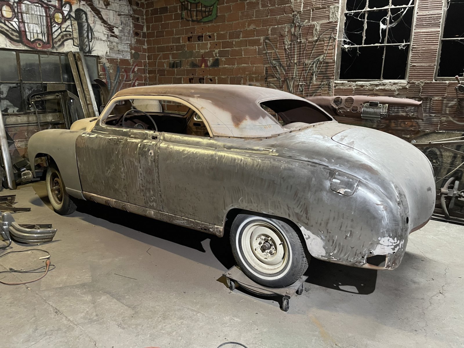

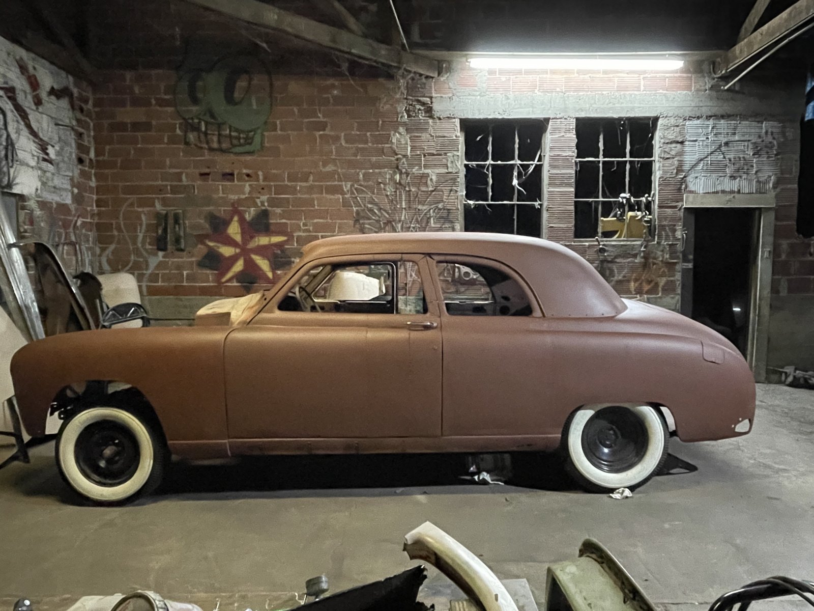

    Photo Sep 27, 7 35 02 PM.jpg Photo Sep 27, 7 36 32 PM.jpg Photo Sep 27, 7 36 46 PM.jpg Chipping away! I'll be honest, I got ahead of myself like a lot of us do. I'm over thinking the chop when the truth is, wiring and a freakin' motor might be a good idea first. So I'm dialing back on messing with the chop for now, finishing up the two door conversion.
    I mocked up the post option today. I don't hate it. I think on the p***enger side I'm going to try and see how a hardtop look would look with a wing window from a Ford hardtop, and see how I like it.
    SUCH a better looking car with less doors!

    Nah. Not seeing that. Looks more like a ‘49/‘50 Lincoln……except the Kaiser/Frazer preceded the Lincoln…soooo, who copied who…:D

    Looks good with the pillars mocked up, looks high-end. The pillars make the rest of the roof look less bulky, without them the turret of the roof seems really pronounced. I like where you're at.

    I like where it is now, but just for fun, since there's a nice side-on shot to work with, here's a couple quick and dirty photoshops. First one is a chop technically, I took nothing out of the windshield height but I brought the back down probably 3 inches to take some of the high crown out of the roof.
    And here's the same picture, but with the rear window brought further forward to take some m*** out of the C pillar
    I could see this car getting finished with just the 2 door conversion, these are just food-for-thought.

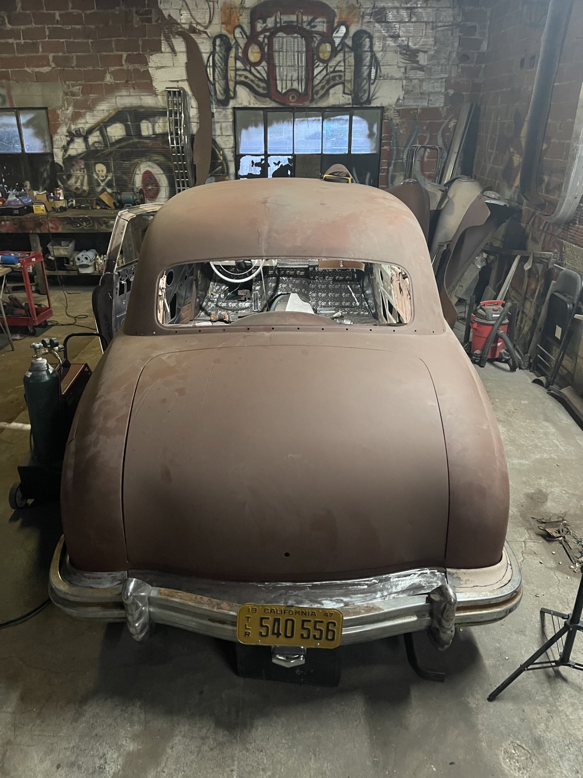

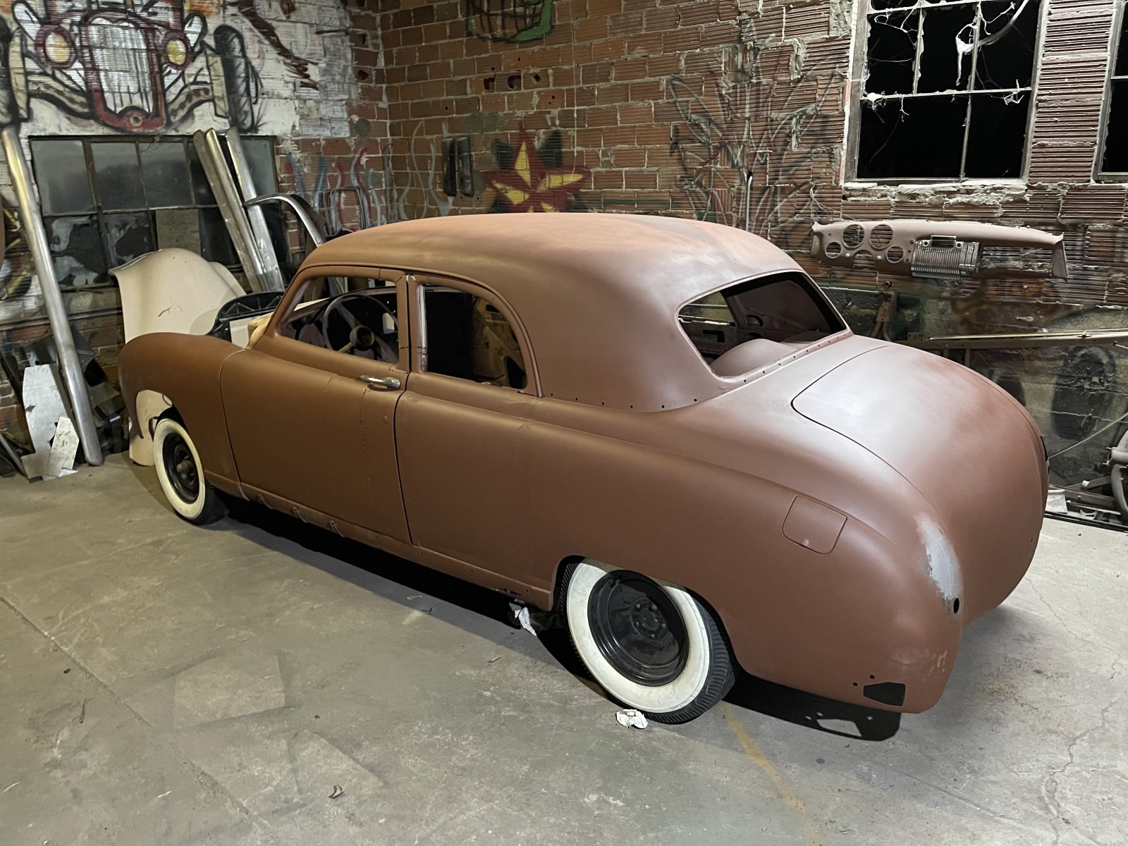

    Update! So, I gotta say this is my first car that I’ve started from a body to a running car. I’ve had lots of cars, but it’s always been a little fixing up here and there and customizing. This has been really rewarding.
    The front sheet metal is finally on, and the second door is done! I still have some welding to do, but it’s functioning two door now. My buddy came over and we got the motor all bolted down and plumbed. So she fired up the other night just with exhaust manifolds, so that was a huge thing!

    ive been following along on IG, stoked to see youve done a build thread on it!! cant wait to see the carson top happen, I think itll look killer whether you do the 3w or the 5 :)

    I like it! The 2 door proportions look spot-on and I like the custom touches like the bumpers and tail lights and whatnot. I think you're approaching it the right way too, getting it mechanically functional and getting the 2 door sedan conversion fleshed out before trying to mess with the roof height.
    This is going to be a really neat finished car. I don't think I ever saw a finished custom one, but I do think this car looks exactly like it could have if it was built in the early 50's.
