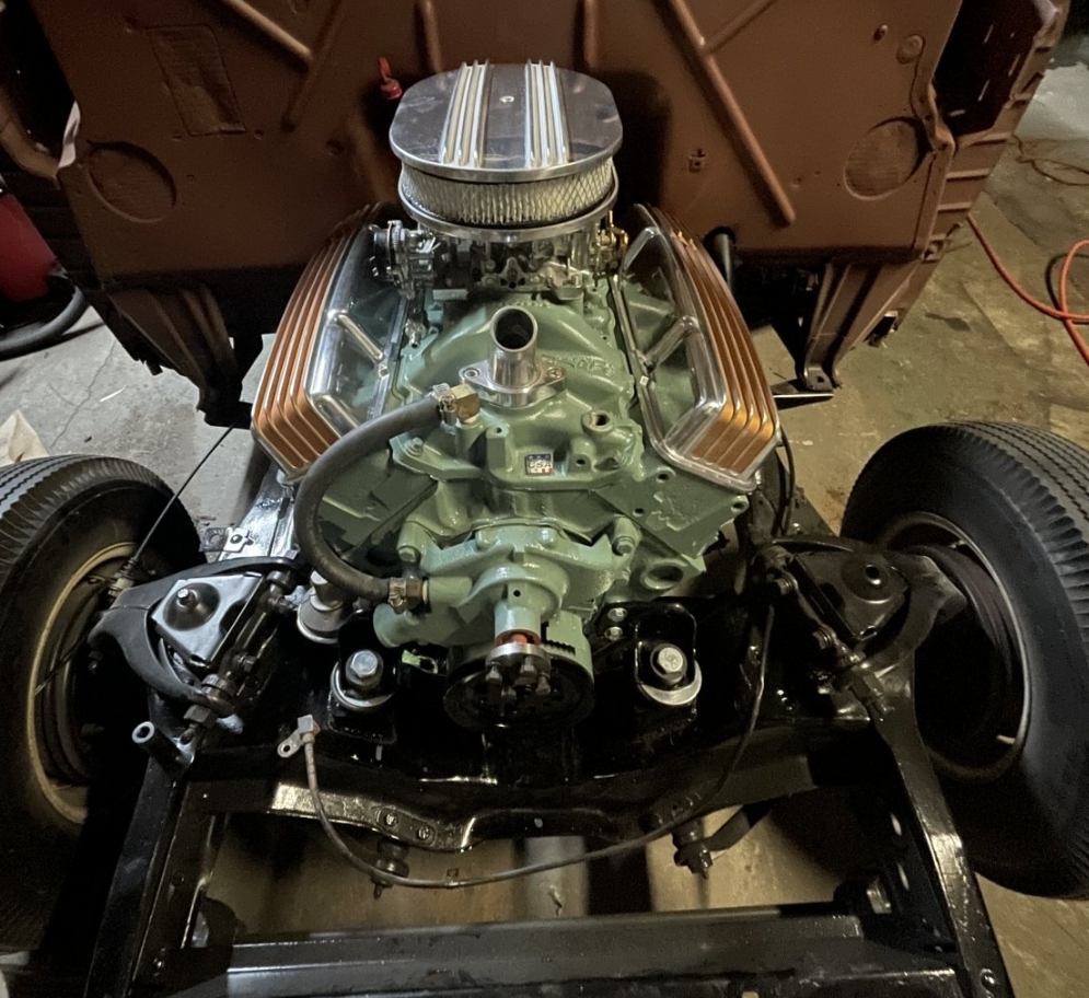

    I am aware this is a fabrication and bodywork thread. Taking a four door to a two door but I got to ask what about the engine? Tell us more. You kind of skimmed over it in the thread and videos.
    That engine color is great but what is it? Factory Kaiser color? I think I see an Edelbrock intake manifold, finned valve covers but what else? Any basic upgrades?

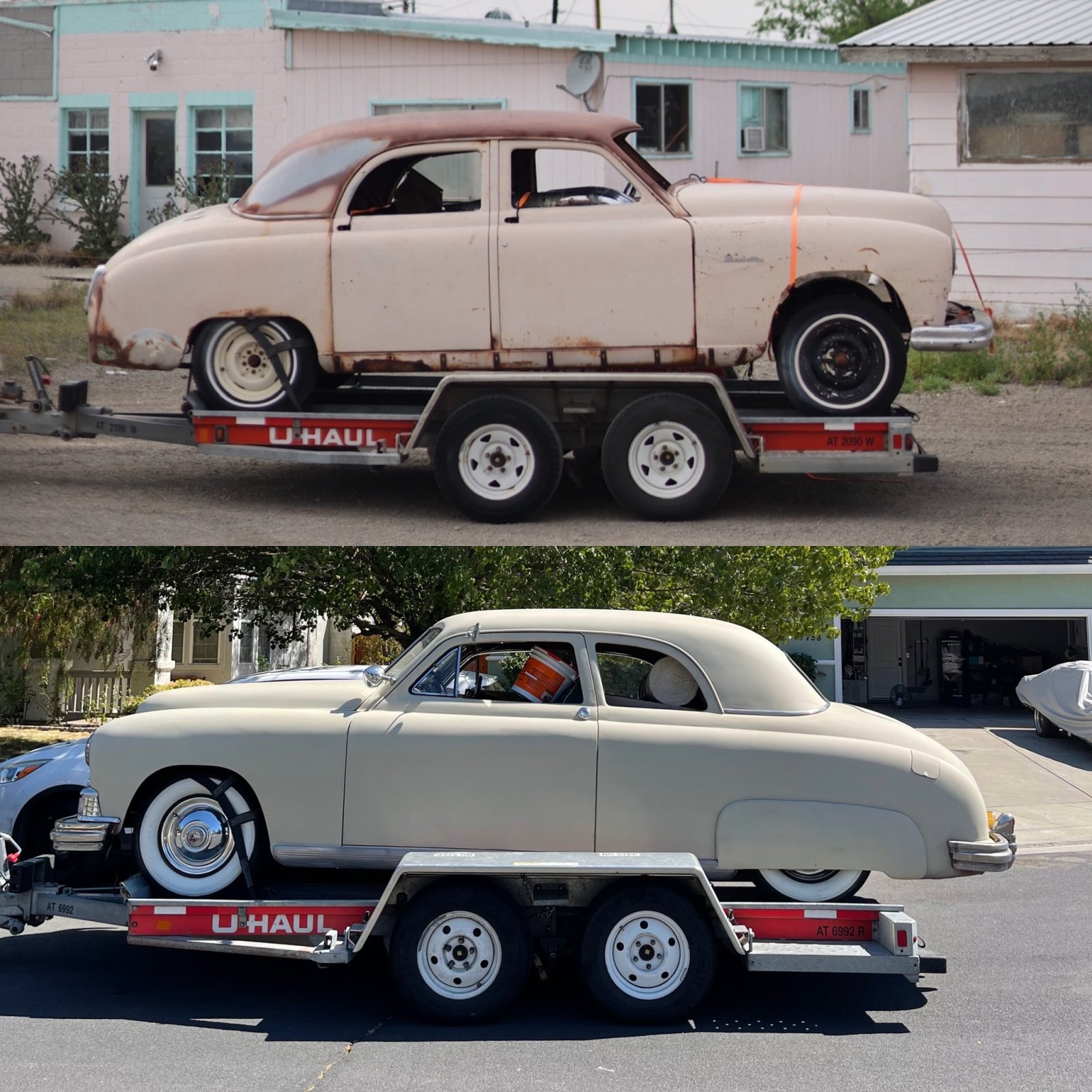

    Oh damn! How did a YEAR almost go by! Thanks to all of ya that followed this and I finally got some updates.
    I moved back to LA last year and it's been a BLAST with the car. I'll head back to where I was when we left off.

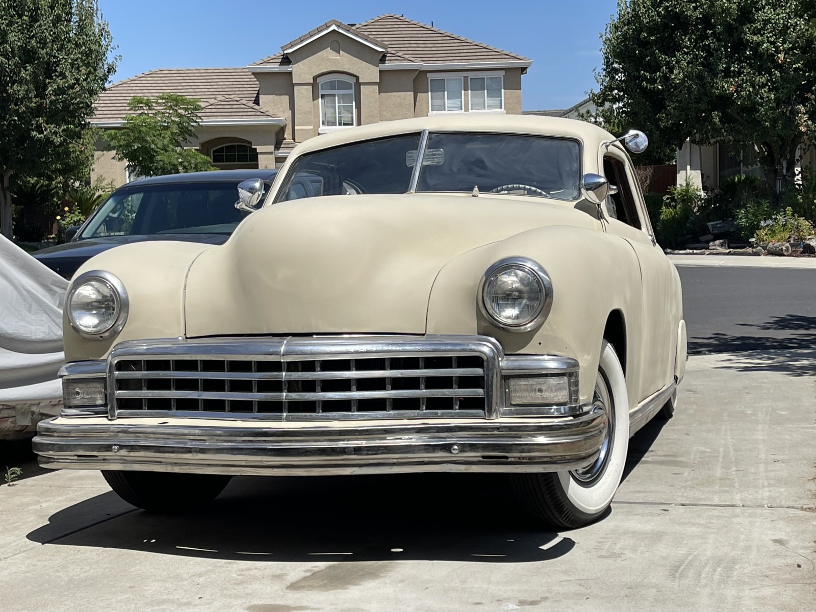

    We got her ****oned up and the gl*** in it and finally got to enjoy some driving around with her and hit some local car shows. It's my first car that I've really built: this is from the frame up from what you guys have seen, so for a guy like me with no big tools or knowledge I'm pretty stoked I was able to build a running, driving car.
    I'll be doing a series again to show you what I've been doing, but I'll pretty much show you a quick update on what I've been doing! So we got her running, lots of local gigs to try and figure out all the things I did wrong...

    As you can see, she sat SKY high... I want to say this car had alike a 9 inch or more clearance stock, so she needed to get lower... I couldn't handle it. My buddy helped me and we did a 4 inch c-notch, and popped two front coils out. Much better.
    Now that the car was at my place, it was easier to get things done. I wanted to get the cheap primer off and put an actual sealer coat on it, but before I did I wanted to get a little more done with the body. I molded the rear splash pan into the body, before we blasted it a tan filler. I actually like that it made it look kinda like when I got the car... and how you could see the stark contrast from all this hard *** work.
    I also took the front bumper, as it's three piece, and welded it all together as one and smoothed it out with no bumper guards. I might put them back on.... but I kinda like how it looks right now!
    And she's off to LA to live with me and some new adventures! Just wanted to post and update, and soon I'll have more stuff to share and more videos on the build!

    Of course! Sorry for taking a year to get back to you LOL.
    It's a 1975ish 305 and and automatic. One day I want to go fancy, but for now I wanted something solid and for the price I couldn't beat it. Other then modernizing with the intake, carb and electronic ignition, it's pretty much all stock. It's been moving the car for about a year now and I've no issues! The color was an industrial paint that many of the blocks for Kaiser and Frazer were painted, so I thought it would be perfect!

    Looks good. The 2 door sedan body is believable as a factory design, it doesn't look "converted", which is always the goal. I like the 1 piece bumper, too.

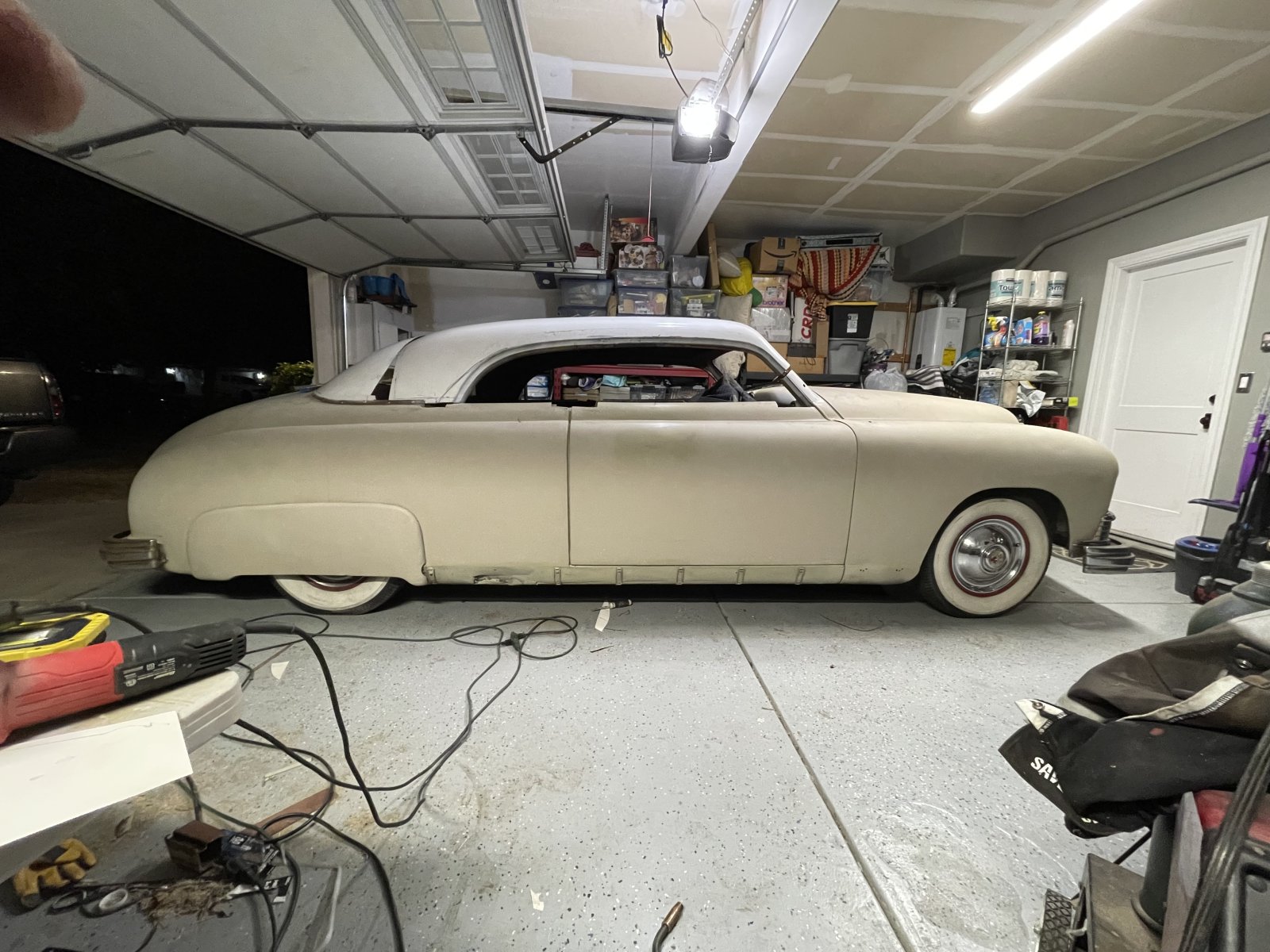

    And finally… the chop begins!
    I have been waiting for this for a year… do sllf got down with my buddy and started working on things. Been a long day, but she sits tonight with no pillars, with 2 inches out of the front and 5 out of the back..
  23. 1952henry
    Joined: Jan 8, 2006
    Posts: 1,583
    1952henry
    Looking good! Have to say that engine paint caught my eye.

    Joined: Aug 27, 2008
    Posts: 18,738
    bobss396
    Subscribed. Dare to be different! Some company had a '52 or '53 sitting outside for years, one day it was gone, likely not saved.

    Moedog07
    Wow, that's going to be a whole different car!

    Kojack
    I agree! The chop has been what I’ve waited for, I knew it would change the whole car!

    Might be a crazy idea: think about moving the rear window forward so you have less C-pillar length. Then extend the catwalk to meet the new rear window location. It would emphasize the 2 door conversion vs stock 4 door more. It can also help take some of the rear roof hump out so it flows nicer.
    Kojack likes this.
