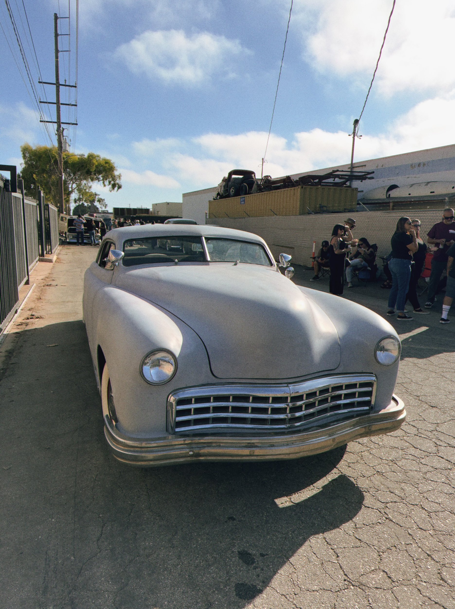

    Sure do!! I’m super excited about it. So much problem solving because I don’t do this full time, but also it’s a car I don’t even have references for. But man, does it feel like a brand new car now!
    I roughed in the sail panel to see how we are looking and I feel like the flow is looking good. I reallr hated that rear window at first, but leaned down it works really well.

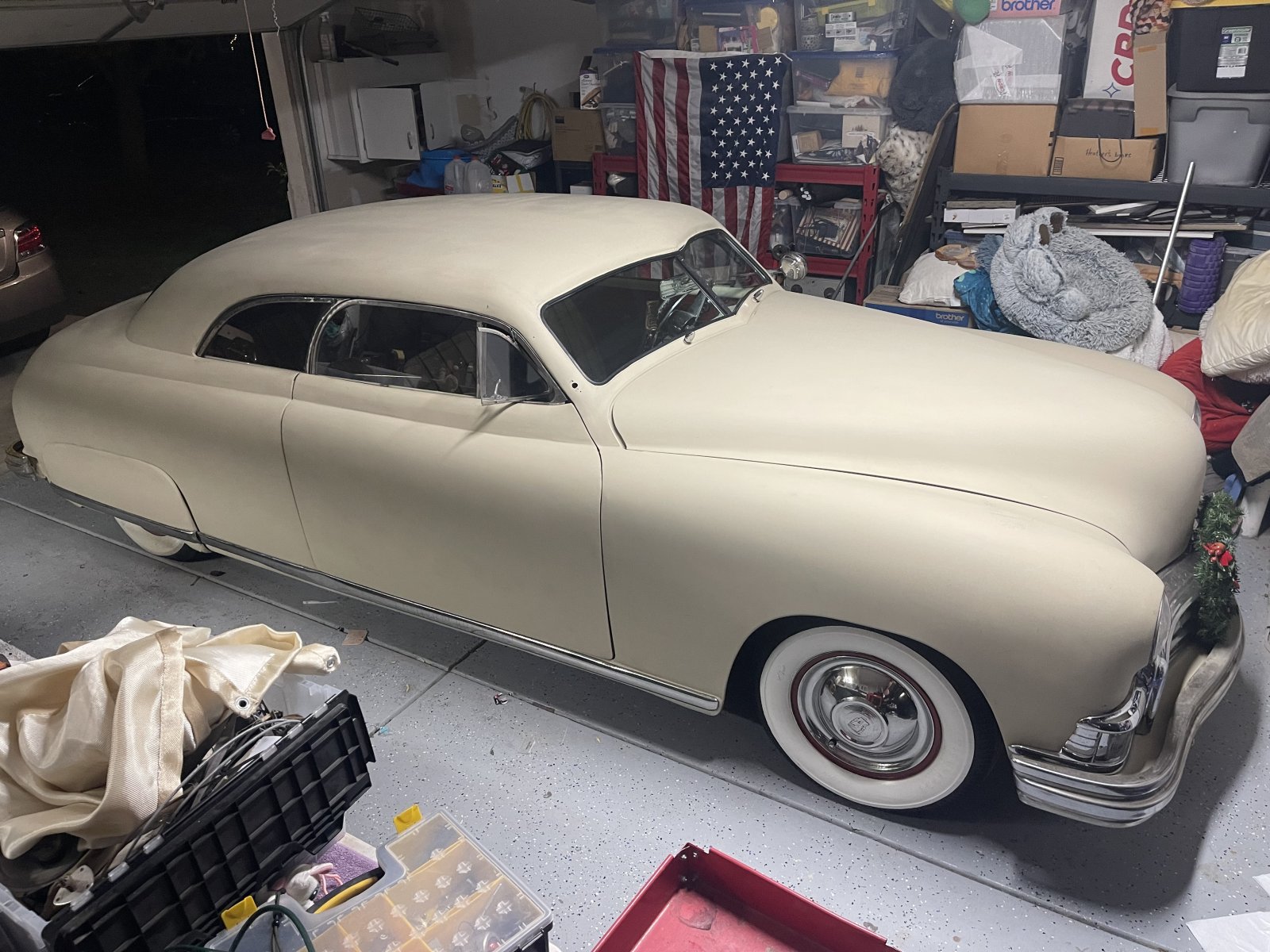

    and the hardtop conversion I’m slowly figuring out. It was a shame my parts car wasn’t savable, but there was plenty of parts I needed…

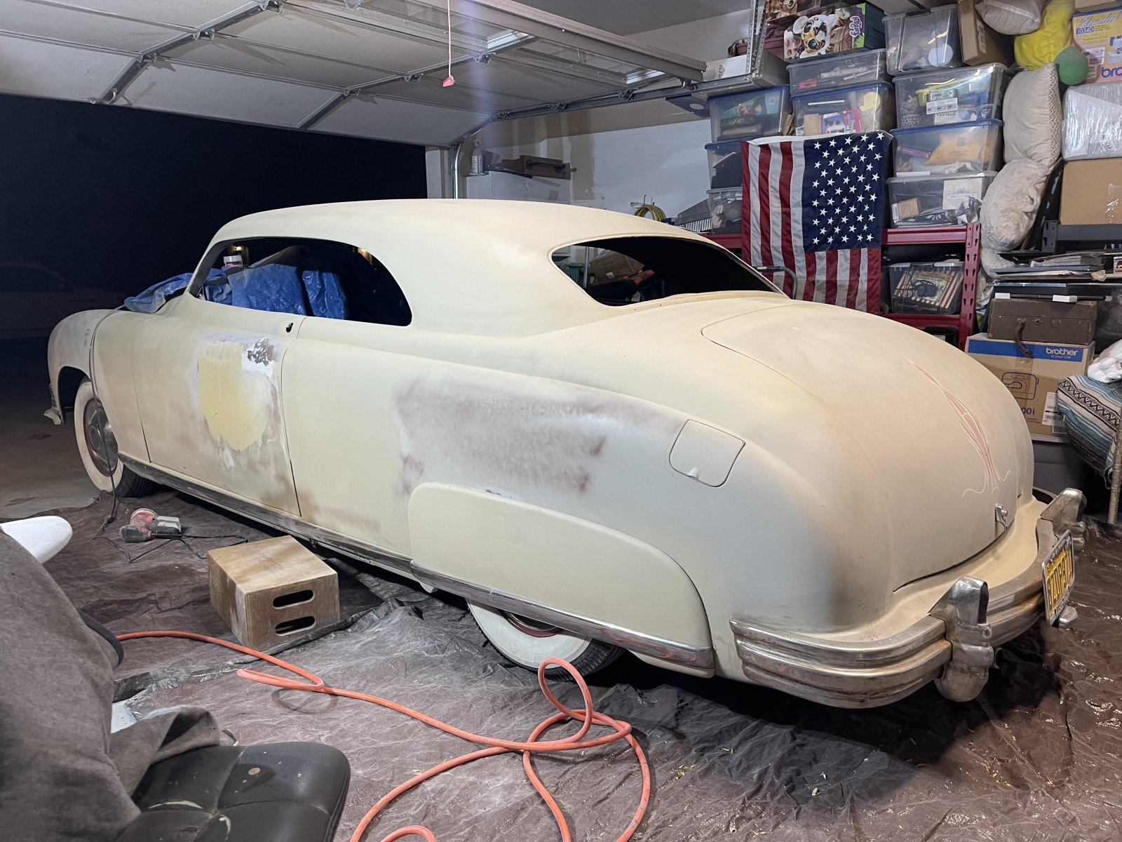

    Chipping a long! Honestly I would have been done now if it wasn’t for the the hardtop conversion! Man, it’s been hard. Lots of things to figure out… I’m gonna be happier but damn is it work! IMG_4980.jpeg IMG_4966.jpeg IMG_4927.jpeg IMG_4980.jpeg IMG_4966.jpeg IMG_4927.jpeg

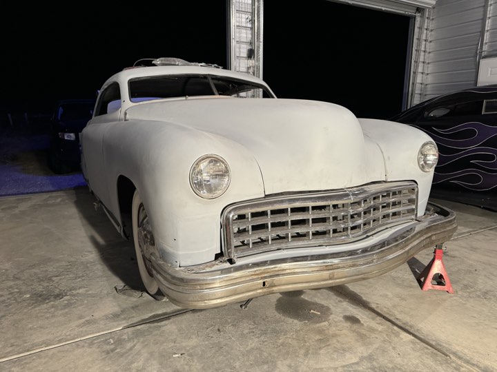

    Chipping away! I can't tell you how much work it's been to get this car straight. As you guys know, flat hides a lot so I've been able to get away with a lot for a while. But I want to get to the next part of this project so I've going to town getting this car straight as best as I can. I only have myself working on this bad buy, but I'm making it happen and I hope you guys like seeing it happen!
    It's rad to see how much different the car has come along...
    Right before I decided to do the paint, I decided to do a little work on the front. I brought the grill back 2 and a half inches, along with slicing up the splash pan and moving it back as well. Removing the side markers I felt really cleaned up the front end and smoothed things out where it feels custom, but still feels like what the car was.

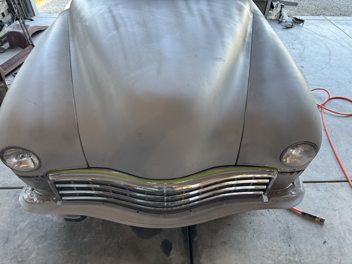

    It’s coming along! I got the whole grill together and help with my buddy Robert, we got the good pretty well lined up and working correctly with the hood latch.
    I can’t tell you how happy I am with it! I feel like it was THE touch the car needed to get it the direction I wanted… D5CE0876-ADE5-4803-991D-DA7836E6D4CB.jpeg
