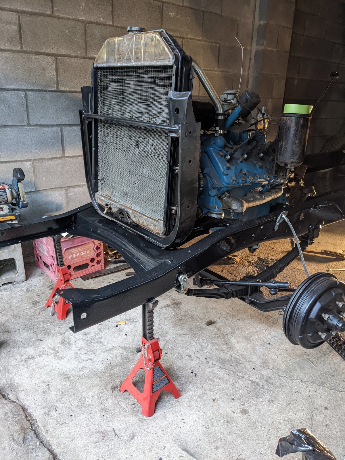

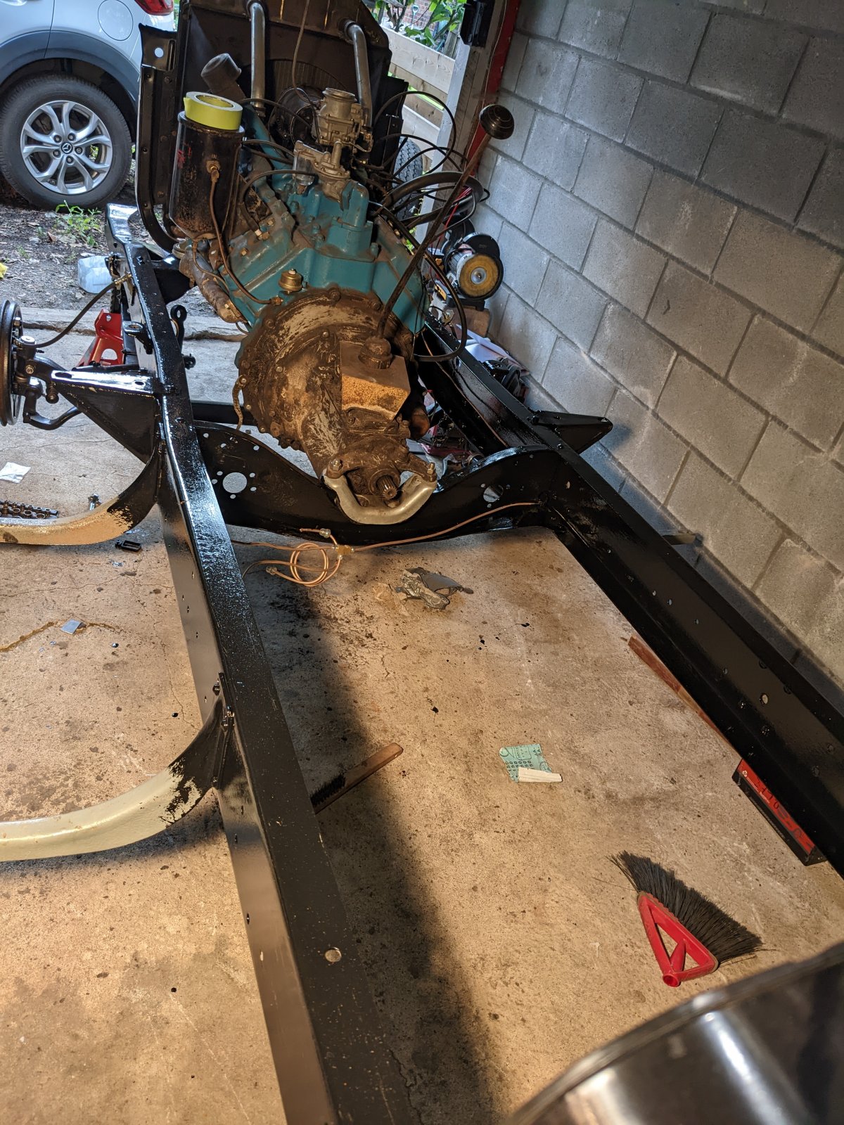

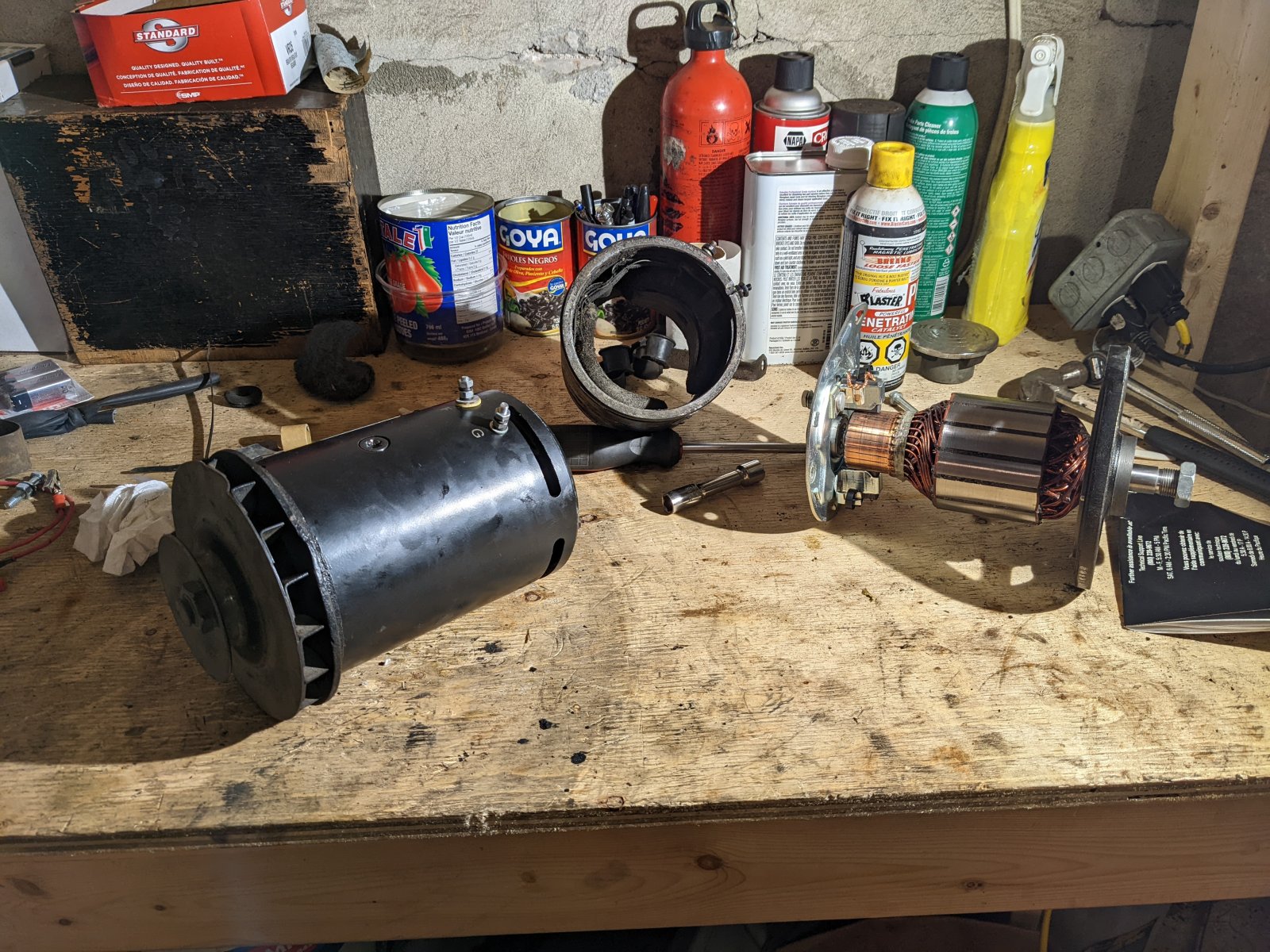

    Spent a few hours in the shop. Replaced all my rear drum brake springs. It took taking apart and putting back together the brakes five times to get both of them right. I kept messing up the brake adjuster on one side and it was hanging the parking brake up. But finally I figured it out.
    Then I pulled the 6v generator off the truck. Took it apart, And put a 12v body instead of the 6v body. The ends are the same for 6v and 12v just the coil windings are different. This was the last step in converting it to 12v!

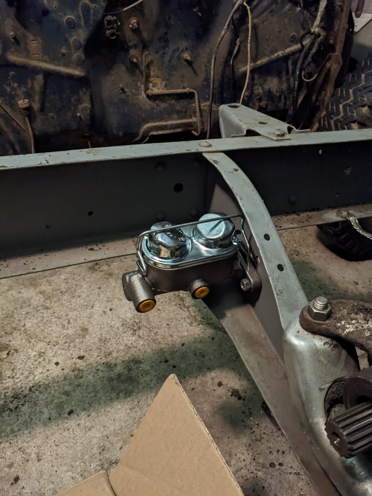

    I drilled my frame to mount a 2 pot master cylinder from a 67 mustang. The OG was a single pot master cylinder. The original mount for these is three bolt holes and this one is two. I'm not sure why folks buy an adapter plate when you can just drill the frame and it's a direct mount with plenty of meat.
    Good night in the garage. Going to replace front wheel cylinders and start plumbing in the brake system.

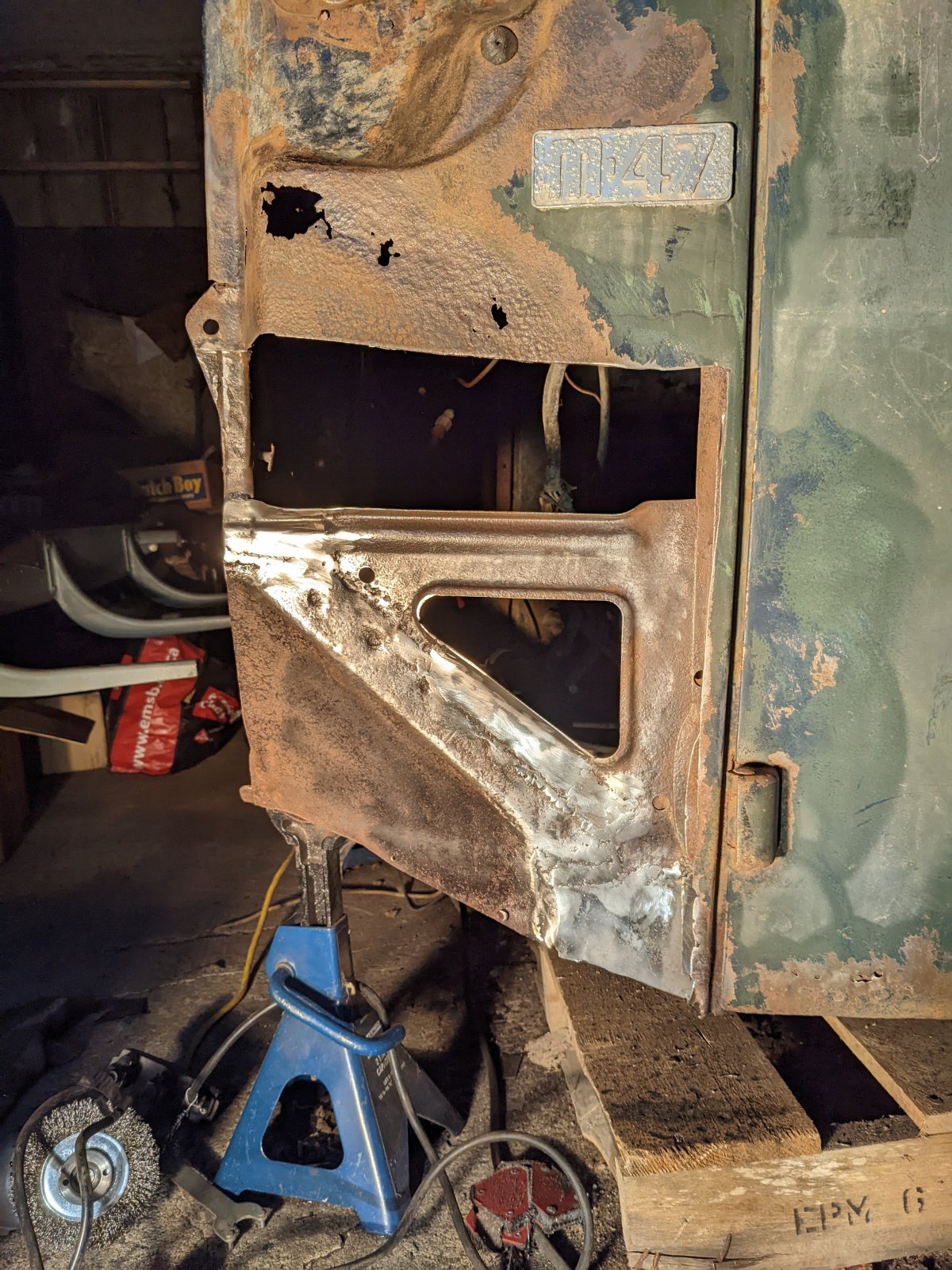

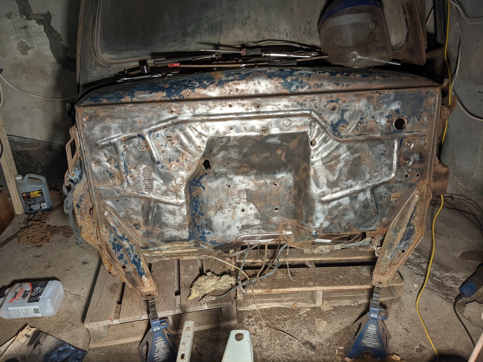

    I started to dig in on my truck cab today. I have two front cowl corners to replace so I obviously started on the one that was in the worst shape.
    I have a replacement piece that replaces the whole corner. So I cut it conservatively so I could see how the frame supports are doing. Behind the cowl isn't thaaaat bad but the bottom right at the front of the door is pretty toasted. I'm going to have to replace the rocker panel (if that's what that section is even called) that goes from about three inches behind the door hinge up to the front. Because I'll have to cut it out, I'll weld in a reinforcement bar front to back to make sure the cab doesn't bow or shift when I'm working on it. Thankfully it's just a flat piece so it won't be hard to replace once it's reinforced.
    The cowl patch actually welds to that piece I have to replace, so once I do that and fix a couple small spots on the reinforcement bracket I'll weld the cowl panel on and it'll all be good. I don't think it'll take me too long to do it all. And again, I started on the hardest/worst corner first.
    Here's where everything sits for tonight.

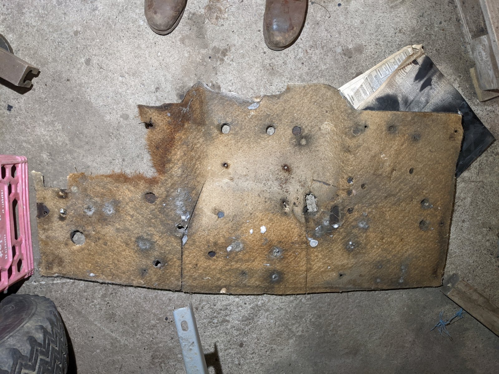

    Because I didn't have any sheet metal for patching here I went ahead and stripped down the firewall. Here's what I started with.
    After I removed everything I hit it with a wire wheel for a while to knock off everything that's loose. Looks like I'll only need to patch one small section under where the battery tray will mount.
    I also removed the original insulation, which just feels like a fire waiting to happen.
    And the other side of the firewall actually looks beautiful.
    Ive got some work ahead of me but I feel good about it.

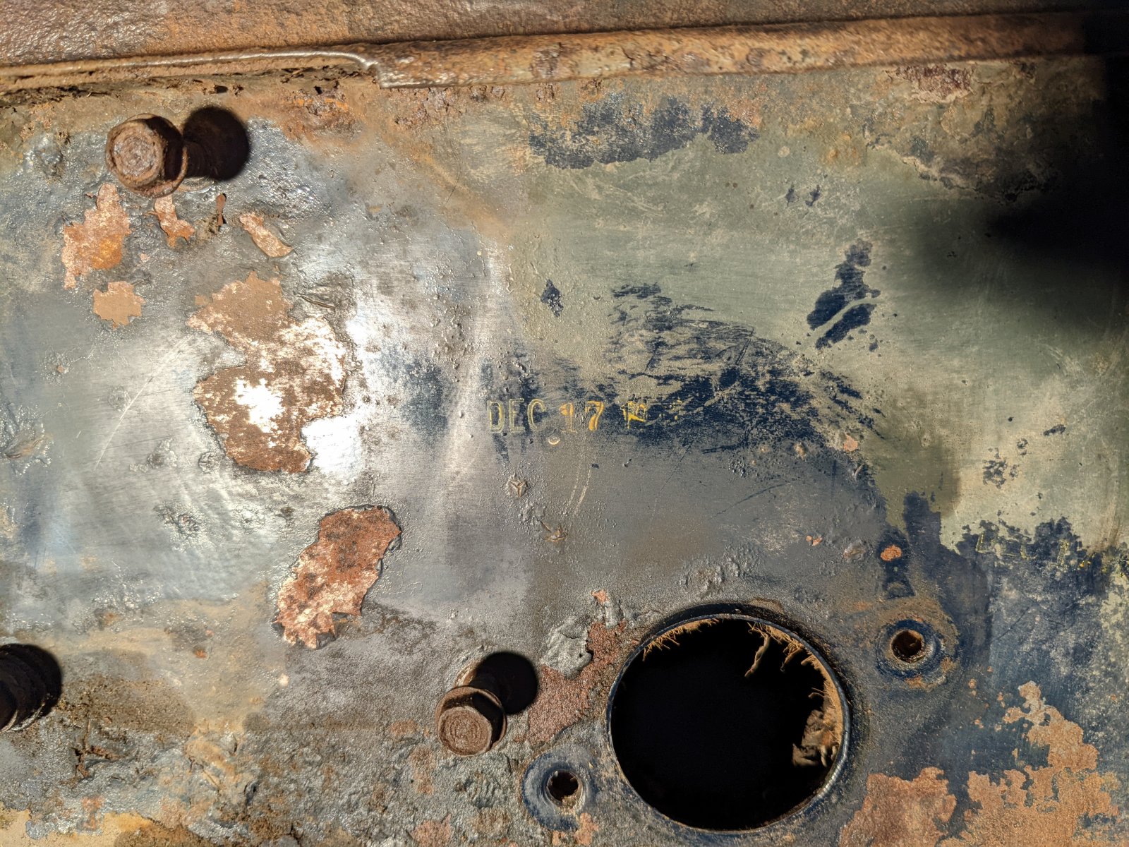

    Also while cleaning up the firewall I found the original production date stamp which was neat.

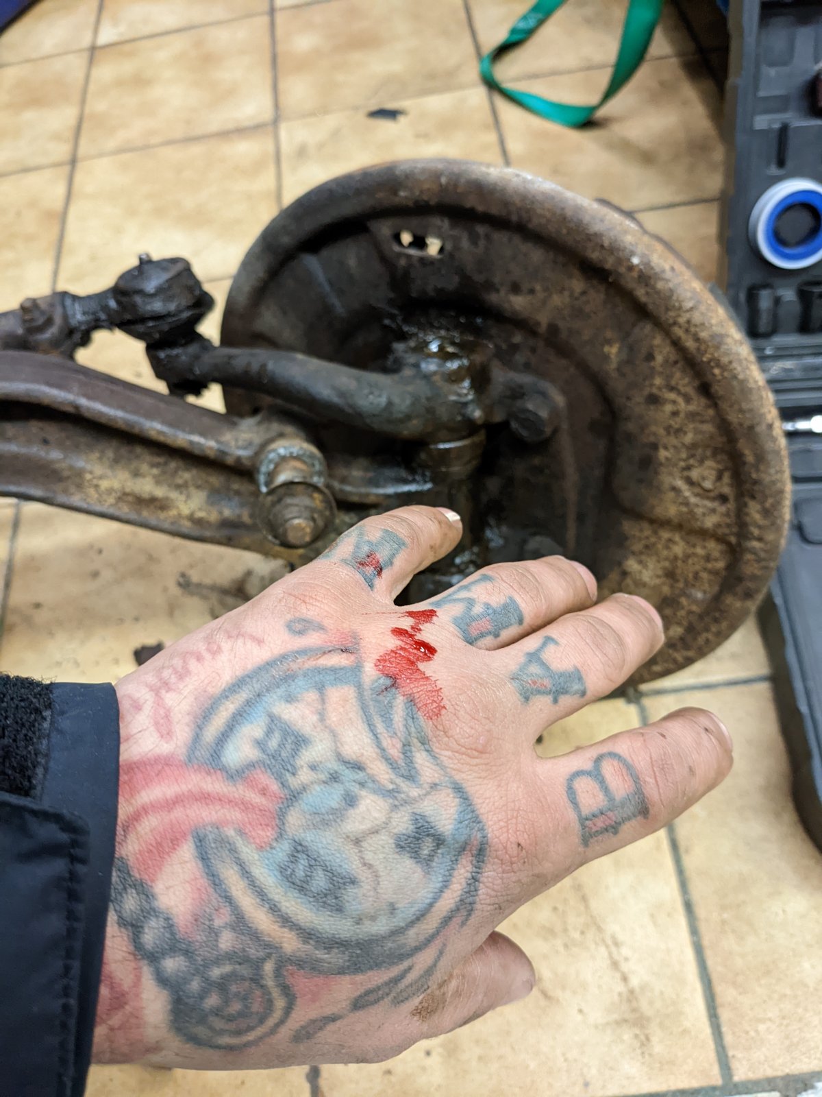

    Well we go to leave and his truck wouldn't start. He's got a 2016 raptor motor in his truck, very much a hot rod and wild. Two hours of trouble shooting in the rain we narrowed it down to ignition/key to the parking/neutral switch, or the starter, or the wires in between those three parts. We did what we could where we were and now it's sitting in front of my house so we can work on it on the curb over the next few days. His parking is underground so he couldn't get it towed to his own place.
    While waiting for the tow truck though I pulled out my 5lb sledge and a piece of 5/8 stainless bar stock and pounded out my king pins!!! Didn't take very much work at all which is a huge relief, but I definitely couldn't have done it at the other garage so the trip wasn't for nothing.
    Obligatory it isn't yours til you bleed on it picture.

    I actually think I cut my hand working on the 56.....so I think that means his truck is mine now right?!
    Stogy and Jeff Norwell like this.

    Wipe the blood on the Cab... complete the bond.

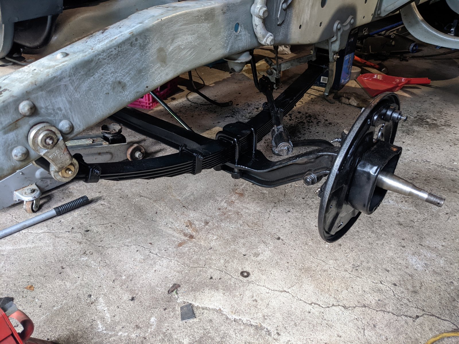

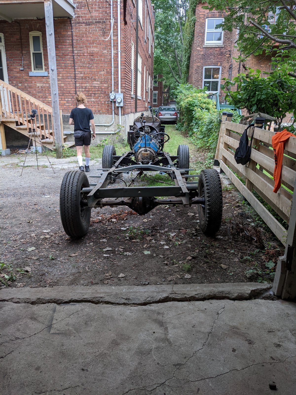

    I pulled all the front suspension, cleaned it up, painted it. Put in new king pins. I actually found a father/son machine shop that specializes in kingpins about three blocks from my motorcycle garage which was really a great find.
    Today I spent the majority of my day in the garage and put together the front end and remounted it to the truck properly!
    I'm hoping to get the cab on the frame very soon and then it's off to the races!
    Hopefully more updates soon, but here's my front axle! Frame will likely be painted in the next couple days.

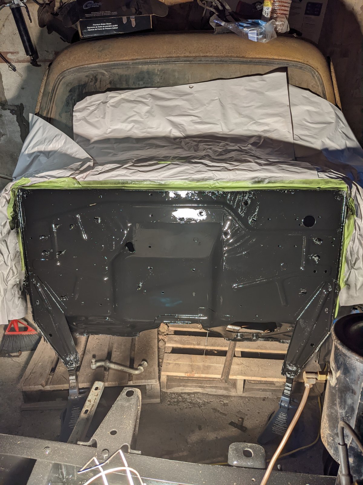

    Also painted the firewall!

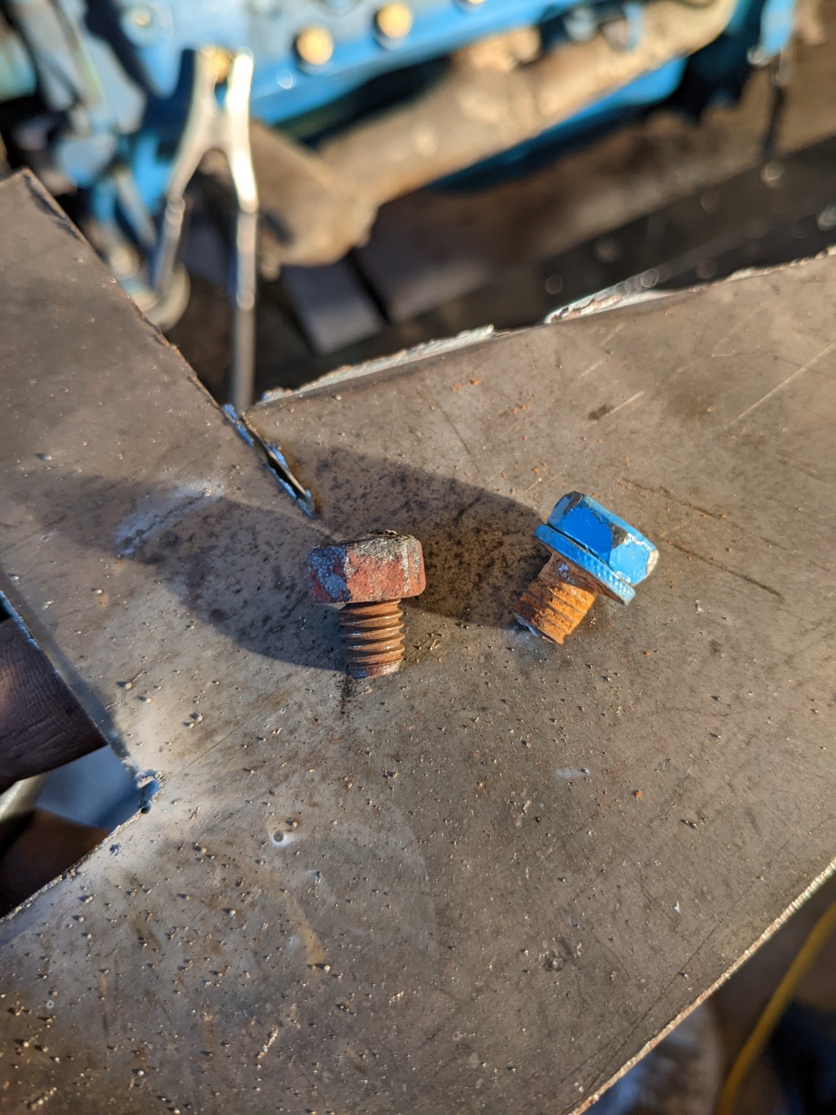

    Also the entire front end is rebuilt with all new bushings, kingpins, and tie rod ends and is back together and ready to have the wheels thrown back on!
    Pulled the thermostat housings three of the four bolts sheared off and I had to weld a nut on to the little bit sticking out to get the rest out. Thankfully that worked.
    Here's the two halves of one of the bolts.
    I'm likely gonna pull the water pumps to make sure I don't have the same problem with those bolts in a controlled location instead of on the side of the road.

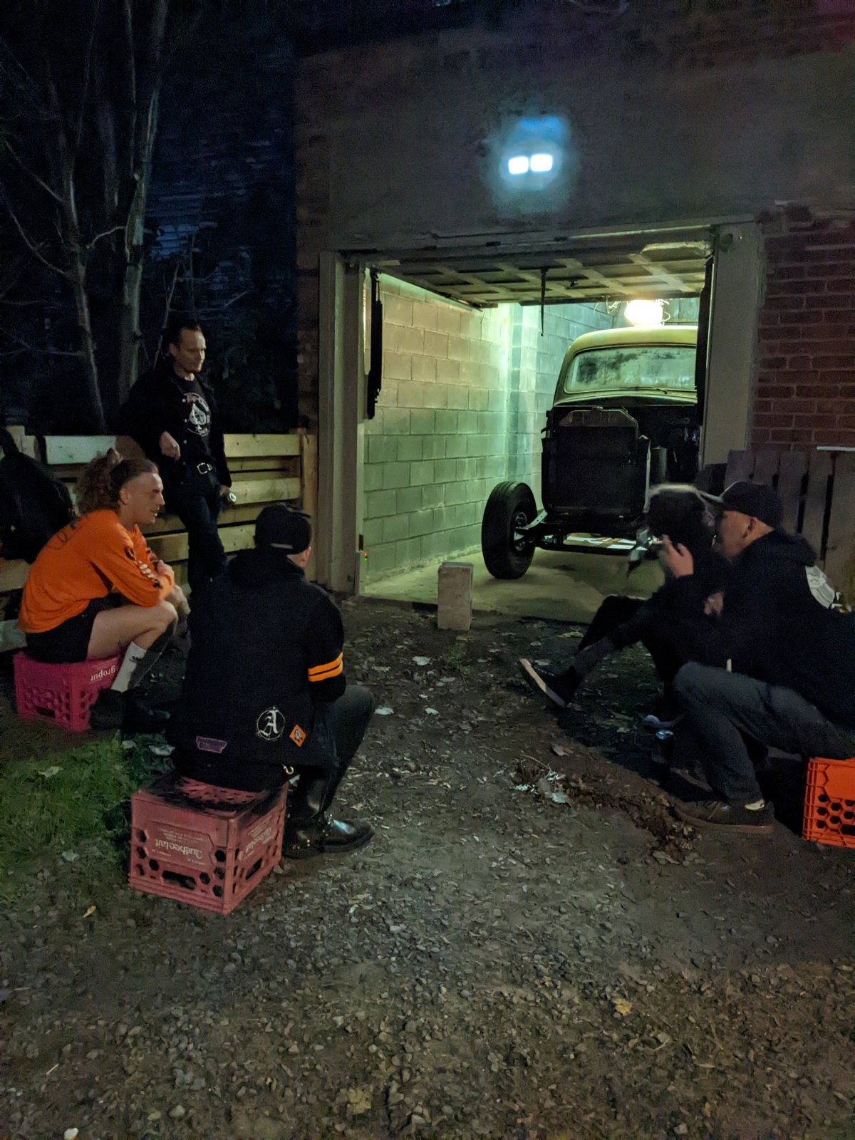

    Huge day for me!
    I took the week off work, got **** done on the truck, went camping, came back...and PUT THE CAB ON THE FRAME!
    I asked for help and seven buds showed up and it took 22 minutes to put the cab on and crack open beers.

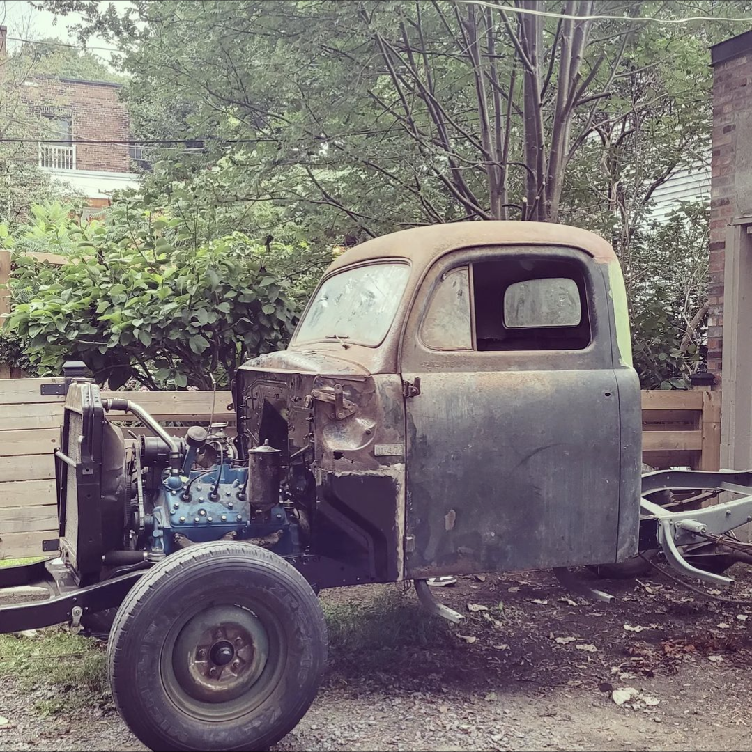

    A friend filmed it with my camera so there will be a YouTube video in the near future, but here's the three pics I took and four from a friend that was there helping.
    I AM SO EXCITED!
    It feels like a real attainable project now and not just piles of metal around a garage.
    PXL_20220826_214618268.jpg PXL_20220826_232528811.jpg PXL_20220827_001758068.jpg Screenshot_20220827-000926.png Screenshot_20220827-000903.png Screenshot_20220827-000943.png Screenshot_20220827-001021.png

    It was REALLY REALLY hard not to tell everyone to leave so I could immediately start working on the truck.
    My work is a five minute ride from the garage so I am likely gonna shift my days around for the next month so I can spend a few hours after work in the garage before getting home for dinner.
    Having the cab on has really lit a fire under my ***.
