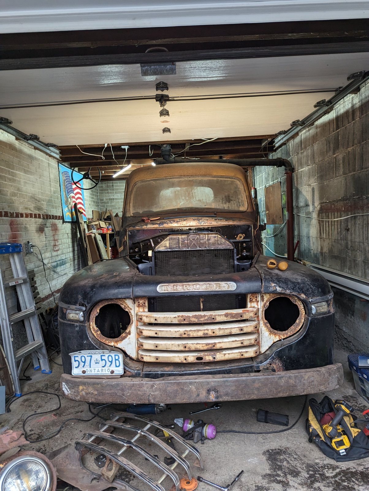

    Had a minor "what the fuck have I gotten myself into" moment with the truck today. The first one, somehow. Then a friend showed up and we very loosely hung the front clip on. I don't think I'll be able to get that reinforced enough for it to drive on Saturday, BUT I do think I will be able to reinforce and replace the rotten parts enough to not have to buy a ton of expensive and almost nonexistent body panels.
    I'm going to pivot my focus tomorrow to brakes, clutch, and steering. I do think I can get it sorted enough to move under its own power but without the whole front clip. the show I wanna get it to is only four blocks away so I think I can avoid cops for four blocks....
    Anyways here's the front end very loosely hung. The drivers side inner fender is totally roached so I'll have to replace a bit of that, or just save my energy and buy one since those are actually available. I also don't have either of the front fender braces.
