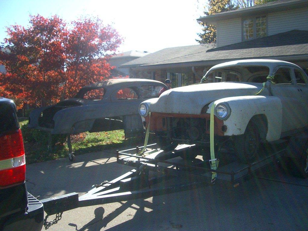

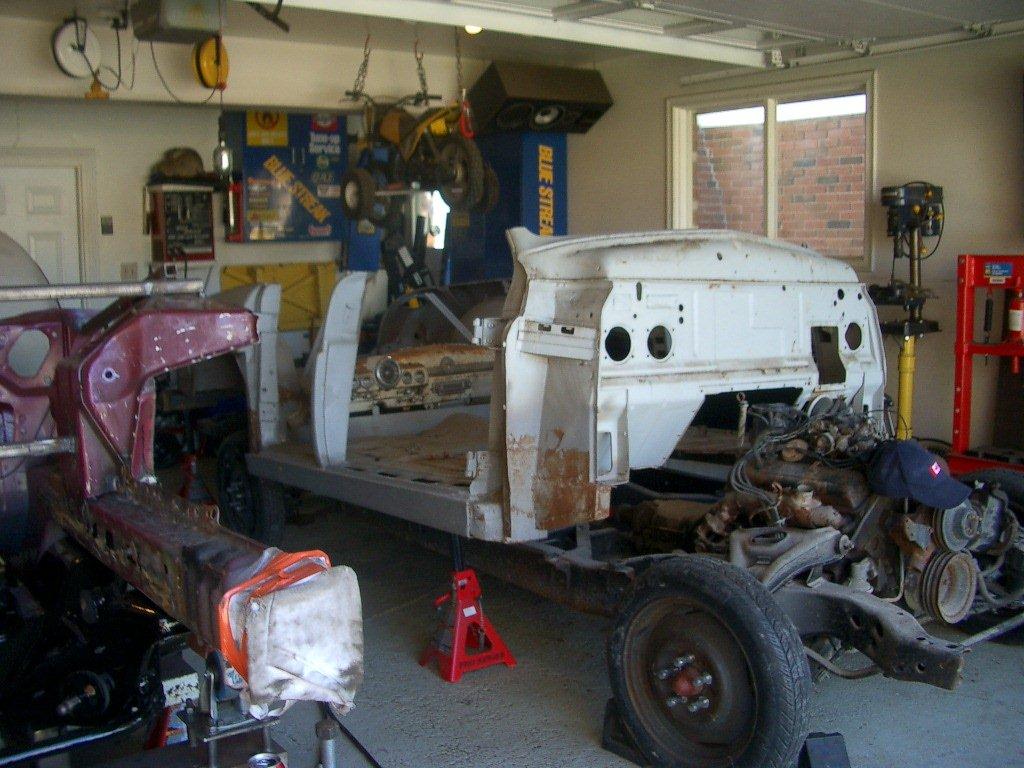

    More pictures to come of the 51 Merc snuggled in the garage ready for surgery and donation to the 49 Merc (maybe), but thought I would post these quickly. This is from the return trip of our family March Break vacay. I finally met up with Ether and some of his buddies. What a great bunch of guys!!!!!!! Ether is a true molten metal manipulator, a sheetmetal surgeon and master mechanical dude. You could not come across a better guy. Ether's Merc is amazing, the thing fires up and rolls like it came off the line like that, the quality and amount of custom work is just staggering. I could have spent a week in his garage trying to take it all in (not to mention all the customer's cars). Again, Chad thanks for the 51 Merc, all the help and mounds of info. Well, back to work! Regards, Rhys.
      160.1 KB
      247
      170.2 KB
      279
      141.1 KB
      305
  5. Glad you made it home and through customs!!!! It was good meeting you and your family. The pleasure was all mine. Now lets see some build pics!! Back to work!

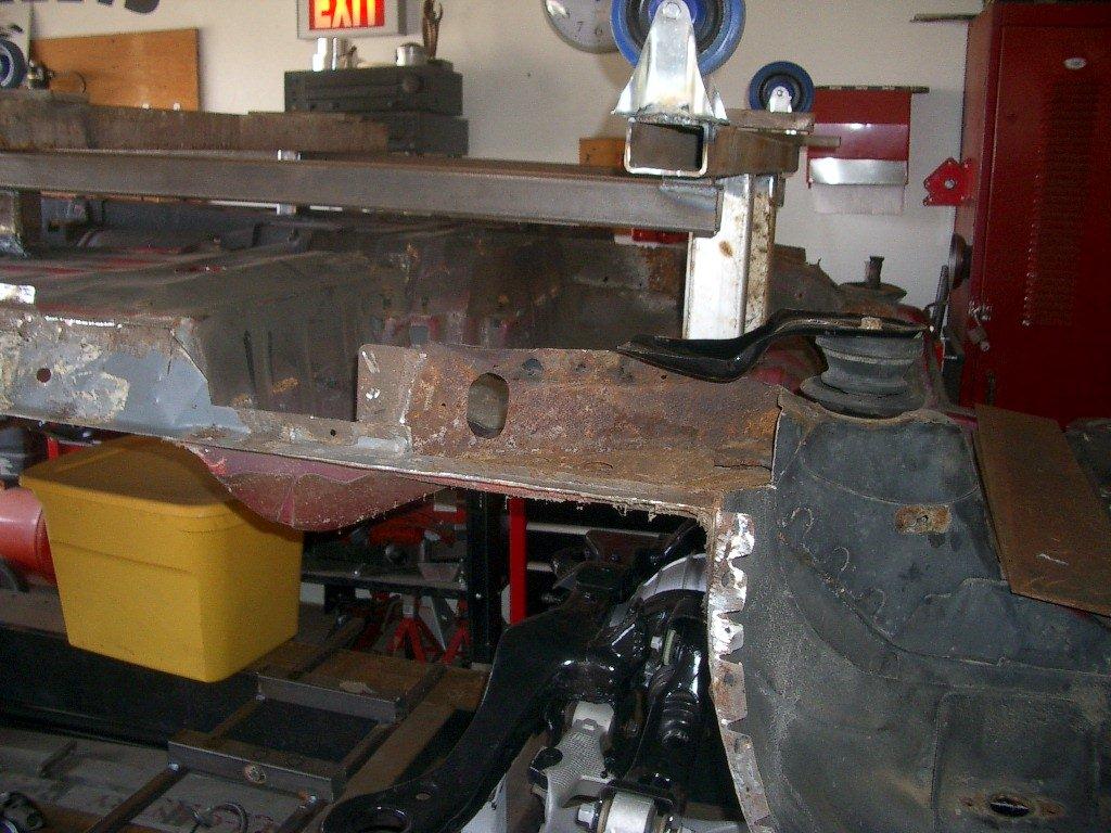

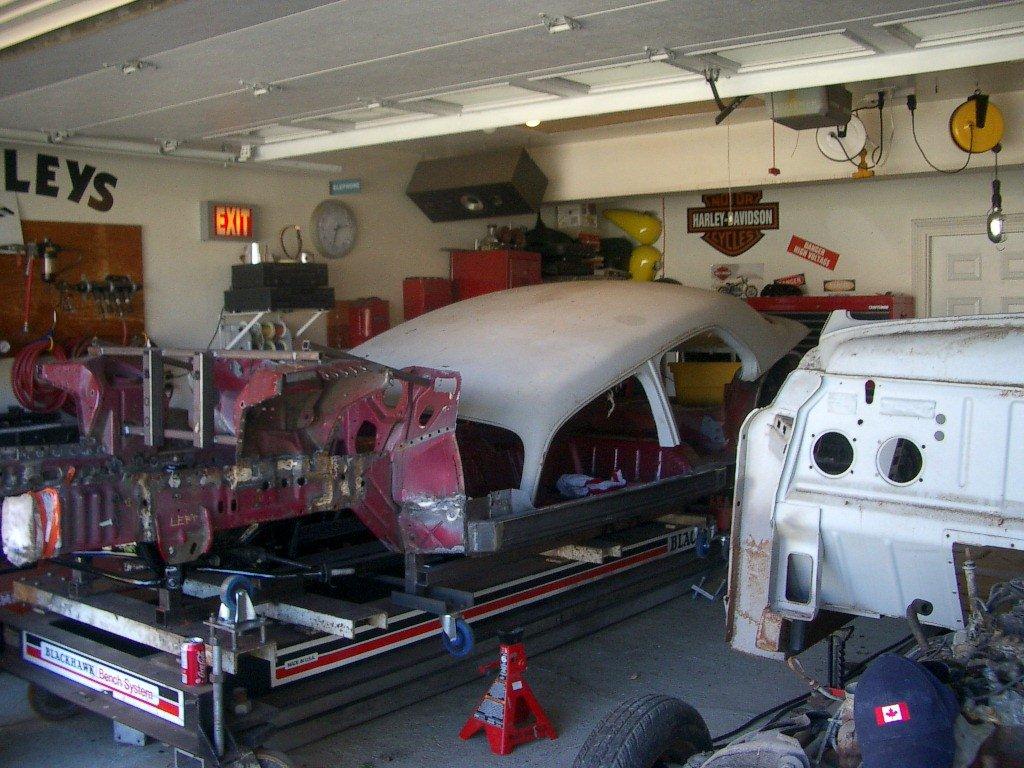

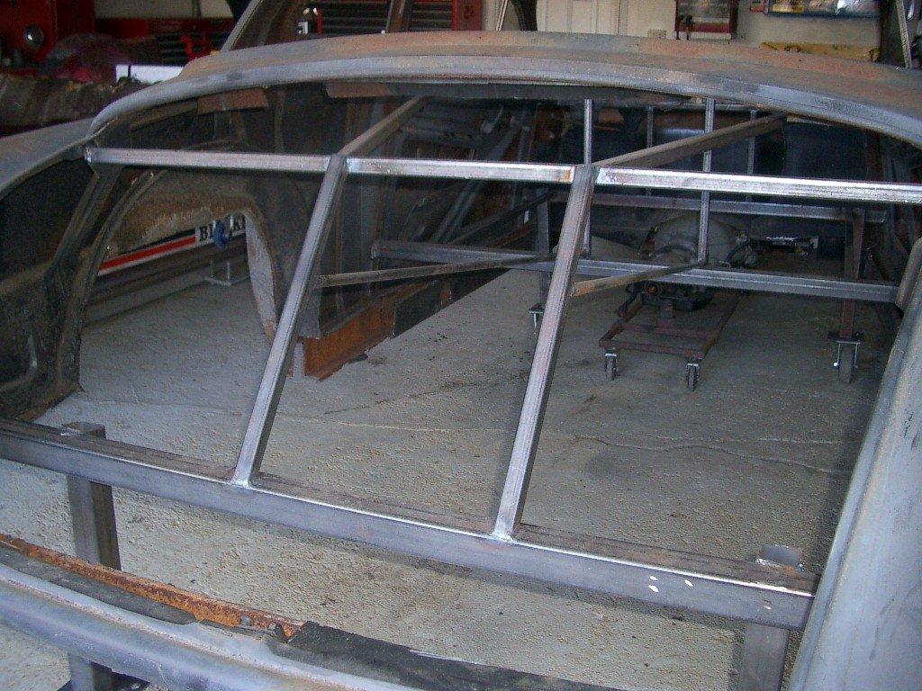

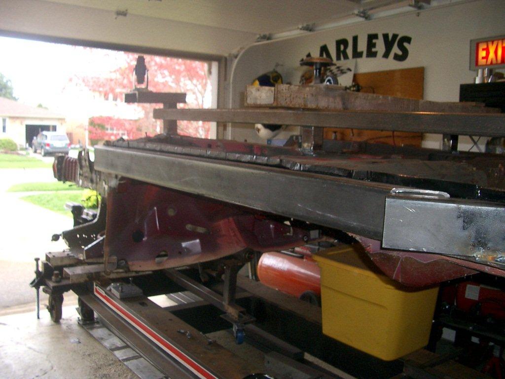

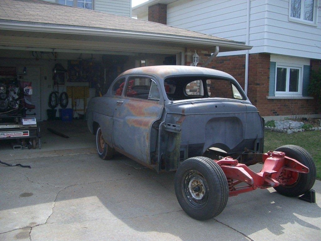

    First day off of work in two weeks here so I am falling behind (It never pays to take a week off, you can never catch up). Spent the day in the garage working on the perimeter frame. Had to cut out the Canadian winter rot and build out. Picture of the Merc in its new spot, pretty tight in there. Regards, Rhys.

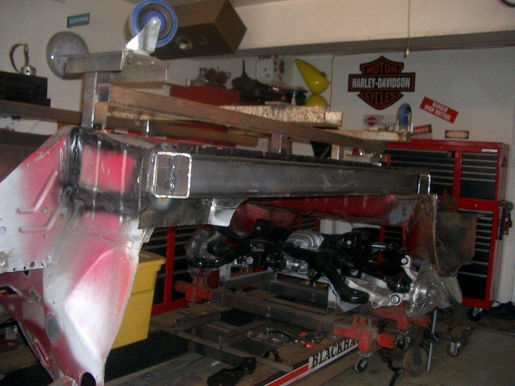

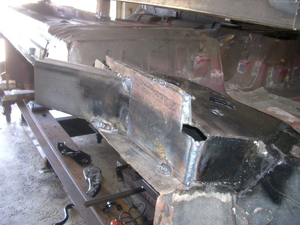

    Still working on the perimeter frame. Just fabing in the tie points to the subframe sections. Hope to finish this in the next few weeks and then begin with mounting the Merc bodies. I have decided to section in about 8" down the centre of the two door from the four door to accomodate track width, etc.. regards, Rhys.

    Man thats a lot of work, more than I would want. Good luck to you, it looks as you know what your doing. I will be watching this build.
  9. James D
    Joined: Feb 8, 2007
    Posts: 4,977
    James D
    You´re planning on widening the Merc? Ewww.... Please don´t!
  10. chopt49
    Joined: Jul 5, 2006
    Posts: 949
    chopt49
    was all on board until you mentioned widening the body!!! please no!
  11. UnIOnViLLEHauNT
    Joined: Jun 22, 2004
    Posts: 4,827
    UnIOnViLLEHauNT
    Adding 8" to the center of the Merc? Man that seems like a lot of work and the end result of a goofy looking Mercury to make what you have work. There was a guy in Australia or something, Mercules I think the car was, added in a bunch in the middle. Car looked terrible. Great work, but goofy.
  12. Frosty21
    Joined: Jan 25, 2007
    Posts: 960
    Frosty21
    from KY
    Yeah, please do not widen that car. It will look awful and you will need custom gl*** ($$$$). Not to mention the work involved in widening it and it not warping, or collapsing on itself, or the doors not closing, or just closing enough to rattle and fall open. Widening the dash, tunnel, package tray, trunk lid, trunk floor, bumpers, hood, firewall, valence pan, etc. is a helluva lot of work.
    I done a '54 F-100 cab onto a S-10 firewall and floor pan. Never again would I try to convert a modern floor into a vintage vehicle. And it was a truck, there was no back seat or trunk area to speak of. I'm still fixing things on it 2 years later, I could've clipped it and been driving it in 1/2 the time and 1/2 the money, even though it was intially cheaper to do the ch***is swap.
  13. 19Fordy
    Joined: May 17, 2003
    Posts: 8,365
    19Fordy
    "I have decided to section in about 8" down the centre of the two door from the four door to accomodate track width, etc.. regards, Rhys."
    It would be easier to widen just the front and rear fenders. Do it (to scale) on a computer to see how it would look.
  14. Please don't widen the Mercury body. Please.
  15. BuilderRhys
    Joined: Sep 16, 2007
    Posts: 128
    BuilderRhys
    Well, alrighty then! No sectioning of the body. I will have to come up with some more creative ideas to get things to fit. I have a month or so before I get to those issues. If anyone comes across these poor section jobs can you post? Thanks for the comments and advice, regards, Rhys.

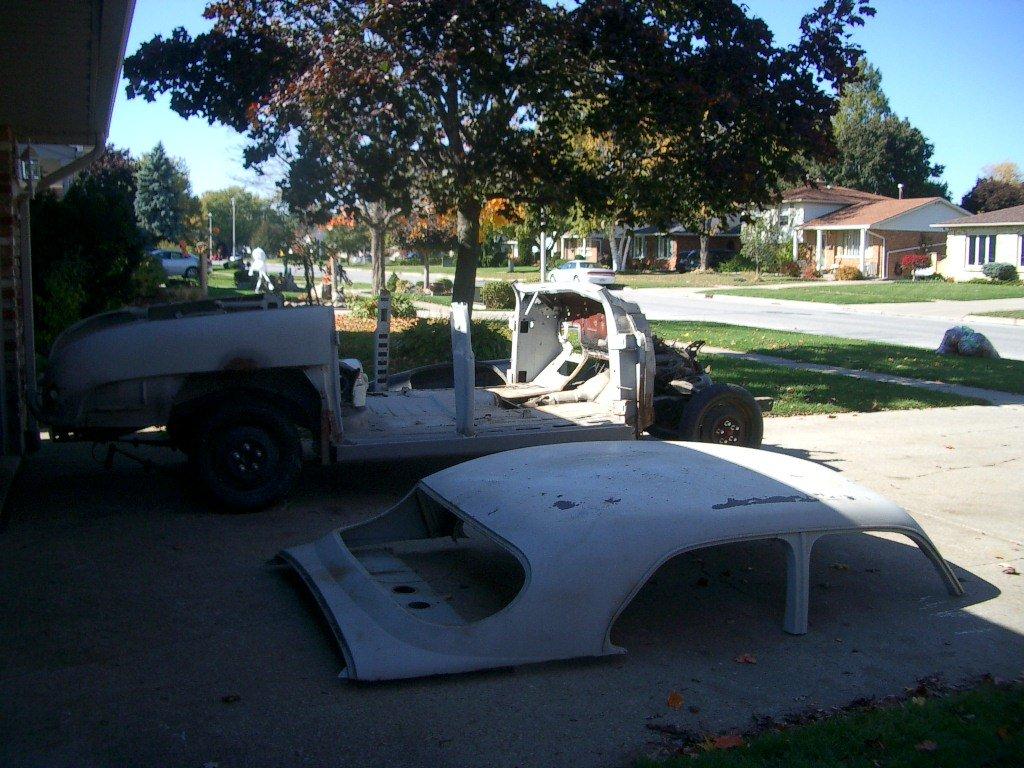

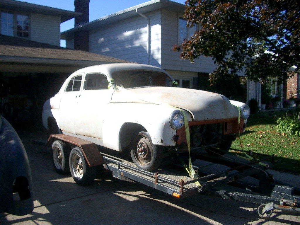

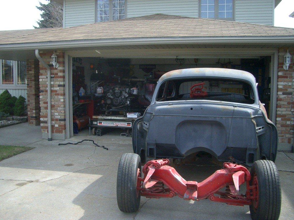

    Still working away. Summer is short here in Ontario and there were toys to enjoy. Fall has hit so back at'er. Regards, Rhys.

    Finished off preparing the shell for soda blasting today. It will go out next week to "Enviro Surface Technologies", a new company in town. He charges $625.00 complete (all sheet metal bits and pieces you can jam in your roller, hoods, deck lids, dash, inner fenders, etc... all included in the price) picked up from your home and delivered back. Seems like a good deal? Regards, Rhys.

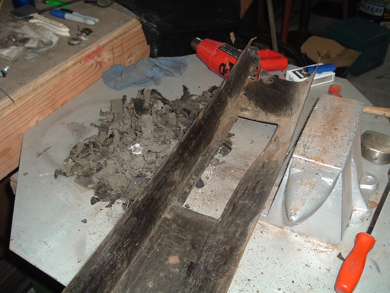

    Hopefully my reply helped you in some way:). As far as the undercoating....Well,a heat gun and a s****er will be your best friend. My whole car was coated from end to end,and under the hood. 14 shopping bags full.Really! Get off what you can,'cause if it has to get blasted off,it's just more pressure=heat=time=$.Pick the spots that are notorious on our cars and start there,it will give you an idea....Looks like you've got things pretty much dis***embled so you can see things.Blasting takes a while with undercoating,so be preparred!

    I spent alot of time with a heat gun and s****er removing all the tar-like undercoating on my 50 Merc. Better to remove the majority of it then spend the time and possible damage from an inexperienced blaster trying to remove it.

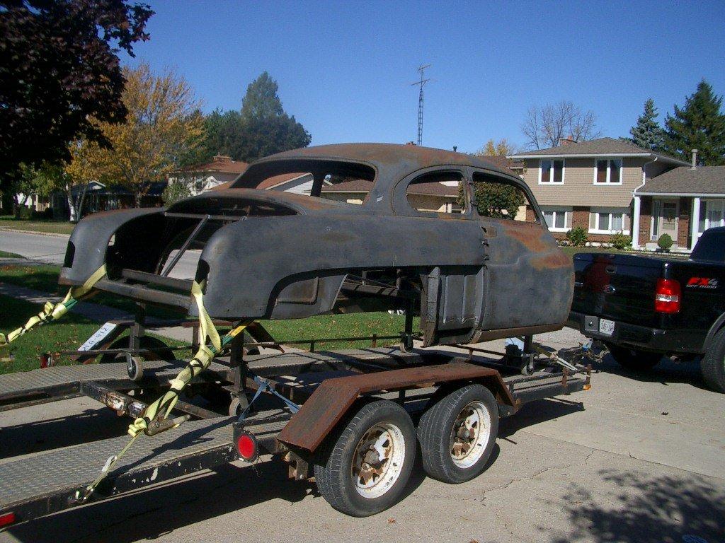

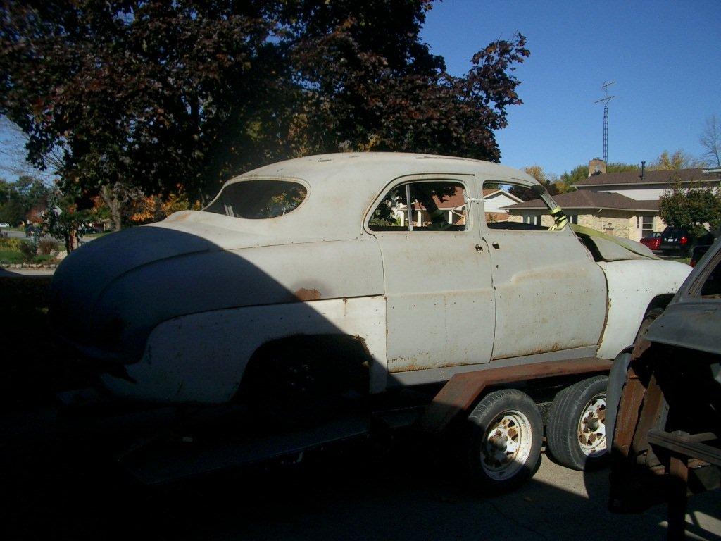

    Not much to speak of this week. Two door out for SAND Blast with a good, experienced friend of mine. Four door back home for the first time in a year or two. Ready to begin "cutting and chopping". Regards, Rhys.

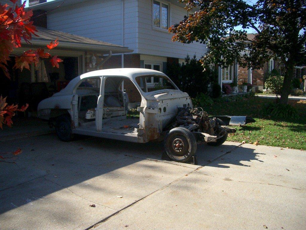

    Pulled the four door apart today. Frame went to a new home. I will spend the next week surgically removing ever bit and piece from the shell. I spent the last hour looking at Chad's (Ether's) CD he gave me on "Area 51" with all the work I have ahead of me. It hurt my head. Regards, Rhys.
