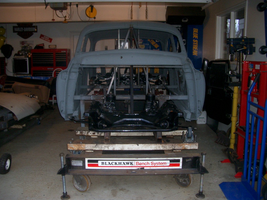

    Welding it back together
  7. Rhys, Glad to see you are at it again!!!! This is going to be one unique build and I appreciate you taking the time to take the pics and posting!!!! The top is going to be fun. There is alot of welding going across a fairly flat area. Warpage will be your biggest challenge and I bet you pull it off. Keep us posted!!!!!

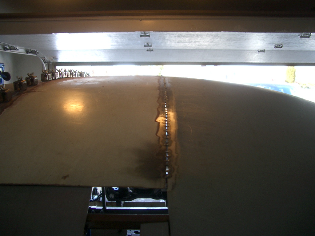

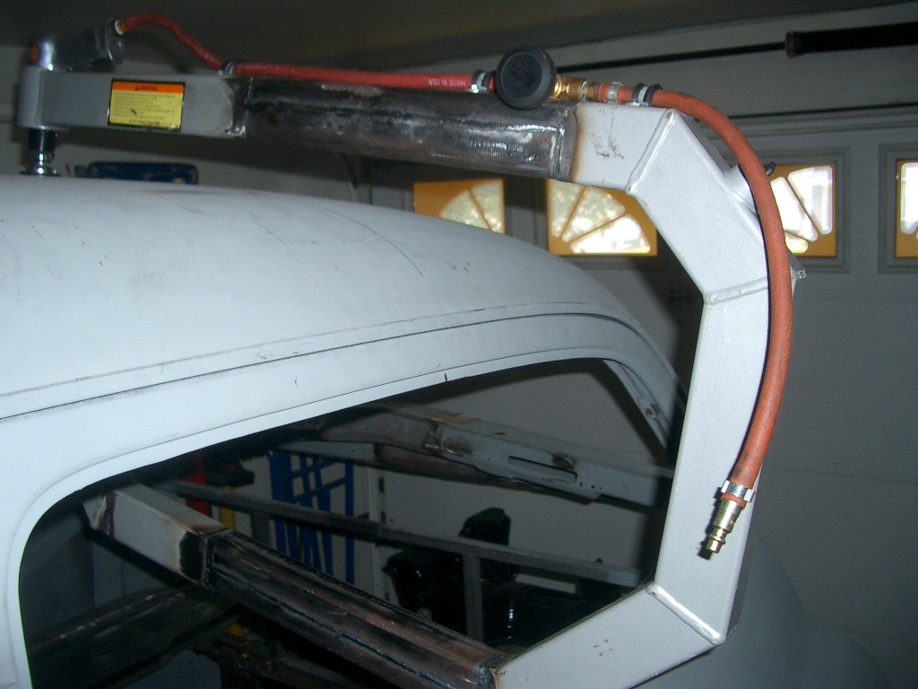

    Cowl section tacked and dollied in. I will hit the roof section next with a flurry of clecos and then on with the tig torch. Regards, Rhys.

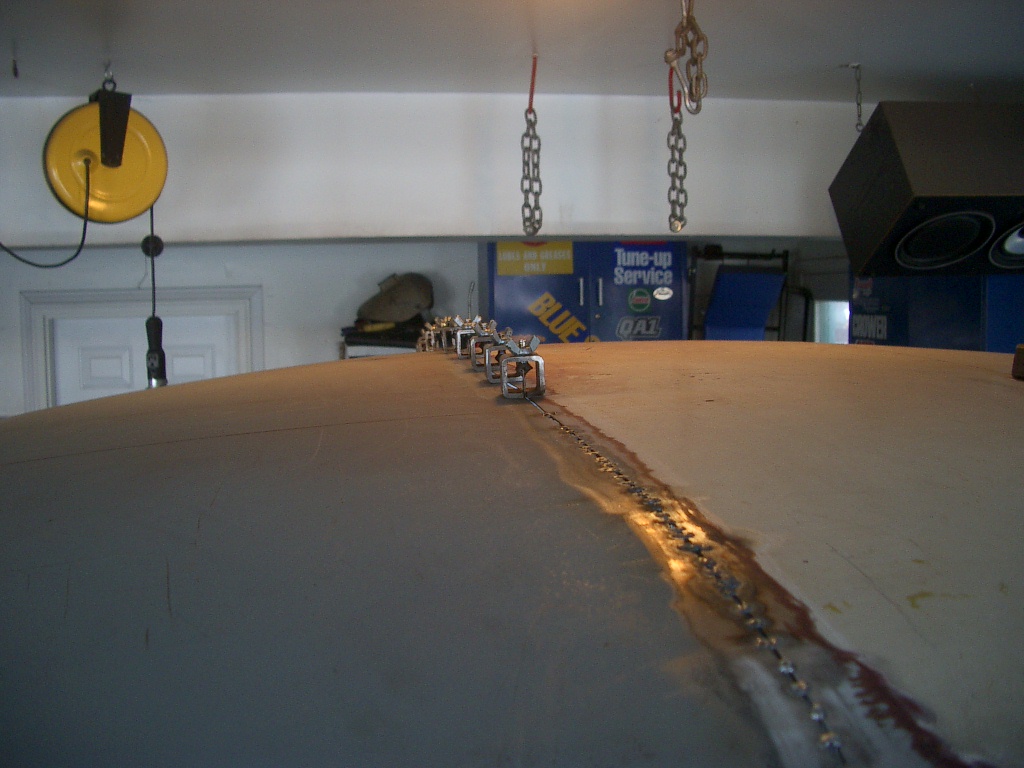

  14. BuilderRhys
    Joined: Sep 16, 2007
    Posts: 128
    BuilderRhys

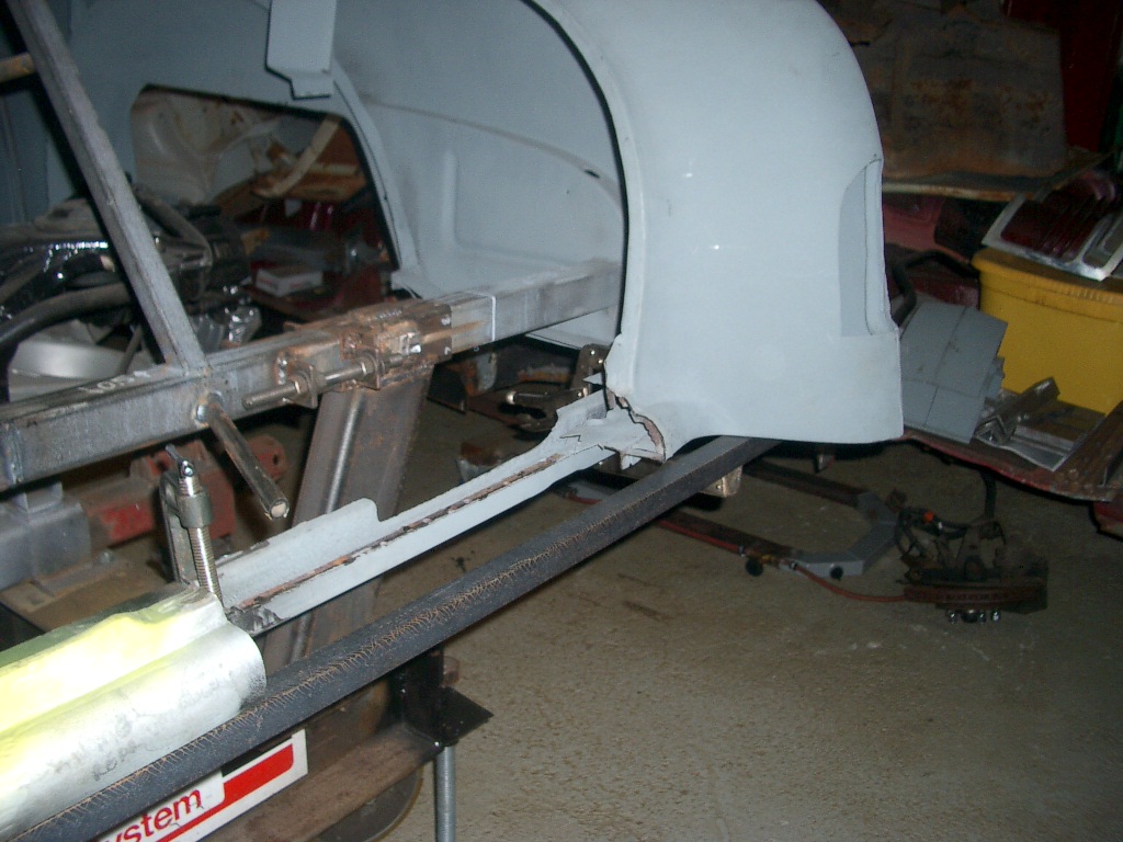

    I managed to get half of the roof section welded in today. It went smooth. I also picked up my new inner rockers from Michael Dundon (Green Mountain) and I hope to move into installing those next. I would like to move into a new body hammer and set of dollies. I have my eye on a Snap On BF603 but holy snappin ***holes they are pricey. What are most people using out there!!!!!

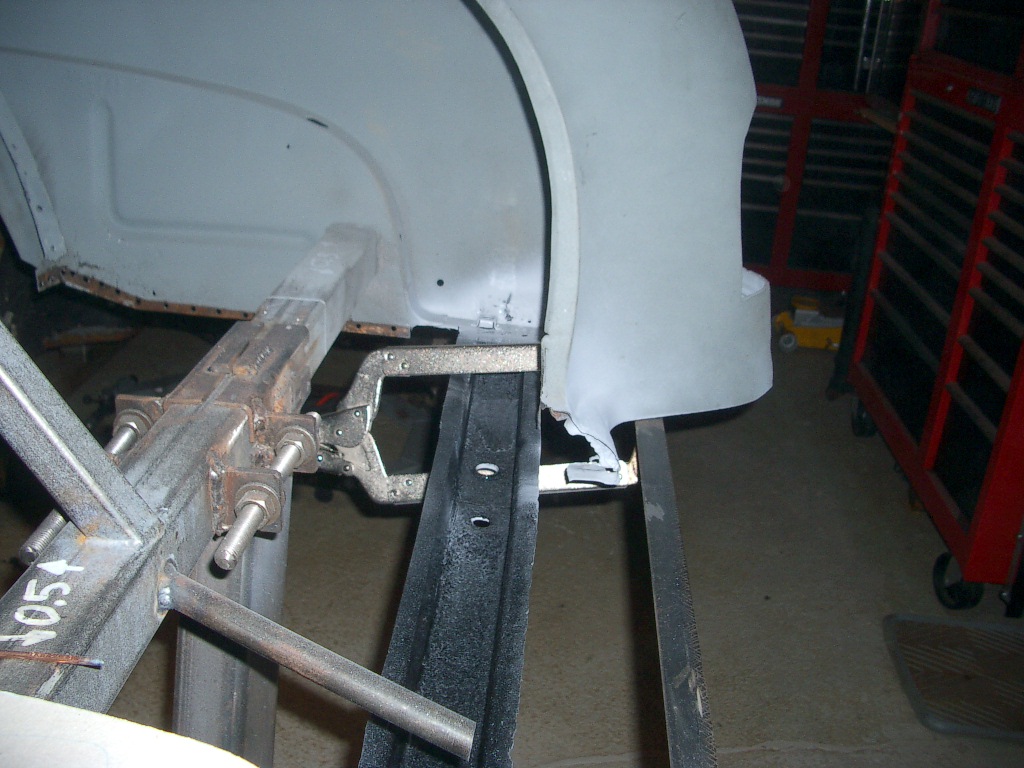

  17. BuilderRhys
    Posts: 128
    BuilderRhys
    I would like to do more here today but honestly -10 Celsius or 14 Fahrenheit (and going into work for the morning) is a bit much. When is it going to freakin warm up I`m sick of the snotsicle hitting the welding shield. Regards, Rhys.

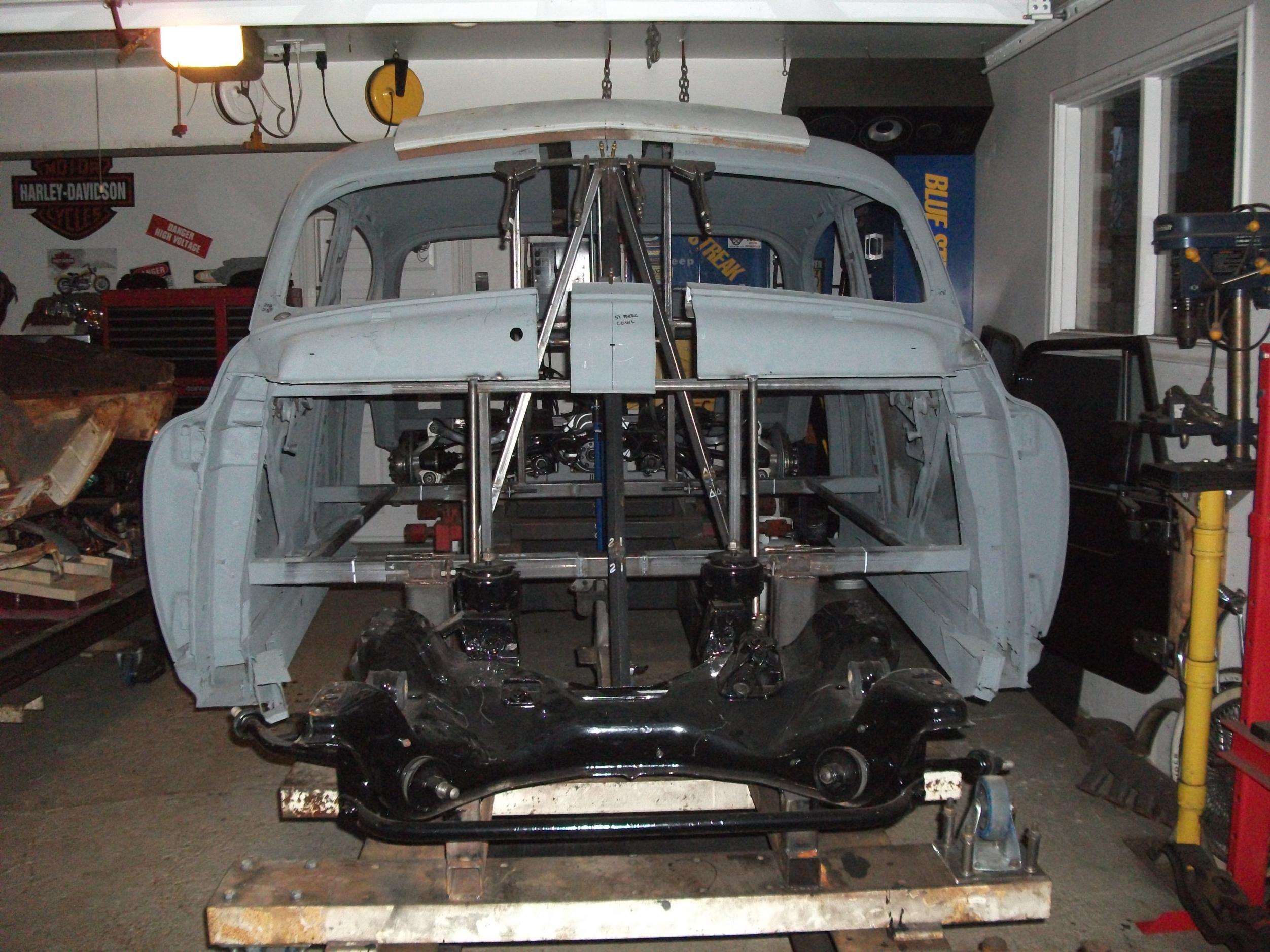

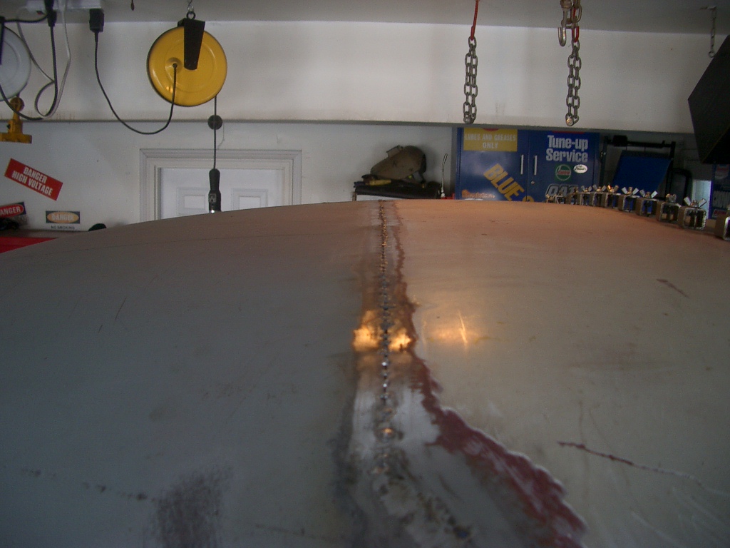

    I'm digging your wooden roof support jack idea. Gonna do something similar for my '36, I think. The entire damned floor and substructure is rotten, so I've got nothing at all for the body to set on while I'm working.
    I've been thinking of doing something like what you've got built there, and seeing that someone else has had the same idea at least re***ures me that I'm not FOS on this one.
    Keep plugging away at it, I think it'll actually turn out looking pretty good. The work you're doing is top notch.
    I ***ume you're going to cut a modern windshield to fit the rear window opening. Got anything specific in mind yet, or are you just going to build a pattern and start laying it on every car you can until something matches?

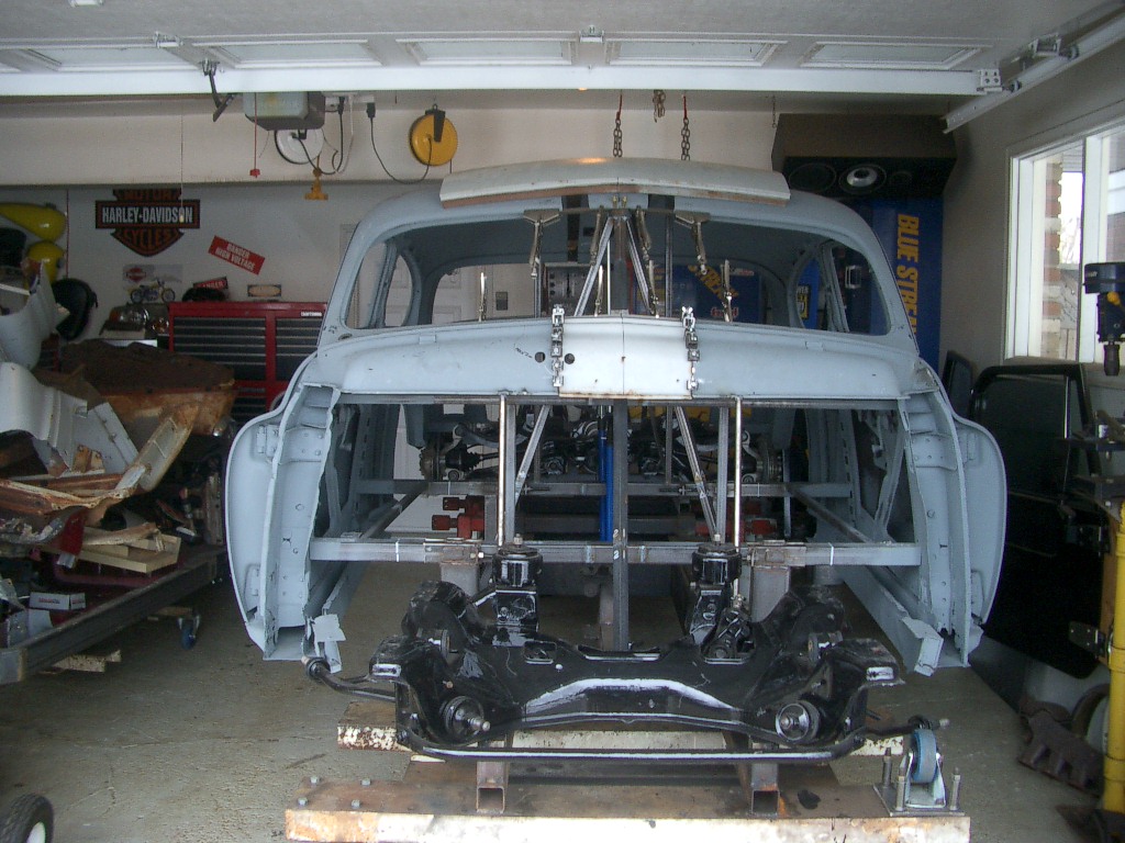

  21. BuilderRhys
    Posts: 128
    BuilderRhys

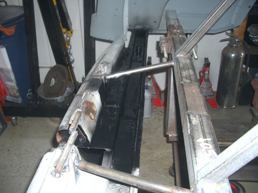

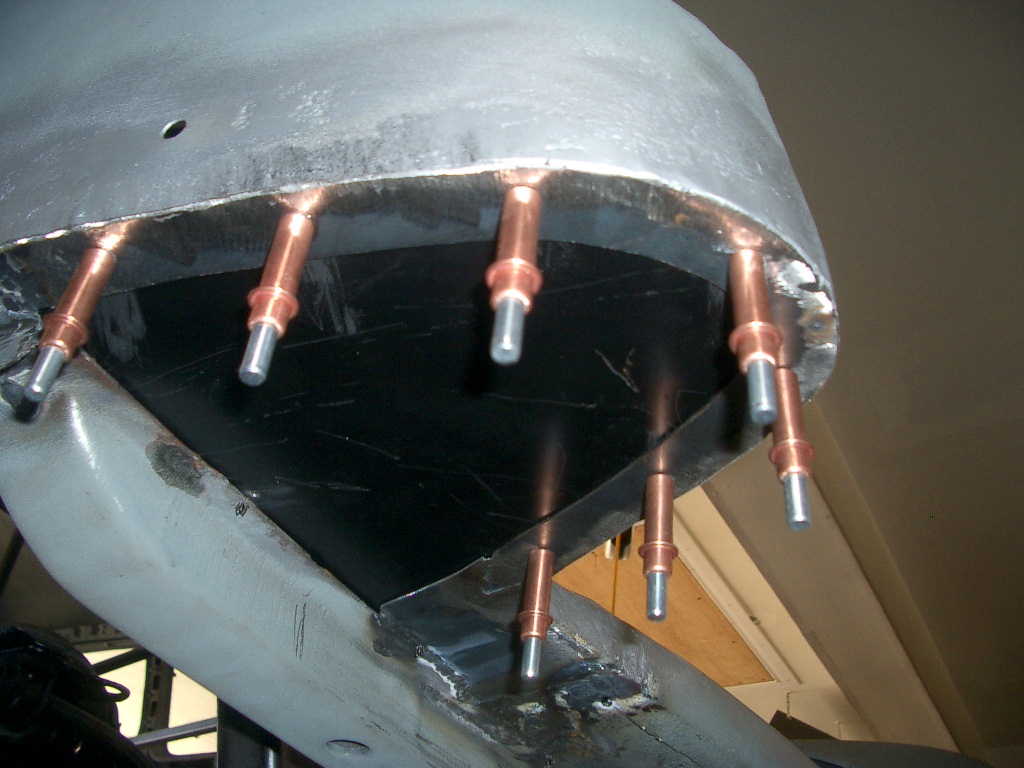

    Finished `tacking`in the p***enger side and played with the rest of the driver`s side. I like the profile of the p***enger side and I think I will slice off a tiny bit more on the driver`s to get it just perfect. For those wondering about the rear window I will be using the 49 rear frame shown in the pictures, a couple of `pie cuts` around the perimeter and it should fly in. Regards, Rhys.

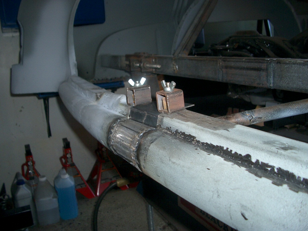

  25. BuilderRhys
    Posts: 128
    BuilderRhys

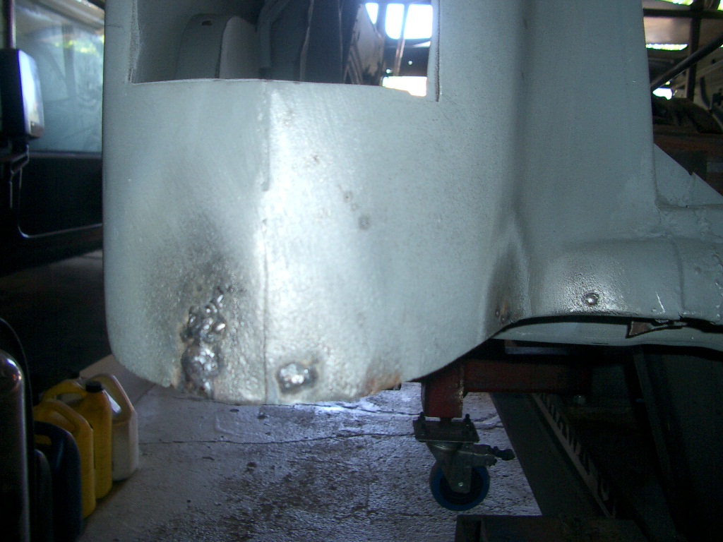

    One side of the rear done. On to the other. Regards, Rhys.

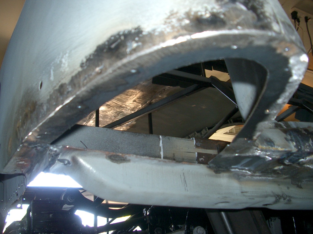

  27. BuilderRhys
    Posts: 128
    BuilderRhys

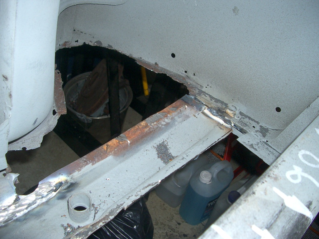

    Working on the right rear side.

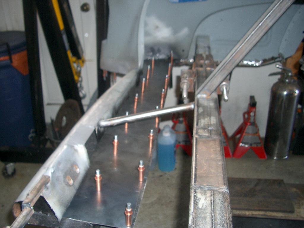

  30. BuilderRhys
    Posts: 128
    BuilderRhys

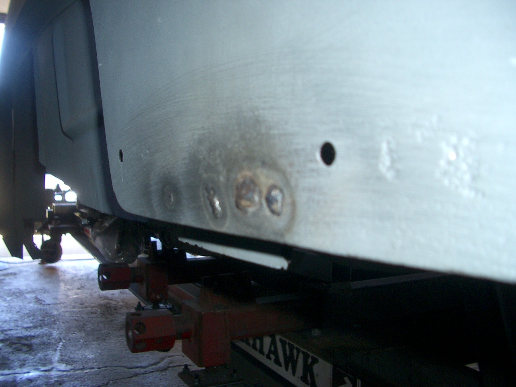

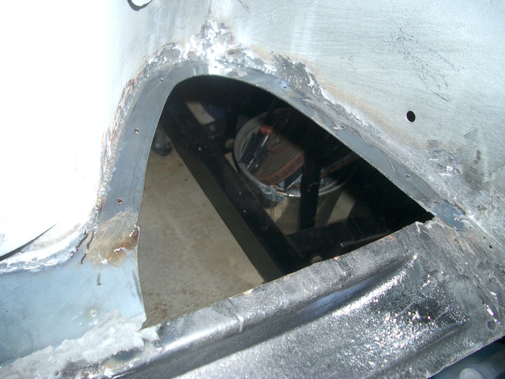

    Last of the rear section tacked in. Bit more welding and on to the inner rockers this week, Rhys.
