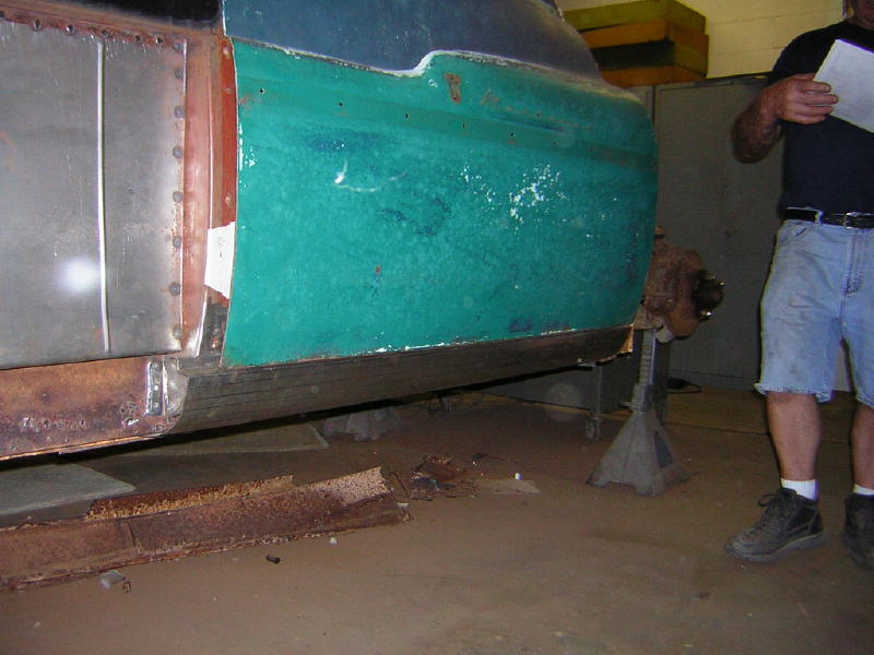

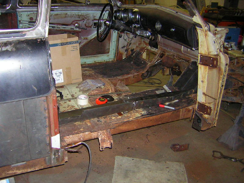

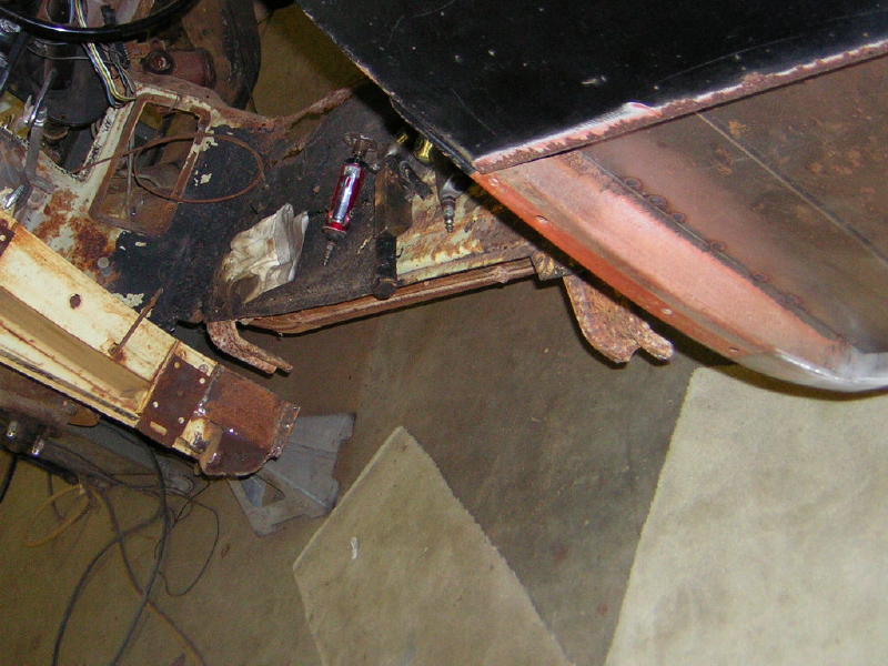

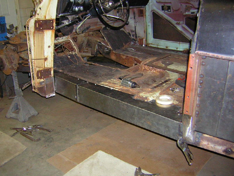

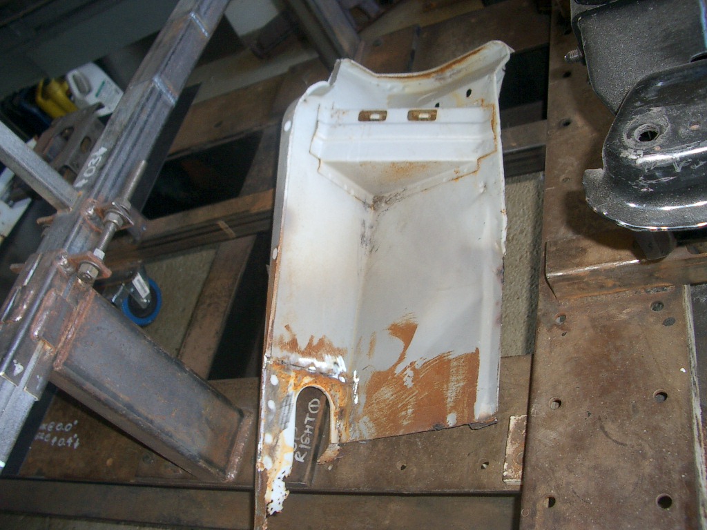

    Managed to get going with the Floor Panel Supports or Inner Rockers. When I removed everything on the right side it looked pretty funky so I decided to go deeper. Long story short, I will have to fab up all the support structure from the lower section of the A pillar panel. I machined up some flanges and doweled them to locate the lower hinge plate. Hinge plate removed and everything peeled back. Doctor Detroit here on the HAMB has helped me out big time with pictures from his car showing all the areas I need to repair. I put the Inner Rockers up in place to check out the fit. Hey Ether, do you have any pictures of these outer areas from your build? Thanks, Rhys.

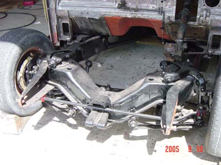

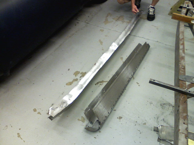

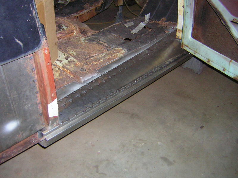

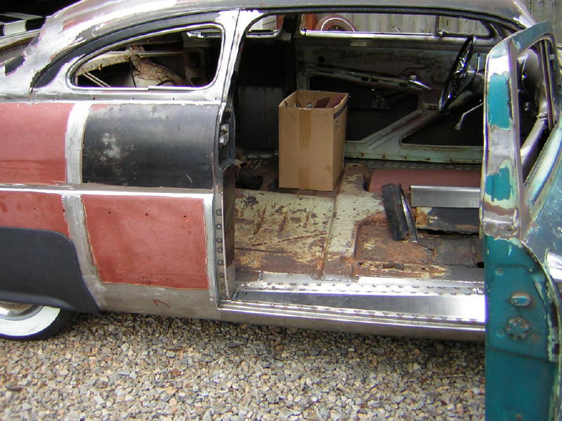

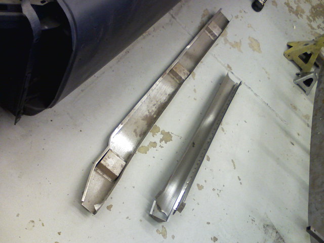

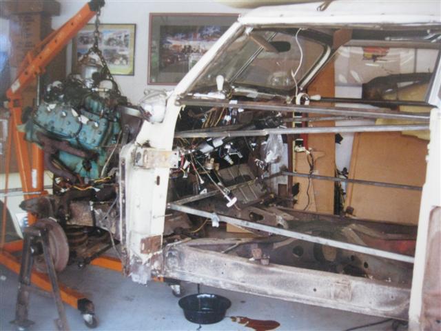

  2. Rhys, Hope these pics help with your rocker issues. I am really impressed with the work you are doing and always interested in how you are going to tackle the next issue. You have chosen a unique approach to customizing YOUR build. It is going to be very interesting how this one is going to turn out and me, for one, look forward to the end result. Dont get discouraged with some of the posts you get. You havent disappointed me yet and you have my full attention on this one, and dont be fooled, if you didnt have there's they wouldnt be following the build. Keep up the good work and with the right approach and proportion, its going to turn out awesome!!!!! I do have a some interest in how you are going to approach a couple future issues I see, but I believe you've got it covered!!!!! Let me know if you need anything else. Ether

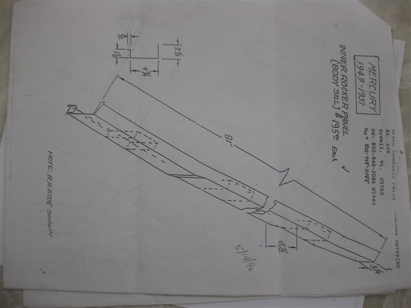

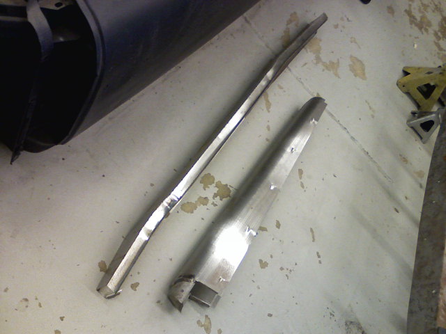

  3. Heres a couple of green mountain rockers, just a little more info to help ya out.

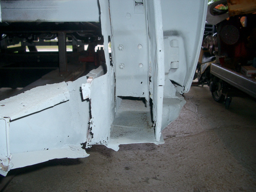

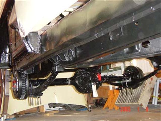

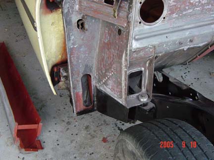

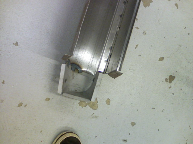

    I am not in any way trying to usurp Ether as he is a master of his craft, but I thought these may be of some help -if only a little. I also used Green Mountain sheet metal. I did find that the distance from the bottom of the A-pillar to the frame is critical for proper gapping of the front fenders and hood. Be sure and put a drain hole in the bottom of the A-pillar. While you're at it.... sign it.

    That`s what I'm talking about!!!!!!!!!!!! With Doctor Detroit, Ether and 19Fordy's pictures I feel like I am on the ***embly line. These last group of pictures are exactly what I need. Thank you very much gentlemen. I am always amazed at the talents of HAMB members, 19Fordy looks like you went the `Full Monty`like Ether on your build, simply amazing. A side note here, but I think my rockers may be the `Green Mountain` variety, I purchased them from Mike Dundon. Again thanks all, the information is much appreciated, regards, Rhys.

    Hey, can anyone tell me if the Mike Dundon (Green Mountain) Inner Rockers are longer in the rear than they need to be to allow for the installer to trim out as required? I can get everything fitted up front to where it looks like it shoud be but I have about a 4" or better over hang at the rear. Also, do the three support sections on the inner rockers (see Ether`s last group of pictures) match up in position to the floor pan supports for the body mounts? Thanks, Rhys.

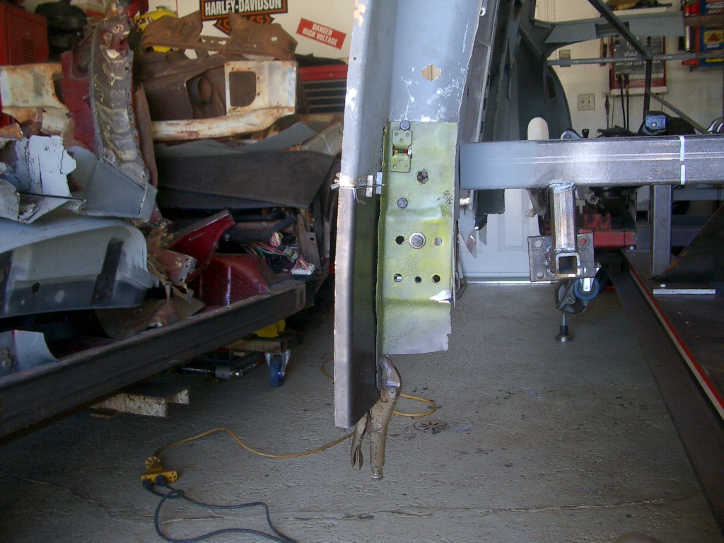

  7. 19Fordy
    Joined: May 17, 2003
    Posts: 8,364
    19Fordy
    1. My Green Mountain Inner Rockers were 81 in. long end-to -end and fit fine. They "****-up" to the rear outside surface of the rear inner fender well and did not have to be trimmed. The front end fit fine also.
    2. Yes, the support sections of the Green Mountain Inner rockers did 'match up" with the original floor pan supports. The second and 4th photo shows the original floor pan support and another floor pan support with frame bracket that I made since I noticed there were 4 extra holes in the stock frame to do so. The bracket closest to the top of the photo is the extra one I made. The other bracket is stock. My previous post shows the front end of the Green Mountain Inner Rocker panel (painted black) without the end cap. I did not have to cut anything off the GM inner rocker. I guess mercury used the same frame for all their cars.

    Thanks for the pic's and measurements 19Fordy. I'm going out in the Garage with the printed copies now to measure everything out. Much appreciated, Rhys.

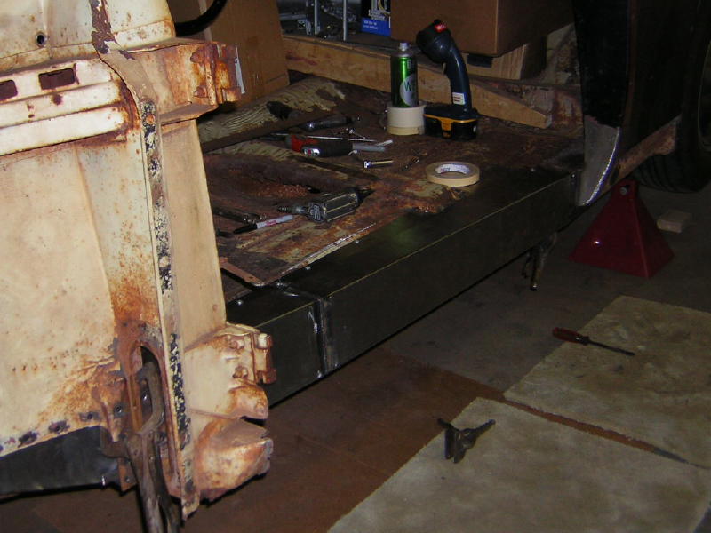

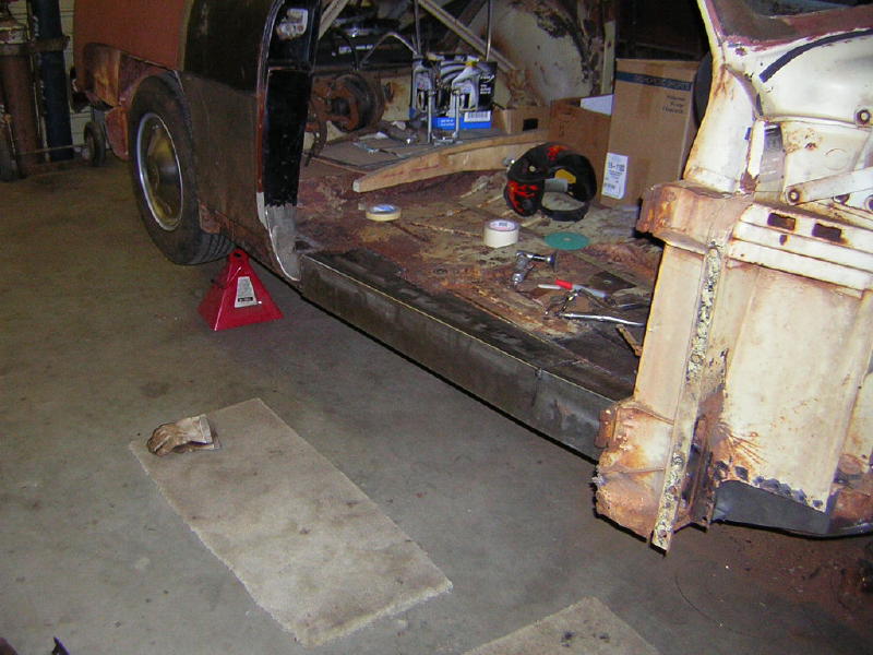

  9. BuilderRhys
    Joined: Sep 16, 2007
    Posts: 128
    BuilderRhys

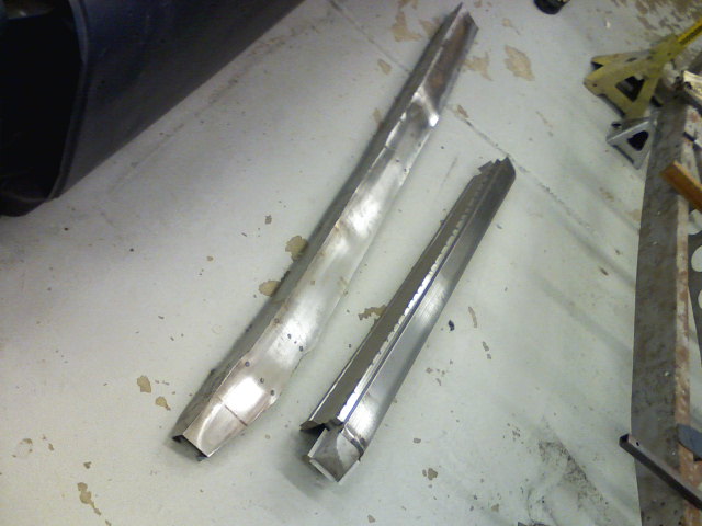

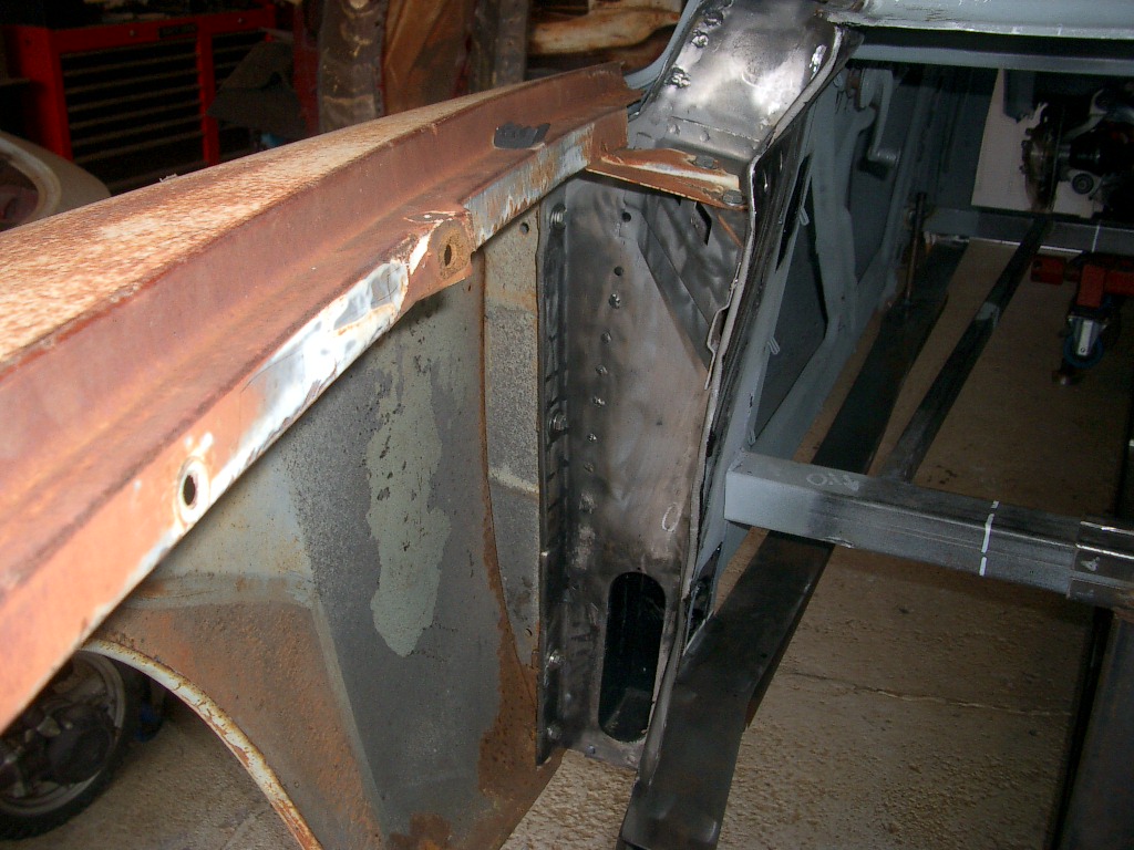

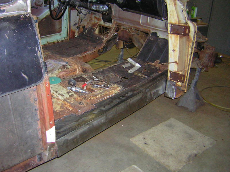

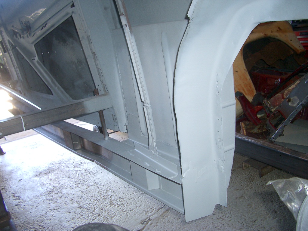

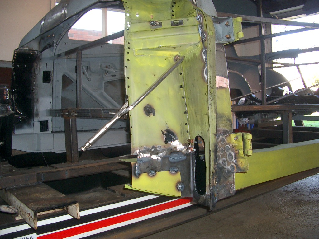

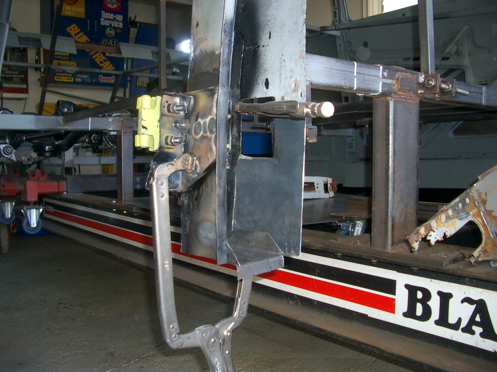

    Managed to clear the old structure out and fab up the new on the `A`pillar panel extension. All tacked in using the hinge Jig to locate. Just need to patch and clean up this last panel and then back to the inner rockers, regards, Rhys.

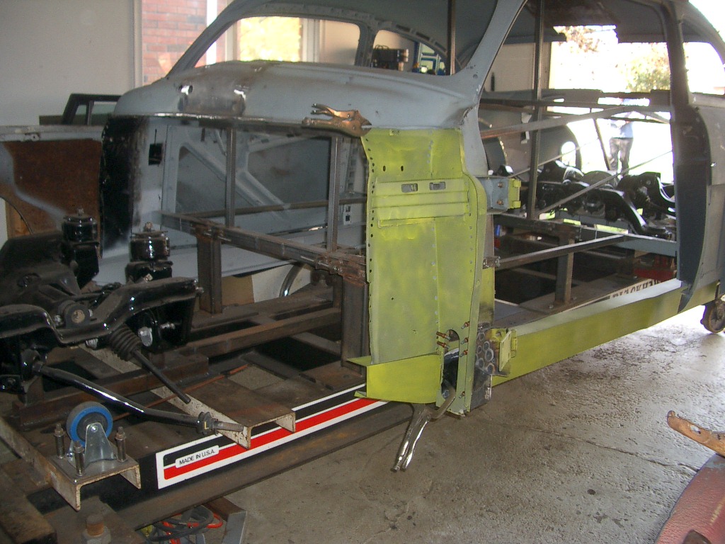

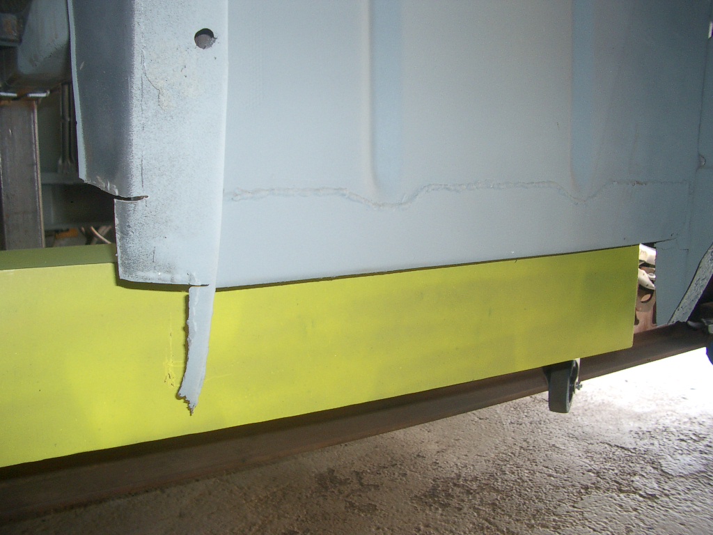

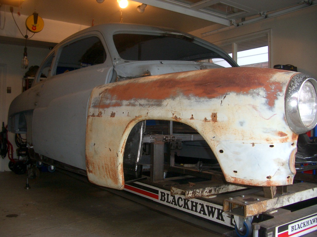

    Managed to get the Pillar Extension Panel Cover and Inner Rocker tacked up on the right side. Fitted the Door up and found that I have the lower hinge slightly proud. I will have to recess it back 5/16" to get proper alignment. I now need to fix some previous repairs to the right quarter panel and finish weld everything out. Regards, Rhys.
  14. BuilderRhys
    Posts: 128
    BuilderRhys

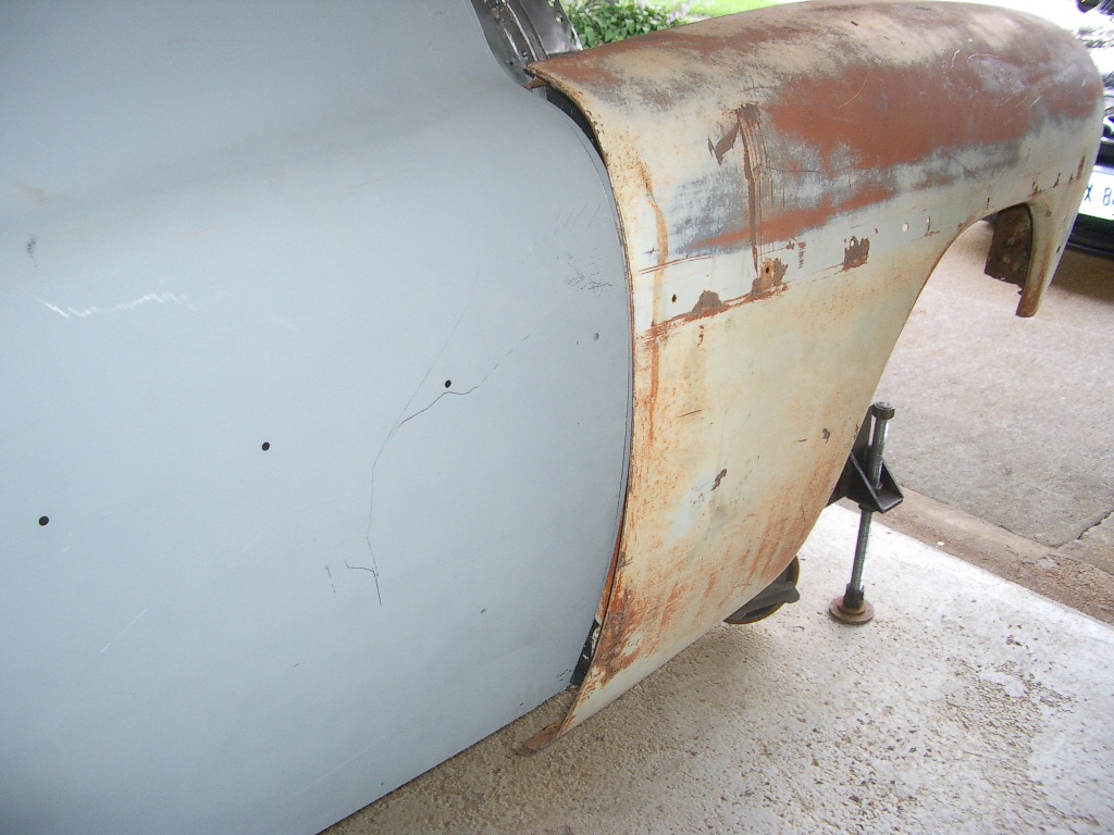

    The door is all aligned and gapped out really well (just needed two hundred pounds of persuasion in the right places). Brought out the front fender to fit it up but found it had a nice crease right at the door side edge, dang it, right in the spot I needed true. I banged it around for a bit and bolted it up. The gaps are off to the door edge. So a little more m***aging on the A pillar extension panel flange and hopefully it comes in better. I think I will grab my salt ridden, rusty Ontario fender for the next fit up so that I am not fighting to many variables. All for now, Rhys.

  15. BuilderRhys
    Posts: 128
    BuilderRhys

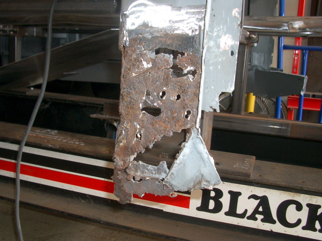

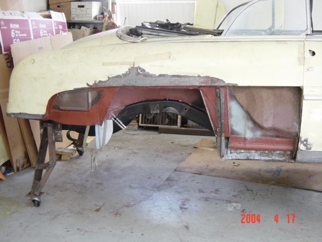

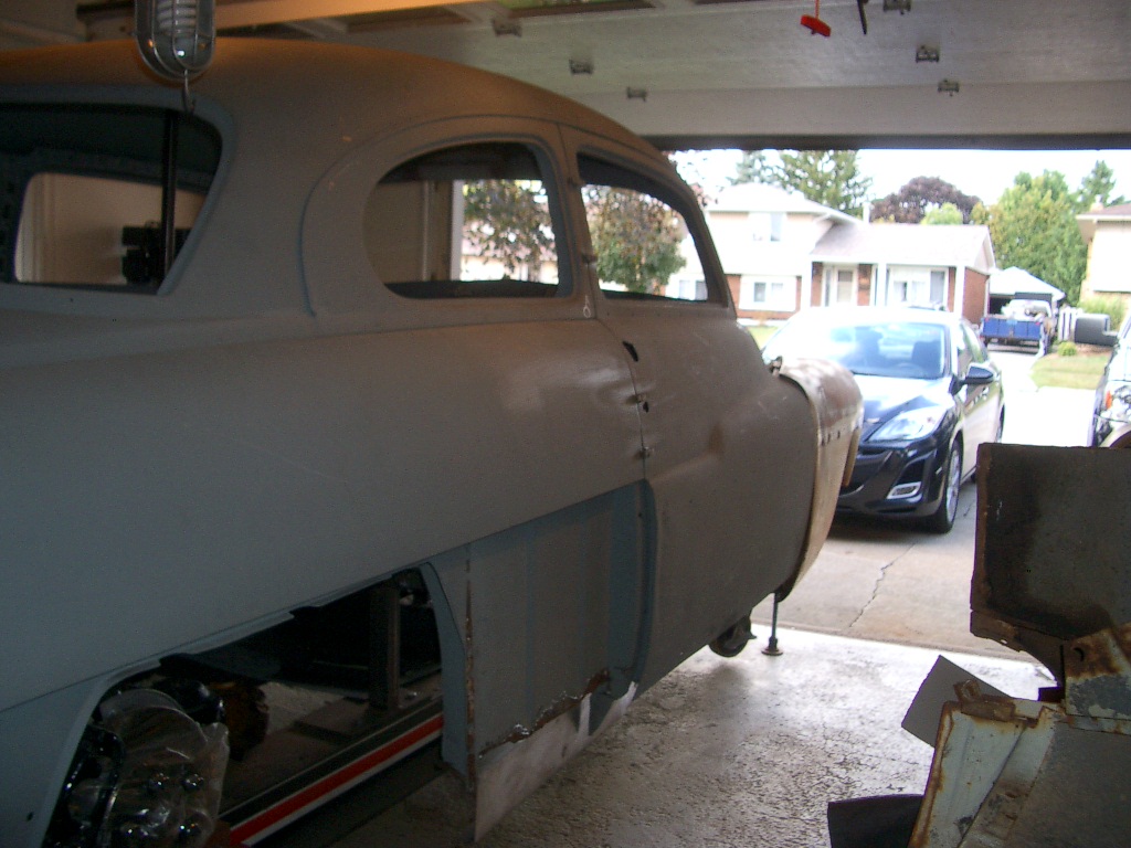

    Did not feel like playin in the rain pulling panels out of the shed today so I left the front end work for another day. I decided to remove a previous patch panel on the inner rocker at the rear quarter panel (it was a lap joint patch panel, I hate lap joints - **** weld or nothing). Ready to weld in after the paint dries.

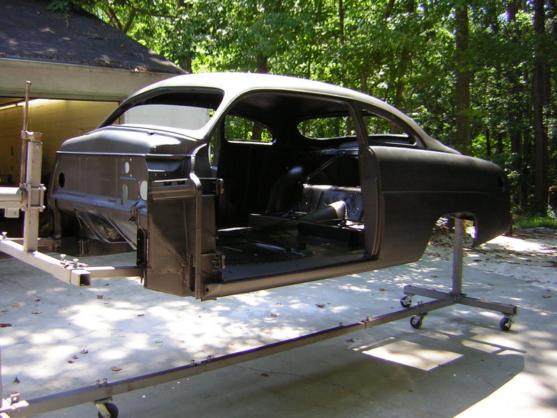

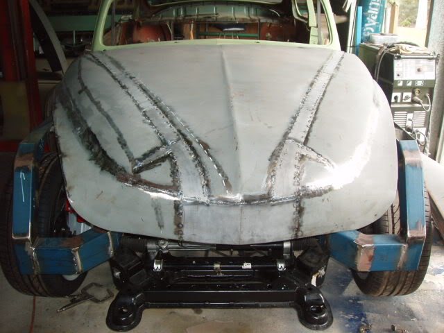

    No photo shop required, the car is widened out and complete. The Merc is widened 5-1/2". The hood will not be widened the full five nor will the deck lid. Infact, I don`t think I will widen the deck lid at all. I may just extend out at the belt line to accomplish this. The hood may look something like below when all is said and done with the required sections and pie cuts.
  18. BuilderRhys
    Posts: 128
    BuilderRhys

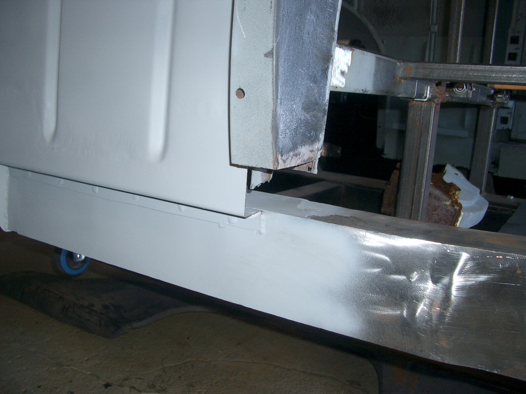

    Fit up my old front fender and I am happy with the gaps, I can now finish weld everything out up front. I continued with the rust repair at the back end. I just have the `B`Pillar extension to finish off and tie into the inner rocker on the right side and then I can start all over on the left side, Rhys.

    Finished off the 'B' Pillar extensions and got ready for the other side today.

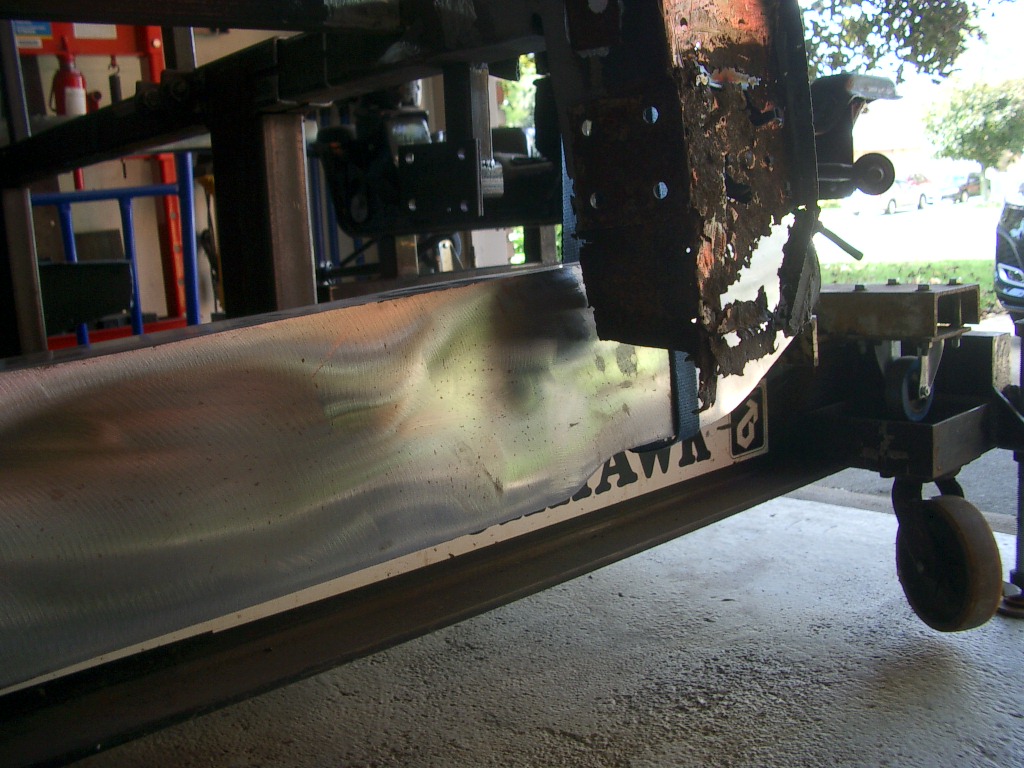

    Rolled the Merc out on the drive and flipped it around to attack the left side. It looks just as bad. Oh well, time to smack it into shape. Regards, Rhys.

    Cleared the left side of inner rocker, outer rocker and rotten structure, Rhys.

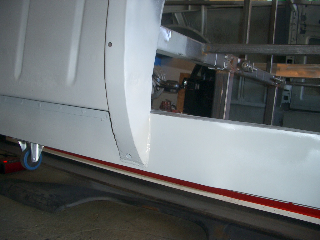

    Still plugging away on the left side inner rocker area, lot's to go, Rhys.
