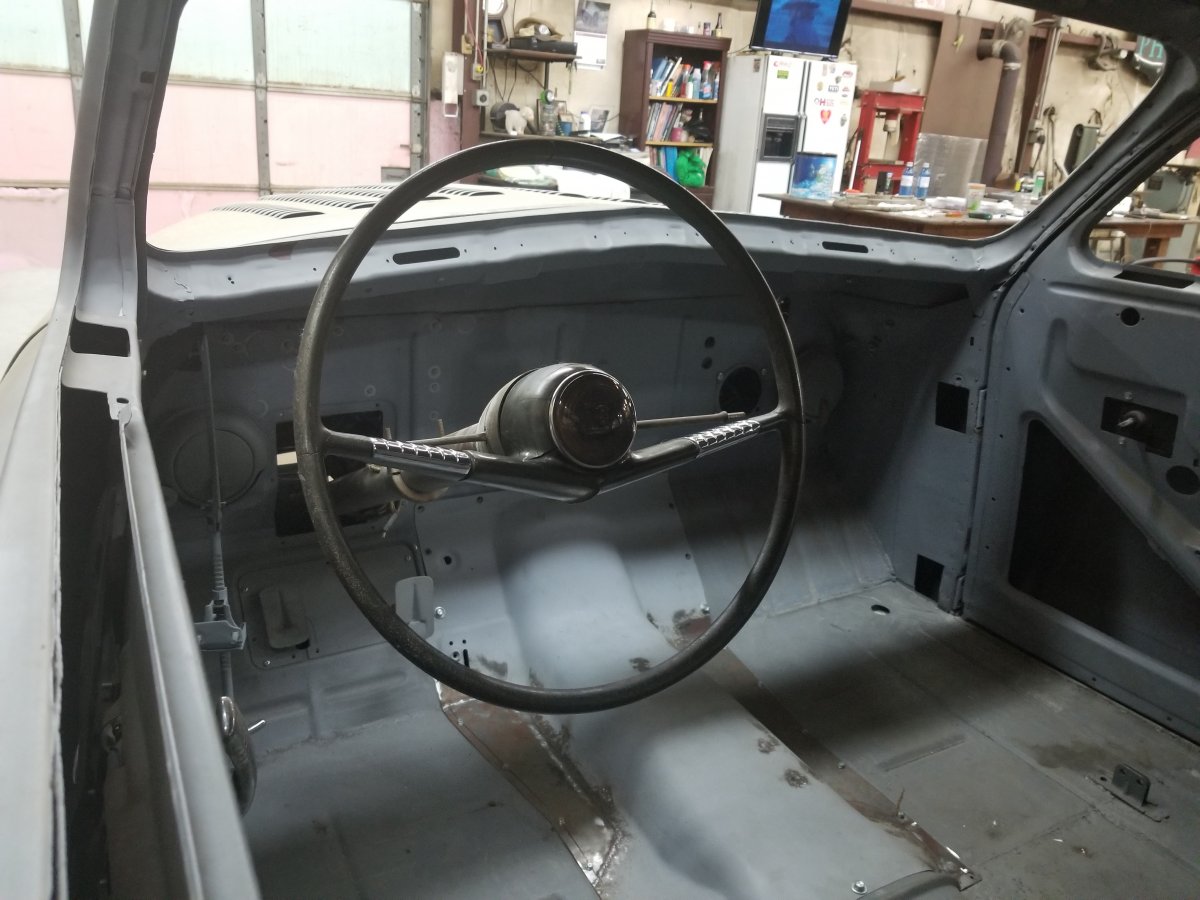

    So I've just been doing alot of different things , Made my transmission mount , used a mock up flathead and got it all bolted together so I could set everything, and test that.. you know everything actually works , and thankfully yes I can actually use the 3 on the tree and it does in fact go through all the gears like it should ( I'll take the small victories where I can find them) . I still have no idea what the throttle linkage is supposed to be like because apparently I'm missing 1 part of it but ill just deal with that at a later time. And I've also been working on starting the dash restoration as-well. The interior i plan on running basically 100% stock in appearance as far as chrome and stainless and the over "feel" obviously the materials with be a little nicer but I love the look of the stock dash.

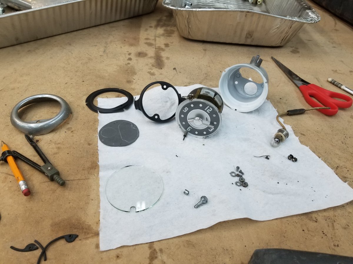

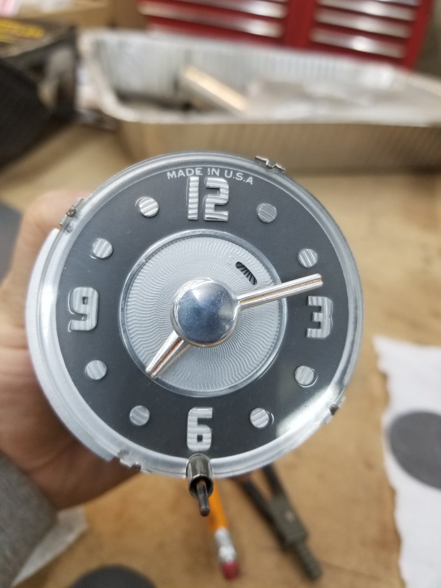

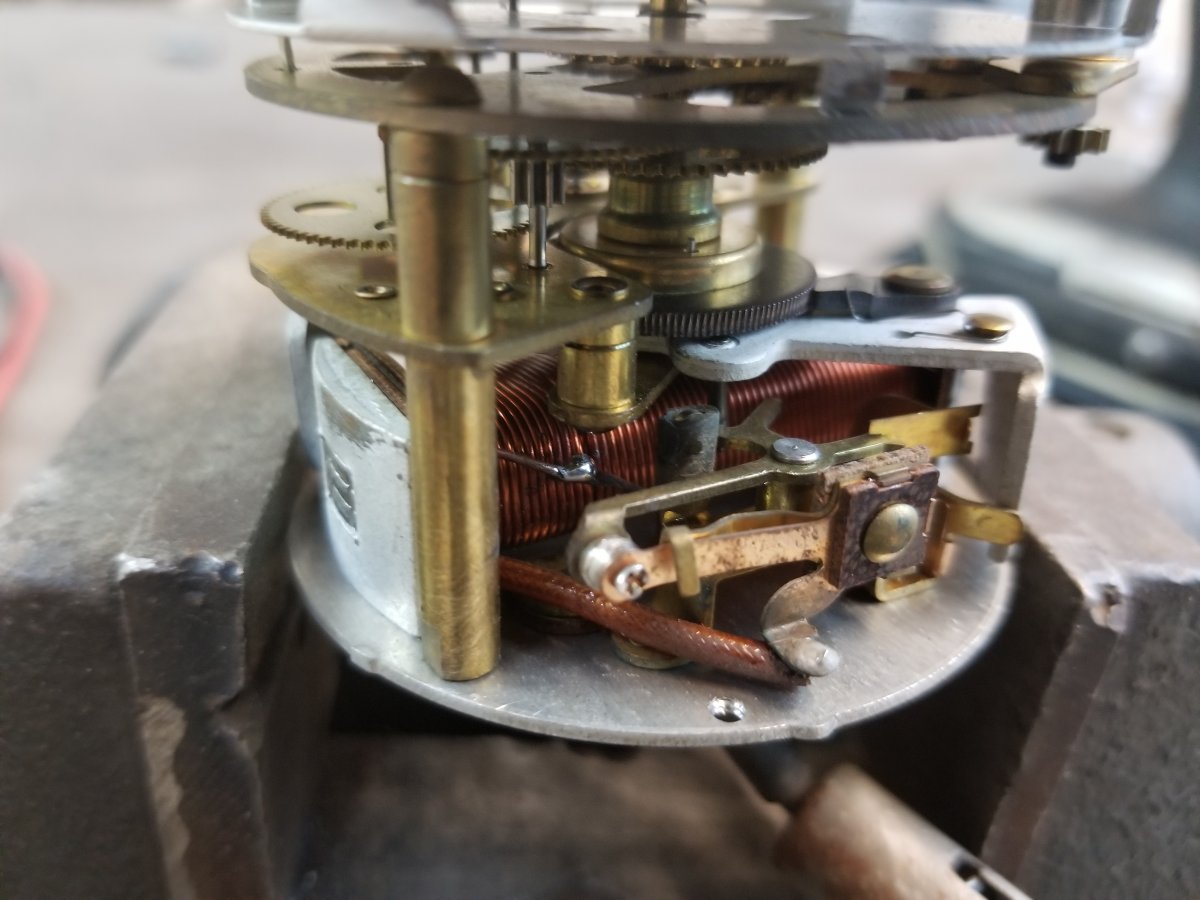

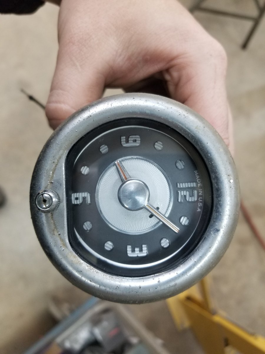

    The first thing dash-wise I wanted to try fixing was the clock... I tried and failed in my Porsche because it was an actual gear inside that broke so basically just wanted to see if this was workable or not before considering looking for another , or getting it fixed. After opening it up and cleaning everything i noticed that when you put voltage to the unit ... nothing happened , the winding action still worked and would make the clock "tick" but i already knew that one of the springs was too weak and it wouldn't run because of stretched spring... the second issue was the electromagnet in the clock wasn't doing anything thus it wouldnt keep the clock wound... well that was a shockingly easy fix... just re-solder the connect and it worked just fine.. ordered a new spring from mcmaster-carr and taadaa one working clock that besides the outside bezel needing to be re-chromed is ready to go in the car.

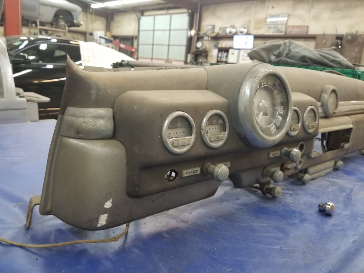

    Mbartils

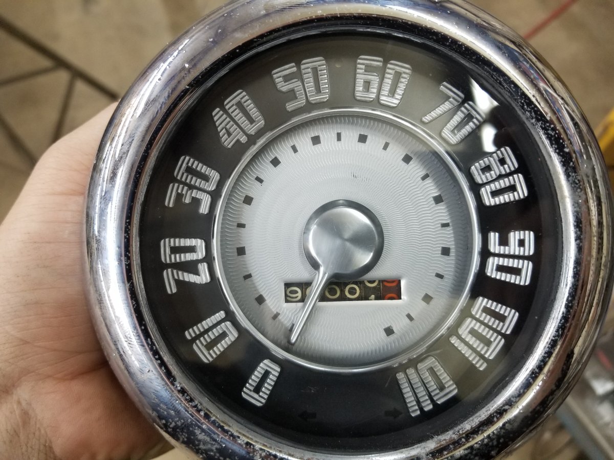

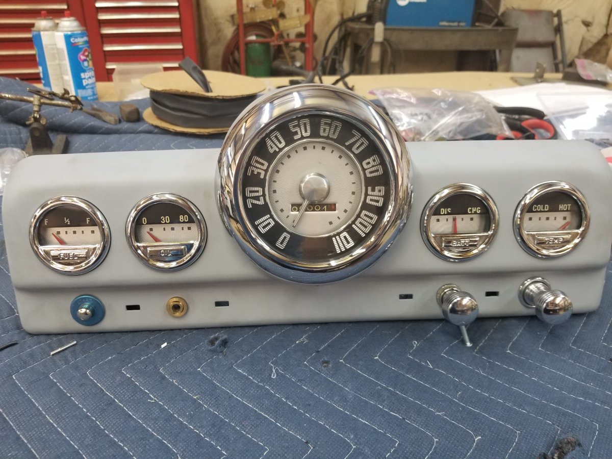

    So next up was the Speedometer , very simple rebuild basically just clean/paint and grease a weird a squeak in the speedometer mechanism. After that was doing all the other gauges , now these I have been acquiring NOS gauges as well as finding old gauge clusters so I could take the gl*** out , because with mine unfortunately the writing on the gl*** was deteriorated far to much to be usable. I simple waited and bought the gauges that had nice gl*** so I could use for mine and now i have nice looking gauges (bar the re-chrome job that will happen later) I test all the gauges before putting everything together that way when i start doing my preliminary wiring i can make sure everything works before final ***embly.
    Tip: when cleaning the old gl*** normally there is nothing wrong with it no matter how dirty and crusty it is simply use warm water and a brand new out of the pack razor blade , place it at probably a 5-10 degree angle off the gl*** and making sure the gl*** is always wet simple apply alittle pressure and s**** everything off.

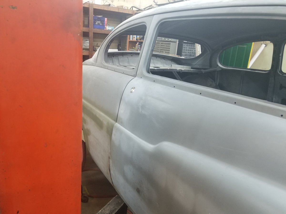

    So few more things done... one that was truly horrible ...de-hog ringing all my seats in preparation to get them sandblasted as-well as a few pieces like the dash and window garnishing that's just to big to properly sandblast in our sandblaster. After what felt like 1000 hog rings everything is now ready and hands finally don't hurt after a week. Also sneak peak of what I've actually already got 95% done , flush mount push ****ons from @CoolHand

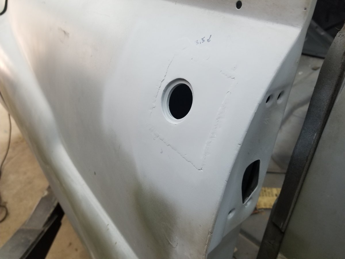

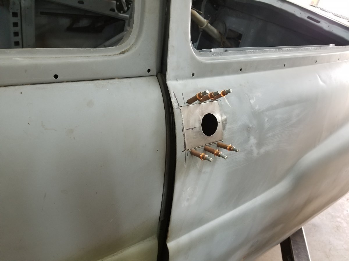

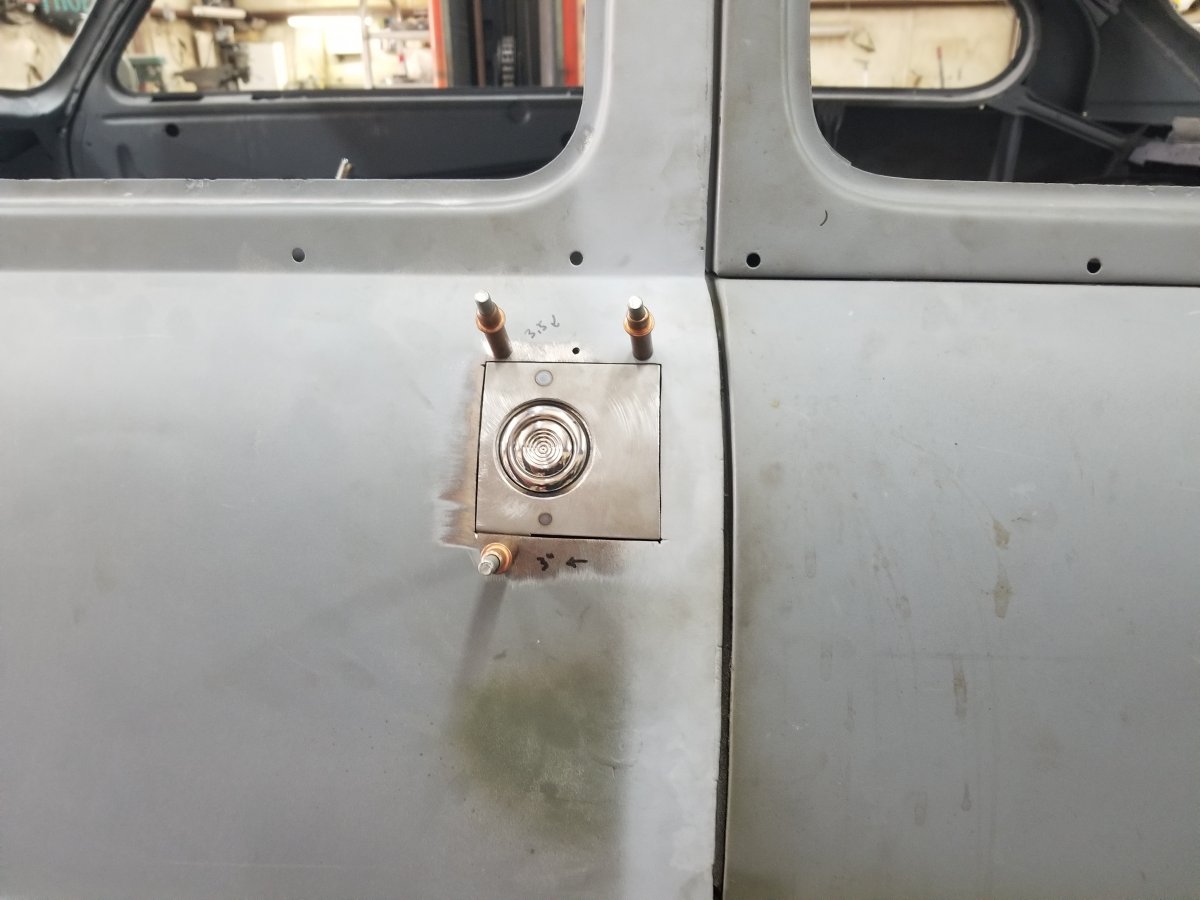

    So i'm sure this could have been done many different ways but this was how I choose to do it. So to start I wanted these to be more of a flush fit than protruding from the door. With the top of the door where i planned to put these having a decent radius I knew i'd need a flat surface , then a curved surface that fit the door. Every now and then we have to cut out holes in some 1/4" steel plate and that's where these 2 "washers" came from because we always save them ,because you never know when they could be handy. Started by putting them in the lath and turning the center down ~.075 , then grinding the sides so they have the right curve to match the door. Some welding and grinding later they are in and done... now the mechanism to actually open the door.. I first tried the simplest way and just adding onto the door mechanism to see if it would open... no not even close by increasing the length of the arm, I was instead of pushing the latch trying to twist it instead. So I need to find something that would make the contact point closer to what it should be with an original handle. So I made a type of offset cantilever that when you push the ****on it would also push the latch in the "sweet spot" and open the door. Now this did work but it was just a little to stiff so I took the spring out of the door ****ons because between that spring and the stock spring in the door mechanism it just had too much spring to be reasonable. After that they work just as they should and I think they look damn good. 20180404_104726.jpg 20180404_105614.jpg 20180404_113103.jpg 20180404_114418.jpg 20180404_114440.jpg 20180405_163251.jpg 20180406_145736.jpg 20180407_132904.jpg 20180407_132923.jpg 20180407_153407.jpg

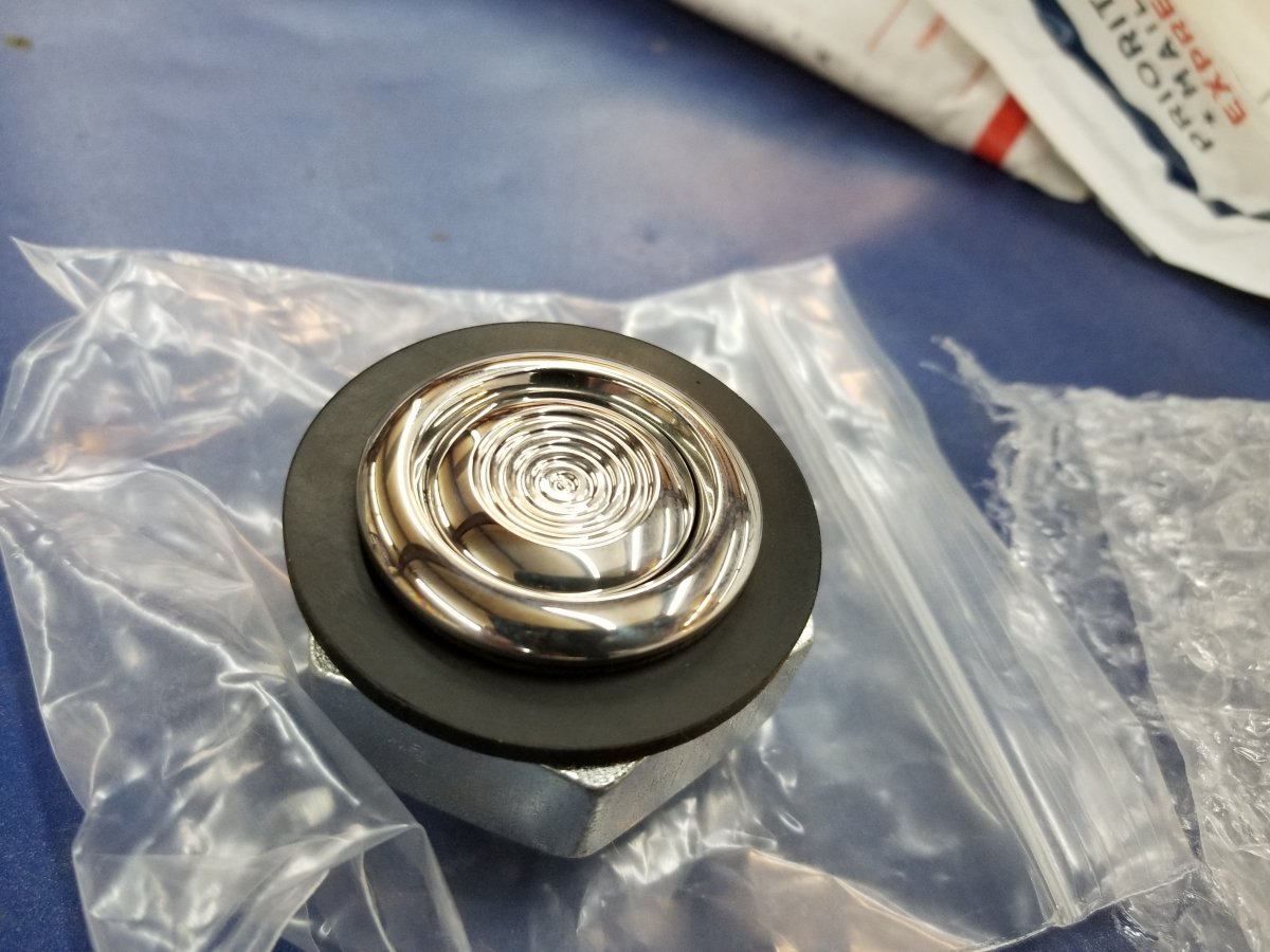

    So it had a good horn ****on (brown one) , and i have a nos one (red) that's perfect , the horn ring was unfortunately broken and missing the ring part but has everything up till where the ring would be so I've either got to search for a ring (doubtful ill find one) or just use the bit I've got as well as the wheel itself as a templete and make one myself ...which is what will actually happen probably.

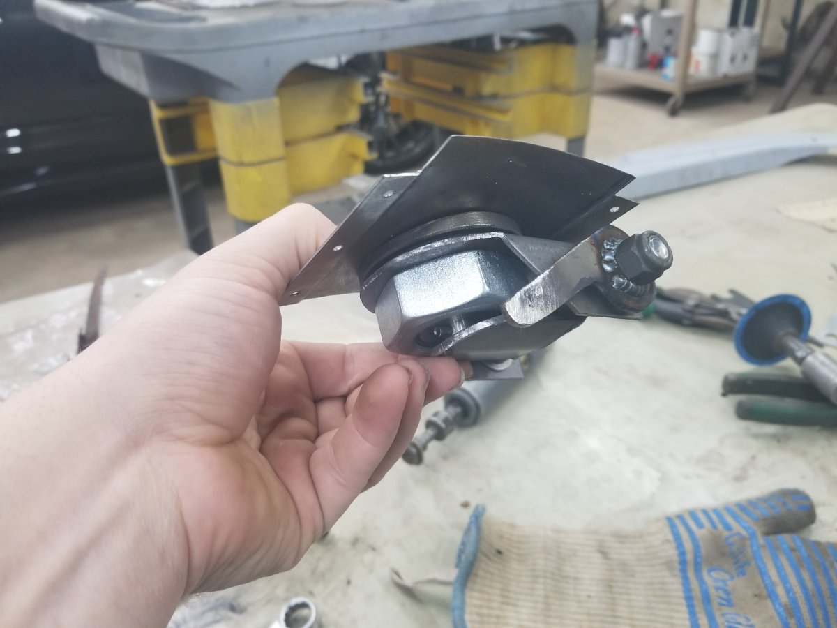

    Luckily I had found a great complete horn ring at the swap meet some years past and I had two cast in br***. They have become so hard to find I cast two rings and two sets of plates that are mounted to the wheel spokes and they came out great.

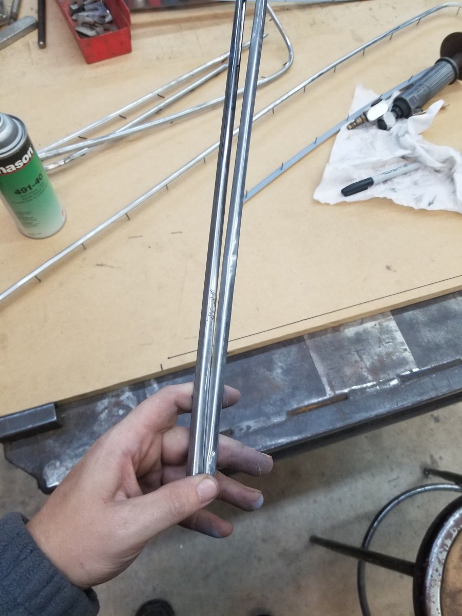

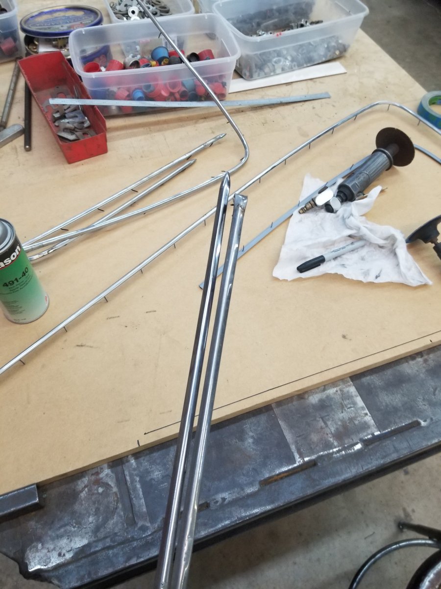

    Interior Stainless , I had all the stainless for this car but unfortunately p***enger side was very damaged but the driver was decent only a couple small dents. I started by fixing the small dents in the "good" side by drilling a hole in the back of the stainless and slowly tapping them out/ then sanding polishing repeat till happy. Then after I had the Driver side good I needed to use that as a template for my bad side. I had a set of 4 door stainless so I used some of that to actually fix the 2 door pieces. And thankfully after everything was over its had to see where it was welded together. The bottom was easier than the top since its simply a straight piece of stainless.

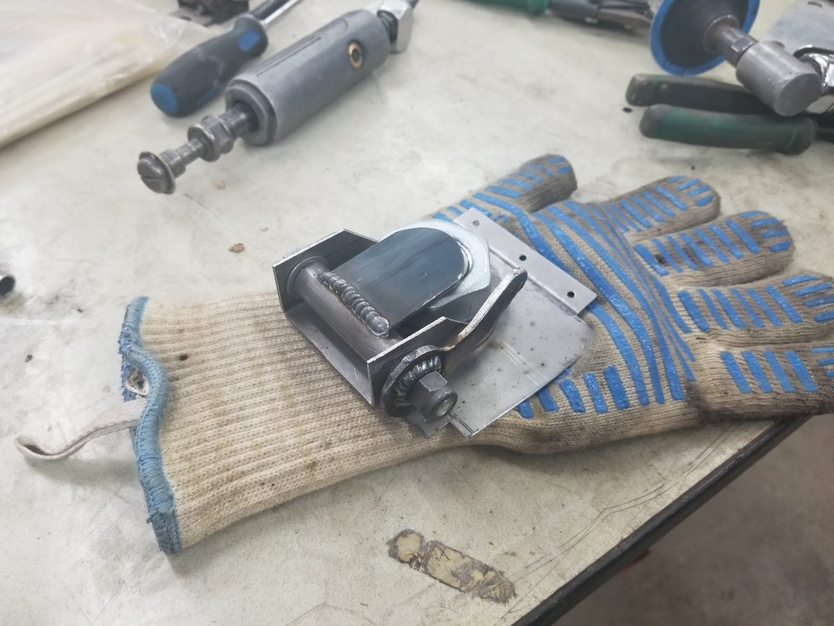

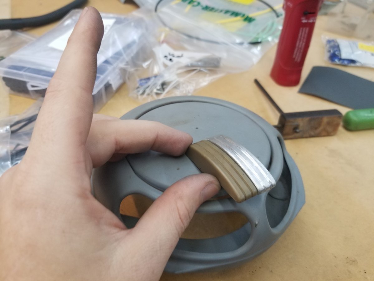

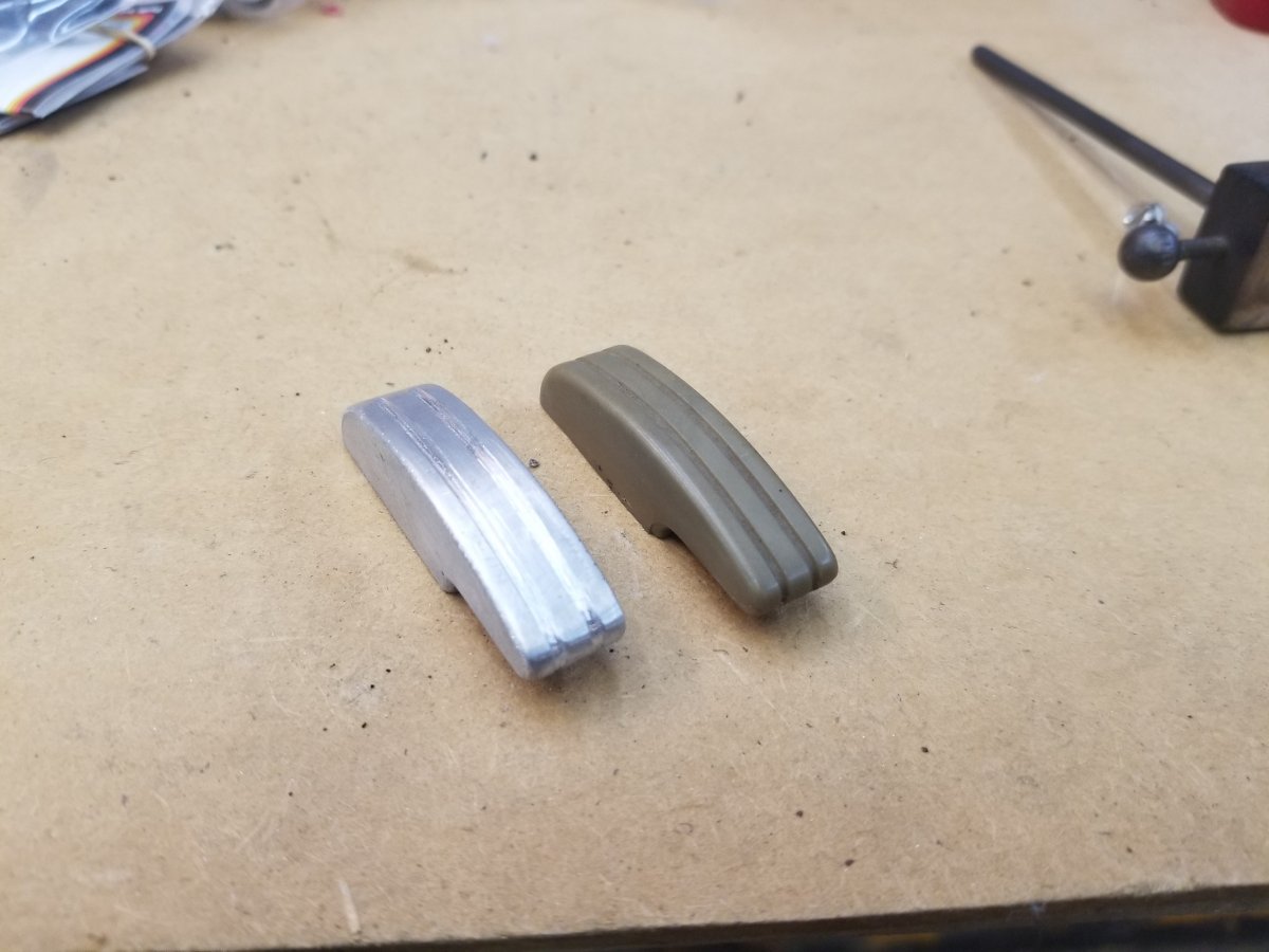

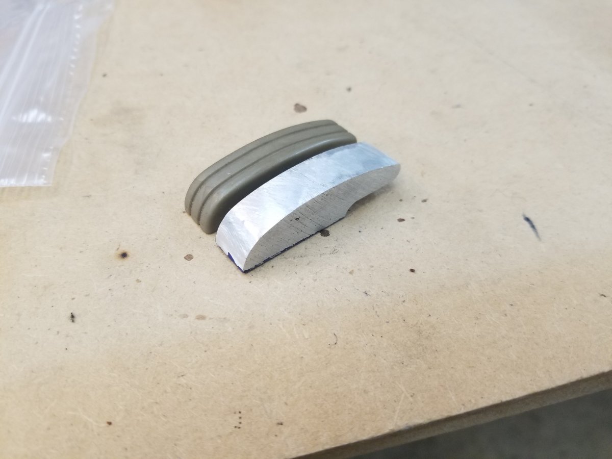

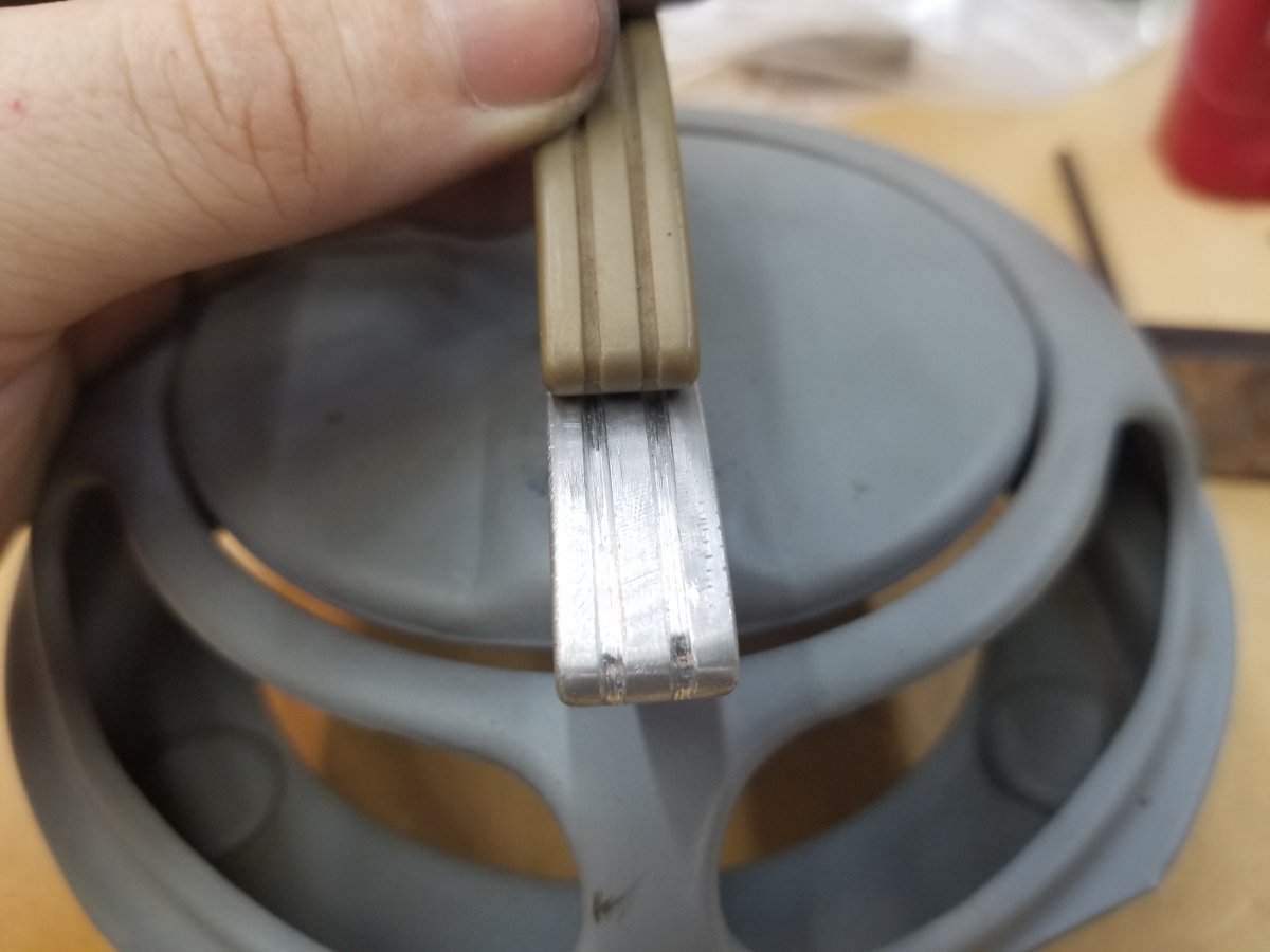

    So I plan on using the original fresh air vents ; but the original plastic pull tabs had some cracks and the small tabs that keep it in place were broken off. So started by cutting some .5" aluminum plate into a rough shape , then drilling and tapping them 8-32 and finally doing some finish work with the cut-off wheel to make a set of small cuts then using a file to finish them.
    20200329_104849.jpg 20200329_104906.jpg 20200329_111800.jpg 20200329_112241.jpg 20200329_112254.jpg 20200329_112310.jpg

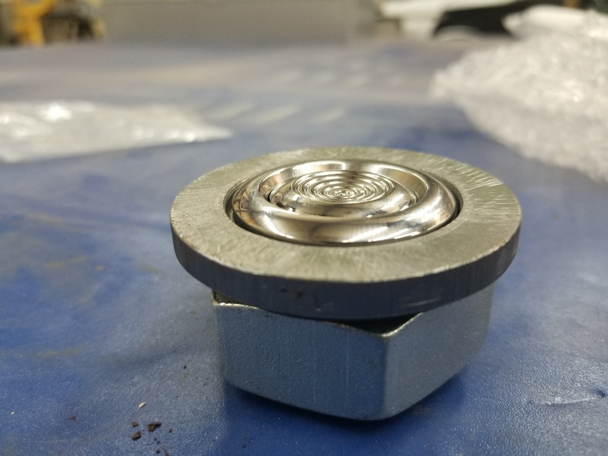

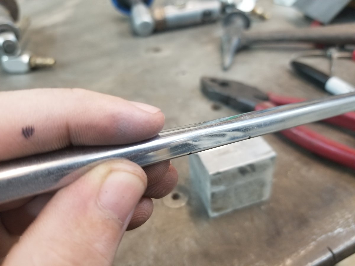

    The back gl*** has the vertical pieces of stainless held in place with this metal backing plate and the trim simple snaps into it.. well sadly like everything it rusted so I needed to fix it. Started by getting a couple hole punches the exact same diameter as the inside of the original little outside arches. Then made another piece that was the exact same as the "valley" . I clamped the middle to the table and then manually bent some metal up, then clamped my "fixture" together [which was just some bar-stock with the hole punches welded on] and then clamped everything together and started manually bending again as well as tightening everything up with a small chisel. After t******* the excess metal off and welding it onto the original piece the trim still snaps together as intended.
    20200205_134717.jpg 20200205_134731.jpg 20200205_134753.jpg 20200205_135620.jpg 20200205_143234.jpg

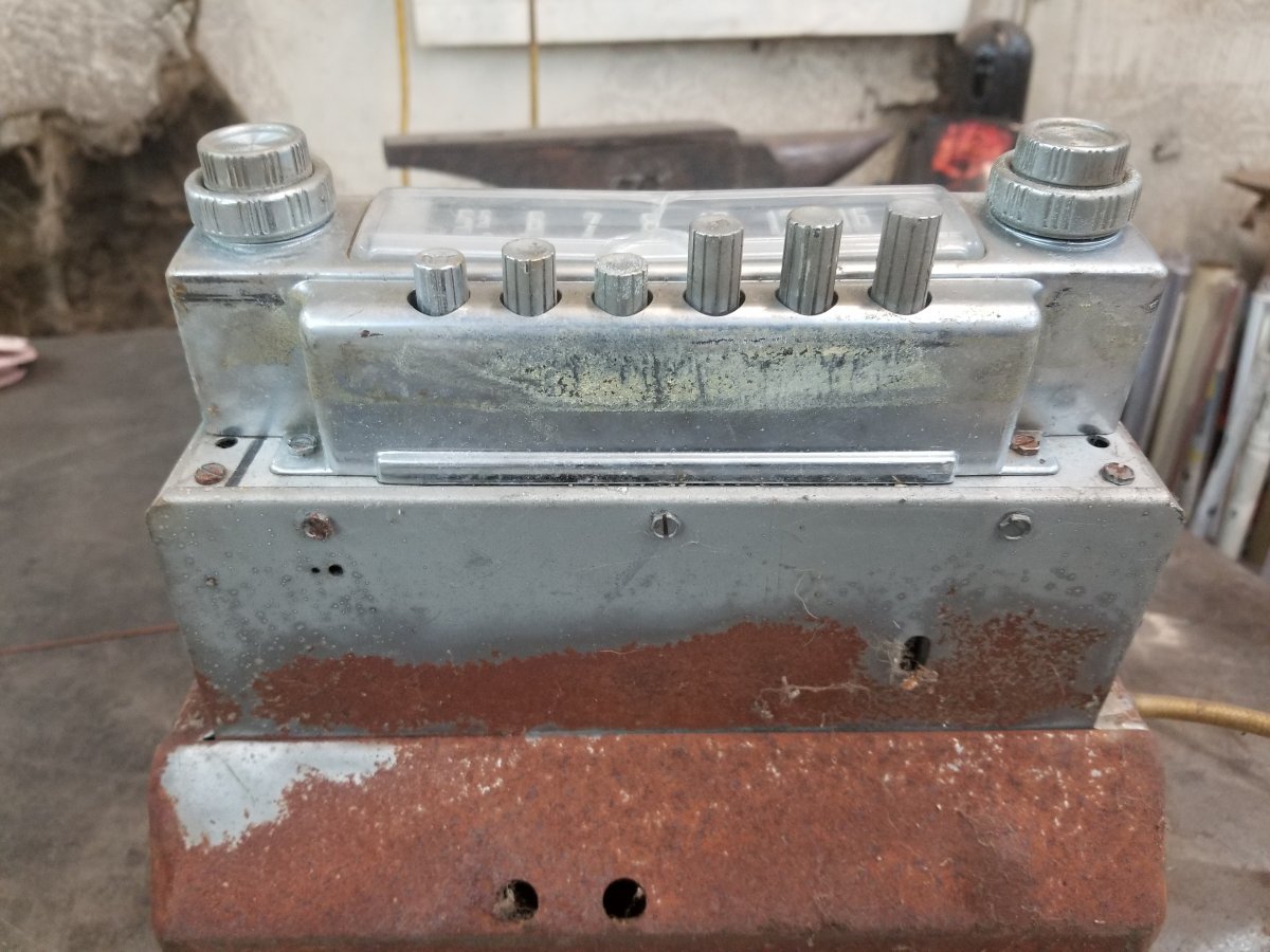

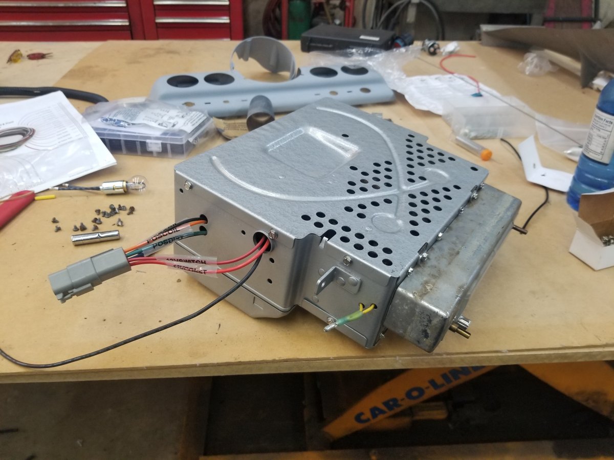

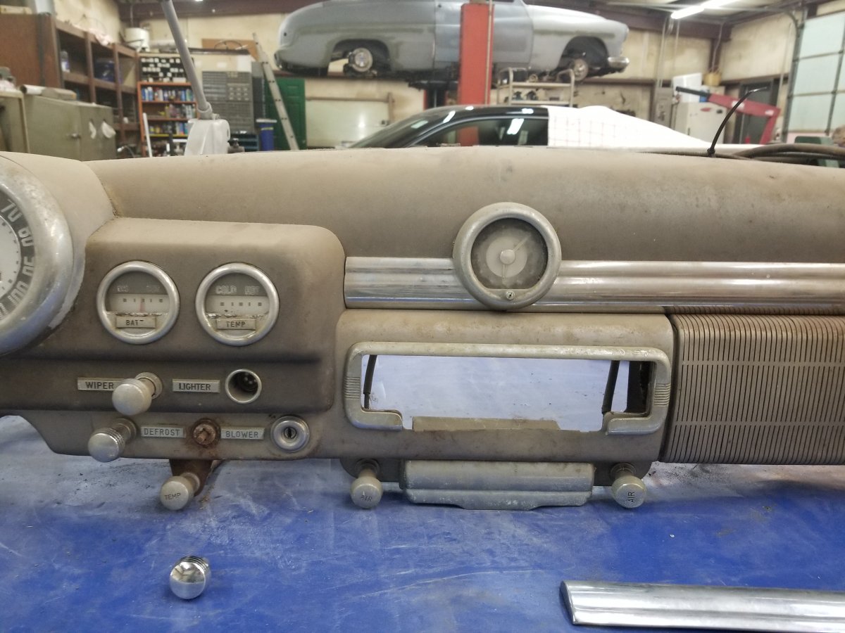

    So whats the second worst thing to do besides paintwork in my opinion...wiring... but also one of the most important things. Because one of my pet peeves is seeing the wiring so i always try to hide everything whenever I have to wire a car so when its done you cant see anything except the bare minimum . So that's what I've been/am currently doing.

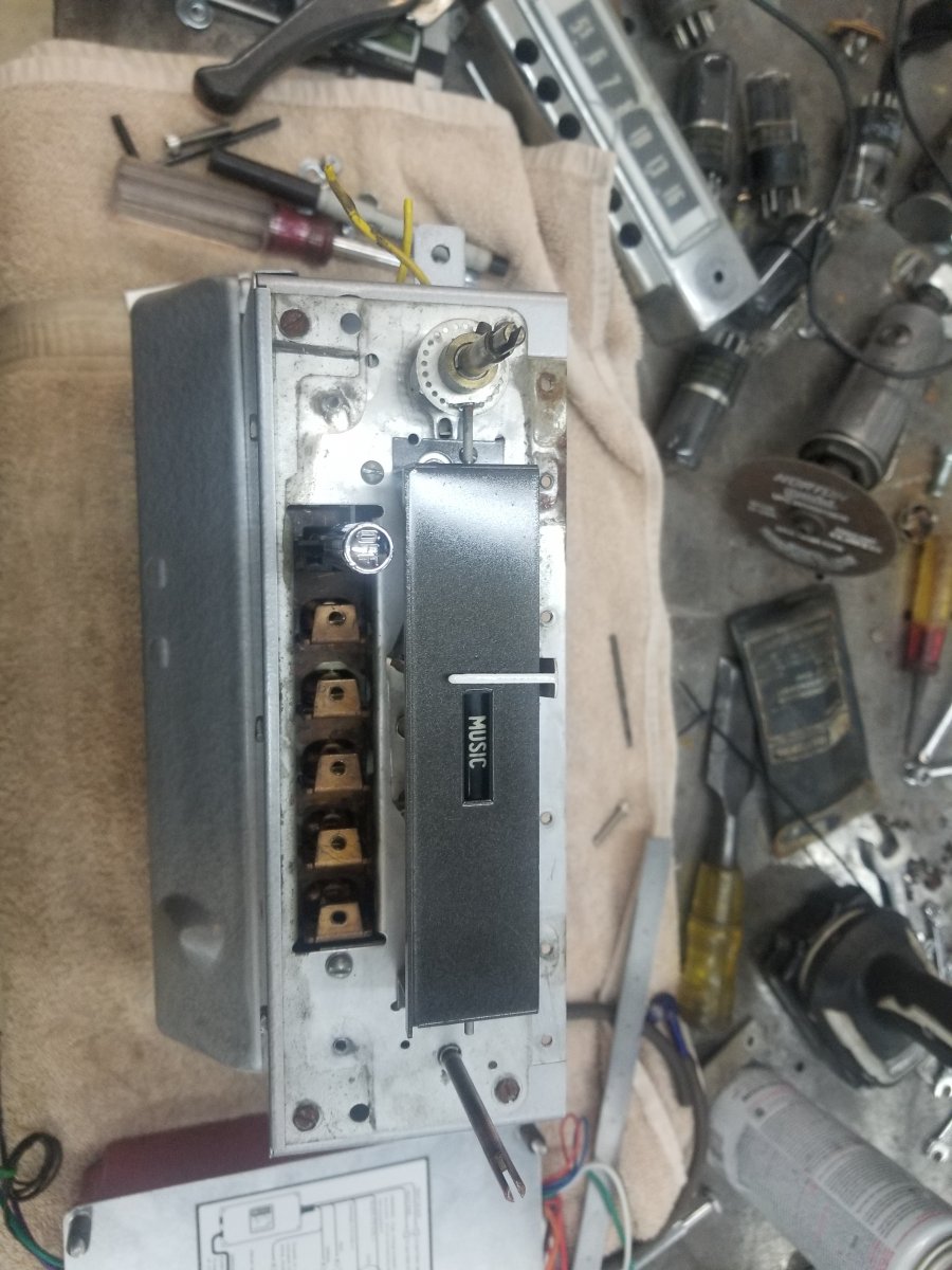

    So to start I always planned on at-least having the original radio in the car... now I never held any hope of getting it working (basically it would be a face plate that lite up and knobs turned but thats about it).
    So started by gutting this... miracle of electro-mechanical engineering and basically getting it so that its just the radio case and the bare minimum of mechanism so that knobs still workand push ****ons still give the appearance of being operations. Now I needed to mount the msd box for the engine somewhere and funny enough its basically the perfect size to fit in the radio...so that's exactly where it went.. So my radio runs the engine in this car....
    I have another face that's currently getting re-chromed with all the knobs and push ****ons as well as another plastic insert that's not cracked.
    20180818_135144.jpg 20180818_135523.jpg 20190223_131529.jpg 20190223_131538.jpg 20200331_121538.jpg 20200331_121554.jpg

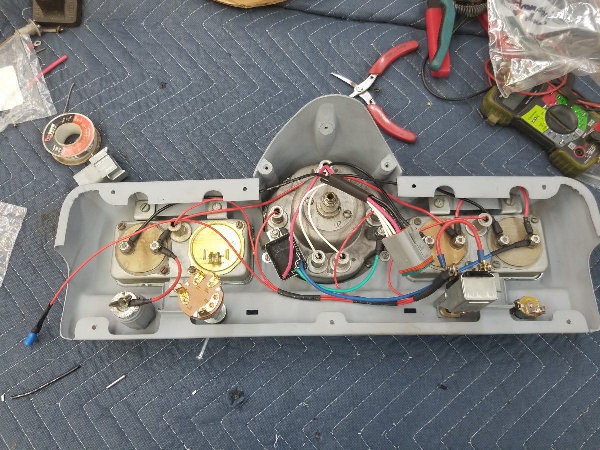

    So the wiring is still continuing , it doesn't make for great photos thou.
    I made a battery box for the rear trunk and included a master battery switch in the mounting so its accessible from underneath the car.

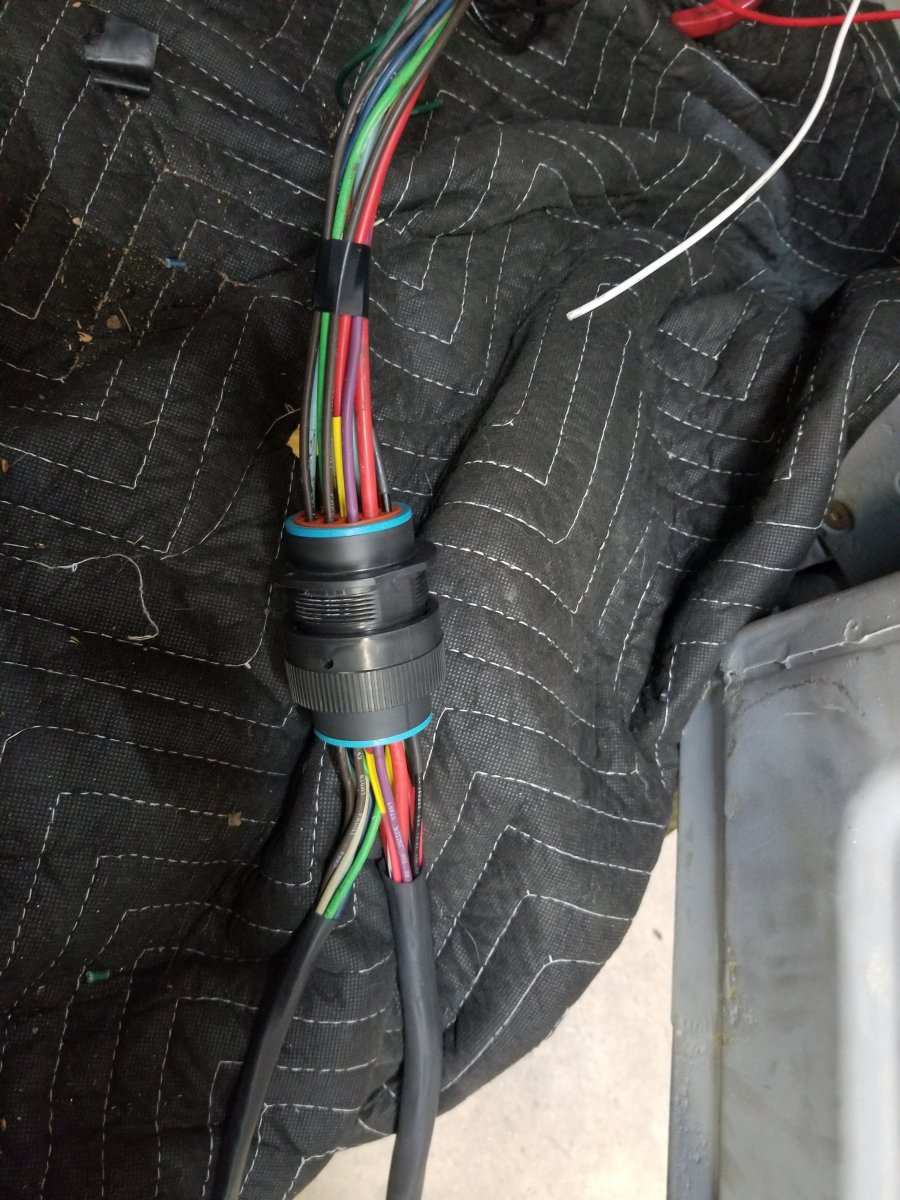

    Also one thing I did which I like was put a deutsch bulkhead fitting hidden in the p***enger side for the wiring of the engine/front end
