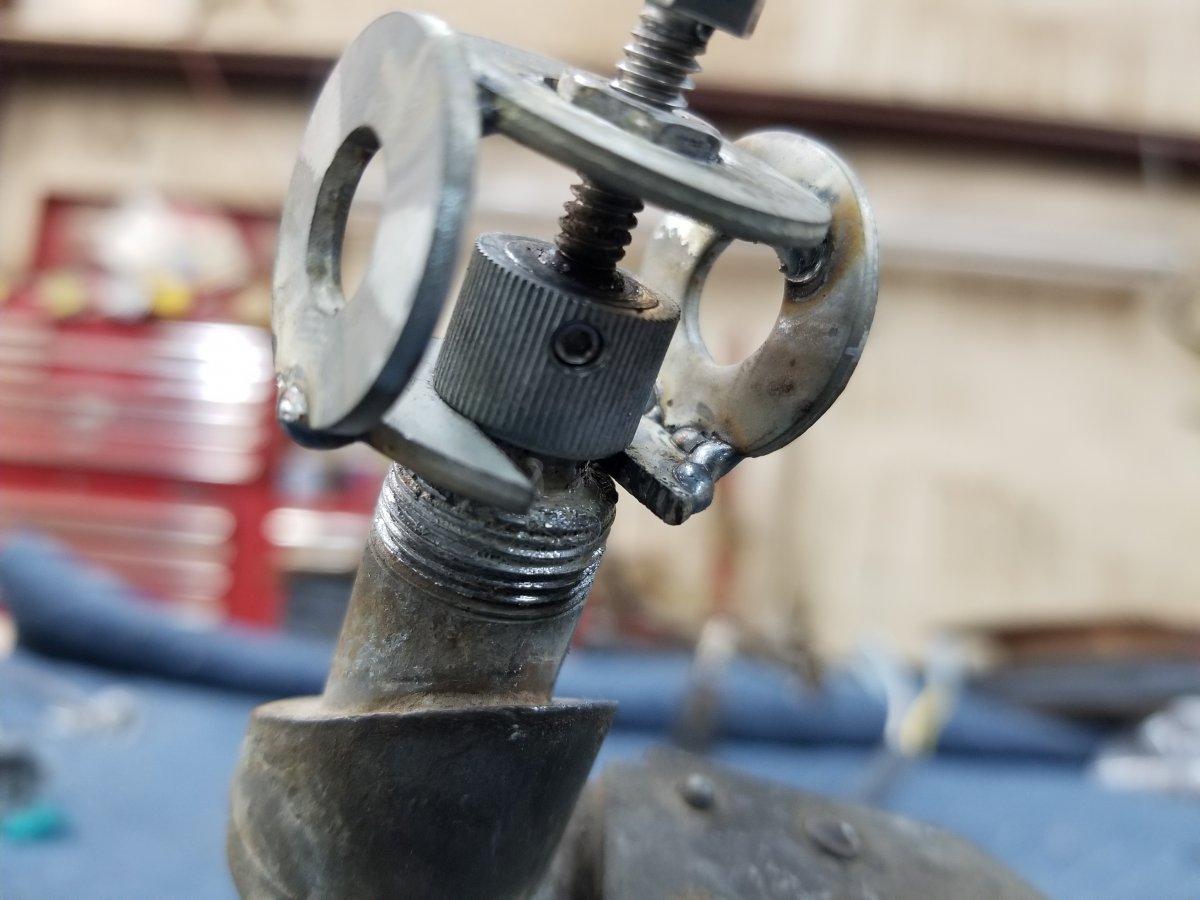

    So after testing the wipers inside the car, I found out I put the arms on the wrong side.... seeing as it hit the body ... so while it was out I changed the wiper arm splines , I didn't have a puller so I made one with some washers and a nut/bolt all welded together.. it got the job done. My dash wiring is almost done only have the radio and the courtesy lights remaining. 20200520_134032.jpg 20200520_134053.jpg 20200520_134108.jpg

    @Mbartils ......Very clever, yet simple to make, puller! I’ve said it before and I am saying it again. I love your Merc build and your ideas and workmanship are First Rate!
