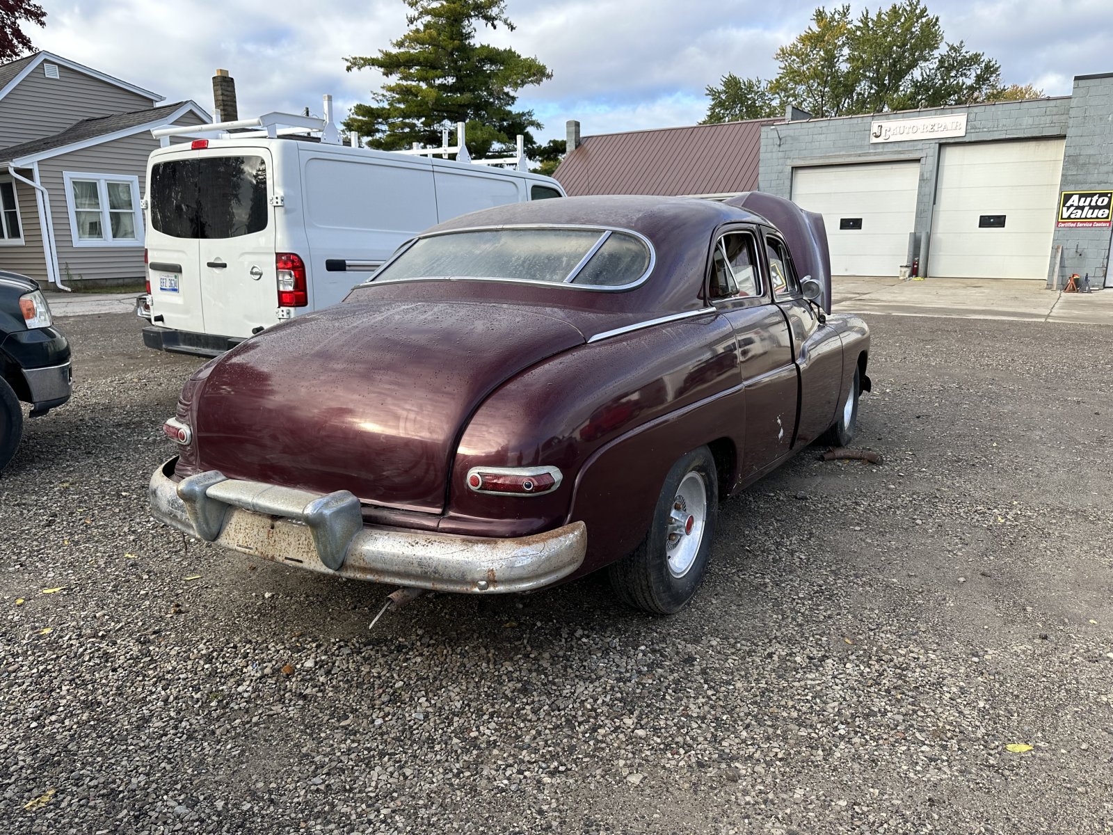

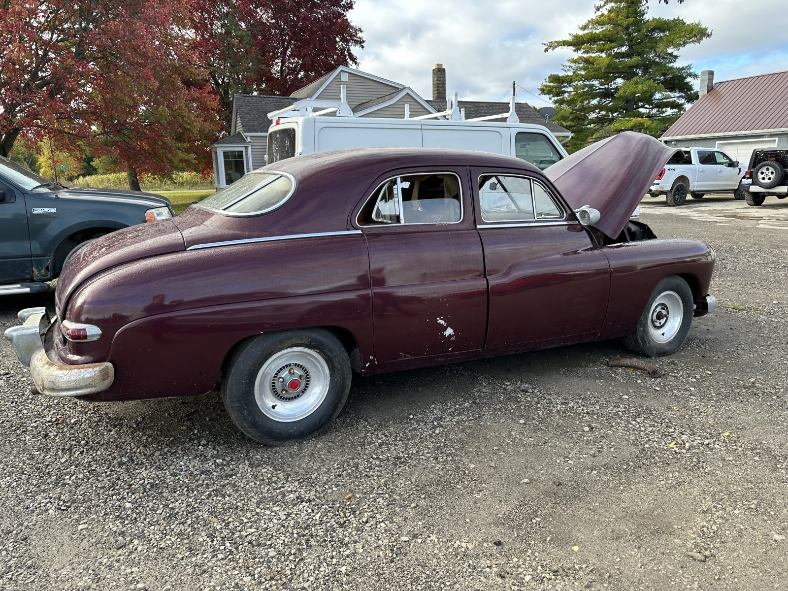

    Hey guys good morning, I’m fairly new here, first Time poster. I recently picked up a 49 Merc 4 door that has been sitting since 1994. The goal is to get this car road worthy in the next 3 months and get it to its first show. I’m slowly trying to get it running. I’ll be adding to this thread periodically so you guys can see the updates. And asking questions, I’m excited to hear some insight IMG_3162.jpeg IMG_3162.jpeg IMG_3162.jpeg IMG_3162.jpeg IMG_3167.jpeg IMG_3161.jpeg

    That’s in a lot better nick than I thought when I read barn find.

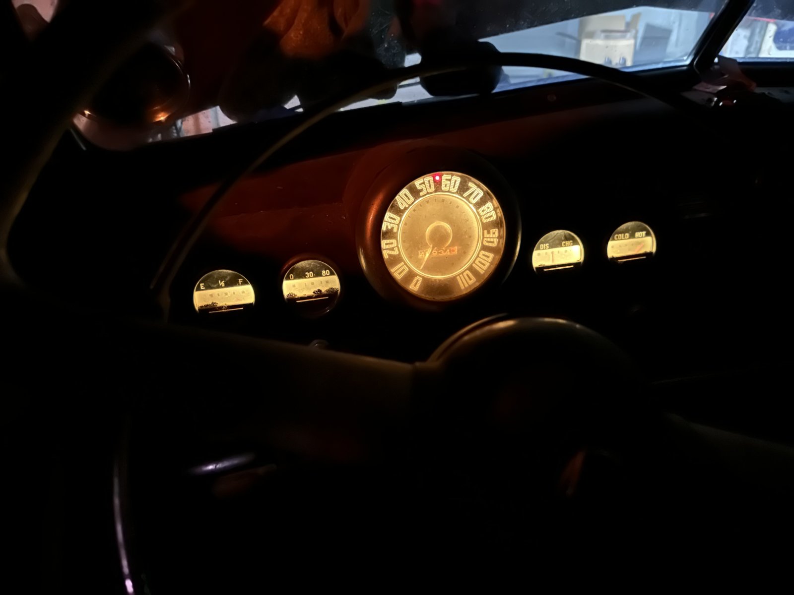

    Made some progress last night, finally got the motor to rotate with it all back together. Replaced the solenoid, points, condenser, rotor and coil. However I’m still on the hunt for spark. The wiring inside the distributor seems highly suspect as well as the wiring to the coil. Any thoughts? Also I found out my cluster lights work

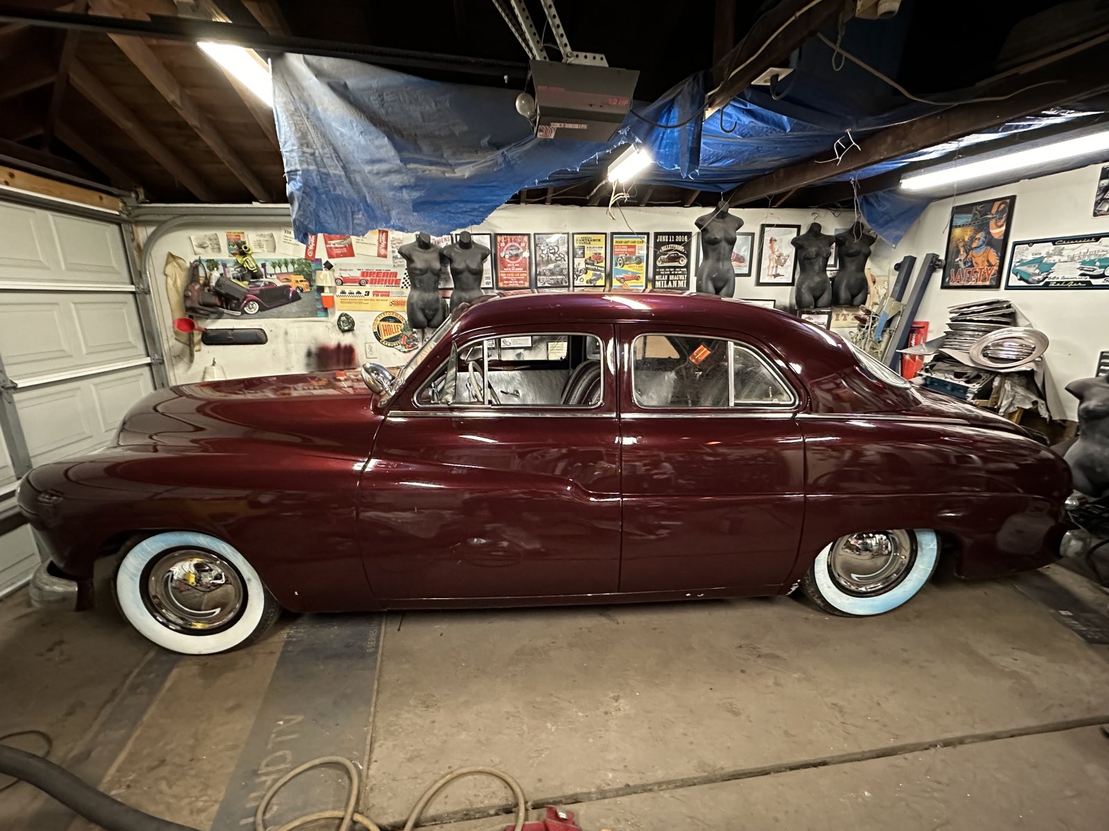

    I got to spend a little bit of time with the car today. I’m waiting on the last of my parts to arrive but I couldn’t wait any longer. Brakes are ready to be plumbed, new tires installed, drivers door repaired and lowered 4” in the rear today. Plan is to level it out and get the front down a bit. Unfortunately the car still isn’t running but it is close. I dropped the distributor off with bill at Brother’s Custom Automotive to have it rebuilt, so it’s ready to install. I should be seeing brake lines and fuel lines in the next couple of days, plus I have a new gas tank to install as well. It won’t be much longer here and I can focus on the interior and exhaust! IMG_4146.jpeg

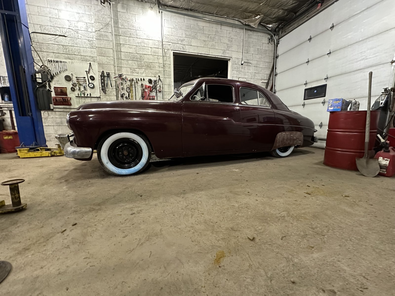

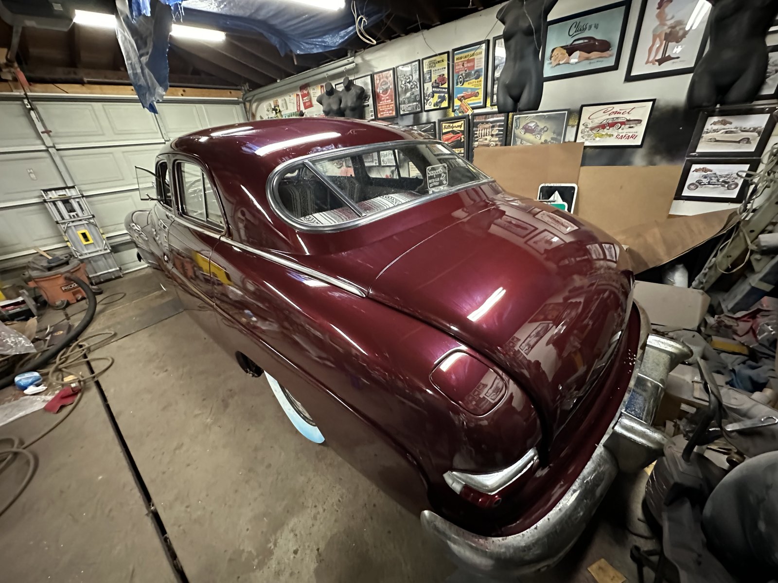

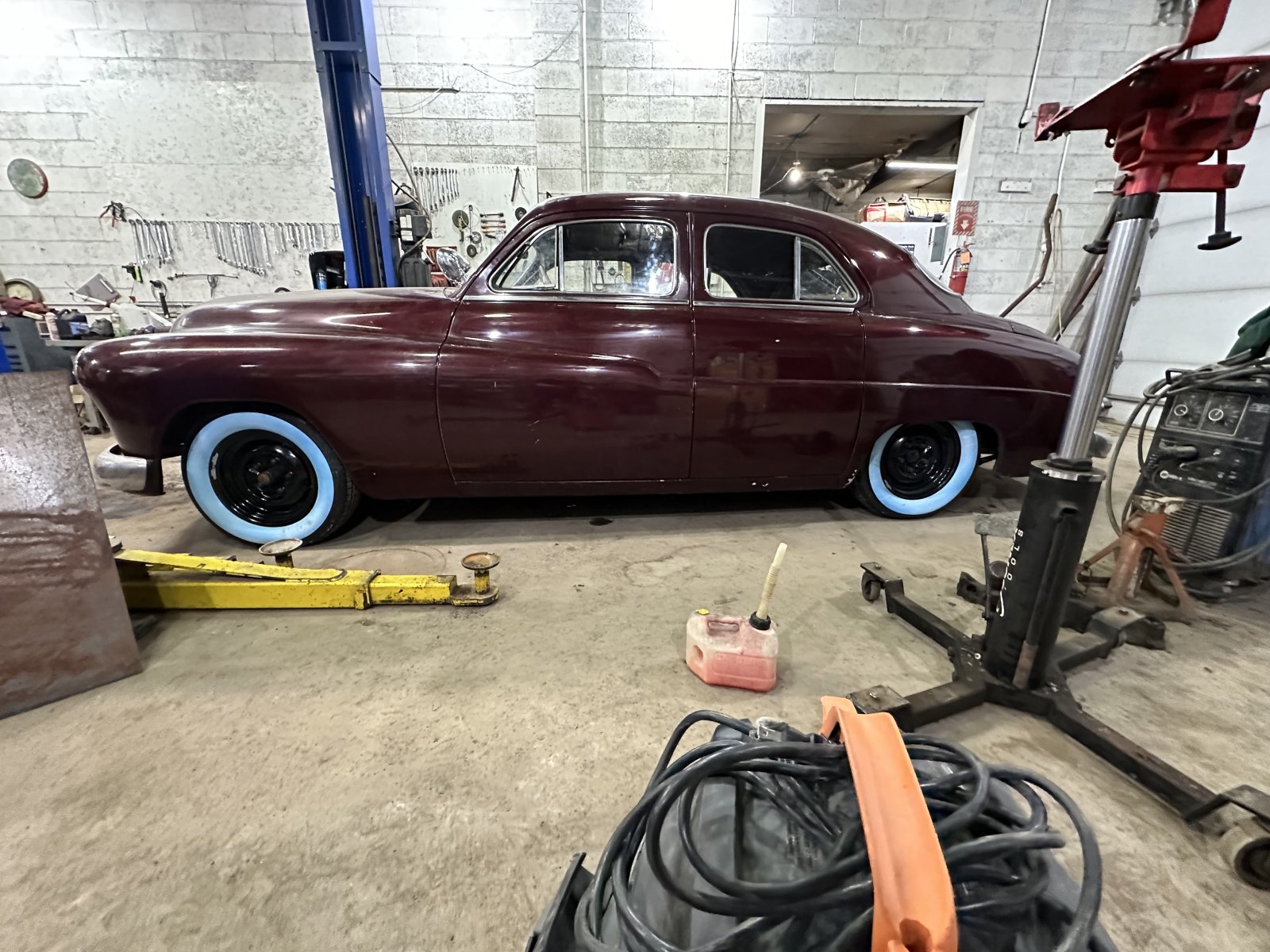

    Managed to drag the car over to my uncles shop this weekend and made some major progress. Just waiting on a fuel pump to be delivered. And to touch on the subject of the mannequins, I picked them to flake and throw down some candy on for this year’s panel jam. But the car has kept me a bit occupied so I have had a chance to get to them IMG_4267.jpeg

    Already looking better than when you found it for sure.

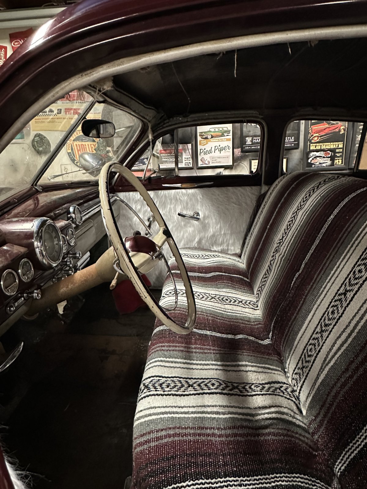

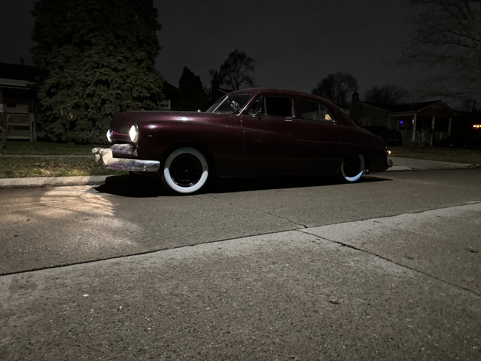

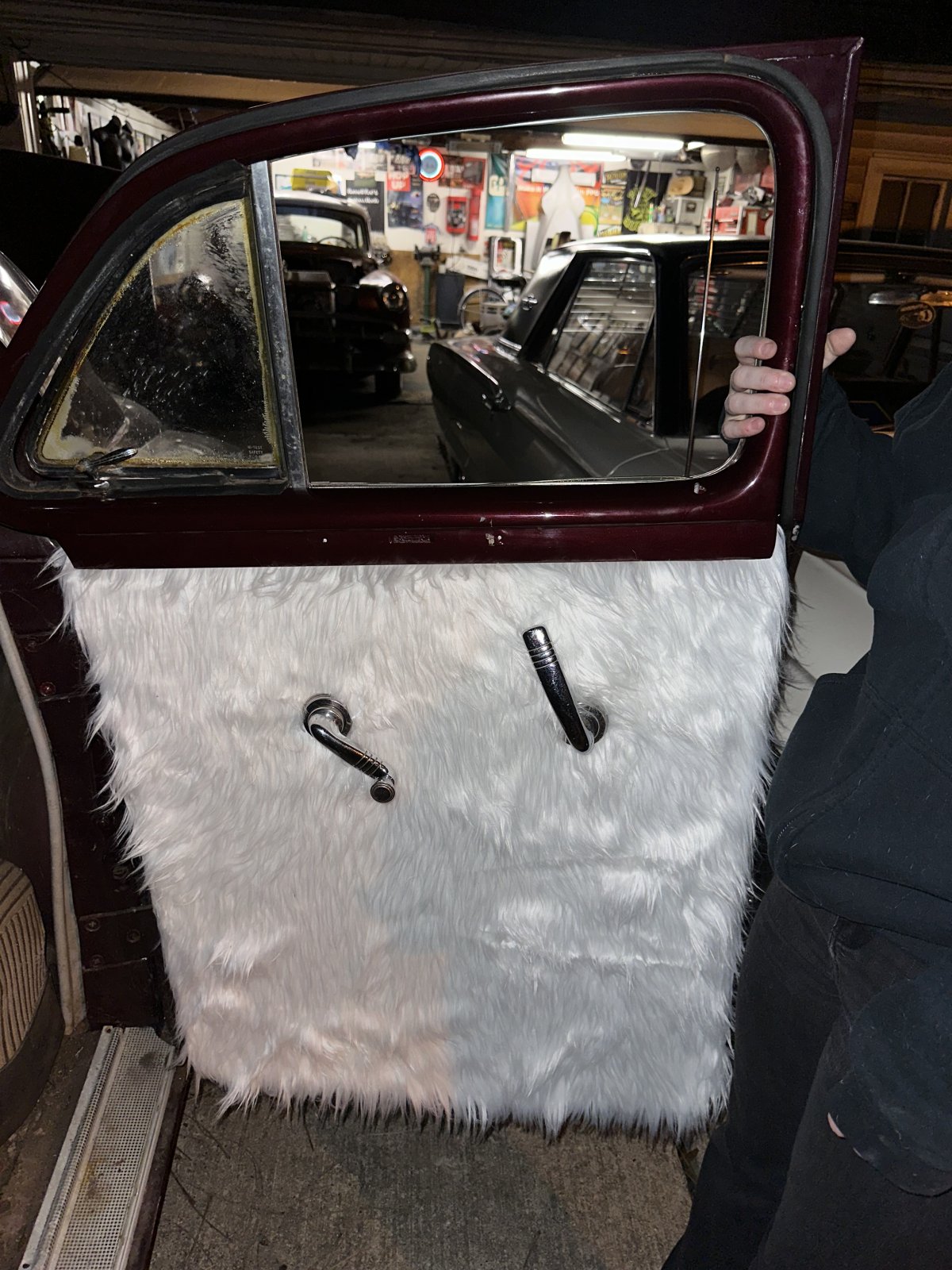

    Slowly making progress, I drove the car for the first time Saturday night. Rode great and drove straight. It still has a hefty miss. I started working on the door cards Sunday and finally finished up tonight. Should be able to get them in with this odd 60 degree day we’re going to have here in Michigan tomorrow.

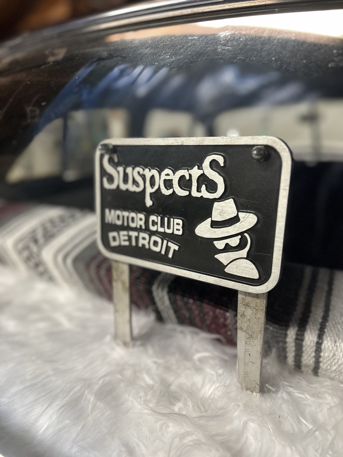

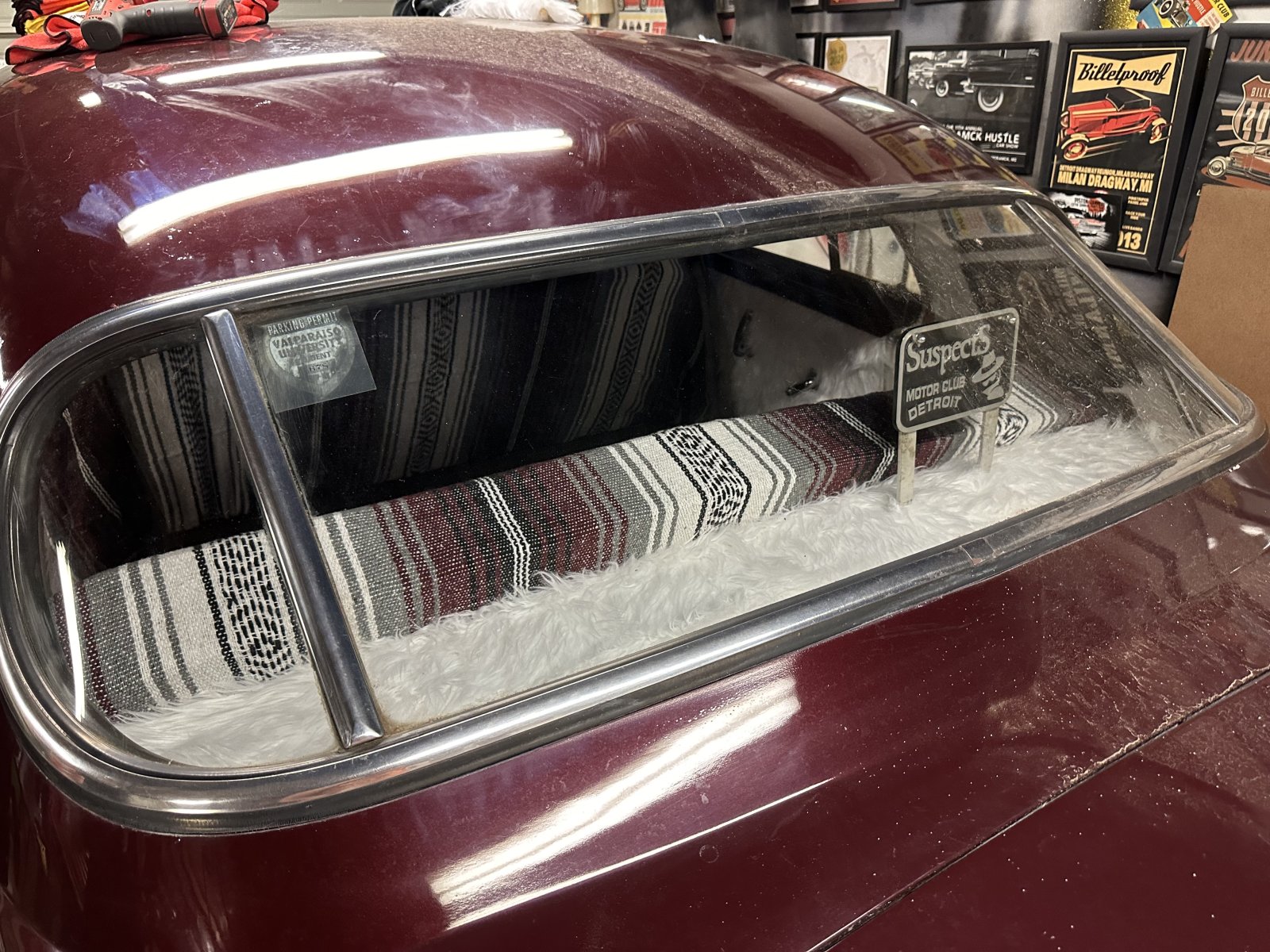

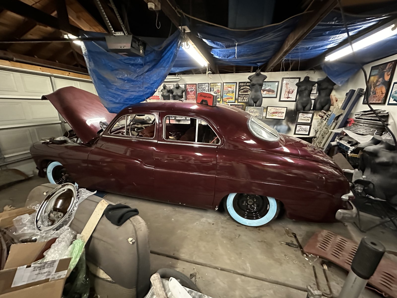

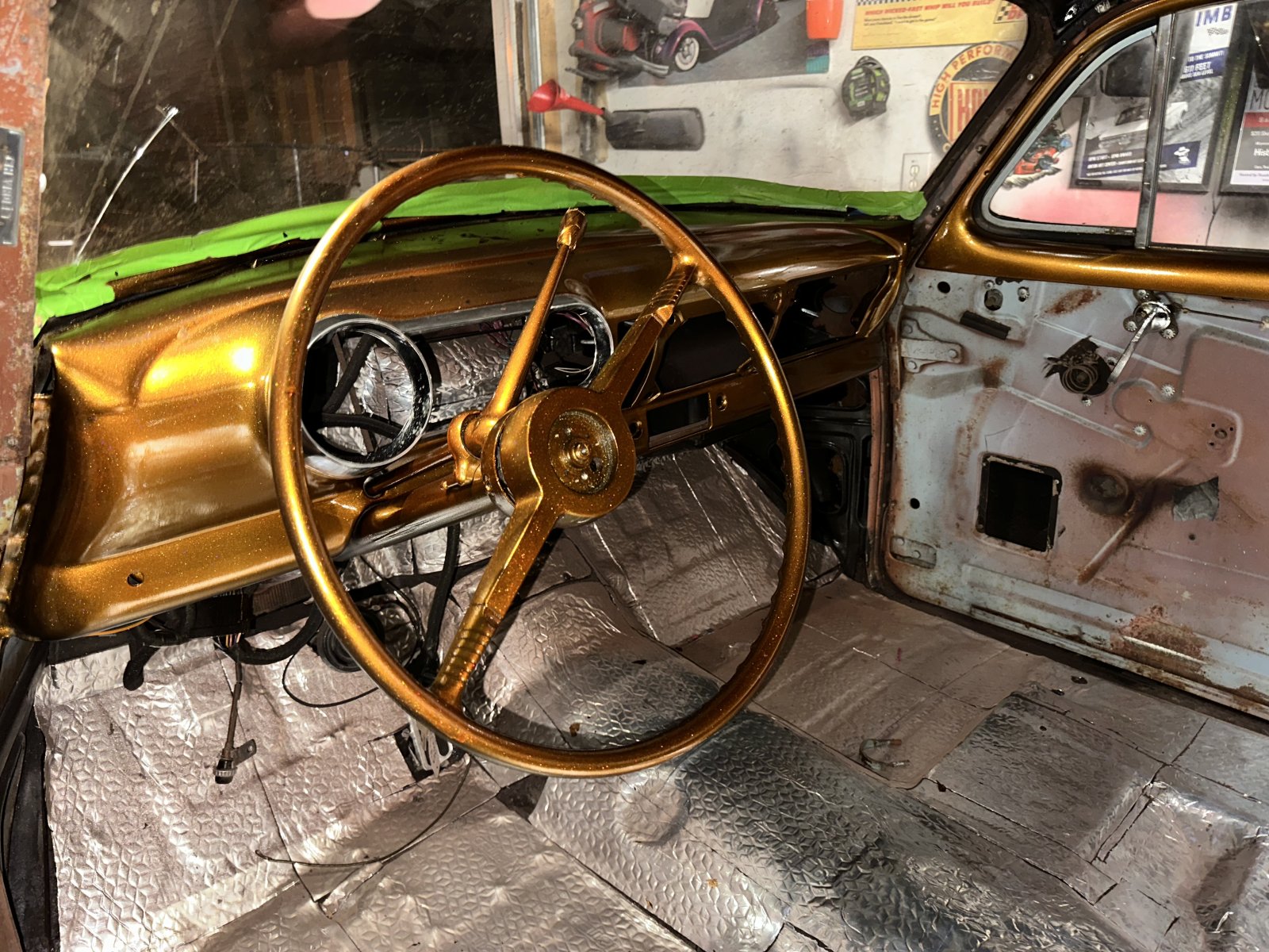

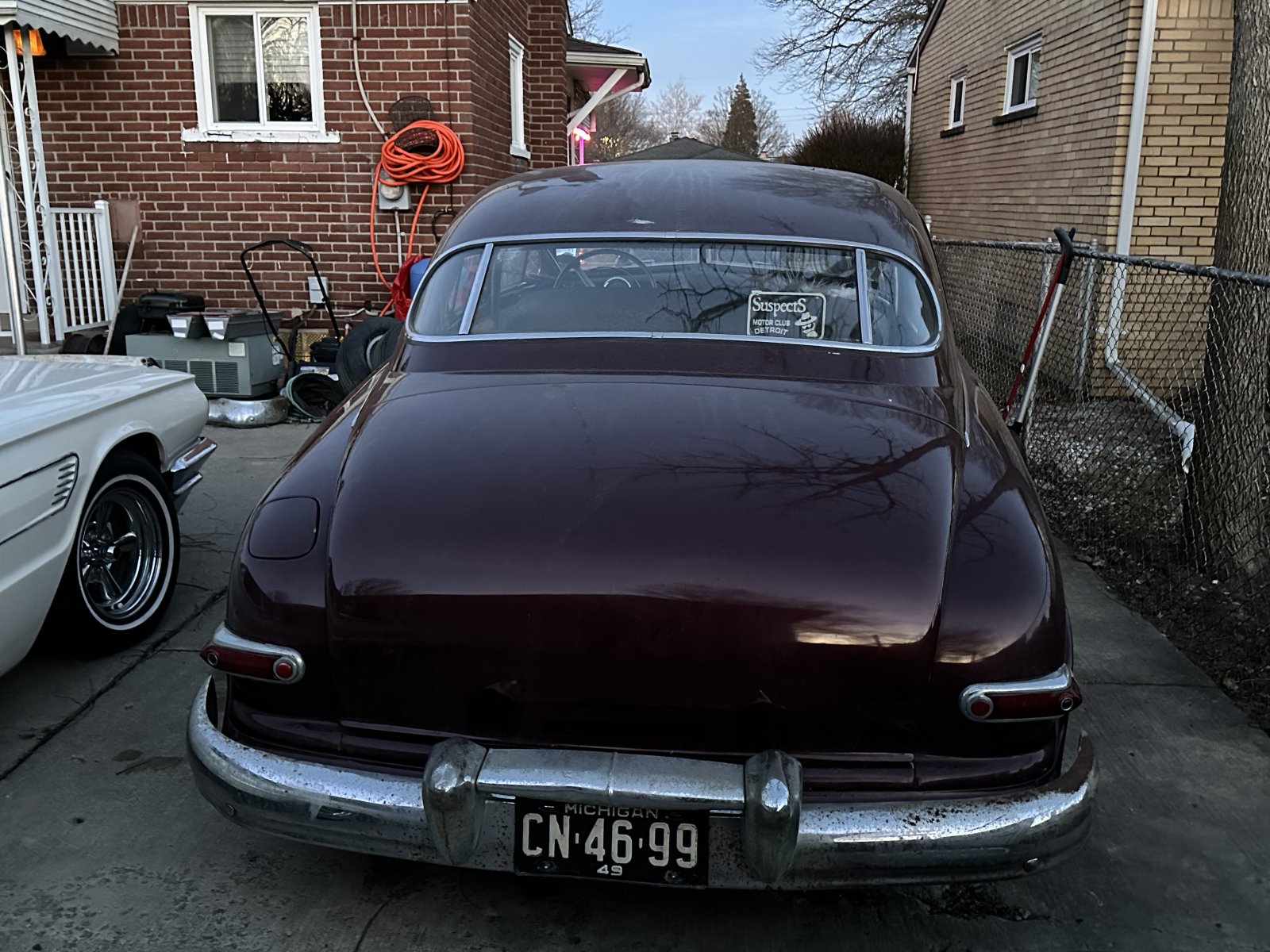

    Spent just a little bit of time with the car this past week, but got side tracked painting a dash for another autorama car, we’ve got 13 days til move in. Interior is moving along nicely. Door cards are in and I’m getting ready to start the package tray. Club plaque is mounted and I still need to cover the seats. Found the heater core has sprung a leak and the generator isn’t charging. IMG_4413.jpeg IMG_4411.jpeg IMG_4427.jpeg IMG_4428.jpeg IMG_4471.jpeg IMG_4470.jpeg IMG_4464.jpeg

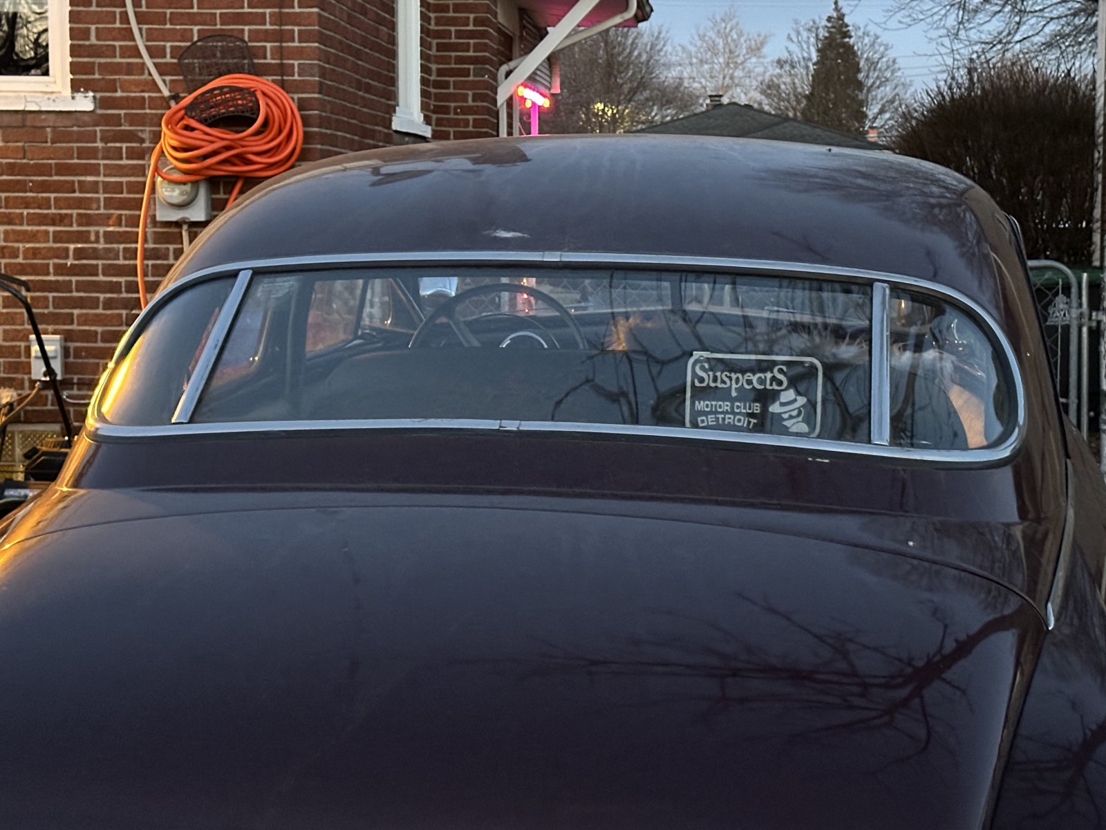

    Hmm...seeing the plaque in your back window leads me to believe that I will likely meet you in a couple weeks... My brother is also in the Suspects.

    And you need to post pics of the womakins once you get them painted!

    That dash looks fantastic!

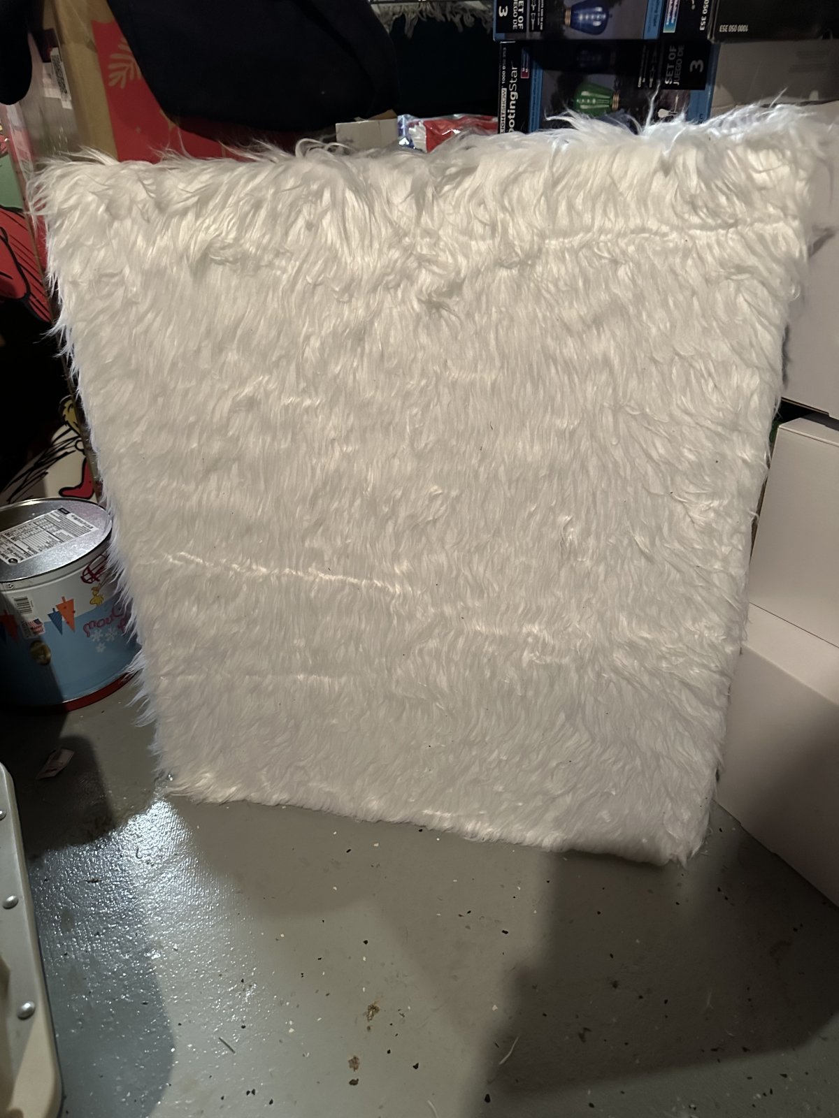

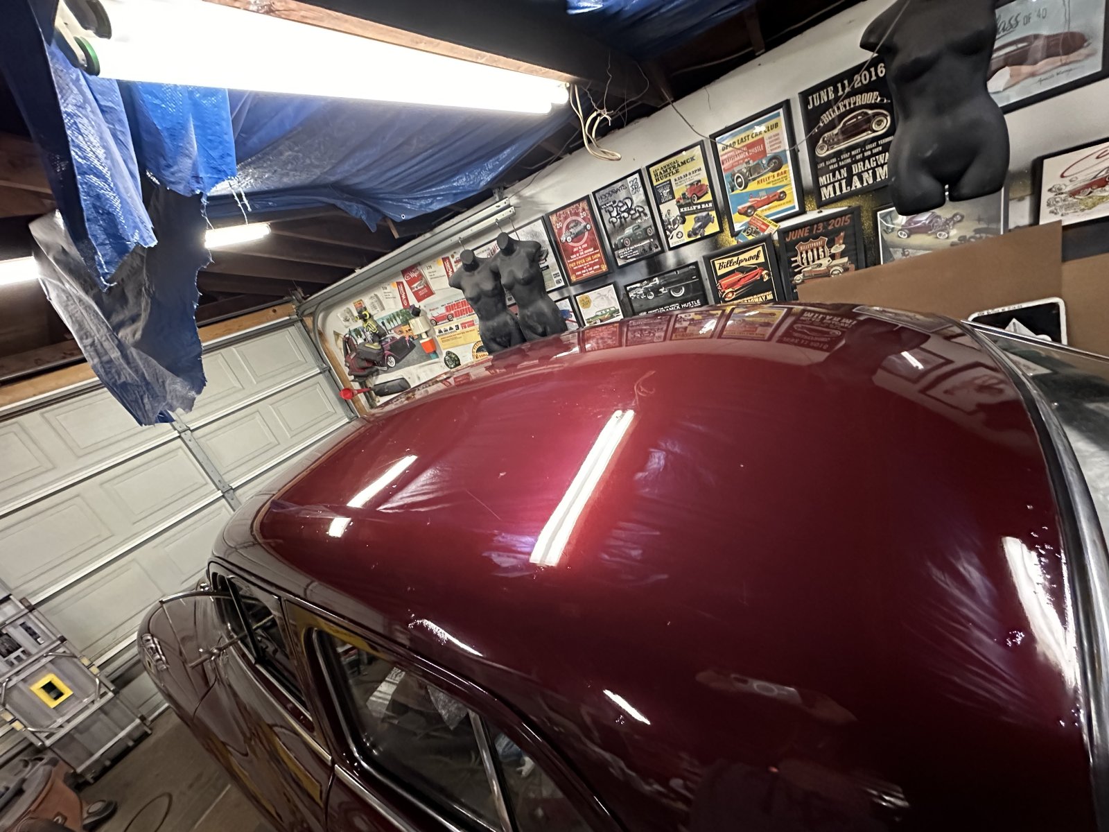

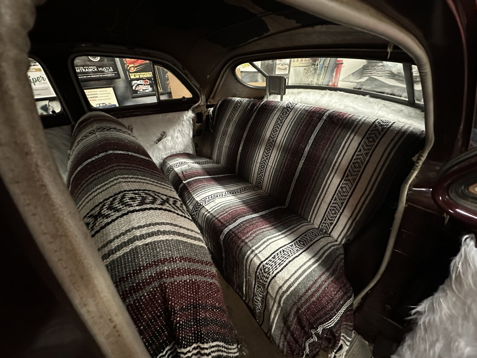

    Spent some more time with the car this week. Covered the seats and finished putting fur into the package tray. I’m currently in between jobs so I spend all day Tuesday polishing the car. It’s really come around. I still need to spend some time polishing the chrome but so far I’m happy with the progress. We had a 60 degree day here in Detroit so I ran the car down to the car was and rinsed it off. We did block off the heater core as well. Tomorrow I’m going to take a look at the generator and possibly rig up some exhaust to keep the fumes down. I did try to paint the skirts last weekend however I had an odd chemical reaction which caused them to shrink and start to lift. I’ll probably figure that out also IMG_4500.jpeg IMG_4506.jpeg IMG_4507.jpeg IMG_4515.jpeg IMG_4539.jpeg IMG_4543.jpeg IMG_4542.jpeg
