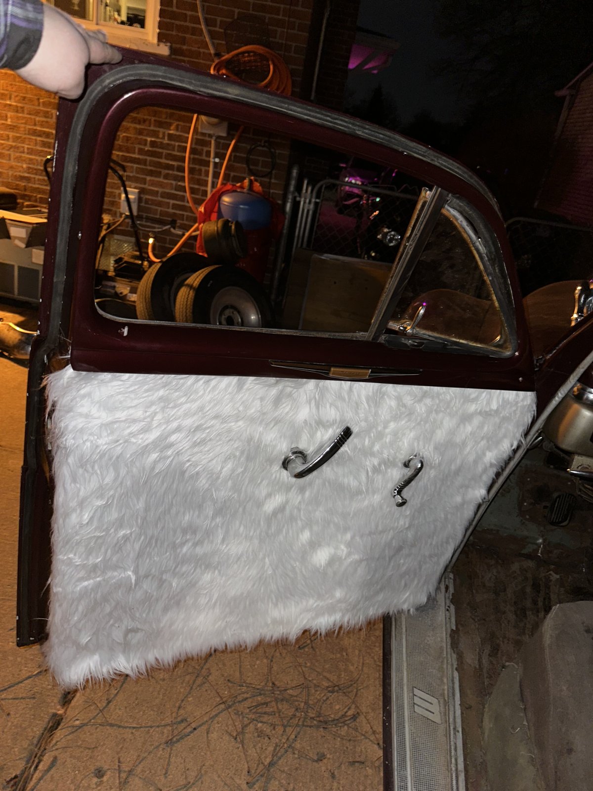

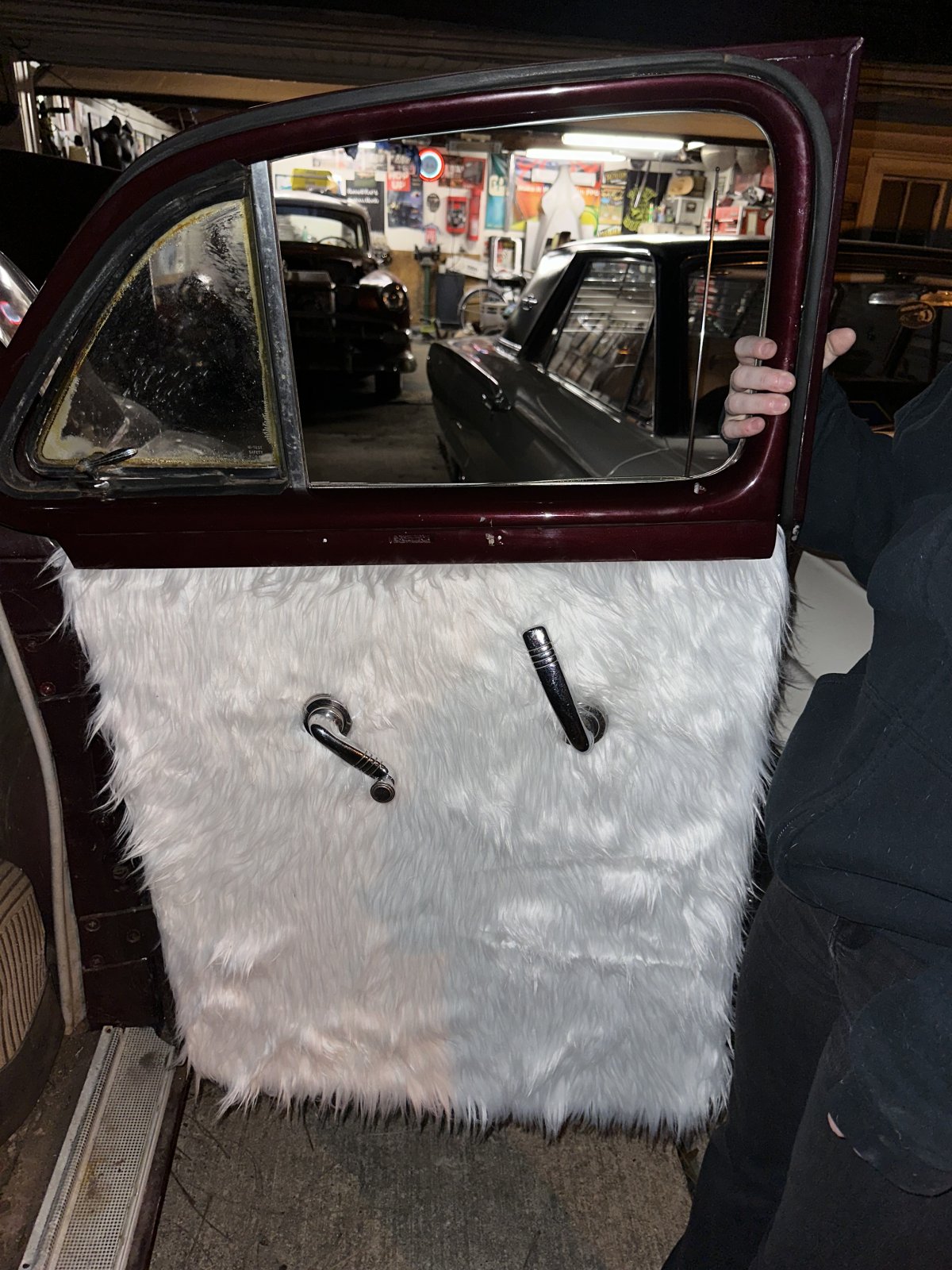

    Looks like it's cleaning up nice. If your blanket seat covers move around on you a lot when you drive the car, straighten out some coat hangers, weave them into the blanket around the front, back and sides where it tucks under the seat frame, and hog ring them into place just like the factory seat covers. It's a way to get them good and tight and they will stay put that way.

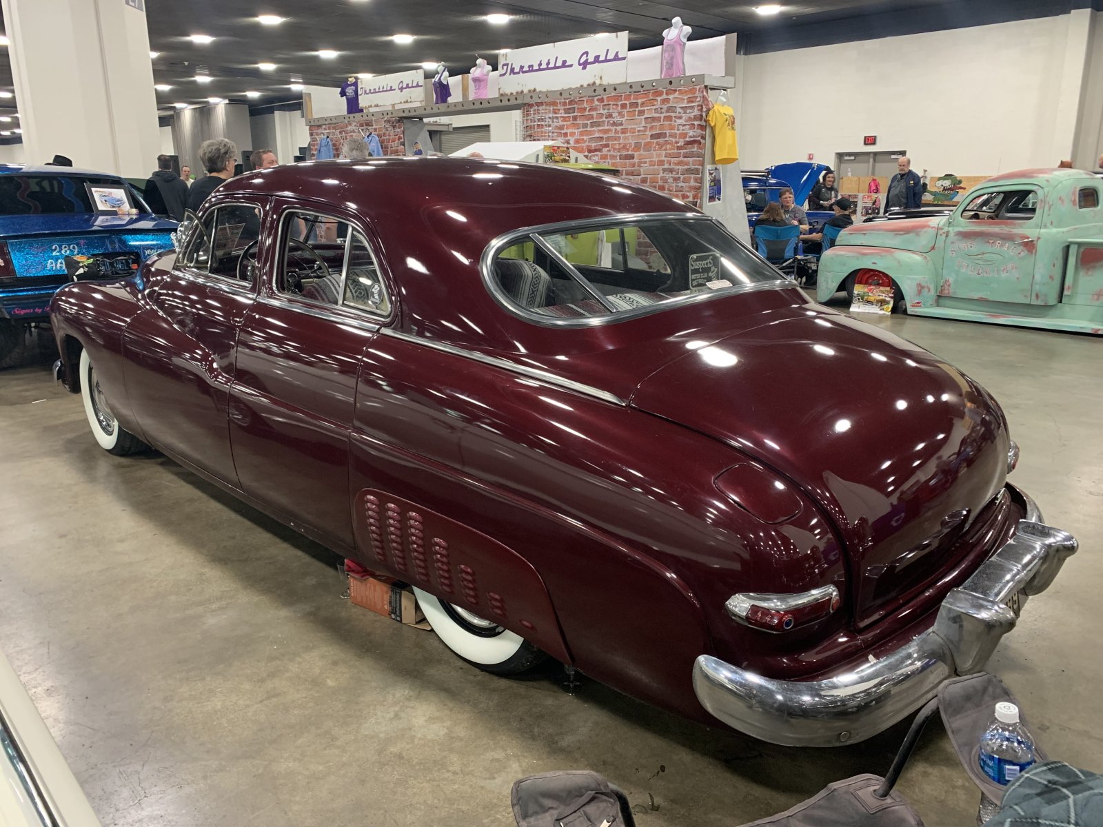

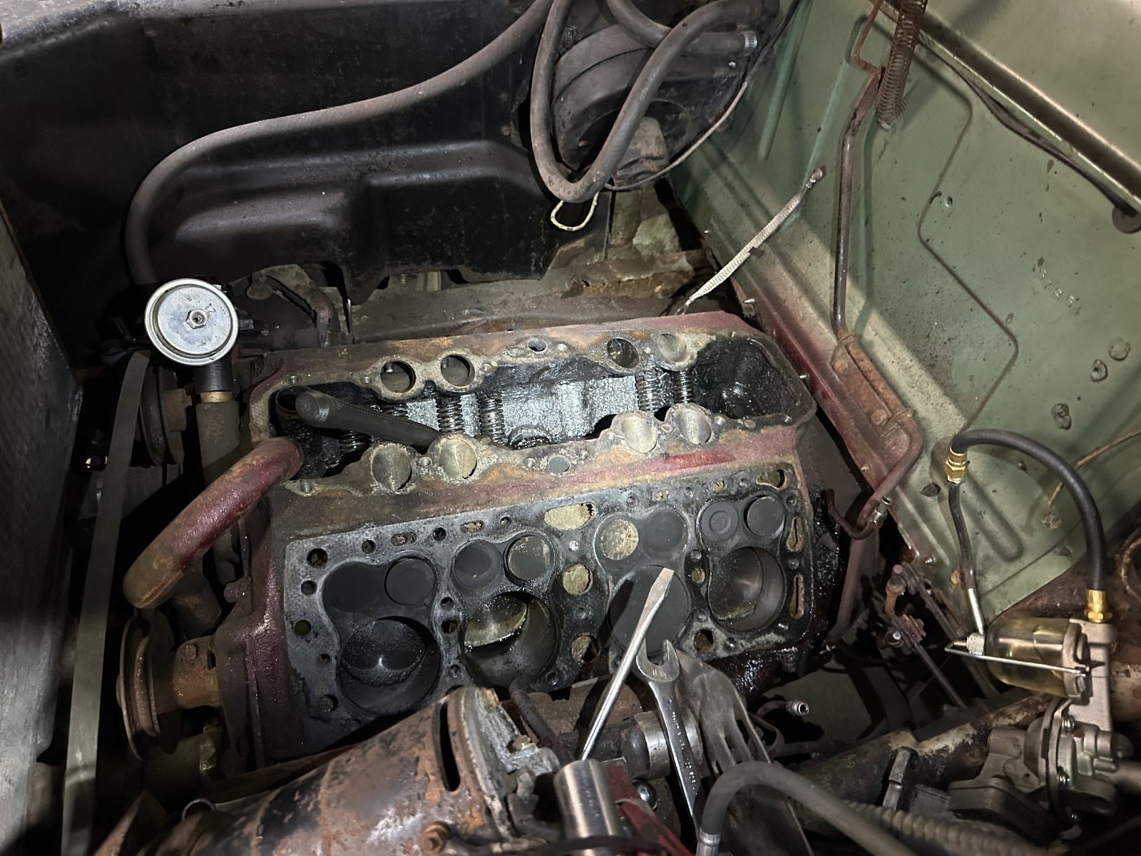

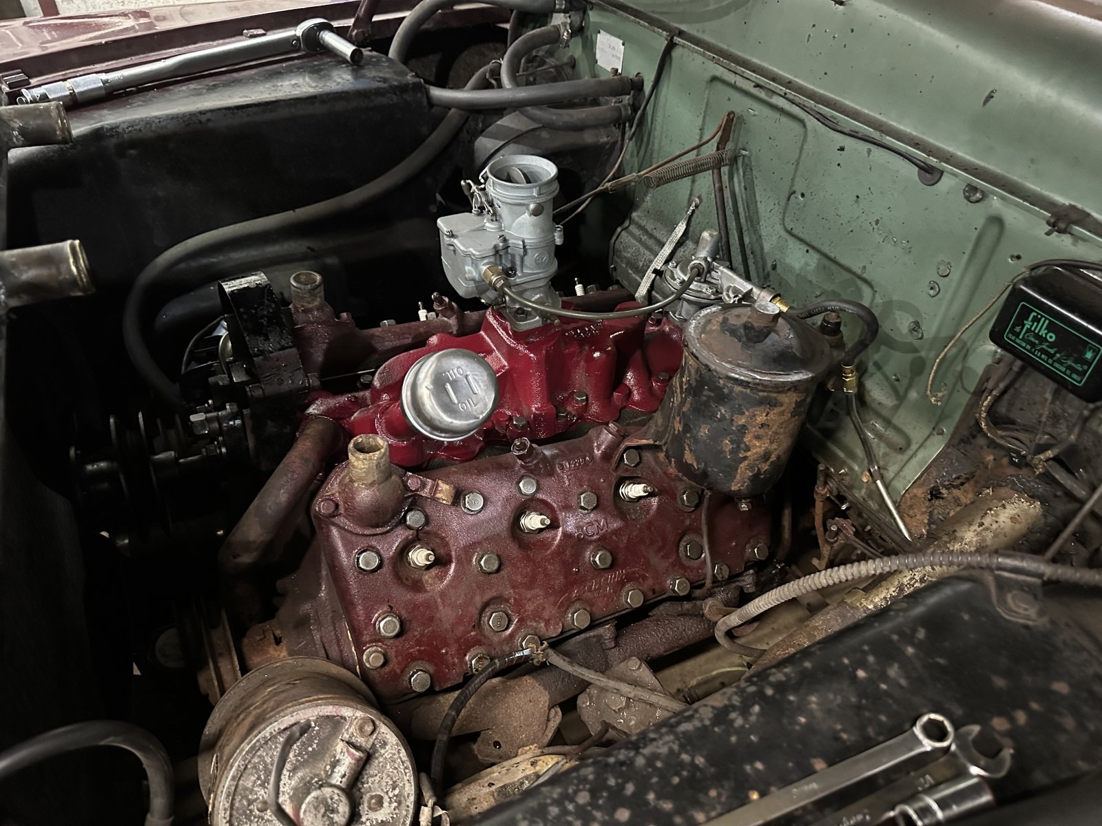

    The car got a great response at the show, still having engine troubles, thinking about pulling the heads and intake again and pulling all the valves and cleaning them up IMG_4643.jpeg IMG_4646.jpeg IMG_4666.jpeg

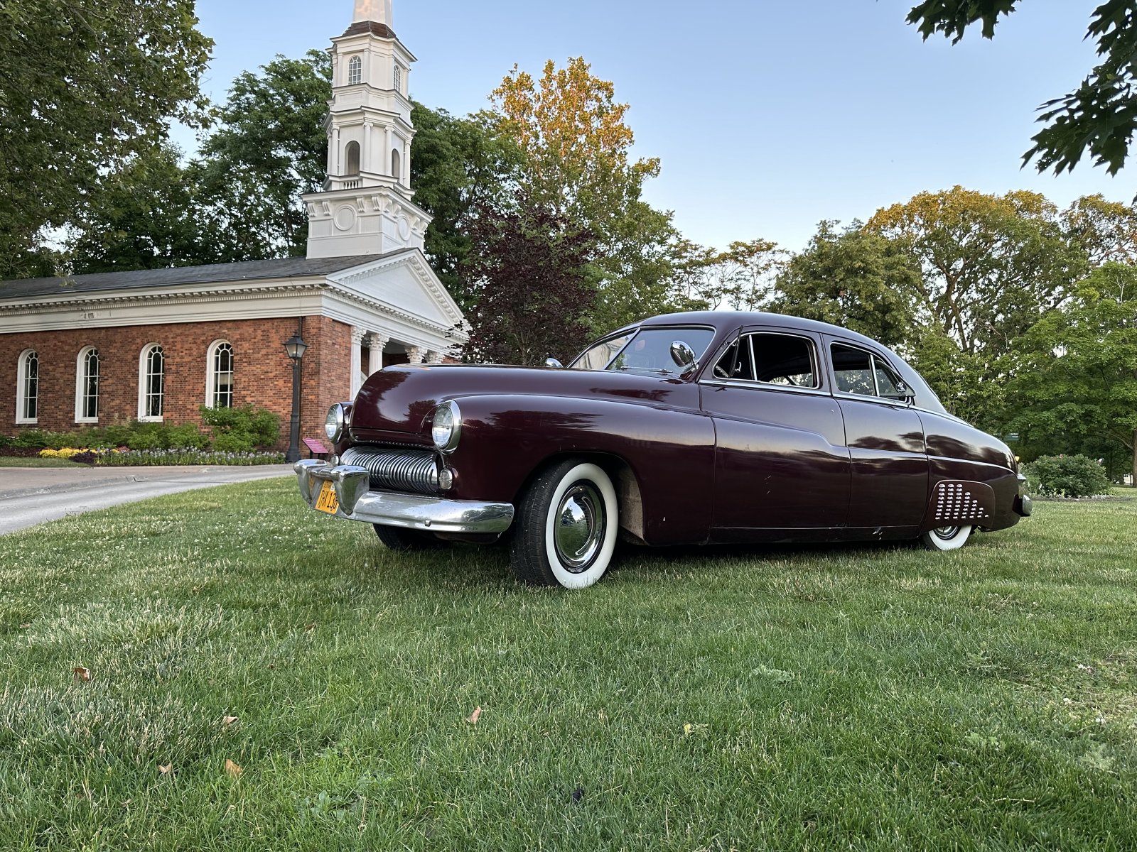

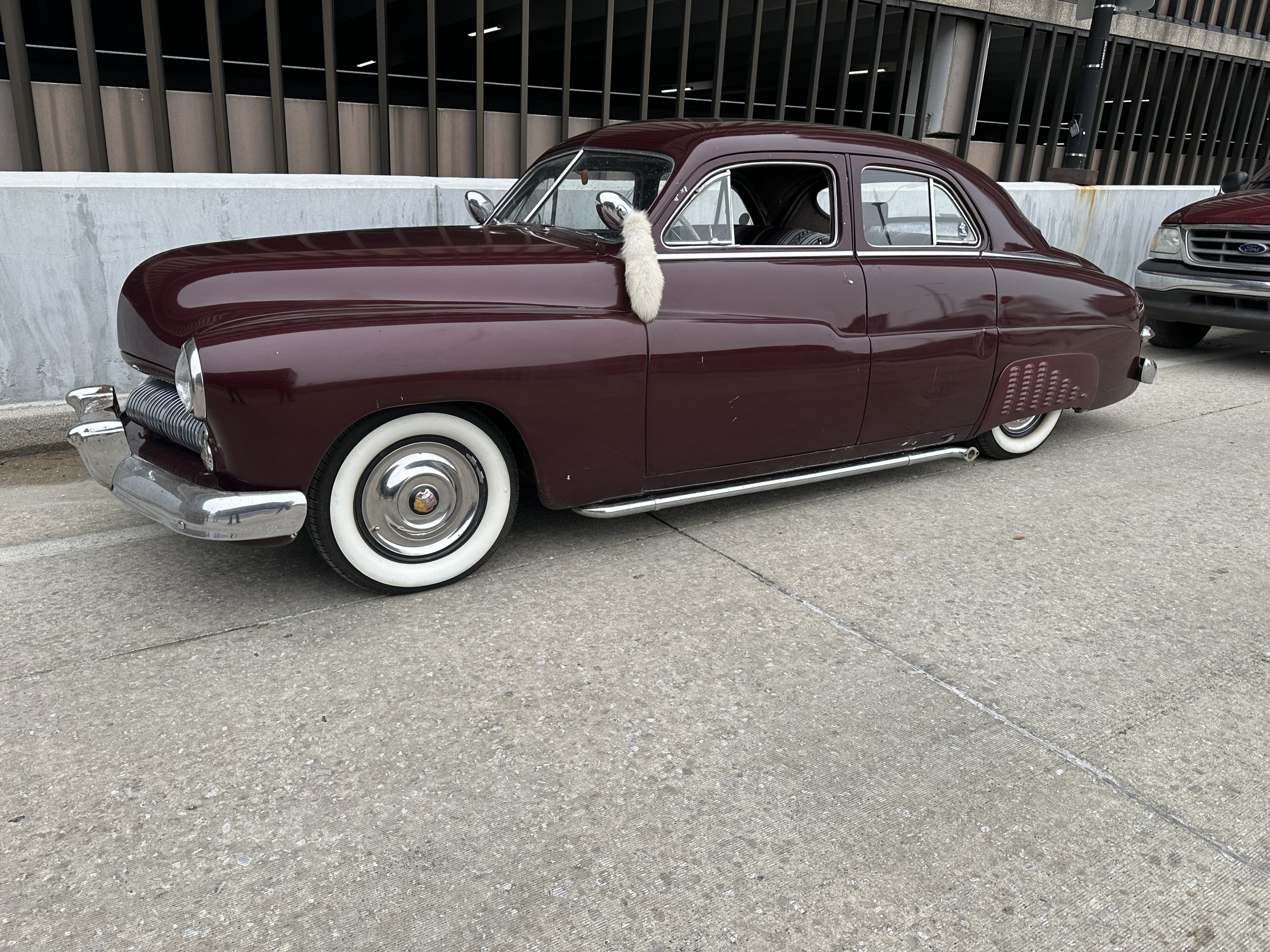

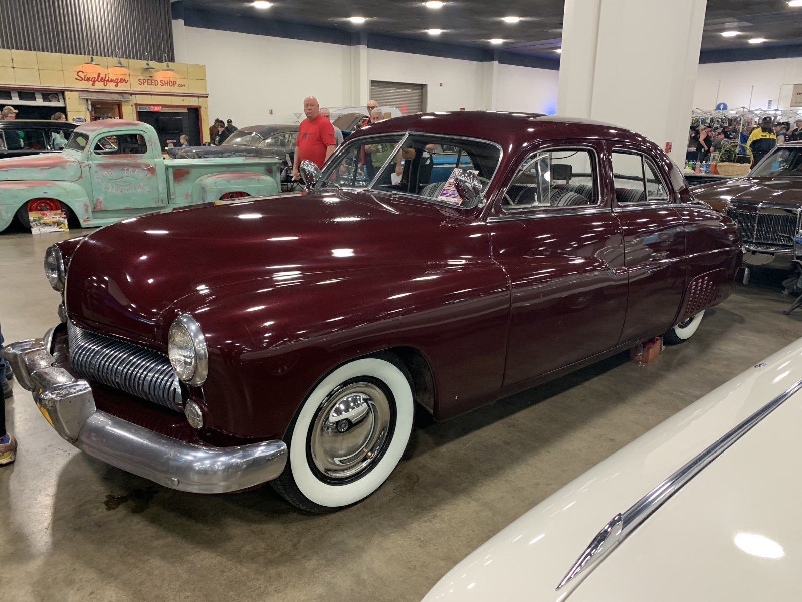

    Yep, looked good and great hanging out with you over the weekend! Here are a couple of the pics I got of your car. I still can’t believe the deal you got on it… :D

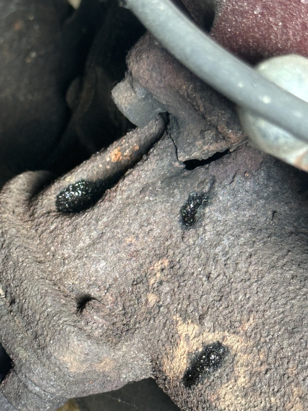

    I’ve been spending a little more time with the merc here the last couple of weekends. The number 3 cylinder never did free up and I found that the number 6 cylinder was very low on compression. The carburetor was also on its way out. Jerry and I pulled the heads off last weekend and started digging into my compression issue. 3 bent valves and a burnt valve ended up being our issue. We picked up a handful of valves, copper head gaskets and a stromburg 97 from an old timer in Detroit Monday. We lashed the valves and freshened up the seats and got the new valves installed. Cylinder heads and a stock 8ba intake went on, we replaced the stock 8cm intake to something that’s a little more user friendly. Taking the generator to have it tested this week, hopefully come next Saturday I may get a good first test drive without it back firing from both ends! IMG_4789.jpeg IMG_4793.jpeg IMG_4723.jpeg

    The Mercury water pumps put the motor mounts in a different position than the Ford ones do, that's why hot rodders using the Mercury engine swap the pumps out for Ford ones (please correct me if I'm wrong, I often am) so if you order new Ford pumps they'll fit on the engine but the motor mounts won't line up anymore.
    I don't know your car well enough to say, and I'm sure some others here will have different stories and opinions, but in my experience, every overheating flathead issue (and most old car overheating issues) was tracked back to a shitty old radiator. Sure it might not leak, but when they get old, they lose a lot of cooling capacity due to buildup inside or whatever.
    The new aluminum radiators you can buy are not very attractive in an old car, but they do cool with incredible efficiency, and they're pretty damn cheap. What are you running for a radiator?

    Put a known good mechanical temp gauge on first to see what your engine is reading.
    On my '49 ford I did a lot of head scratching and fucking around trying to solve my perceived "hot engine" woes only to find it was a bad sender reading much hotter than the engine truly was.
    Try Shay @ Pre60's Auto Supply (just north of you across the bother) he may have some merc pumps for you.

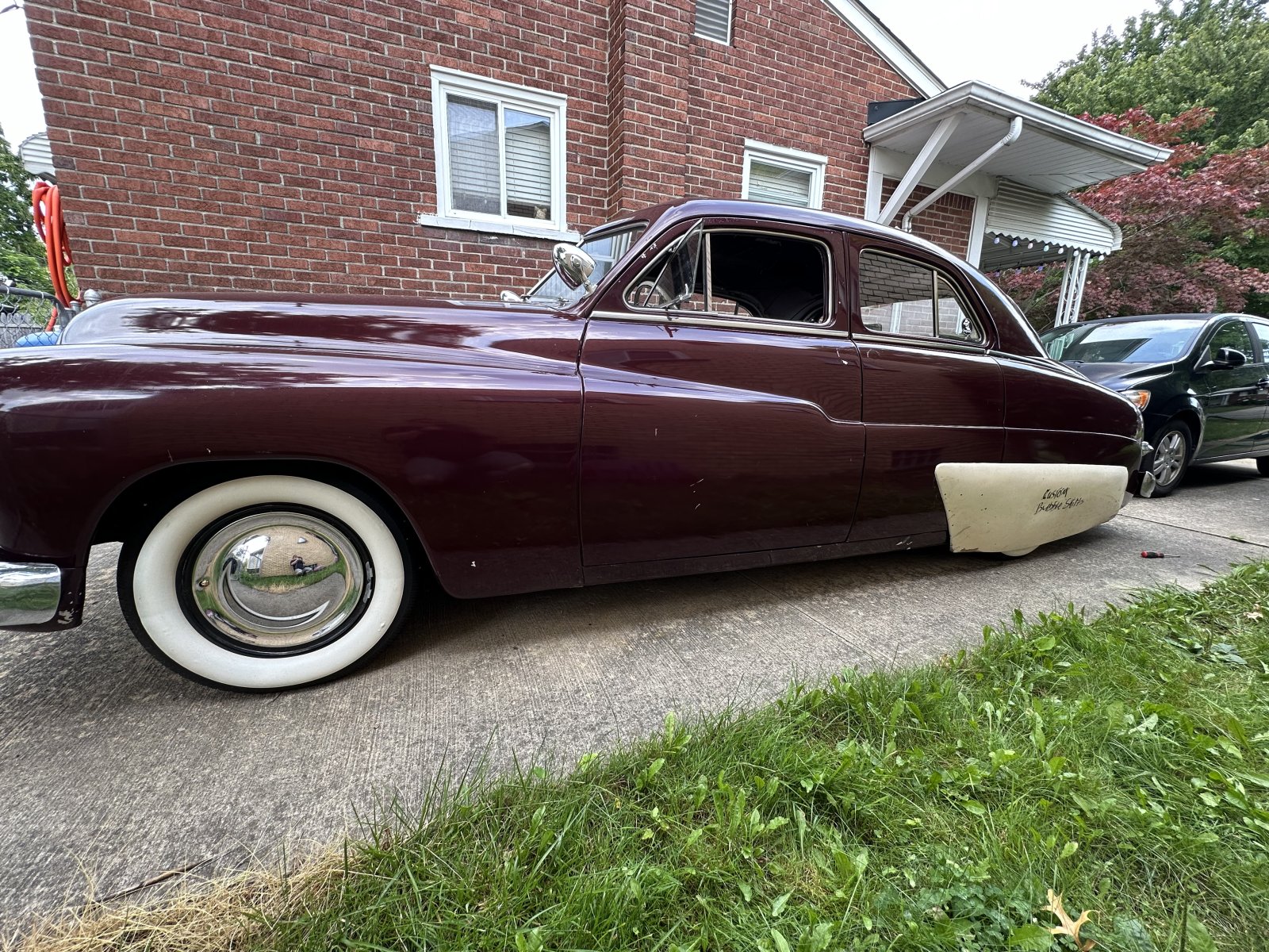

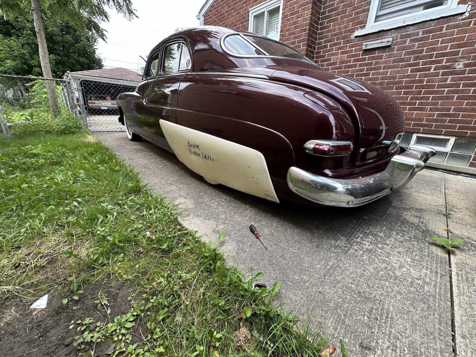

    IMG_5748.jpeg IMG_5747.jpeg Also scored a set of bubble skirts today. They have the right look but I’ve got too many doors
  14. Smokeshow
    Joined: Oct 2, 2011
    Posts: 272
    Smokeshow
    Looks like you are taking the old girl in the right direction! You have taken it along way in just a short time.
  15. I dig those skirts!!!
    Maybe @anthony myrick can chime in with some suggestions on the skirts on a four door.
    anthony myrick likes this.
  16. guthriesmith
    Joined: Aug 17, 2006
    Posts: 11,762
    guthriesmith
    Just need to tell everyone they can’t use the back doors. :D I like the look of those skirts on it. :cool:

    I have to disagree about those skirts.:(
  18. Yea. Cut em
  19. Okie Pete
    Joined: Oct 29, 2008
    Posts: 6,044
    Okie Pete
    I like the shirts . Maybe attach them to the rear doors and cut them at the door gap ?

    I’m not sold on the skirts myself but I couldn’t beat the price

    I love your 4 door Merc, and the skirts too. I like the idea of cutting the skirts on the door opening. Once they are color matched they would look great!

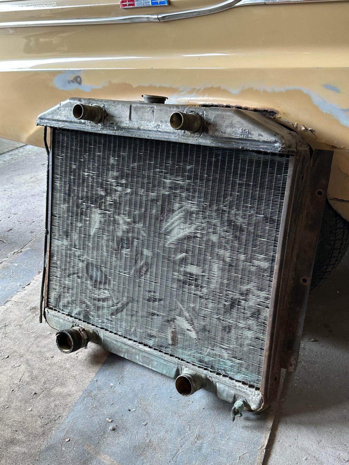

    Slow progress is better than no progress, decided last week I was going to break down and order an aftermarket radiator for the merc. While the parts were in the mail I went and snagged a flush kit from the local auto parts store and drained the radiator. Yesterday I pulled the radiator out of th car, no wonder it wasn’t cooling, half the fins were smashed. Checked out the insides of the water pumps without removing them also and they looked decent. I drove the car for the first time yesterday in over a month more than 5 miles without any sort of issue overheating. It runs about 3/4 temp on the gauge but with a temp gun shows 185-195 on the head. Sorta thinking I should have put a 160 thermostat in it instead of the 180s. IMG_6034.jpeg IMG_6025.jpeg IMG_6024.jpeg 76872F1A-E927-4F29-8A8F-4D77061402D9.jpeg IMG_6028.jpeg

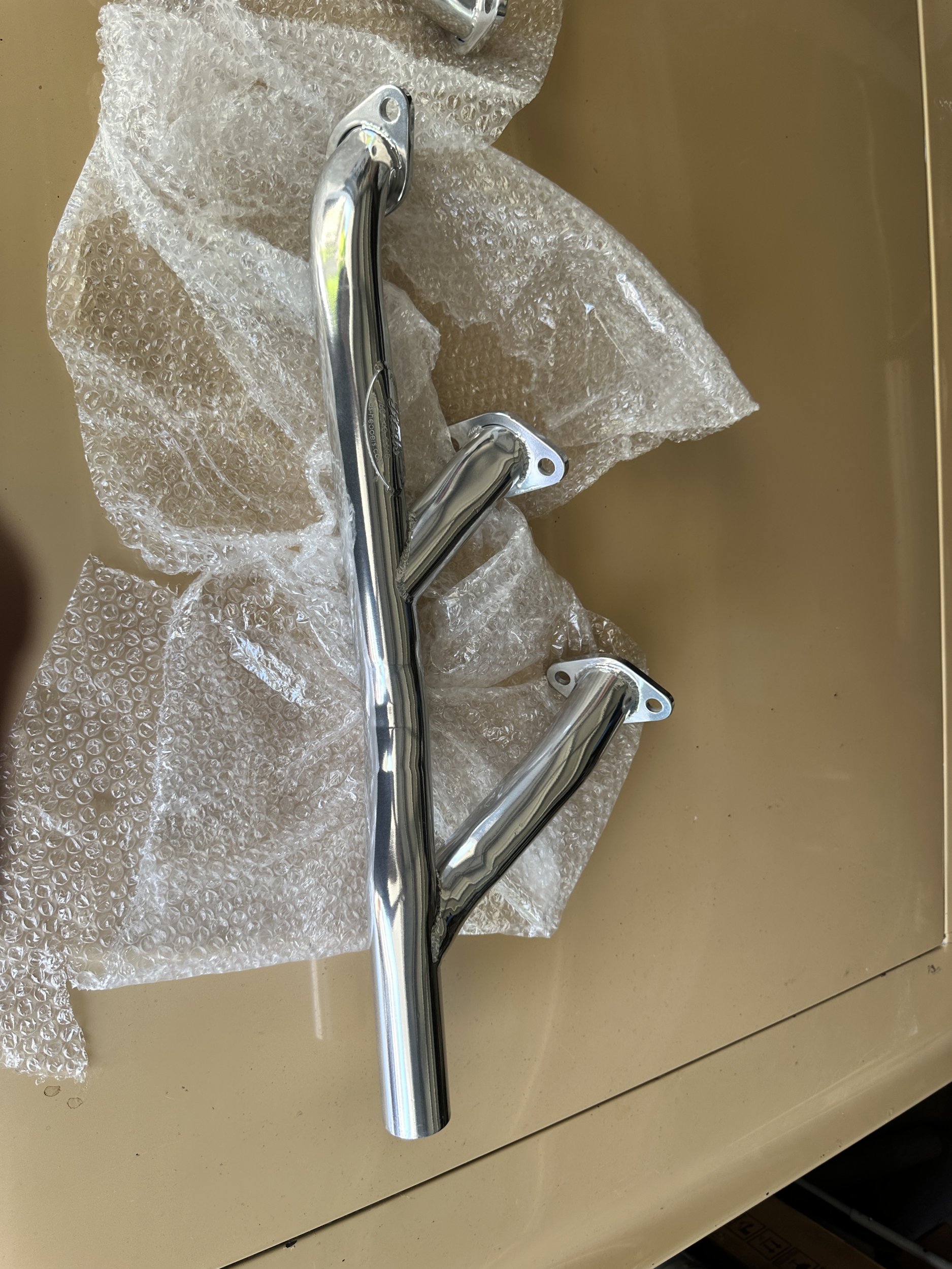

    I suppose the next venture i plan to tackle is exhaust. Been doing some reading on here about manifold/headers. But nothing about fitment, I’ve heard the original fenton’s fit perfect but the repops don’t. However when comparing photos they look identical. I’ve got a buddy who swears by the redd’s but the fenton’s are more my budget. Any insight? The passenger manifold has a decent sized hole that pushing exhaust fumes into the fresh air box that’s desperately in need of a new seal, so all i get I fumes in the car while driving IMG_5753.jpeg

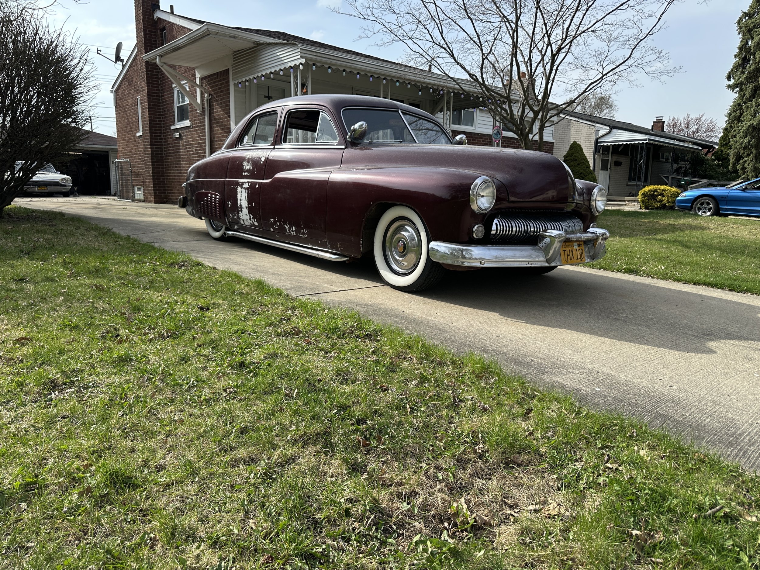

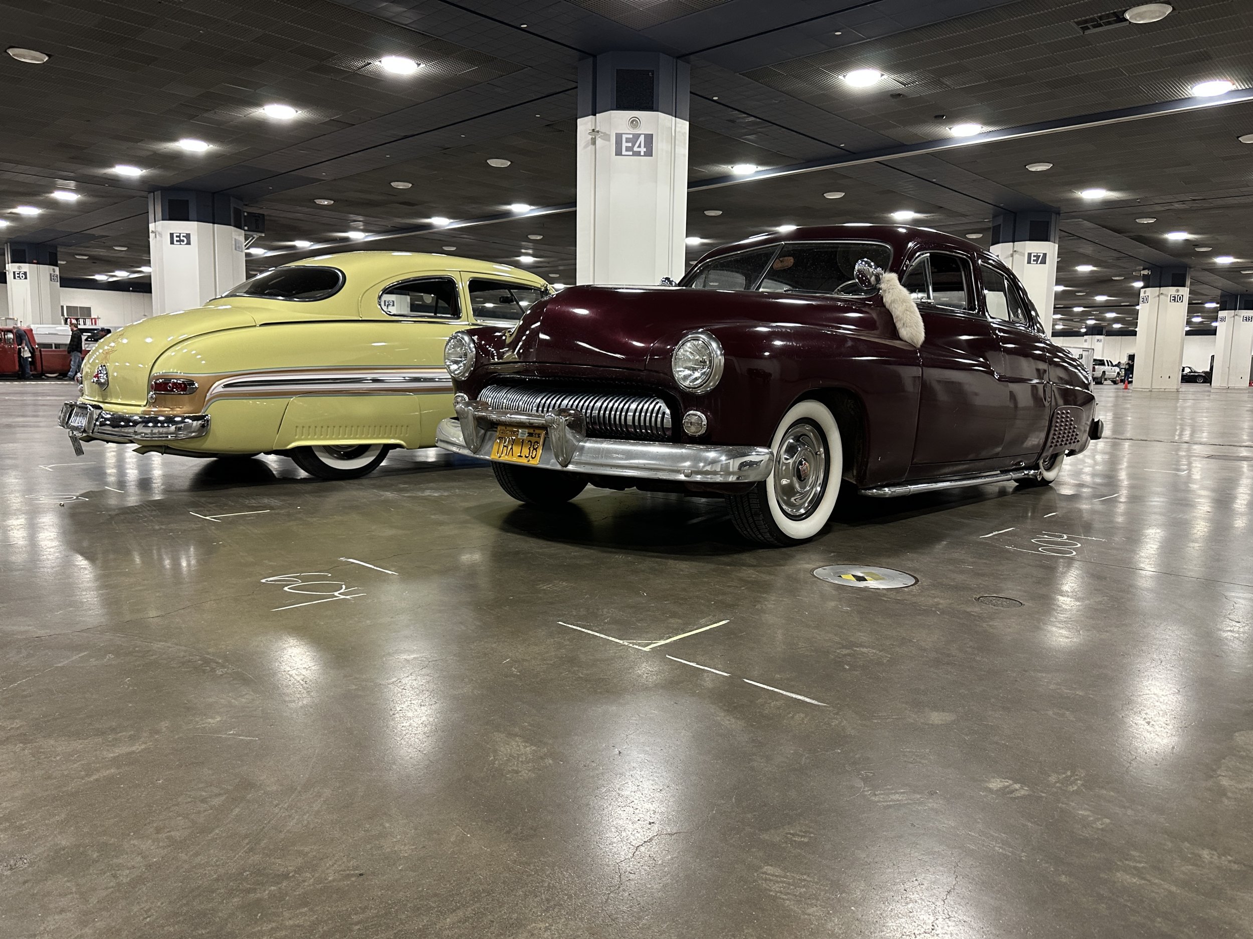

    IMG_7171.jpeg I’ve been slowly plugging along on this thing as spring is finally starting to show its face here in metro Detroit. The car did the Detroit autorama once again, this time I scrambled to throw a set of lake pipes 4 days before move in. I had a small scare when the drivers rear flew open on the drive into the show. I let it sit for a few weeks before throwing a set of Aerostar coils on the front. Talk about a difference in right height! And in the last two weeks the biggest milestone, insurance and hopefully soon, registration! I’ve got a set of reds headers on the way and an induction heater to hopefully make the removal of manifolds go as smooth as possible. I may actually get to enjoy the car this summer! Once this thing is finally dialed I may finally get around to some long awaited maintenance my Thunderbird is looking for IMG_7166.jpeg IMG_7291.jpeg IMG_7490.jpeg IMG_7491.jpeg

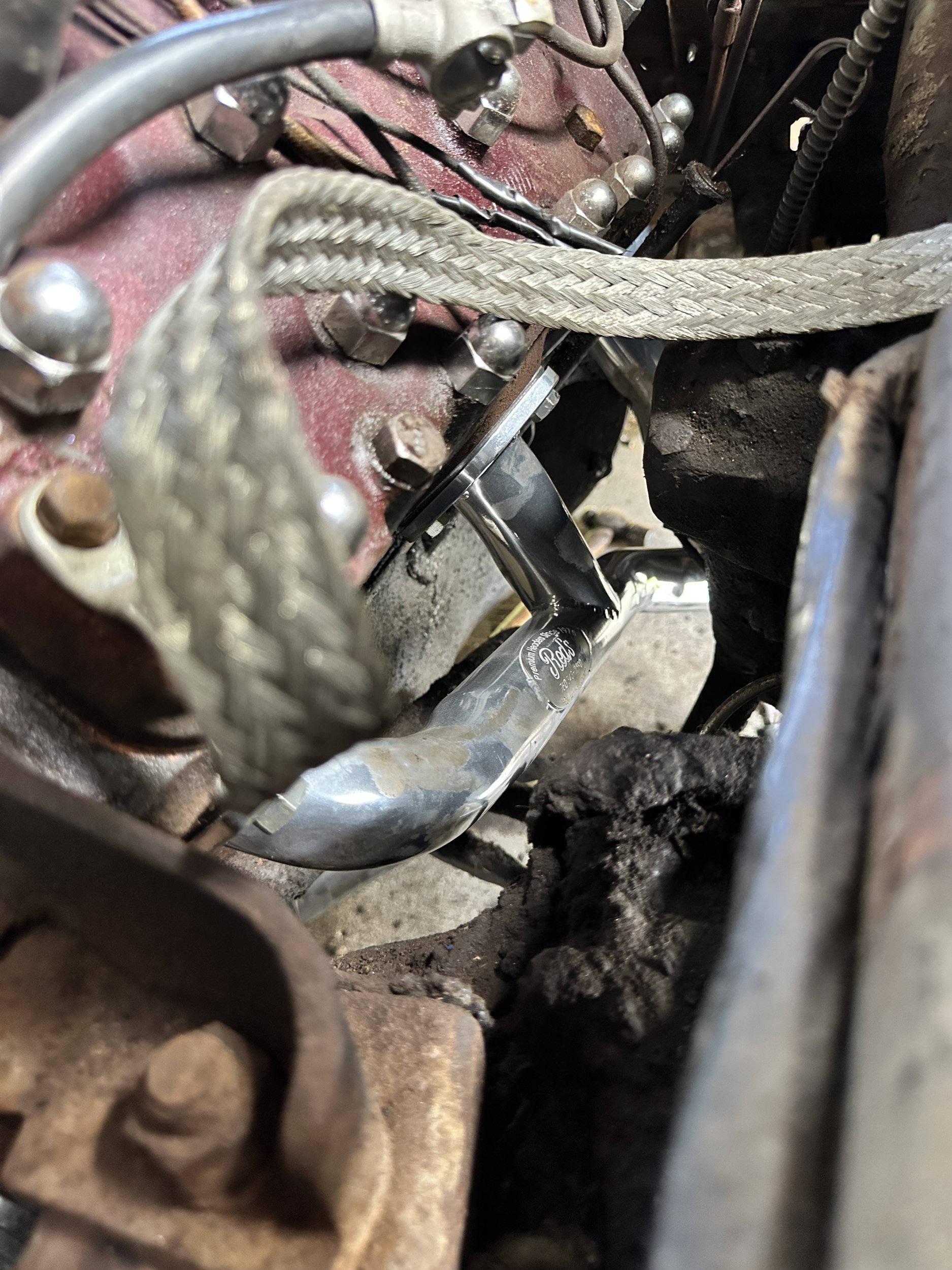

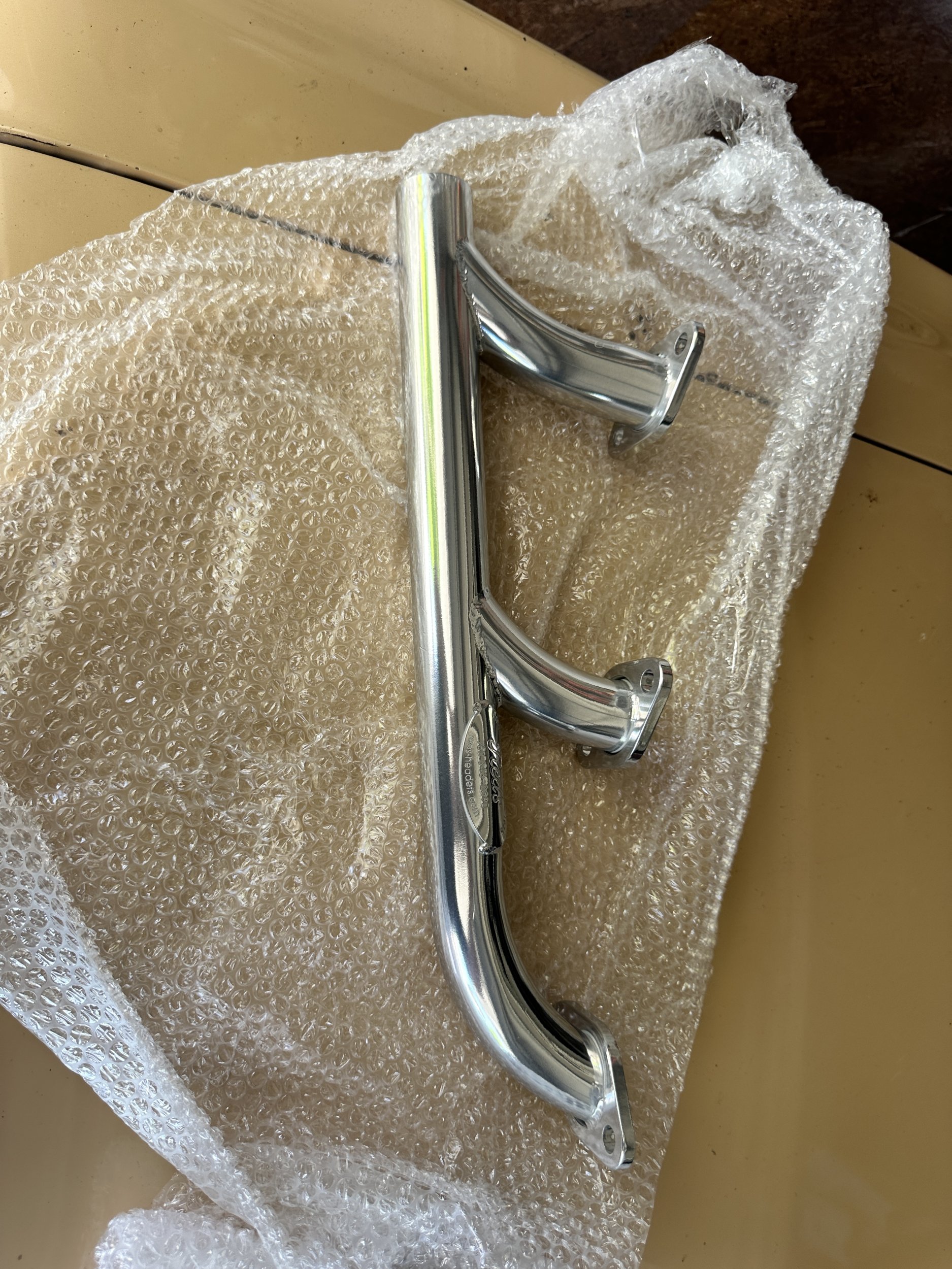

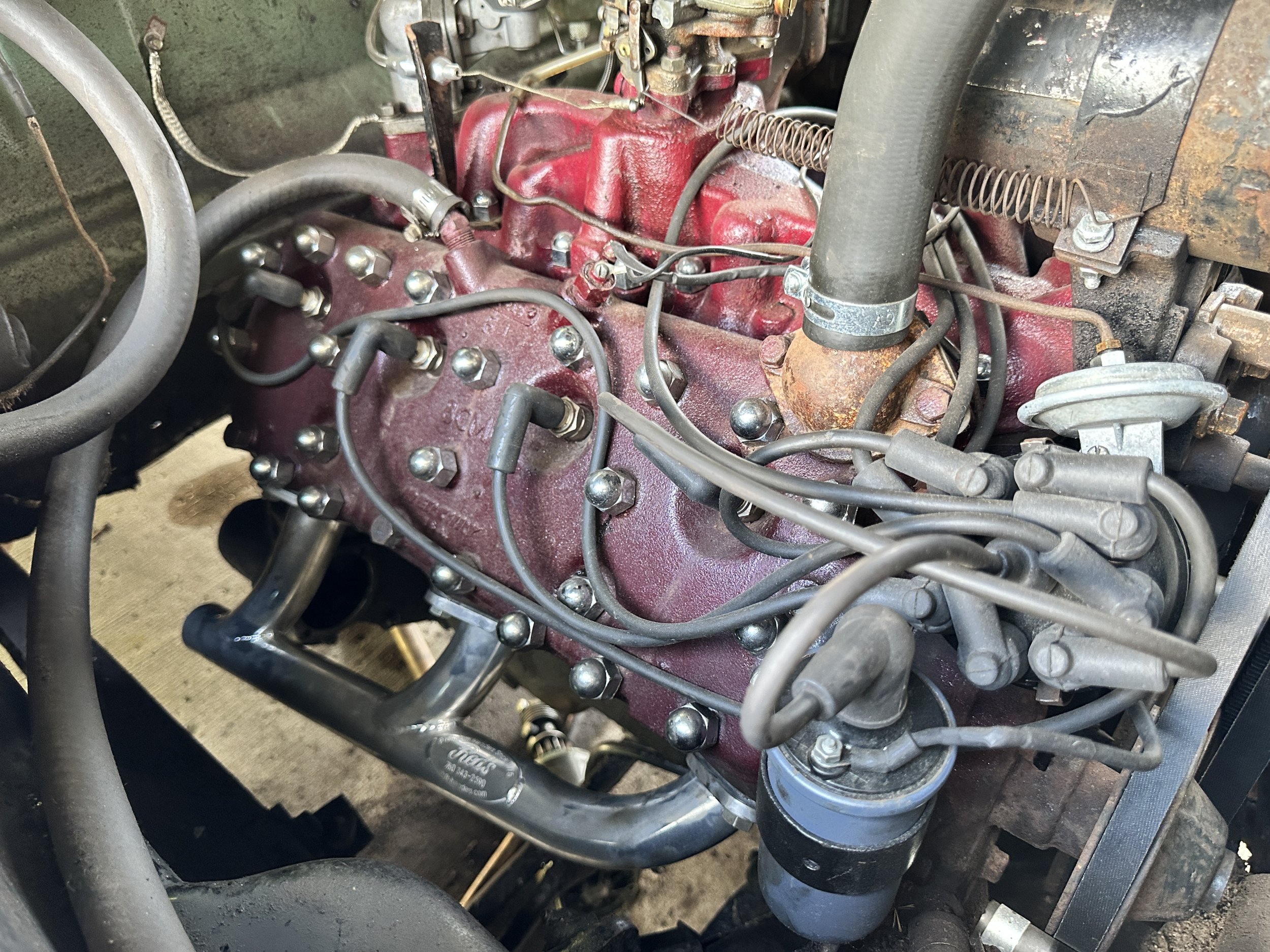

    Once again slowly making progress on the car, my headers finally showed up from red’s after about a 3 month wait. I immediately took them to get ceramic coated. Once the headers came back I started to pull the manifolds. I purchased an induction heater to aid with the removal of the bolts however ended up with 5 broken bolts. Luckily the bolts broke flush with the manifolds instead of the block. With about 6 hours with of work I slowly removed each broken bolt, cleaned the threads in the block and installed the headers. The car is going Thursday for exhaust, I m still contemplating keeping the lake pipes but I’m not sold on it yet IMG_7923.jpeg IMG_7924.jpeg IMG_7941.jpeg IMG_7952.jpeg IMG_7958.jpeg
