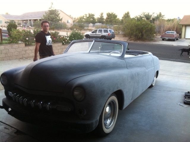

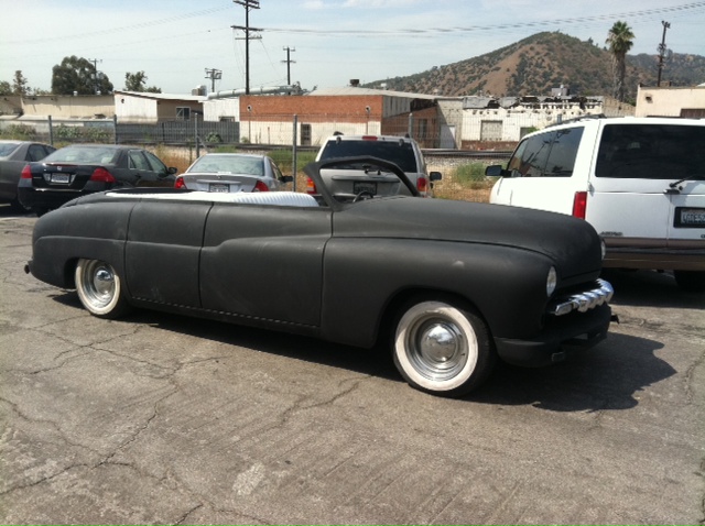

    Picked it up this Friday, Primered and ready, well at least for now... After a few minutes of putting it back together got to drive it in 100 degree weather across the San Fernando Valley. So glad it's a convertible because it has no A/C....

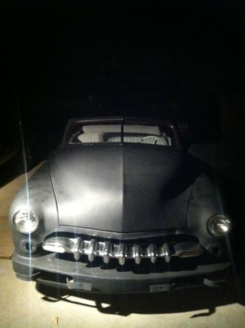

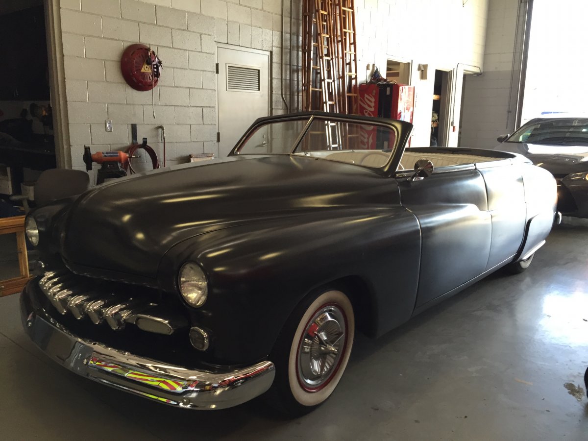

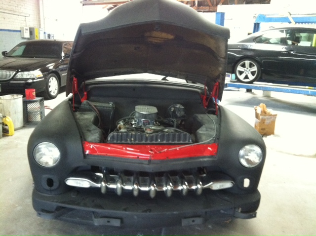

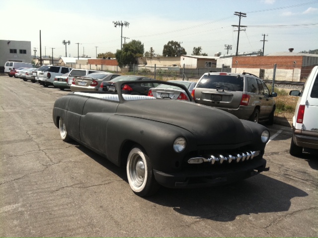

    Wet Sanding, chrome bumpers and a new paint job.... It was a quick job and I never knew you had to sand till your fingers bleed only to have to do it again, but this time with water. And yes, I did use the Hot Rod Flatz, Black Twilight and honestly it came out really nice, its more of a gun metal gray/black during the day but really sets off at night. And then Christmas came early... The chrome bumpers were finally done...
    Unfortunately the hood hinges we're never tightened correctly and it's misalignment now causes it to s****e against the cowl and s****e off all the paint. Anyone know the easiest way to align it, so it won't drop so much on the left p***enger side when I close the hood.

    Ok, so it's been quite sometime since I've been on here. And like most of us, I haven't stopped learning while busting my knuckles trying to wrench on this beast!
    So I just had to share the release of this music video that my car was in! I just saw it today and am pretty estatic how cool it turned out!
    Since I was last on this post, I've added rear skirts, a new 350 sbc, rebuilt the whole front end suspension along with brakes and tires, dropped the rear by removing 3 leafs and added 4" lowering blocks. (I'll post pictures later)
    All thanks to the everyone on here! Thank you all for posting your tips and suggestions, answering emails and silly "FNG" questions. I'm happy to say, my baby is finally coming along.
    Thanks again everyone for all your help and support, hope you enjoy as much as I did...

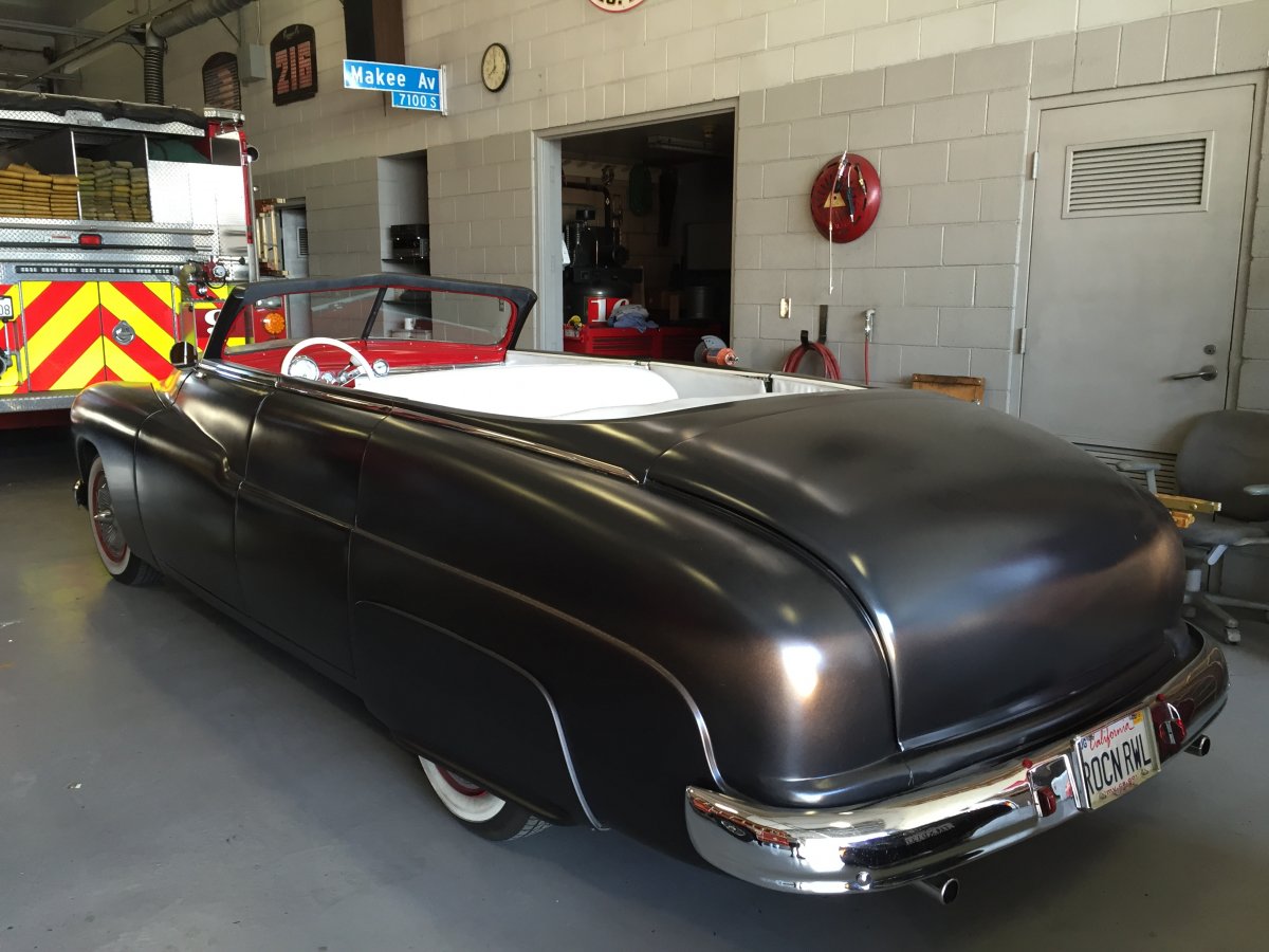

    image.jpeg image.jpeg Thank you... Here are a few with the new skirts.
