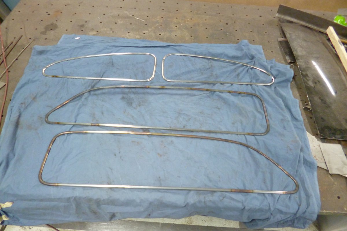

    Now it´s time to start on the window trim and garnish moldings. Making all new stainless trim from half round D-shaped bar. P1030605.JPG P1030617.JPG P1030604.JPG

    Going from concept to reality in 2 short pages so far .... pretty cool!! I really would like to see more detail than 3 pics in post #35. Thats where so many chopped Mercs fall short. Too many ugly rubber gaskets or cheesy plastic door edge guard material. Your homemade stainless deserves it's own tech article. Keep up the great work.

    This is really excellent workmanship and your do***entation ain't too shabby either! Could you explain your process with the window trim and D channel as well as how you attach the trim once completed?

    Thanks guys. Sorry but I don´t have any better pics of the trim process. I start making a paper template of the windowopening as big as the trim will be on the outer perimeter. Then I cut off 1/2"(the same amount as the bar is wide ) and makes a steel template from that. Then I heat and shape the stainless bar around the steel template and weld it together. The backside I drill and tapp with M4 thread 4mm deep. Weld some small tabs on to the small edge in the window opening to get some more material to drill in, drills holes in it matching the holes in the trim and mounts the trim with small countersunk allenhead screws. Attached is a pic from the backside of door to get an idea of it.
    Hope it makes sence.

    Have got all the window trim and ventwindows done and testfitting with rubberseals. Also made an extension to make the fenderskirts higher just as Sam Barris did on his 49.
