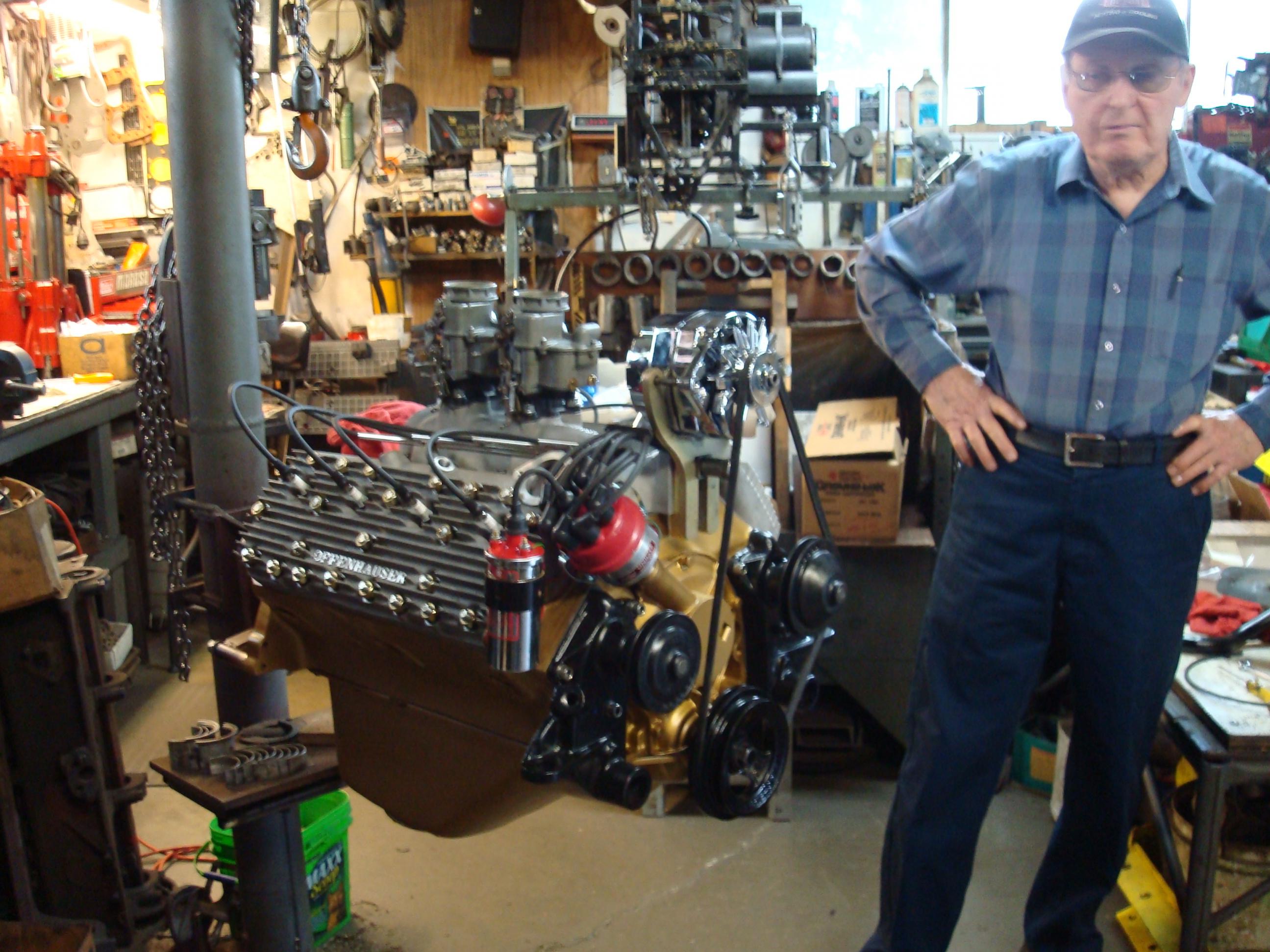

    Go see Len Hurley.

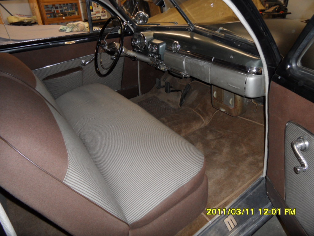

    Here are a couple of photos the rest are in my album, I am still sitting here looking at the hair line crack and weighing my options???? :mad:

    John, I took your advice and spoke to Len, **** it is like talking to you he suggested getting it s***ched and machined, or getting a new block and replace the inner parts with my stuff. I jst cant seem to go there. Larry
