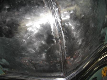

    There were some holes in the hood from a missing piece of trim so my first thought was just to weld them up. Then I thought I would go ahead and just weld the whole seam and make the hood one piece. Finally i though I might as well add a peak so I filled all the old trim and emblem holes and welded a 3/16" rod down the seam. It's got a little ways to go to get it in primer but I like it so far.

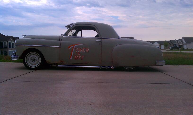

    Here's the intake/exhaust setup, only ill be running stock Carters. The last pic is how its sitting now

    I finished my hood peak and shot some epoxy primer on it; that'll hold it for a while. Im still not 100% sure where Im going with this; just doing one small mod at a time and see where it ends up.

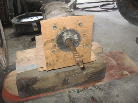

    I started mocking up the Ranger 5 speed onto the factory bellhousing using an old spare flathead I had. I'm copying this idea; a guy on the P15D24 site designed this swap. I had the bellhousing blasted and made a template; just need to drop it off at the machine shop to have the center hole machined out 1/8".

    I ordered my Langdon's flathead HEI distributor today; should have my 5 speed front plate back from the machine shop in a few days, too. They are welding on a guide tube for the Mopar throwout bearing.

    On the Dodge trans the input shaft has a sleeve that the throwoutbearing rides on. On the Ranger trans it used a hydraulic throwoutbearing that mounted to the ranger bellhousing so it did not have a sleeve. I wanted to use the mechanical clutch linkage and Dodge thowoutbearing so I have to have a sleeve machined to go over the input shaft and mount to the front plate of the Ranger trans for the throwout bearing to ride on. I'll post some pics when I get it back.

    I got my Ranger trans front plate back from the machine shop. They did an awesome job; they made this snout for the Dodge throwout bearing to ride on. Reasonable price, too. It's Morley Performance in Fenton, Missouri if anyone wants to check them out online or on Facebook. Great shop with some cool projects going on.

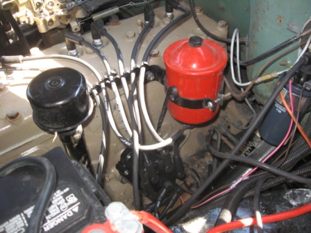

    Thanks all; I'm glad I kept the flattie, too. I got my HEI installed; wow, what a difference in throttle response! Very easy to do; only took a few hours.
