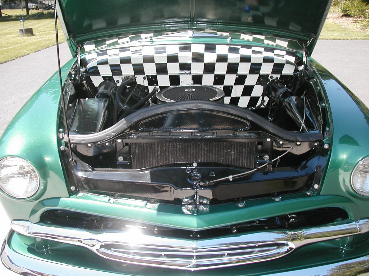

  26. Here's a little thing I learned many years ago and a solution to one of the problems with these 49-51 Fords. We all want good clean gaps and work hard to get them. On these cars, hood gap is one of the things that we see be them Good or Bad. You can work hard to get Good ones only to drive them a short time only to see things change. I'm talking Hood to Fender front to back. The Core support on these cars is just a large U made out of angle iron, mounted in the center and not tied together at the Top. One of the reasons the Rad mount brackets are always broke loose from the solder to tank. Seems the engineers must have thought the sheet metal air dam was enough and it may have been were it not for the Dog Legs stamped in that part right where the Rad Tank step starts on both sides. On the last two 51's I've built I added a piece of 1" angle iron and bolted it just under the top tank and tied together the top of the U of the core support. Once painted you can't see it, also I no longer bolt the core support to the Frame with the stock center bolts. This system lets the complete front clip rock in the center uncontrolled. I've started mounting the core support on both bottom corners of it to the frame with a spring and bolt there. This let's me adjust a fixed height and keep it outboard and that stops the Flex that happens at the Top Rear fender bracket that is mounted with 1/4" sheetmetal screws to the pinch weld of the Cowel top and Firewall. Just seems to tighten everything up and keep all my Gaps where set them and my Hood Latches have never given me any trouble since. I've been driving my avitar for 16 years and it's holding up just fine. Here's a photo of the brace under the air dam across the top of the U bracket. If you don't know it's there you don't see it at all.
    Keep up the good work, I'm really enjoying watching it make progress.
  27. jakesbackyard
    Joined: Feb 13, 2007
    Posts: 946
    jakesbackyard
    from ND
    I’ve had thoughts of the front structure as I’ve noticed it is real tippy side to side. What you did looks like a good answer to the problem. Especially the mounting on each side to the frame. Thanks for the kind words and ideas.
    bchctybob, loudbang and Pist-n-Broke like this.
  28. One other thing I do. Prior to actually installing the U Core support is take a good framing square and make sure the vertical side rails are actually square to the bottom section. Most are not and it can drive you Knutz. May be a little late for that tid bit but well worth doing.
