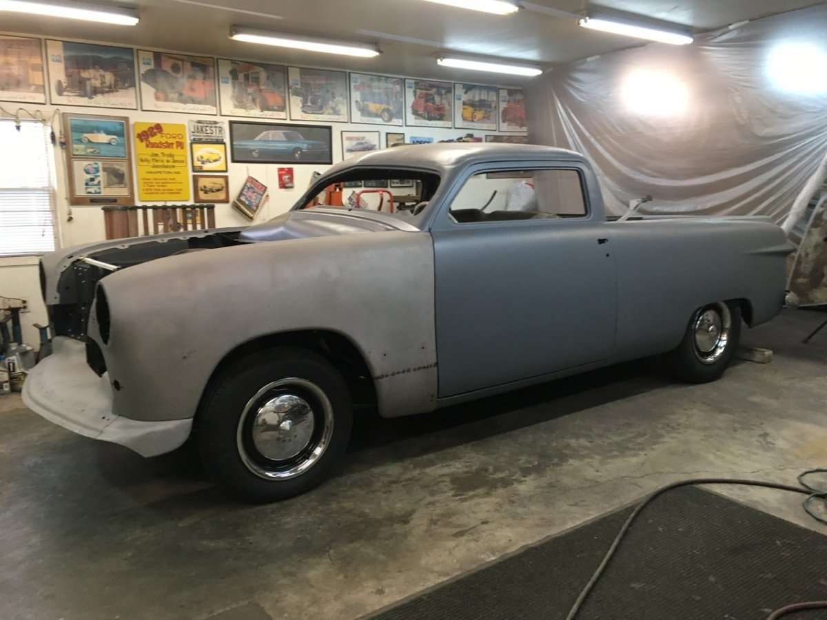

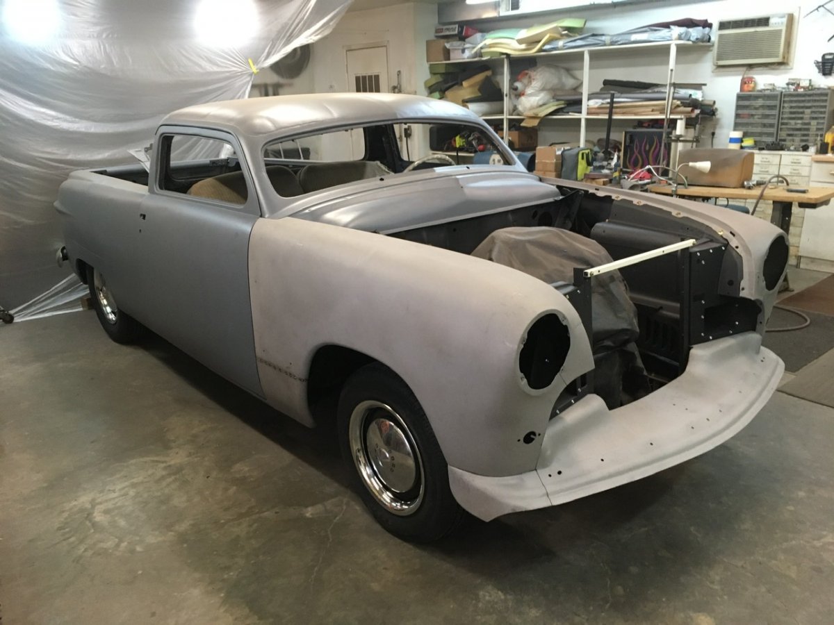

    Fenders mocked up and fit. A little more tweaking and welding and they’ll get sprayed with epoxy...starting to look like a car...

  6. I'm not a singer: transpose "it's beginning to look at lot like Christmas" into it's beginning to look like a hot rod. :)
    loudbang and jakesbackyard like this.
  7. Looking good! Getting closer. :) I wonder who makes an interior kit for a '49 Ranchero? :D

    Looking good, nicer than a ute.

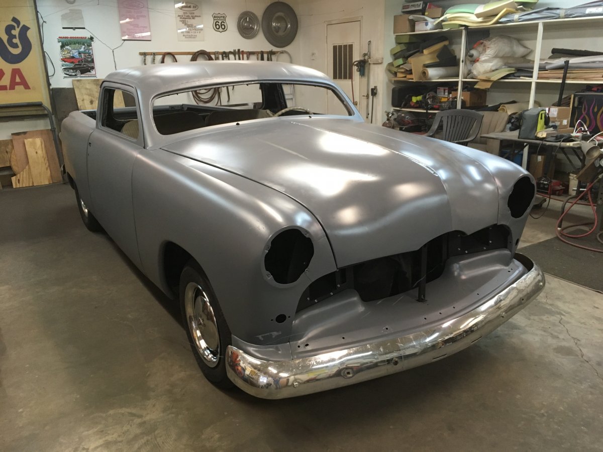

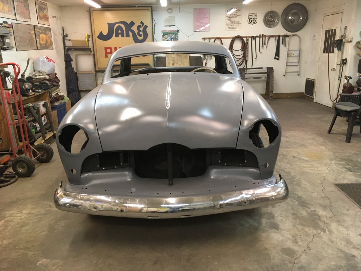

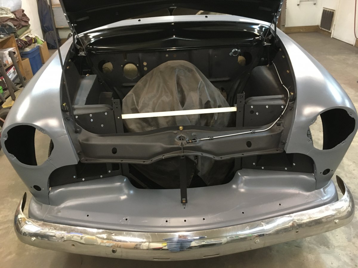

    Front end in epoxy, together and aligned pretty well...now to work on the bed interior...

  11. Looks great, Jake! Shop looks nice and tidy too.

  12. jakesbackyard
    Joined: Feb 13, 2007
    Posts: 932
    jakesbackyard
    from ND
    Thank you. My shop was a disaster yesterday. Took down my makeshift booth after priming the hood yesterday and spent all morning today cleaning and putting things away before I put the hood on this afternoon.

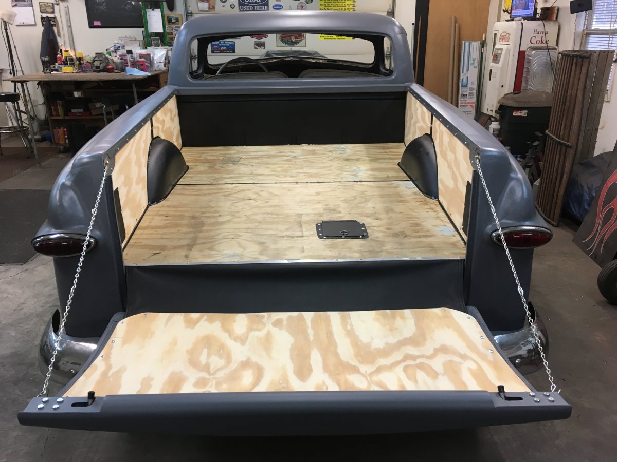

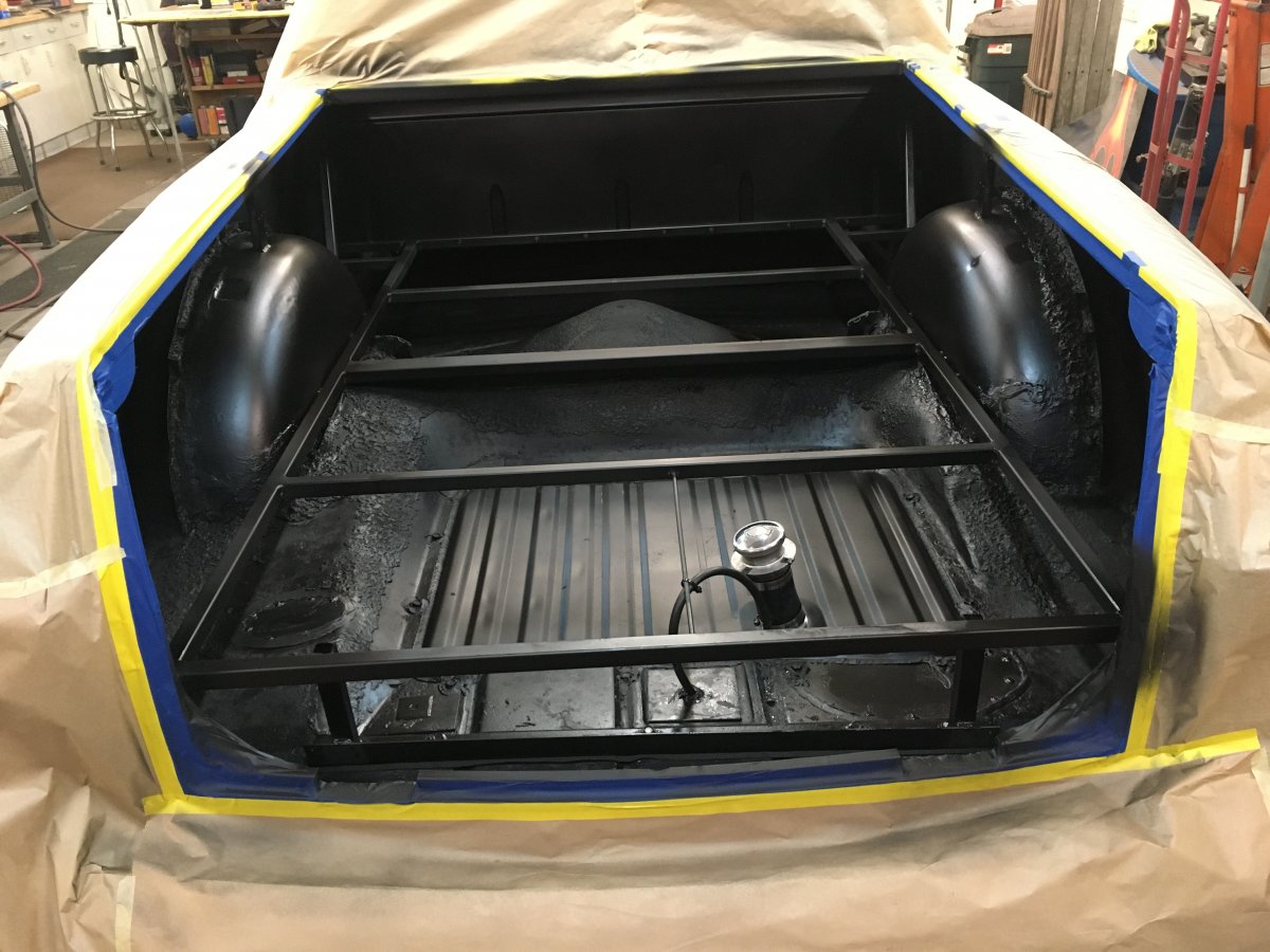

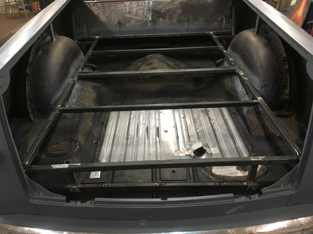

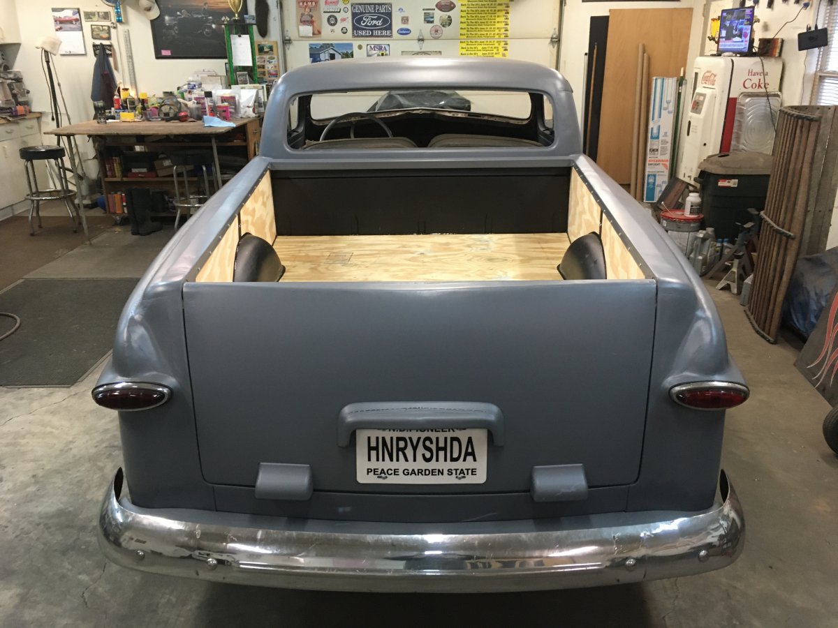

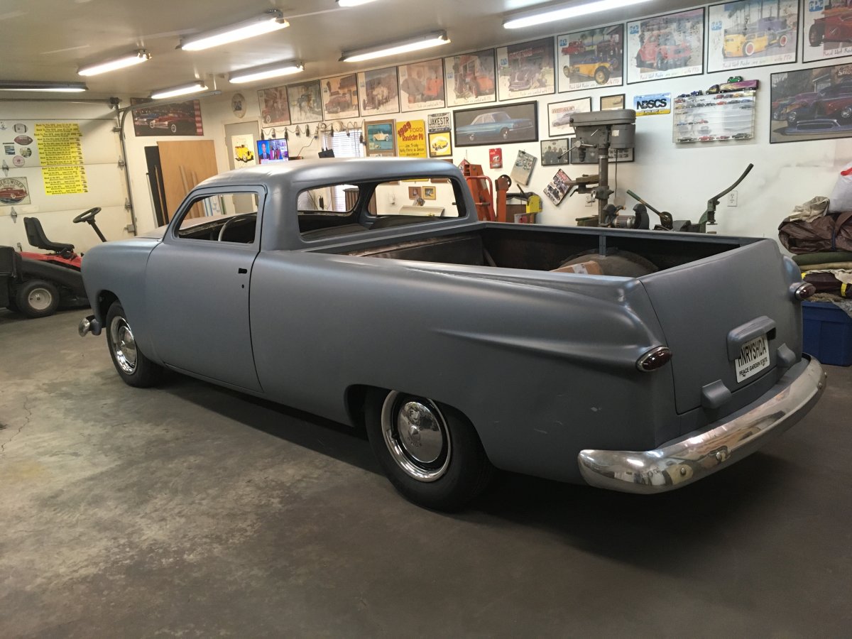

    Box pretty much done. Still needs tailgate cables and it’ll get a coat of bed liner when the body is in final primer. Time to do a bunch of body work and mudding...

  15. 1-SHOT
    Joined: Sep 23, 2014
    Posts: 2,896
    1-SHOT
    from Denton
    Love the license plate. HENRY SHOULD HAVE DONE IT

    Are the plans to use the plywood as templates and do the entire bed in metal? IMO that would be the way they came from the factory and you do have the skills. Either way it is a beautiful example of what should have been.
  17. jakesbackyard
    Posts: 932
    jakesbackyard
    from ND
    Thank you. It will remain the way it is with a coat of black bed liner.

    I was expecting to see the bed floor amd sides from a donor pickup, like a Ranger, but the bedliner painted over that wood should look ok too.
  20. Fabber McGee
    Joined: Nov 22, 2013
    Posts: 1,438
    Fabber McGee
    I built a flat bed for my 75 Ford 4 x 4 and decked it with 1 and 1/8 tongue and groove plywood. Then had it sprayed with 2 part urethane bed liner. That stuff is tough. After hauling about anything you can name on that deck for 15 years, the coating is still perfect. Road spray has finally rotted the wood from underneath in a couple places, but I'm starting to thing the coating can not be damaged. It is nearly 3/16 thick and no wood grain shows through, just has a nice pebbled surface. I think it's an excellent choice for the shoebox.
    They could have also made it a smooth finish, but said it would be too slick to stand up on. Pebble finish was made by fogging the top coat from several feet away.
  21. Dick Stevens
    Joined: Aug 7, 2012
    Posts: 4,089
    Dick Stevens
    Are you going to be able to coat the bottom side too? It would be a shame to have the deck rot on this great build!
  22. jakesbackyard
    Posts: 932
    jakesbackyard
    from ND
    It’s treated. I’m sure it will outlast me. Lol.
