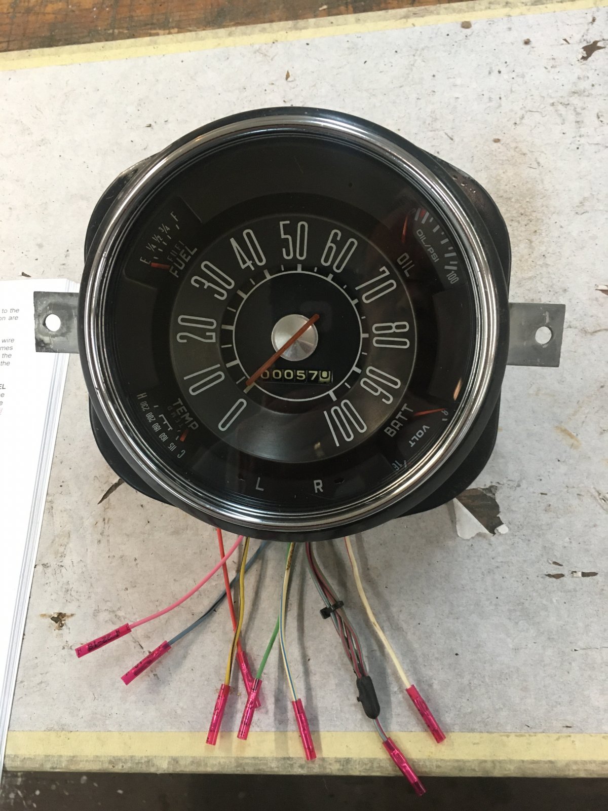

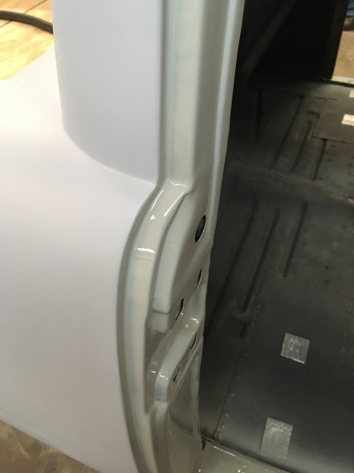

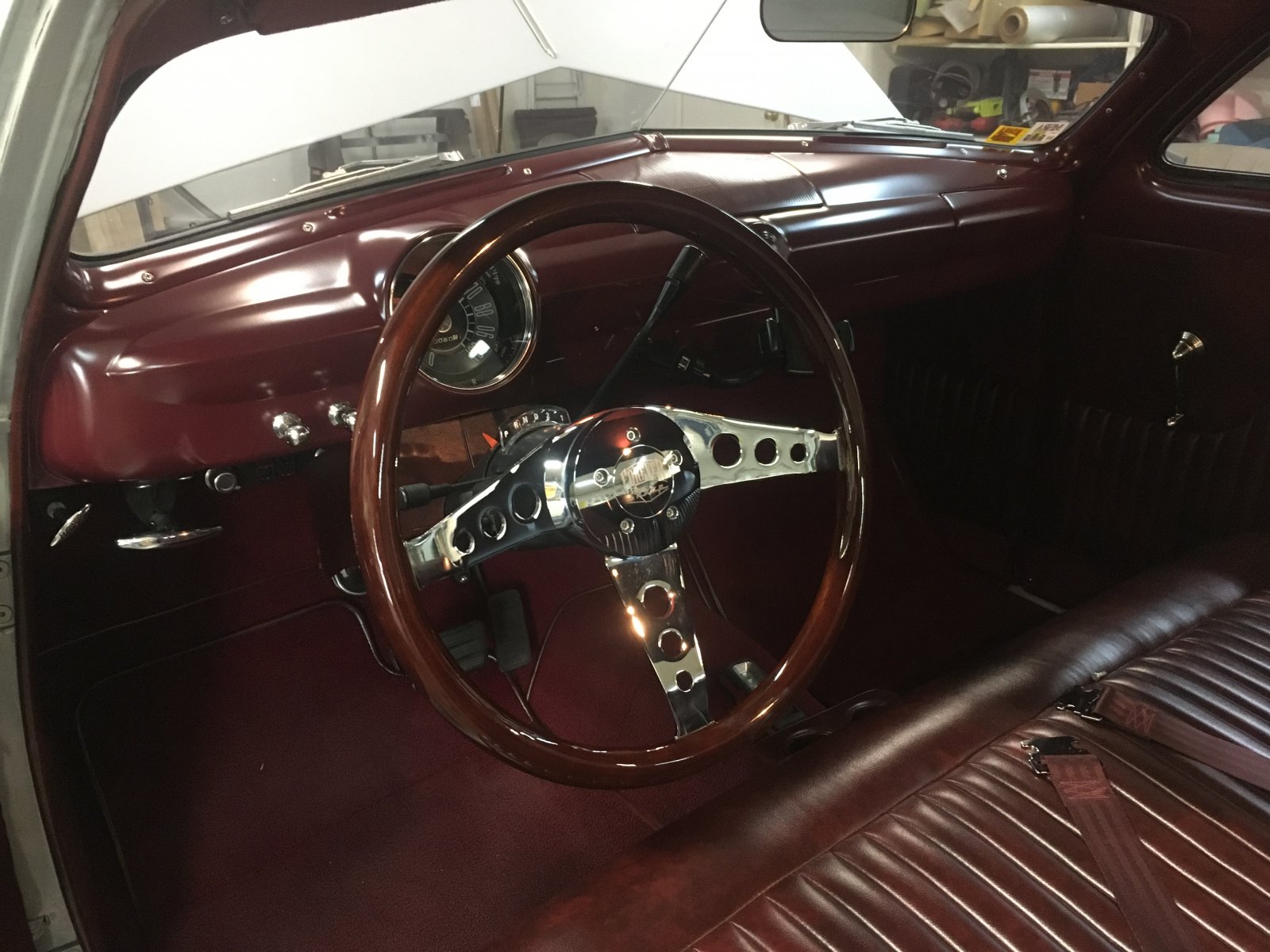

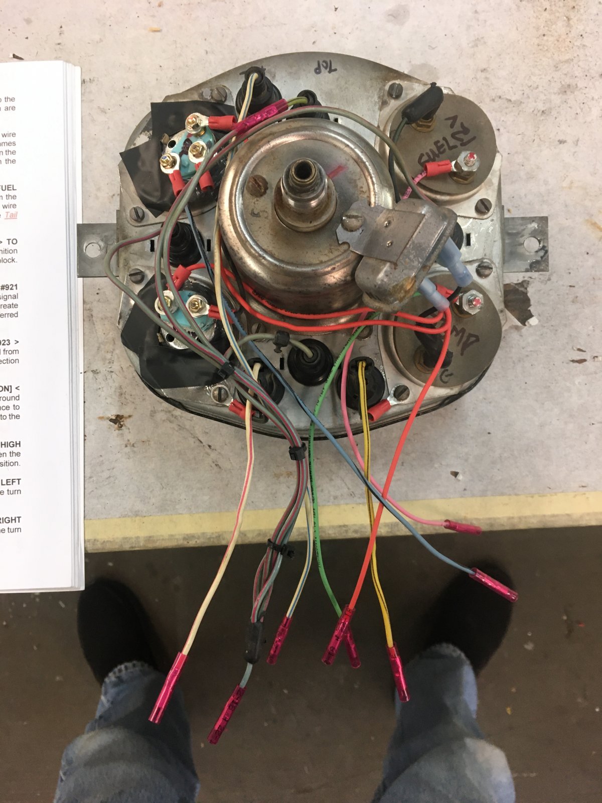

    Tying up all the loose ends on the Ranchero. Exhaust complete. Emergency brake all done. Gauge cluster all rebuilt and all working. New steering wheel on. A couple small things yet to do and then it’s time to tear down, sand and paint…

    @jakesbackyard Are you going to put any connectors on the gauge cluster to make it easier to remove if ever needed? I used 6 pin wire connectors on my '51 Custom when I had the dash out and rewired it. Also made for an easy install and not having to contort an old body to work under the dash.
  14. jakesbackyard
    Joined: Feb 13, 2007
    Posts: 946
    jakesbackyard
    from ND
    I thought about it and probably should have, but no. I didn’t. I’m skinny and thankfully pretty limber yet…:)
    loudbang and warhorseracing like this.
  15. warhorseracing
    Joined: Dec 26, 2006
    Posts: 2,801
    warhorseracing
    from cameron wv
    Doing it made mine easy peasy.

    Really like the steering wheel. Never saw one with the top spokes down in that position. :)

    Similar…door jambs are painted…I think it was posted a few months back…

    With the spoke pointed down.....there's no need to twist & turn to be able to read the instrument panel.
    I like it!

    I did mine on my '59, made the gauge lights all common and the gauge wiring with long leads. I have 2 barrier strips mounted to a plate back-to-back under the dash, easy to reach.

    To me it was a no brainer as to how simple and easy the reinstall was. The work behind the dash was accomplished on the bench sitting on a stool and not standing on your head with a flashlight in your mouth with both arms contorted. Adding those connectors enabled me to reinstall the dash in the car. Raise the car on the lift with the door open and simply push the connectors together and tuck them up out of the way.
