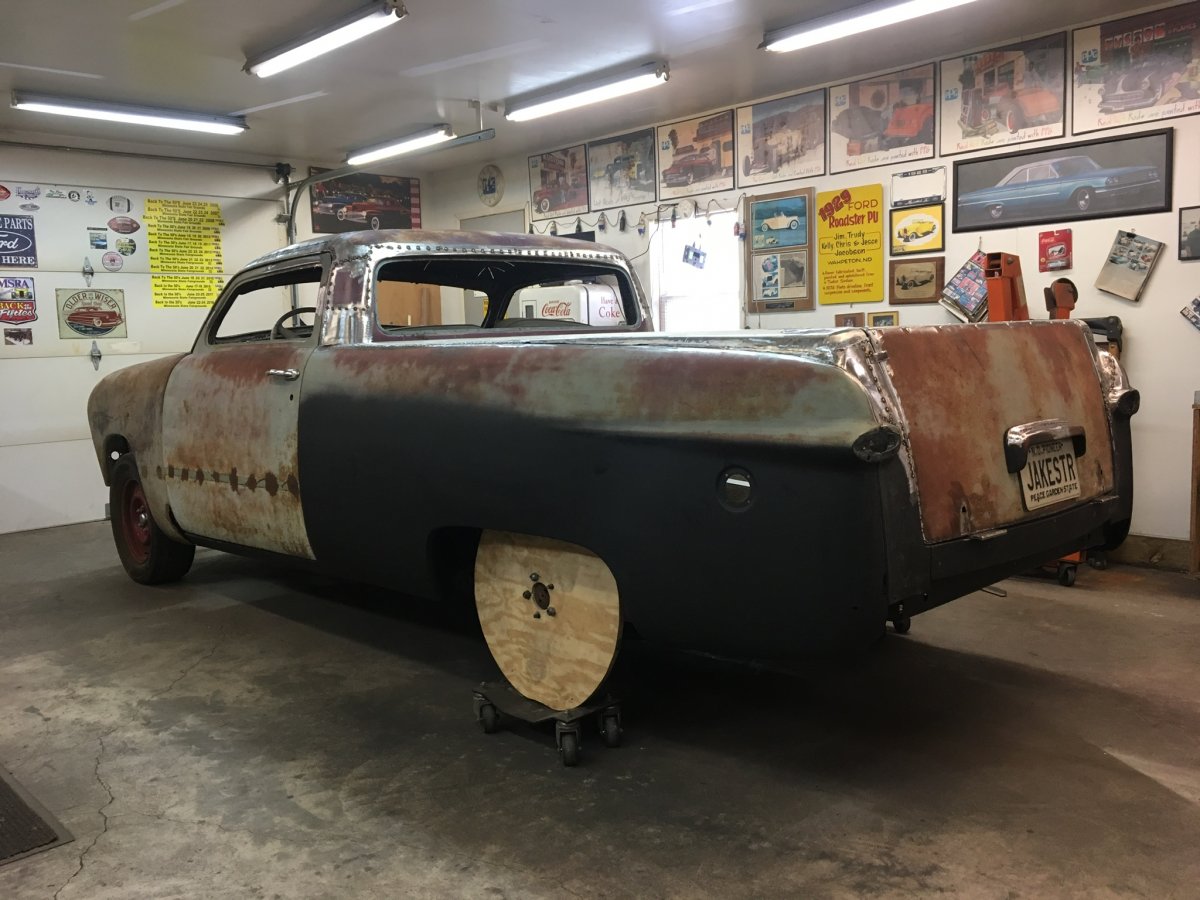

    On another detail, have you considered fabricating plugs for the stake pockets? Or maybe you'll end up filling them?

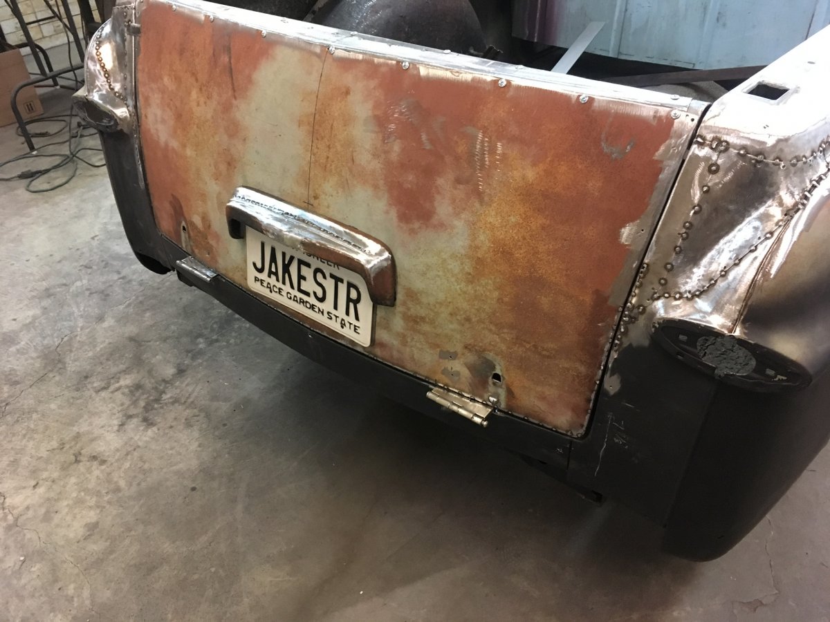

  3. low budget
    Joined: Nov 15, 2006
    Posts: 5,566
    low budget
    from Central Ky

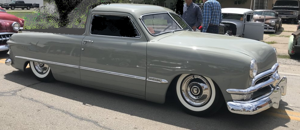

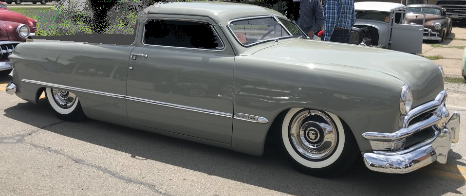

    Still sketchy but a little lower roof, Yours seems somewhere in between these two.
  4. bobss396
    Joined: Aug 27, 2008
    Posts: 18,732
    bobss396
    I like it, keep the upper part as is, but recess the plate area maybe by 3/4" below the skin.
    loudbang and ffr1222k like this.
  5. ffr1222k
    Joined: Nov 5, 2009
    Posts: 1,453
    ffr1222k
    The license plate and the surround really changed the tailgate look. That looks nice.

    The plate and surround look good but the upper part of the tailgate to me still looks too tall. IMHO the surround should be raised up until the top of it is inline with the tops of the tail lights if you drew a straight line across the tops between them. I think its coming out great though!

    It will have stock bumpers without guards. I’m sure woody bumpers are tough to find anyway.
    Thanks. Right now I’m leaning to a solid grey like the pic, but that’s a long way off.
    Thanks. I had the surround up even with tail lights, but didn’t care for it. Right now it’s only held in place by butyl strip caulking. I’ll wait till the hinge covers are done and figure out the placement.

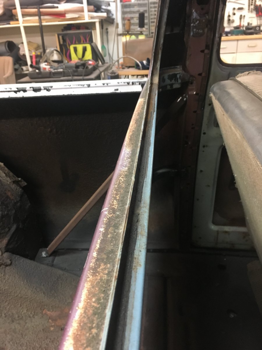

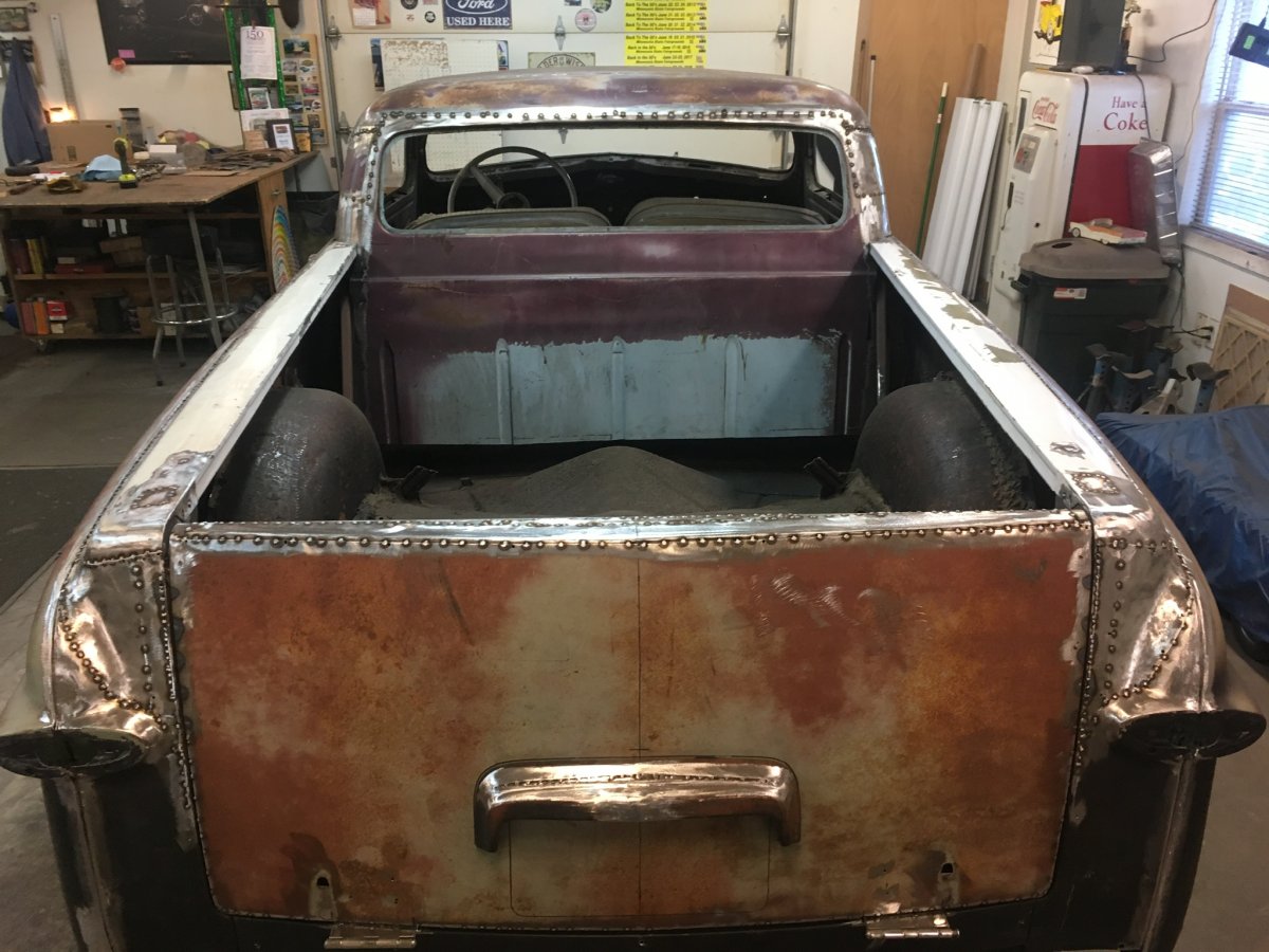

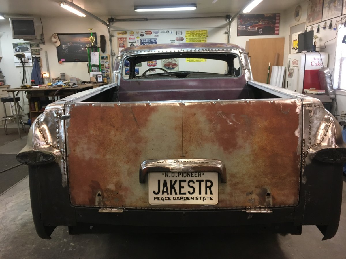

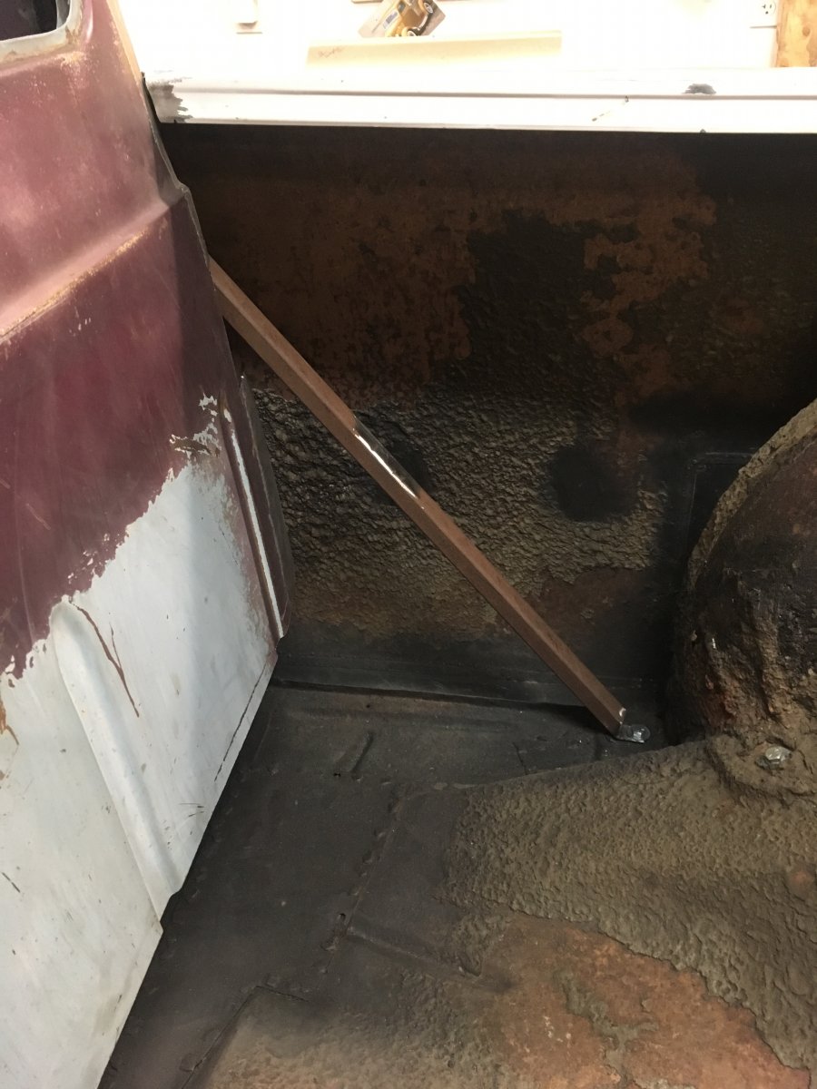

    Not much new to look at. Tacked and fit the tailgate, filled a bunch of holes and patches, and added gussets from the B pillars to the body mounts with 1” thick wall tubing. Spring pin latches should show up Monday for the tailgate.
    8AA70866-E080-4A3E-8432-5348CA544415.jpeg E994E609-F06E-406B-A651-9AD8CA3AD2CE.jpeg 6A6ABD8F-4E4F-4778-ABD9-6362541591DF.jpeg
    Unkl Ian, Randall, Bone_Idol and 14 others like this.
  20. Peanut 1959
    Joined: Oct 11, 2008
    Posts: 2,188
    Peanut 1959

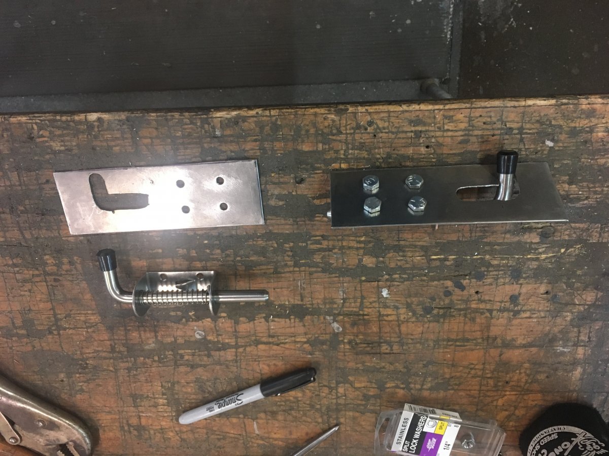

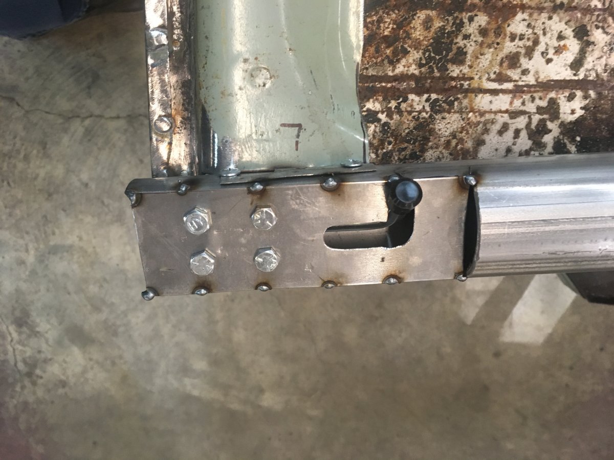

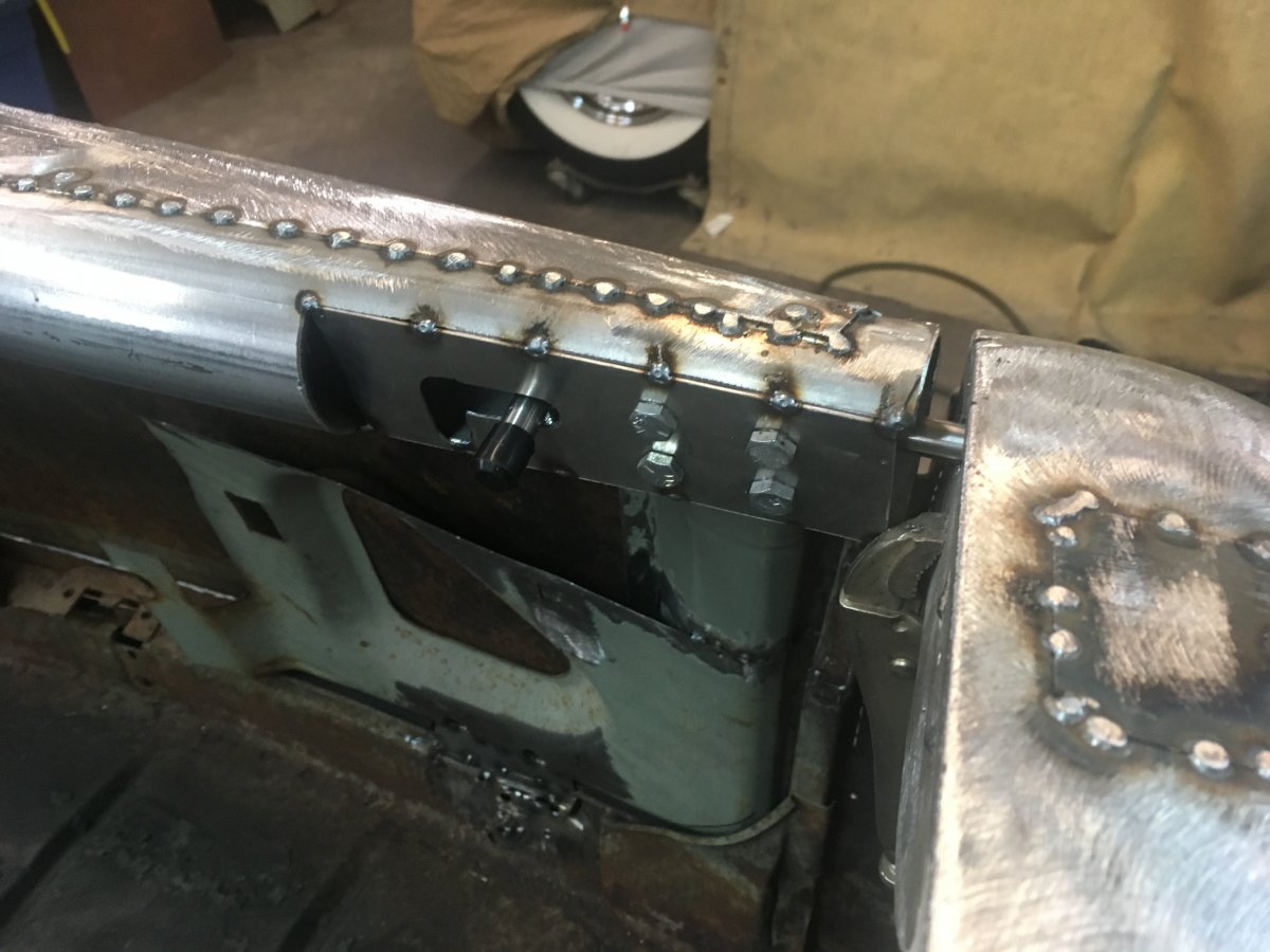

    Stainless spring pin latches came, made mounts, cut tube, tacked in place, and work good. $16.50 delivered from Amazon!
    0919AF25-0C8B-4CE5-BA47-019D433FDC0A.jpeg 7E700ECD-81BA-455B-BB66-EDBB160125AA.jpeg DC9C0A16-FAA3-4A85-8BC9-A2678C291BE5.jpeg
