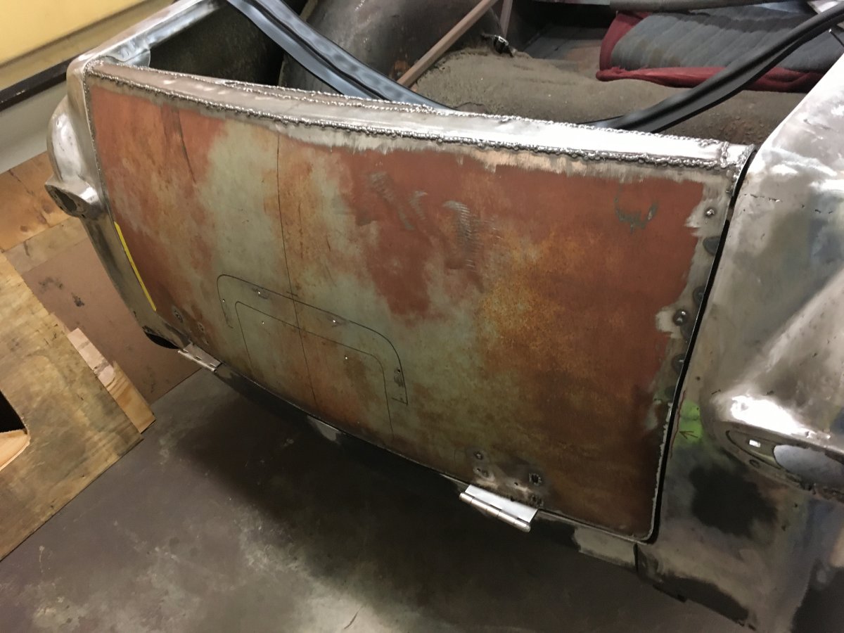

    Not much to show. I have finished all the welding and grinding on the body. Still have to weld up the tailgate. The body is ready to DA and put on a couple coats of epoxy. Doing some other Uph projects right now, but one of these days It’ll get in epoxy.

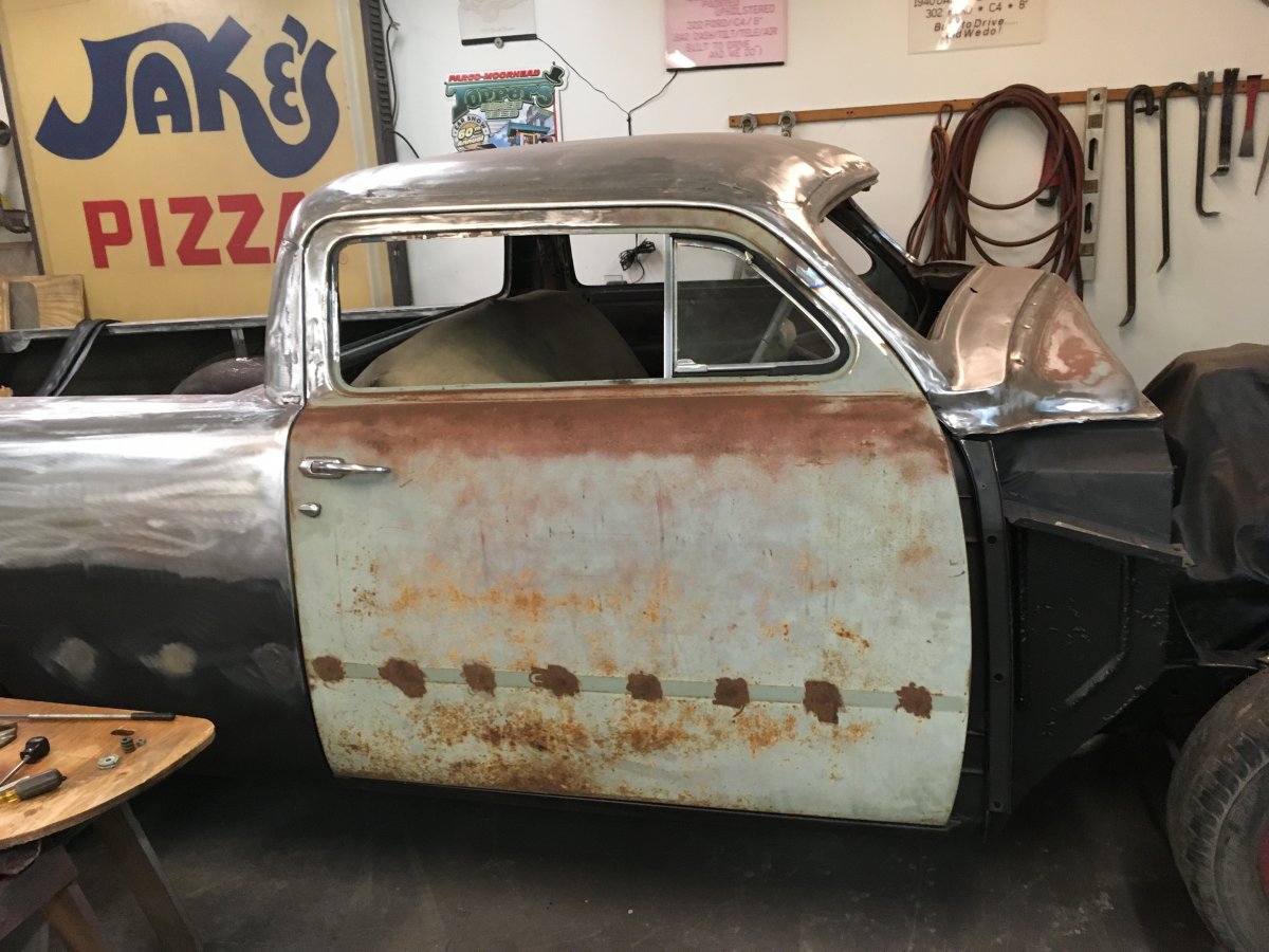

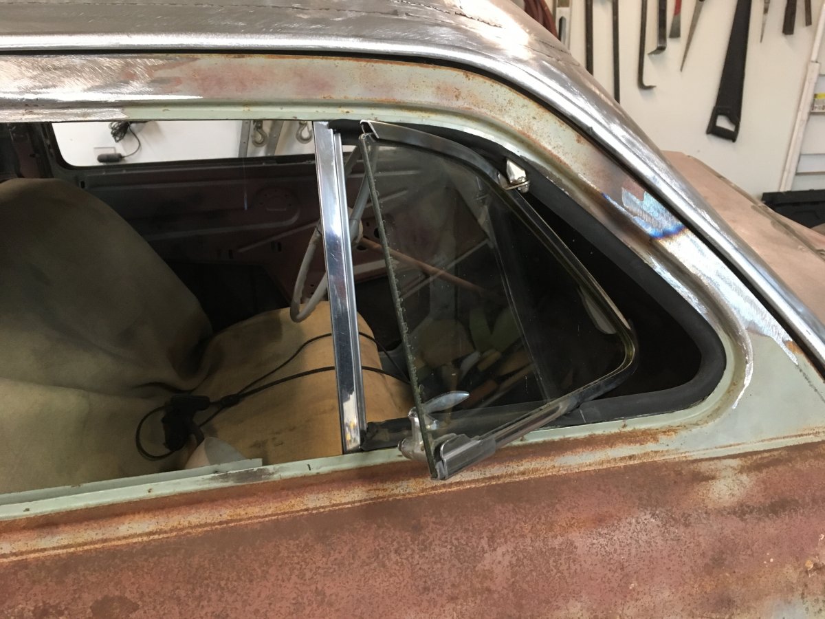

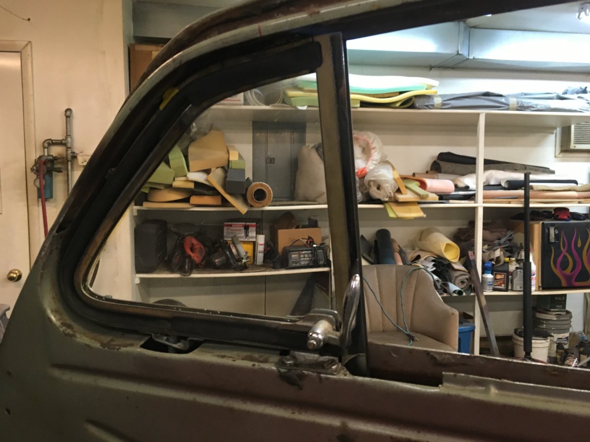

    Haven’t worked on the Ranchero until lately. Did get the tailgate all welded up and fit. Last few days to get away from welding/grinding I decided to chop the vent windows. Finished up the right side this morning. Still needs some filing, sanding and polishing, but came out working well. Now on to the left.

    I think you did a perfect job on the vent windows. They take a lot of patients to get correct.
    Be sure you get it really spotless before epoxy because thats your first step in your paint job.

    Is it just my eyes or maybe the photo angle, or does the side window look wider at the top with the new vent window installed?

    jakesbackyard
    from ND
    It’s the photo angle. I noticed it too. It measures correct top to bottom. Even put the door gl*** in this morning to check everything out. Works great. Working on the left side now.

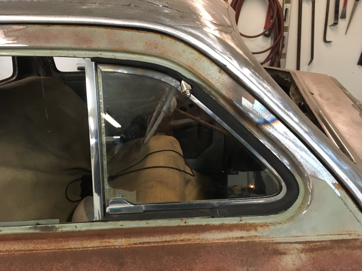

    Done and done...both sides filed, sanded and polished. If any one would like the templates for the outer and inner frames and gl*** let me know. 4” chop at B pillar.
