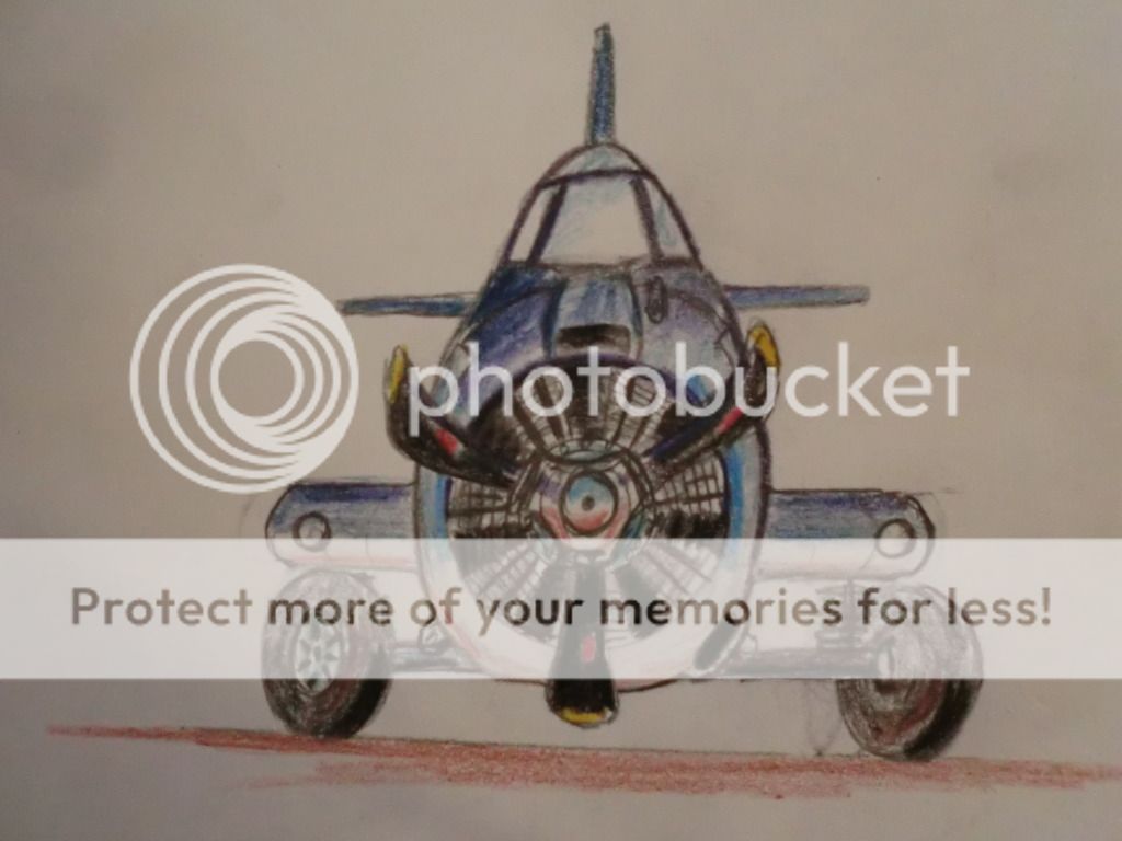

    Here are some rough draft sketches of my idea. I want this thing to look like it hit hard and the landing gear wadded up inside the wing. It might be kind of neat to make front fenders out of small drop tanks or bombs.There is a little under 3ft of space from the belly to the bottom of the floor boards currently. That should give me plenty of room for a frame, engine installation, cargo space or maybe even seating

    I would have left the engine together,..put it on a stand, and had a *****in' wind machine !! All sorts of aviation parts are available thru vendors in "Trade A Plane" magazine...... Worth looking into for gauges .
