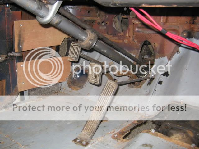

    I finally remembered the Camera. Just closed up the shop. Got the Flatty running this evening. Seems to run sweet. Was just running it on the ol' pour some gas
    down 'er throat...... I am attaching images taken this evening. The current work is extending the pedals, positioning the steering column and wheel. The dash has
    been moved back 12". The gas pedal rod has been lengthened 12", the Clutch pedal rod has been lengthened 9 1/2" and the Brake pedal rod has been lengthened 4 1/2". The steering column will be positioned as seen. The section is 4". The "repositioning" of the column will be approx. 3". I'm still "engineering"
    the steering column mounting and transition to the steering box. I've located the battery into the Trunk and
    run all new 2 guage wire to the Solenoid and Starter.
    I have wired one of the Speedway (pull type) ignition switches. The gas tank is out and in the process of being cleaned. There was approx. 12 gallons of 30 year
    old gas in the tank. Varnish city. I'll be running the engine on a one gallon gas can for now. I just scored a
    Hurst Master Shifter 3 speed shifter on E-Bay. My next step is going to be fabricating the mount bracket and shift arms and getting the whole floor shifter installed.
    I need to cut and reweld the Drive Shaft. At that point,
    it'll be running and driving. After that, Weld like Hell ! !
    Stay tuned .
    I guess that I'll have to restore the ol' Gas Pump also.

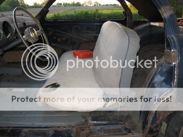

    Oh ya, I also chopped the Factory Front Bench Seat 8".
    (4" section and 4" chop).
    Trunk Mounted Battery .
    chryslerfan55 and kidcampbell71 like this.

    i continue to be impressed but the pedals are "kinda" scaring me.. have you considered fabricating new arms in one-piece that won't depend on a bolt/nut for attachment? just saying, that bolts and nuts work loose, and risking yourself and a rider.... oh, AND the car... worries me.

    Please don't leave those pedals like that!:eek:

    Believe it or not, the Clutch and Brake Pedals are really solid !! ??
    The Gas pedal is shakey due to it being Rubber. Since I'm just in
    the mockup stage, I will most likely go with a underfloor Brake and Clutch ***y (ECI brakes) and do something different with the Gas pedal. Right now, I'm shooting to get the car running and driving (for mobility's sake) and then I've got to get welding. Gene Winfield is doing his metal Seminar at the shop next month, I'm going to let Gene take a look and give me some
    real "old school" input. Thanks for the comments, I appreciate
    feedback. Feedback is what makes a project "come together"

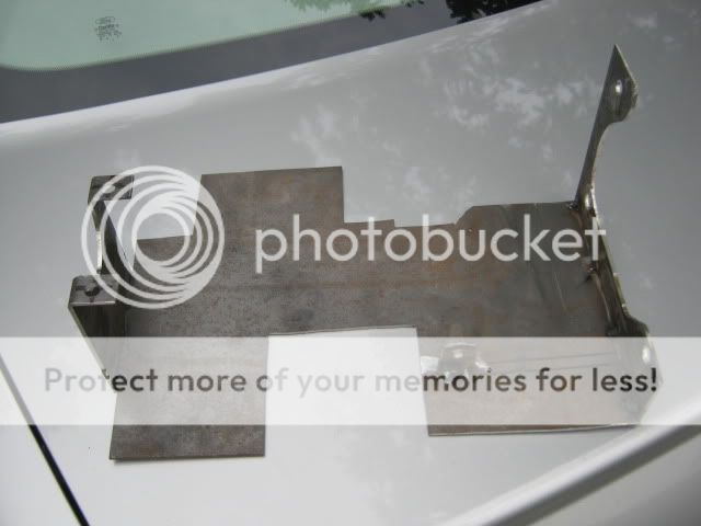

    Just mocked up the 3 Speed shifter plate. I'm using a Hurst Mastershift 3 Speed Shifter. I am using the original 3 Speed Transmission behind the original Flatty.
    Here are some images of the Transmission Shifter Adapter plate I made last night. I'll give 'er a try today.
    I made a pattern, so all should be good.

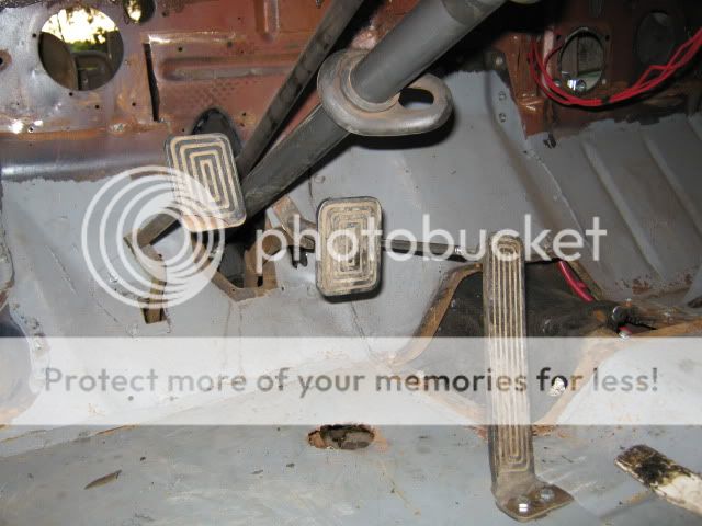

    I figured I'd put some images of the 3 speed shifter bracket
    now that it is installed in the car. The car in 100% running and
    driving at this point. Now that the Gene Winfield seminar,
    Syracuse Nationals and Summer are gone for that matter, it's
    time to dig in to the bodywork. Here are some fair images of
    the shifter mounting bracket......
    I know, I know, the pedals are scary. Just temporary to move the car around while the bodywork is being done.
