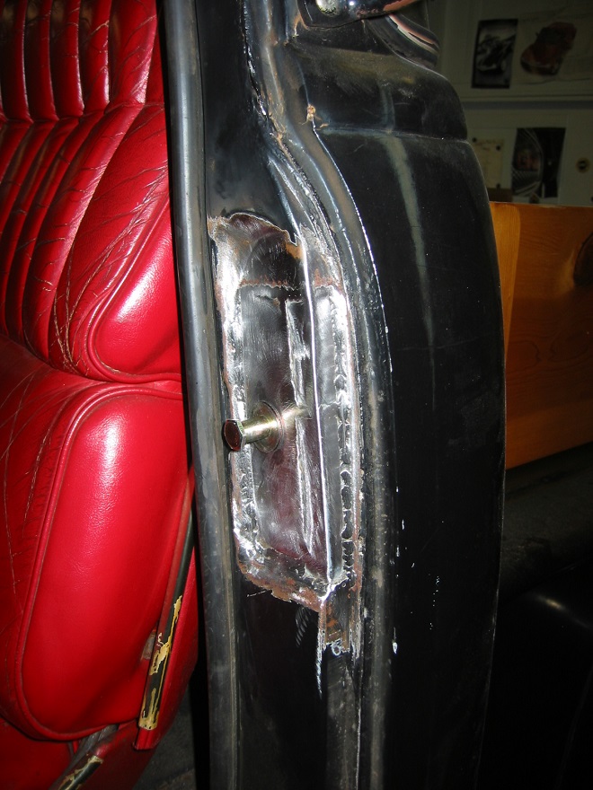

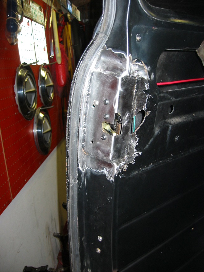

    Dude - As much care and time as you are taking fitting the door gaps - Why not cut around the Altman plates and weld them in flush like you would the Autoloc style sheet metal kit. In fact, had I seen the Altman kit before I installed the Autoloc bear claws and sheet metal kit over the Thanksgiving weekend in my '53, I would have done just that. And using the weld in striker plate from Autoloc would finish and ultra clean, flush and blended install. Also be permanent and look factory.
    Here's how mine looks after welding and grinding, ready for a little Ever-Coat glazing putty.

    Wow, honestly until you said that the thought never even crossed my mind. Seems like that would make it fit better and look better as well. Doesnt seem like it would be hard to do either...hmmmmmmmmmm. Damn you.....:D

    You bet - post up your results. A wire-feed welder is your friend.....
