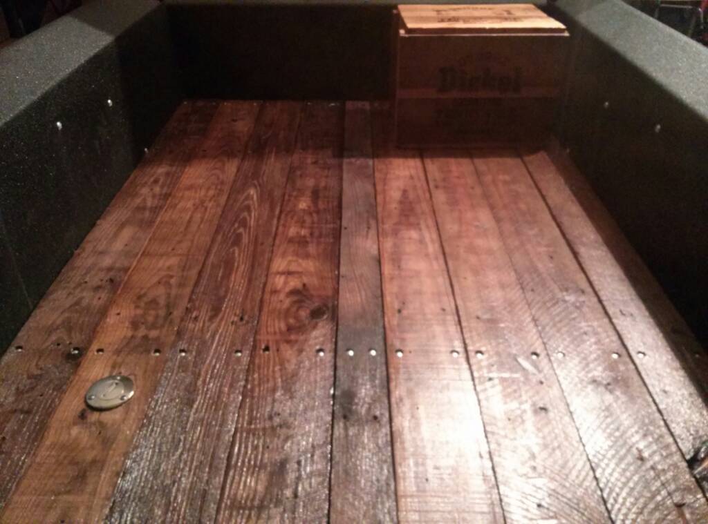

    I drove about 60 miles to buy some barnwood to use for the bed. It is going to look cool as hell. I will soak it all with linseed oil when done. No strips, just bolted to the front and rear sills, and both center cross supports. Everybody is giving me shit saying its going to warp, but I am not going to worry about it, seems to me if its bolted at 4 diffent spots it cant warp much, not to mention I dont plan on leaving it outside anyway.

    It looks a lot better with the oil on it and I am putting it with the rough cut side up, not the side the picture has up. I have two boards installed so far, very tedious...

    Why no strips? I think it would look awesome with them. Without them, there will be gaps between the boards, allowing things to fall through/get caught, road grime to come up....something to consider.

    Something different, thats all. Initially I was going to rip them all 1/4 inch or so on either side and join them together like a table top. But that would be a ton more work and not allow any movement and then splitting/warping might occur sooner. So I am going to lay them out just how they are for a more "rustic" look if that makes sense. I dont know, I may end up doing something different one day...thats whats cool about it is I can change it around if it doesnt work...
    BTW, they are just sitting in the bed in that pic, I am doing them from the outsides in and trying to get them to butt up a close as possible before bolting them down...

    Boiled linseed oil is not water proof and will offer very little protection. It's better than nothing but that's about it.
    I suggest a Spar Varnish if you want a traditional wood finish that is somewhat weather resistant.[​IMG]
    Polyurethane is option also but it does not have that look like the old type Varnishes.

    Good to know. I wanted something I could apply over the rough wood without changing the look of it too much. I was not aware however that it was not at all water resistant. I actually looked at the stuff you posted up earlier but ended up buying the linseed oil on a whim during one of my home depot trips and that was that....
    I wonder if the varnish can be applied over the oil? I have already done a few boards.....

    I would let the BLO dry in the sun for at least a few days then the Varnish should do fine.
    Be careful with the BLO as cloths saturated with it and wadded up in a confined area like a garbage can, "will", not "might" catch a fire due to spontaneous combustion..

    BTW, thanks F-ONE, I ended up using MinWax Helmsman spar urathane on the bed wood. Couldnt find the spar varnish...Looks better than I expected and still has that old look to it. I am also going to spray the bottom with the same leakseal stuff I have used everywhere else just for extra protection.

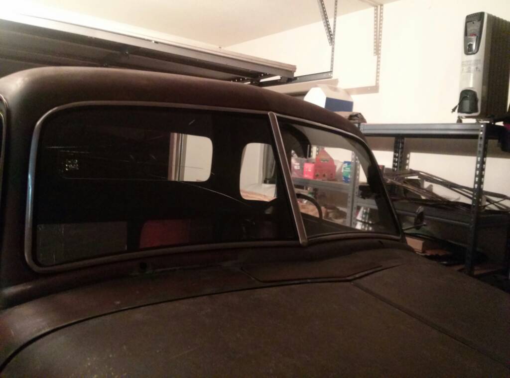

    So I decided to do things right and ordered another windshield glass for the pass side. Got one from a different vendor hoping it would fit better. I laid it on the broken one and it was slightly smaller all the way around and fit perfect. I talked with the glass guy that comes to our shop and he gave me a couple glass grinding discs to grind down the drivers side one to fit.
    I ground on it for a bit, compared it to the broken one and it looked like I made some progress and so I went to test it out. Ended up breaking it pulling it in too tight. I cant tell you how pissed I was. It took
    all I had to place yet another order for glass. I am just about ready to let this thing go to the "sitting and rotting" thread.

    LMC and it was a perfect fit. Who knows though, maybe its my truck. If the second one fits too then LMC is the way to go. The first ones were from Classic Parts...

    1412776214000.jpg WINDSHIELD IN FOR GOOD!
    So the second glass from LMC was exactly the same as the first, and obviously fit, however I could not get it to go in the way they say to install the glass. Normally you put the glass/rubber/trim together (which I did) and set it centered with the lower part of the assembly over the lower lip, then rope it around to pull it all in the rest of the way around. No matter how much juicy juice I used I could not get it to seat in the top and the trim kept popping out, which would allow the rubber to come off the glass.....
    So I took it back out, reassembled it and then slid the driver side in starting at the center divider. since the w/s is tapered slightly I was able to get it in the slots in top and bottom at the same time, slid it over and got it mostly seated on the pillar side. Lots of suction cup positioning and rope work and got the drivers side done pretty easily. Now I got inside on the pass side and with the suction cups set the top of the w/s in place and pulled up and in while working the rope and eventually got the bottom lip up and over. Lastly, the pass pillar side was some work, used the suction cups and lots of lube to attempt to slide the glass within the rubber as far to the center as possible while pushing down and reached inside and yanked the rope and PLOOP it fell into place...
    The trim had come out a little at the bottom but with some plastic ply bars and lube I got it back in and TADOW!! Man I am pumped.....nothing like getting something done that has been kicking your ass....I should mention I did this all by my lonesome, if I had a helper it would have been and HELL of a lot easier, so that is definitely my advice if possible.
