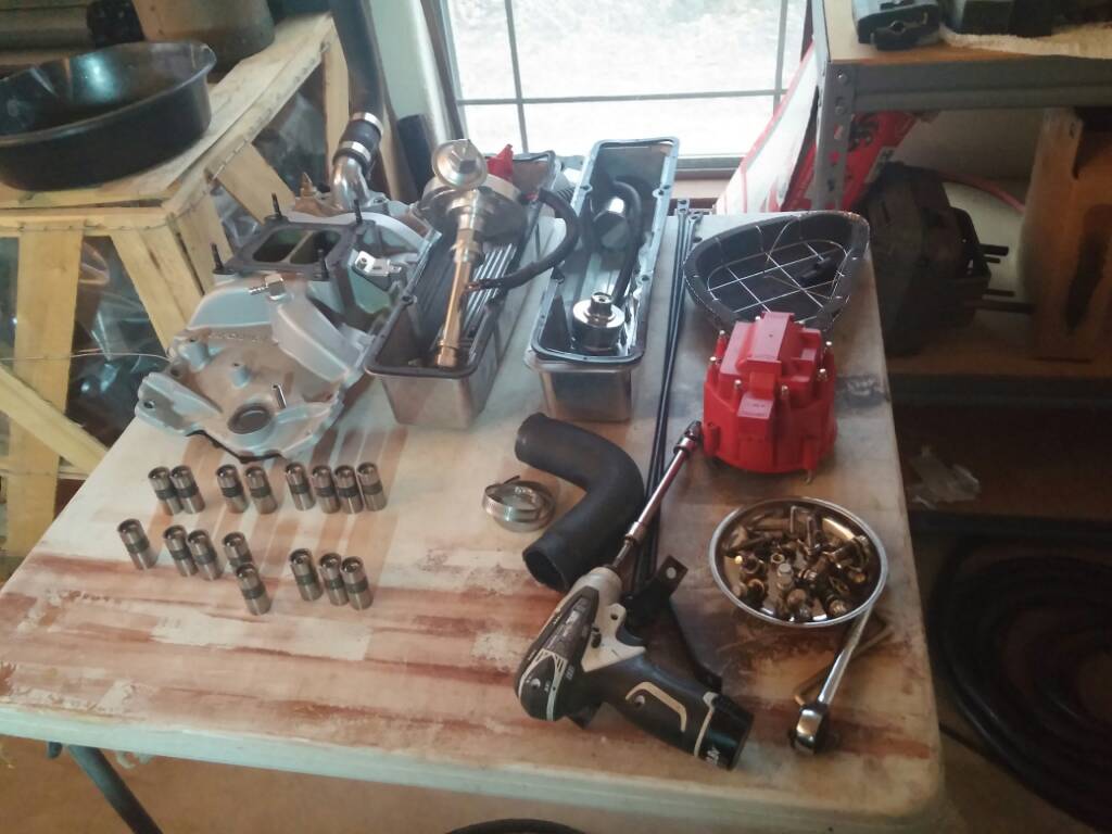

    Still chasing gremlins....my brakes were hanging up, thought it was my residual valve but just notice my brake pedal isnt coming all the way up when released. Pull it up and the brakes release. Havent figured out if the pedal is dragging in the firewall or if I need a return spring or something like that.
    Lifter noise....the engine builder had me running 20-50w syn VR1, I need to add 2 qts and inadvertantly added 2 qts of straight fifty. Oil pressure is always 70psi+- so I am going to do an oil change and see whats what. Cut open the old filter and take a look..
    Horrendous knock noise the last time I drove it, only at idle and is not consistant. Suspect a cracked flex plate, all the videos online of a flex plate sound exactly like mine...already started the teardown..
    Fuel leaks out of the tank at the vent when filled.....didnt put a check valve in....got a rollover valve for it, have to drop the tank again...
    Speedo wacky...havent calibrated it yet but it is about 15mph high, when coming to a stop just before 0 it goes all the way over to 120 or whatever....dont know why....
    Guess it could be worse...still need to install seat belts and door gl***. Need a heater....other odds and ends.
    Not happy with the gl*** packs, not loud enough at all although it sounds bad ***, the cam is just right. Maybe they will loosen up a bit with time....

    As far as the knocking noise, I took off the trans inspection cover and unbolted the converter. Started the engine and it made the most godawful screeching noise. Shut it down quick, figured something changed so it must be the flex plate... I tried a little trick my boss told me about to get it out without pulling the whole trans. I pulled all the bolts to the trans, put in two longer ones on either side, pulled the driveshaft and unbolted the rear trans mount, took off the vacuum line to engine and pulled off the floor cover so the shifter had room to move and slid the whole trans back just far enough to sneek the flex plate out. Was actually pretty easy considering I was laying on my back...
    Turns out all the bolts were loose with one almost all the way out. the screeching was the bolt s****ing against the converter since previously they turned together. Only thing keeping it in was being up against the converter itself. I pulled it out and no cracks, but went ahead and bought a new one with new bolts and hopefully that will be the end of it. (with a little loc***e this time of course....)

    I got the new flex plate in and got it al back together, good to go in that area. Changed the oil and filter and still
    have a pretty noticeable lifter tap. Also really need to get my electrical squared away, my voltmeter shows the alternator not charging consistantly, so gotta figure that out becuase as the voltage gets low the truck starts running bad due to low voltage at HEI (I ***ume).
