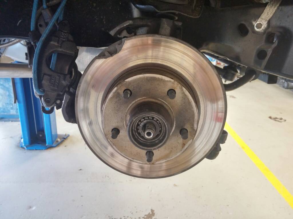

    Got lucky this weekend...was going to hot rod night Saturday and had a wheel bearing try and lock up going about 80 on the highway..damn near yanked me off the road....Got so hot the rotor is permanently part of the spindle.... kept hearing noise prior to **** hitting the fan but there was a rowdy challenger on drag slicks 2 cars in front of me for 20 miles all the way to the highway and I thought that's what I was hearing...
    Funny thing is I had recently tightend them up to get rid of the knocking created by them being loose...guess sometimes we learn about our screwups the hard way...coulda been worse...it happend about 2 miles from the dealership I work at..limped it in and got parts coming...dang hard to find a 74 camaro spindle... 1430259374034.jpg

    BTW, the broken chunk of rotor is from trying to get it off with a puller. Then torched it and beat on it some more and still wouldnt budge. Found a salvage yard that is going to ship me a spindle and got new bearings/seals for both sides and 1 rotor for the p*** side.

    I guess this is a wake-up call for me. My '65 vette has the outer race welded to the spindle on the p***enger's side. After trying all of the tricks you have (save for breaking the rotor), I was just going to pack as much grease as I could and reset the nut. I guess that's out now. And you thought Camaro spindles were hard to find (for a good price that is).
    This also worries me as the No Limit Engineering IFS I put in my '56 uses Camaro spindles, and I thought those were super common.

    I had just ***umed you could pick those up new, but Napa, oriellys and rock auto had nothing so I had to go used..found a couple on eBay but too pricey..called a couple salvage yards and got hooked up with SouthSide autoparts. They didn't have it but found one in their network...should have it tomorrow...I imagine a vette spindle would be less common...

    I am surprised that it wasn't available as a remanufactured unit. I was kind of counting on these parts to be readily available when I decided to use that IFS.
    There is a puller that's arms secure under the lug nuts on the studs. It's for 4 x 4s, so I'm going to try to rent one from an Off Road place as they cost over $200.

    Man what a ***********. So cant get the rotor off the spindle as stated above. Found a spindle used, but about 35 miles from me. Send my parts driver to get it, she gets it back to me and get it cleaned up and painted. Order new rotor and bearings for both sides. Get dr side done, get p*** spindle installed and put on the rotor. Find the outer bearing is too small for the spindle. Find out that the spindle is the same from 70 to 81, but from 77 up the diameter of the outer bearing is bigger. So I call up napa and get the right bearing. Bearing wont fit into the outer race on the rotor. Call up napa and get the later model rotor. Get it all ***embled, go to put the caliper on and find the caliper mount bracket on the spindle is bent. Tried to straighten it out, got it straight but did the ol' "needs just a little more" and broke it off the spindle. Drive all the way back to the junk yard, they dont have another one so I leave and 1 hr later they call me and said they find one. So I drove all the way back down the and get another used spindle and find it is the smaller diameter. I had already cleaned all the grease out of the first one and repacked it and exchanged it with napa, so I now had to clean this one out and exchange it back for the first one I had.
    It still isnt back together yet almost 2 weeks later, but hopefully tonight or tommorow.....old cars are fun huh?...

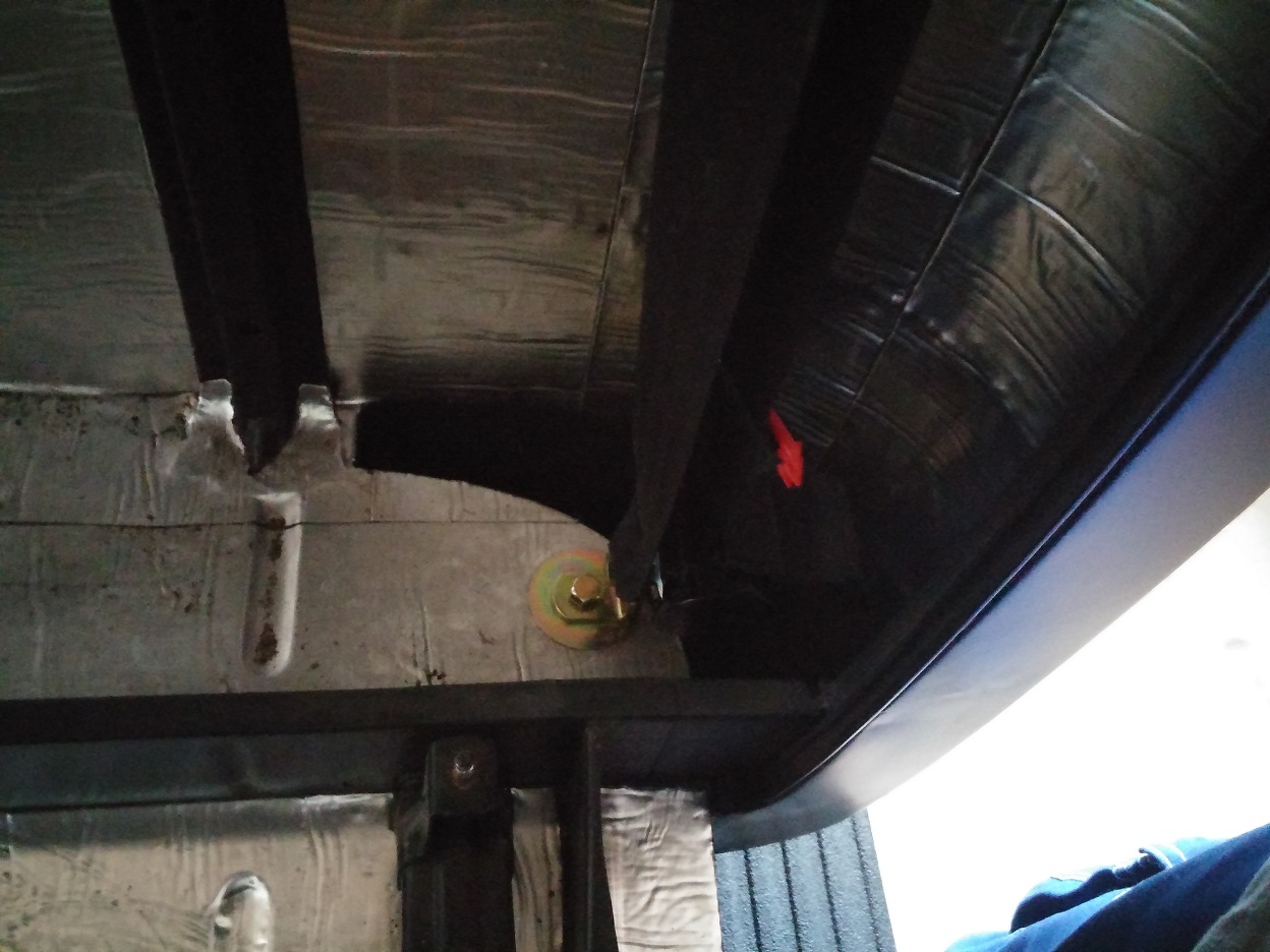

    Got seat belts installed. Actually a lot easier than I thought it was going to be. Of course I had to have a problem though, the lap belts are too short to come through the seat far enough to use them. Found some 6" extension brackets online so hopefully that will fix my issue.
    Also got my cowl vent all set up and working, that is cool as hell. Really makes driving it more comfortable as it brings in a ton of air...
