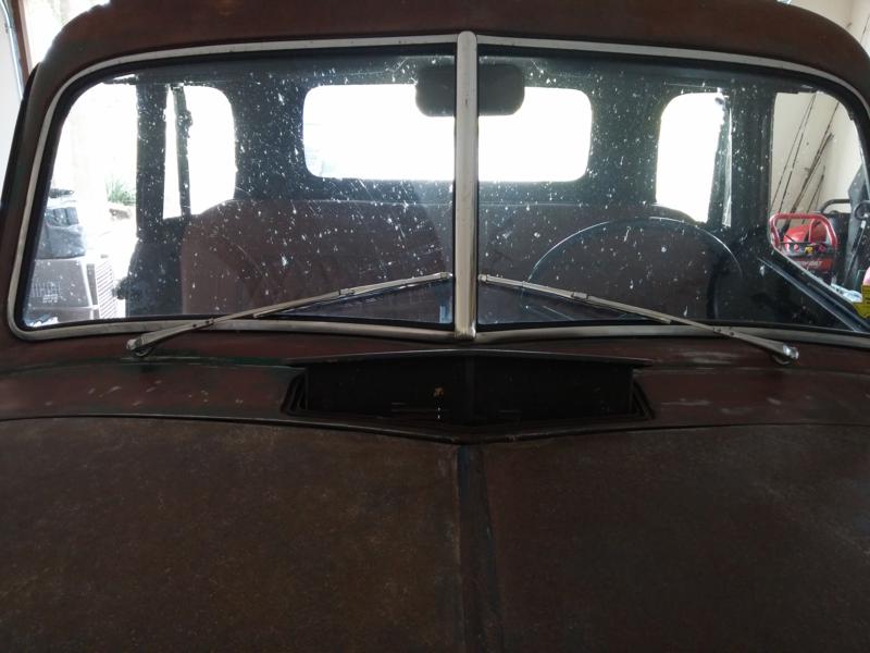

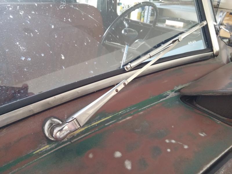

    Got quite a bit done the last few weeks...
    Got original wipers and linkage installed. Finally filled the hole in my dash with a wiper knob. Got a working vacuum motor in...just need to plumb up a vac line and see how it works.
