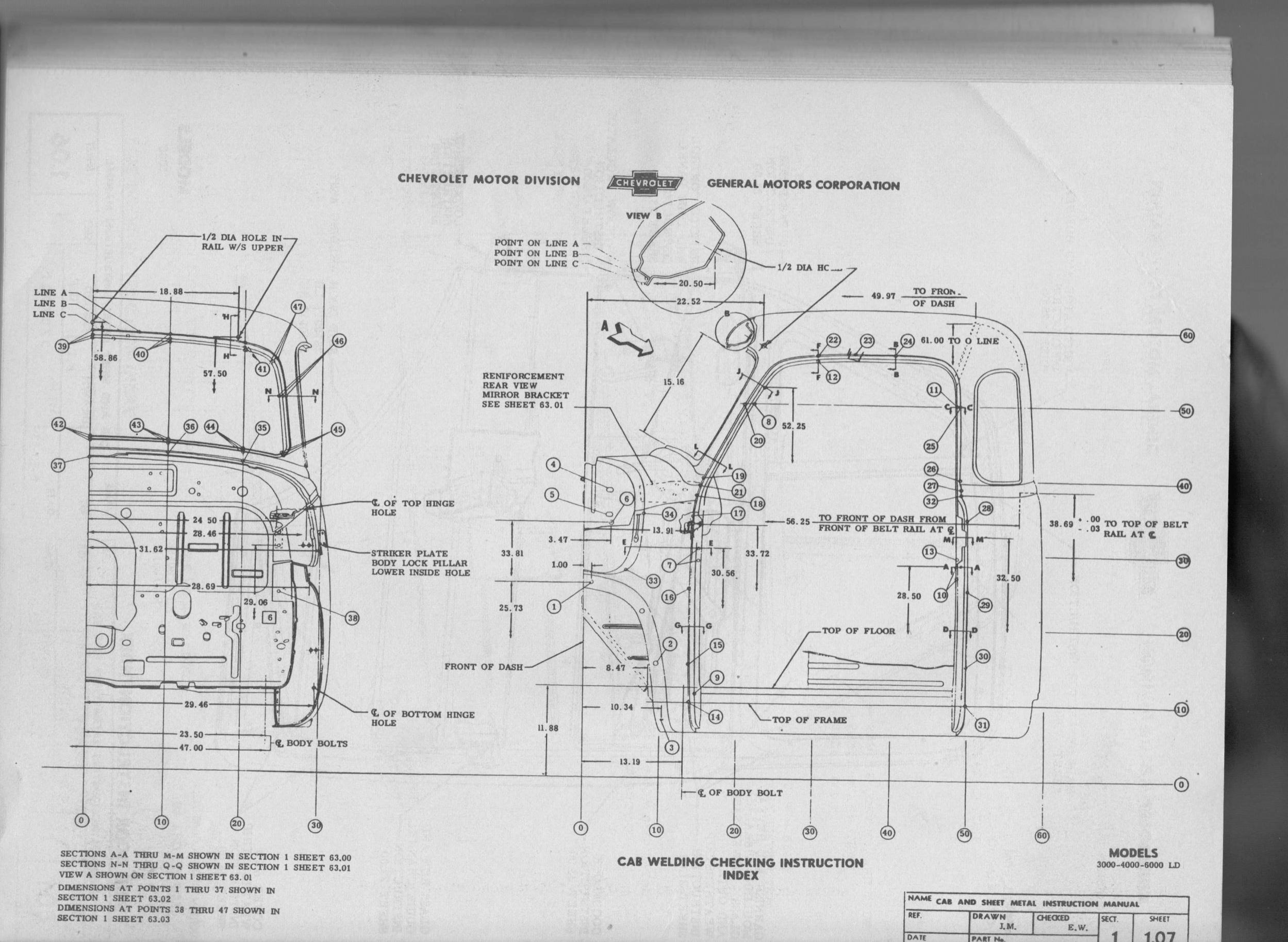

  7. oldman2
    Joined: Sep 9, 2010
    Posts: 2,373
    oldman2
    shadams, here is a copy from my 47-54 ***embly manual on the cab dimensions, hope pic isn't to small (most of the time you can zoom in to make it larger). This might help you as to were everything should line up...Jim
  8. shadams
    Joined: Mar 16, 2011
    Posts: 1,505
    shadams
    Thanks Jim! It wasnt until you posted that picture that I remembered I bought the ***embly manual a few weeks back. I pulled it out and looked around again, lots of numbers and seems to be laid out for someone familiar with those style diagrams, but really makes my head spin. I will have to sit down and figure that out soon though and put it to use.
    So I took 65standards advice and boy did it pay off. I couldnt find a port-a-power locally so I made one myself. Bought a bottle jack and found a ceiling fan down rod, found some s**** angle iron and welded it to the ends of the downrod at angles that would match the door jambs, cut them to length and welded them to the bottle jack. Presto, home made porta-power!!!
    Stuck it in the door jamb and went to work. I was amazed how far down that cowl had sagged, but I think I got it all back to normal!!
    I dont know what I would have done without your advice Tony! I owe you big time. Once again this place comes to the rescue. Thanks again and I am sure I'll be bugging you guys again...:D
