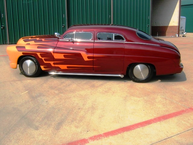

    That Barris car works very well, excepting - as you say - the rear window. Why not use a `51 rear window, since you have the frame now and you´re going for a milder chop?

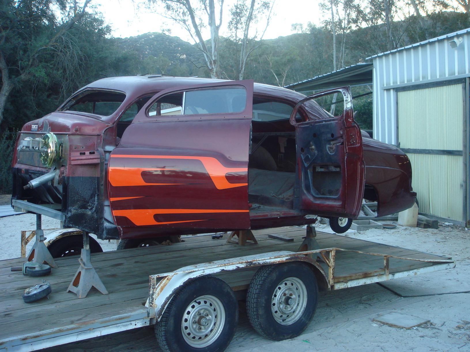

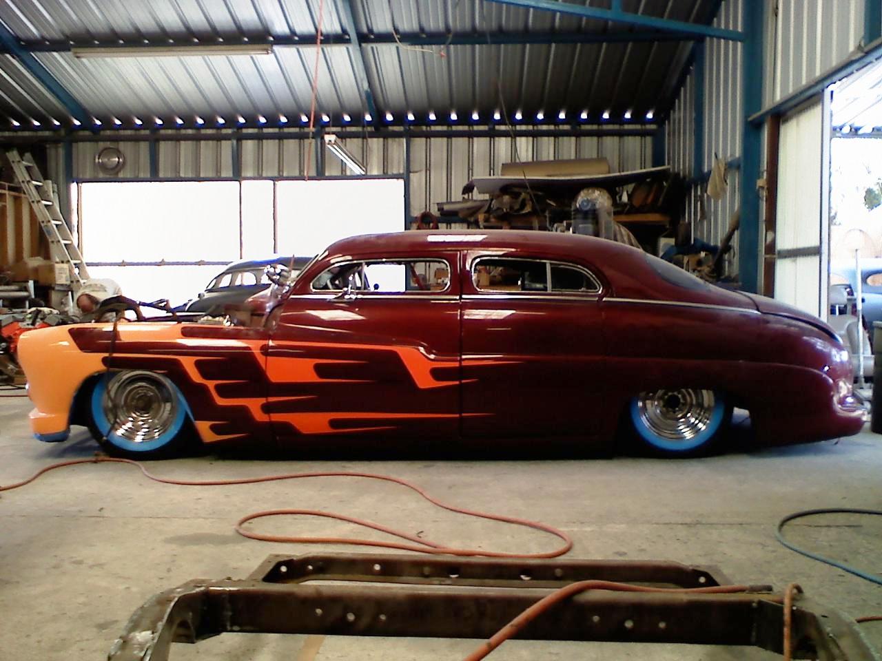

    HRod 50 these pic's should help you get a better idea of what your new roof pofile will look like. I know this one is a hard top and a little lower than you want yours. Just imange it a little taller and with window posts & side stainless still attached to the doors and with drip rails. I plan to give it a 3.5" to 4" cut up front = (12.5" to 13" windshield) with 4.5" to 5" out of the rear and relocating a 1949 merc rear window forward about 3"

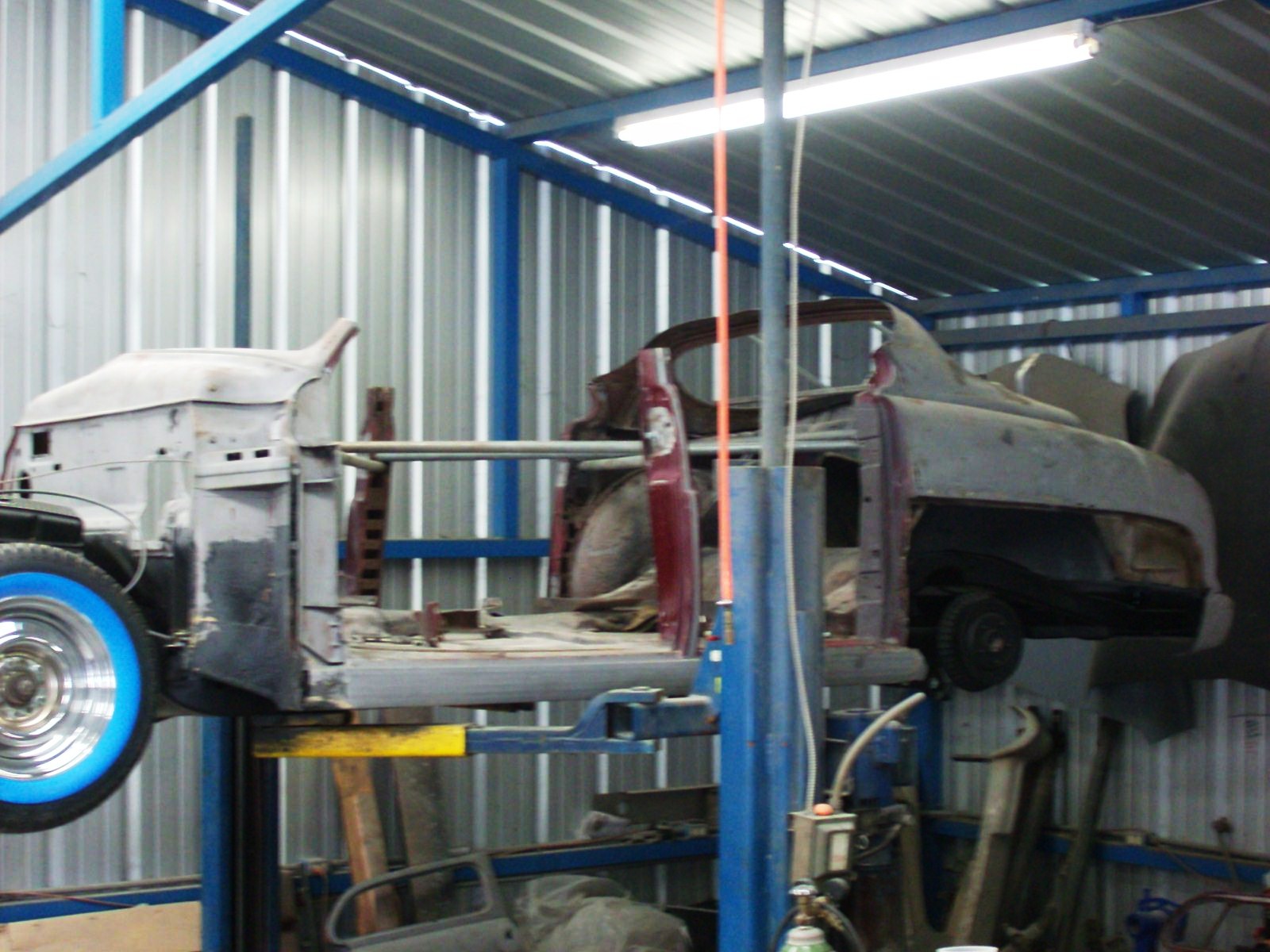

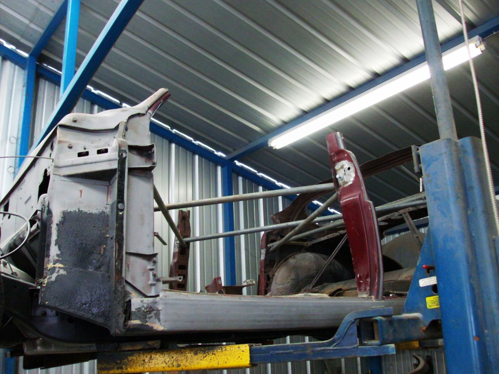

    HRod 50 I sure hope you are you setting down. Ok it has been raining off and on here and the weather was just to ****ty to start any paint real work so off went your top with a few other small items :eek::eek::eek::eek:.

    The transformation has begun....
    "Don't make me Angry, you won't like me when I'm Angry"
    To Be Continued..........:eek:

    :eek: Holy Convertible Batman!! :eek:
    Can't stop now, finish you must.
    I would not show your wife these pictures until after the roof is back on the car. They have funny opinions on stuff like that;)
