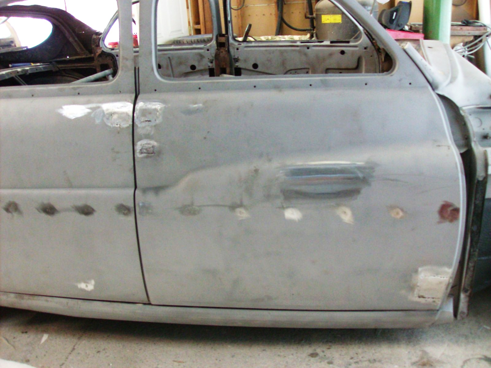

    Got the other rear door rehung with the rear corner rounded to match the other side and started to fit the trunk. Still need to work on the rear bumper apron and then it will be the time to put a new helmet on Thor :cool:

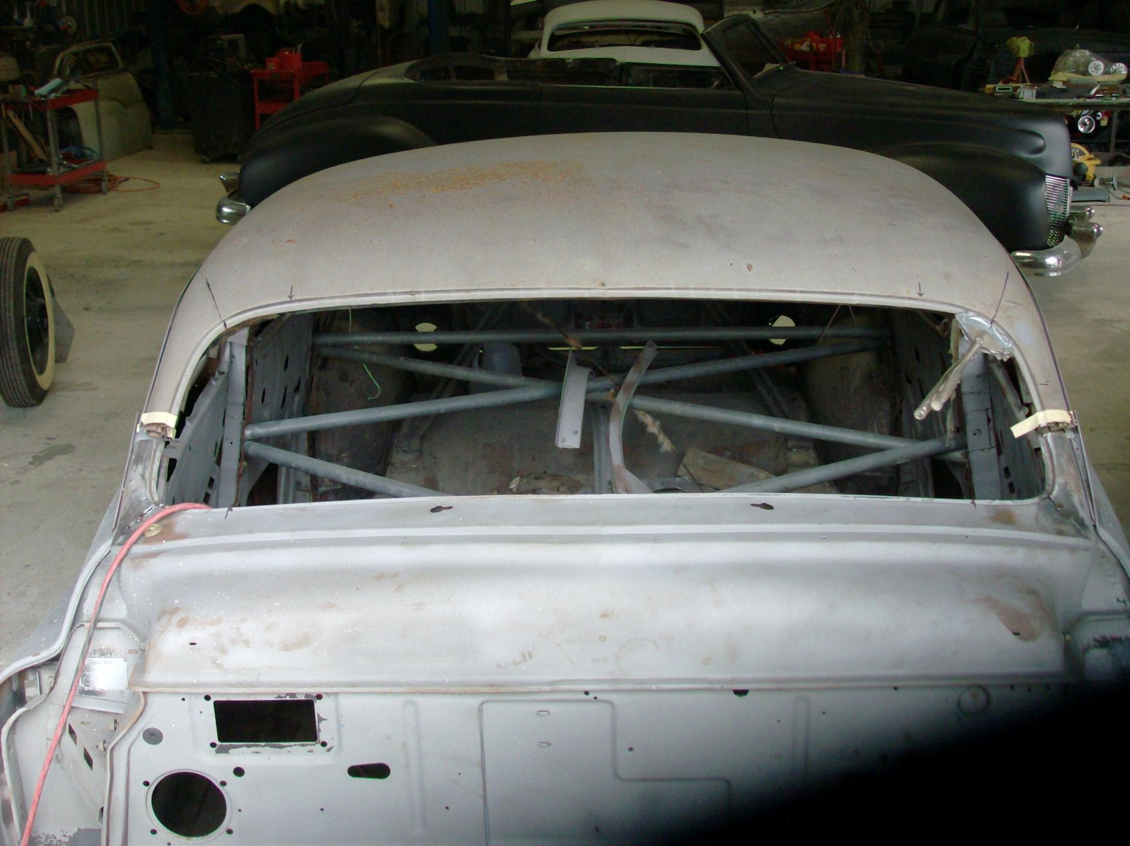

  20. Heres a little update. I finally got another build at a good stopping point mid last week so i started to install the new top. I am doing this chop a little different as i want it to stand out from the norm. I am cutting 4" out up front but will be taken about 5" in the rear. I am also going to keep the rear door window opening long just like orginal as it will have a working rear vent window. I also plan to reprofile the top side of the rear door to make it look more like the profile of a 2dr rear window. Sorry for the bad pics as my shop camara has seen better days.

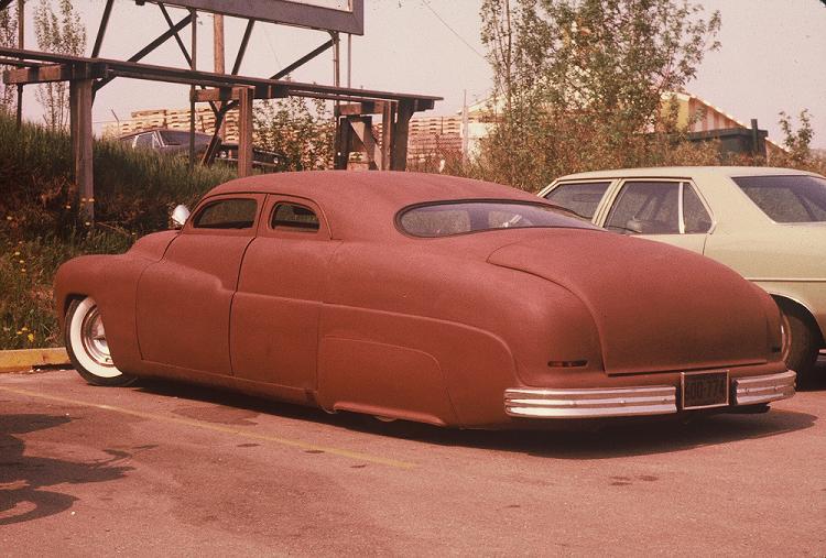

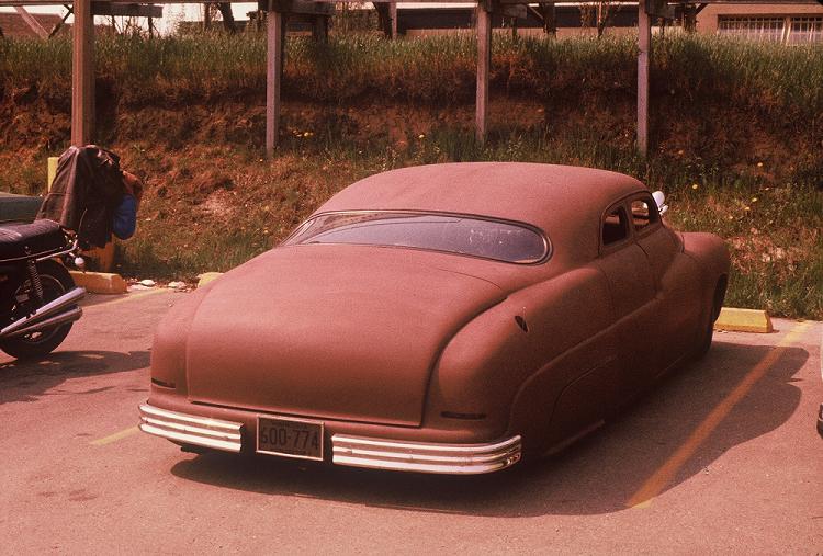

    Awsome merk, My dad has a four door, Here is a pic
  24. WhatsaMerk?:eek:
  25. tattedfordguy
    Joined: Sep 13, 2006
    Posts: 1,361
    tattedfordguy
    merc, Is that better?
  26. no it wants to save it to the computer.
