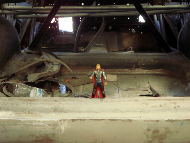

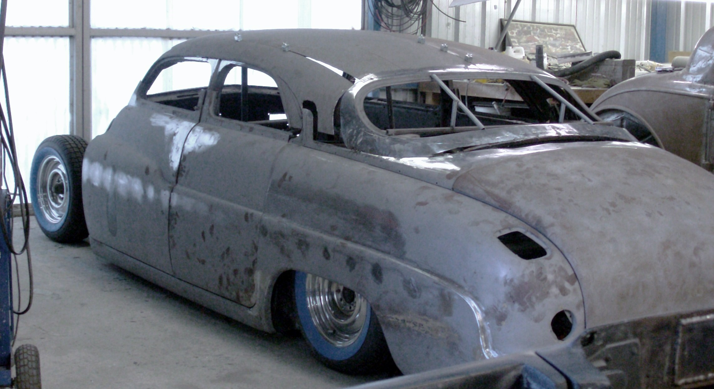

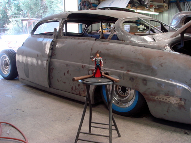

    Here you guys go... Since the only thing I know about is Chopped salad, I'll let Rick comment on how he's chopping it..
    Once again, Awesome RICK! Thank You.....
  3. Trukcrazy
    Joined: Mar 5, 2006
    Posts: 109
    Trukcrazy

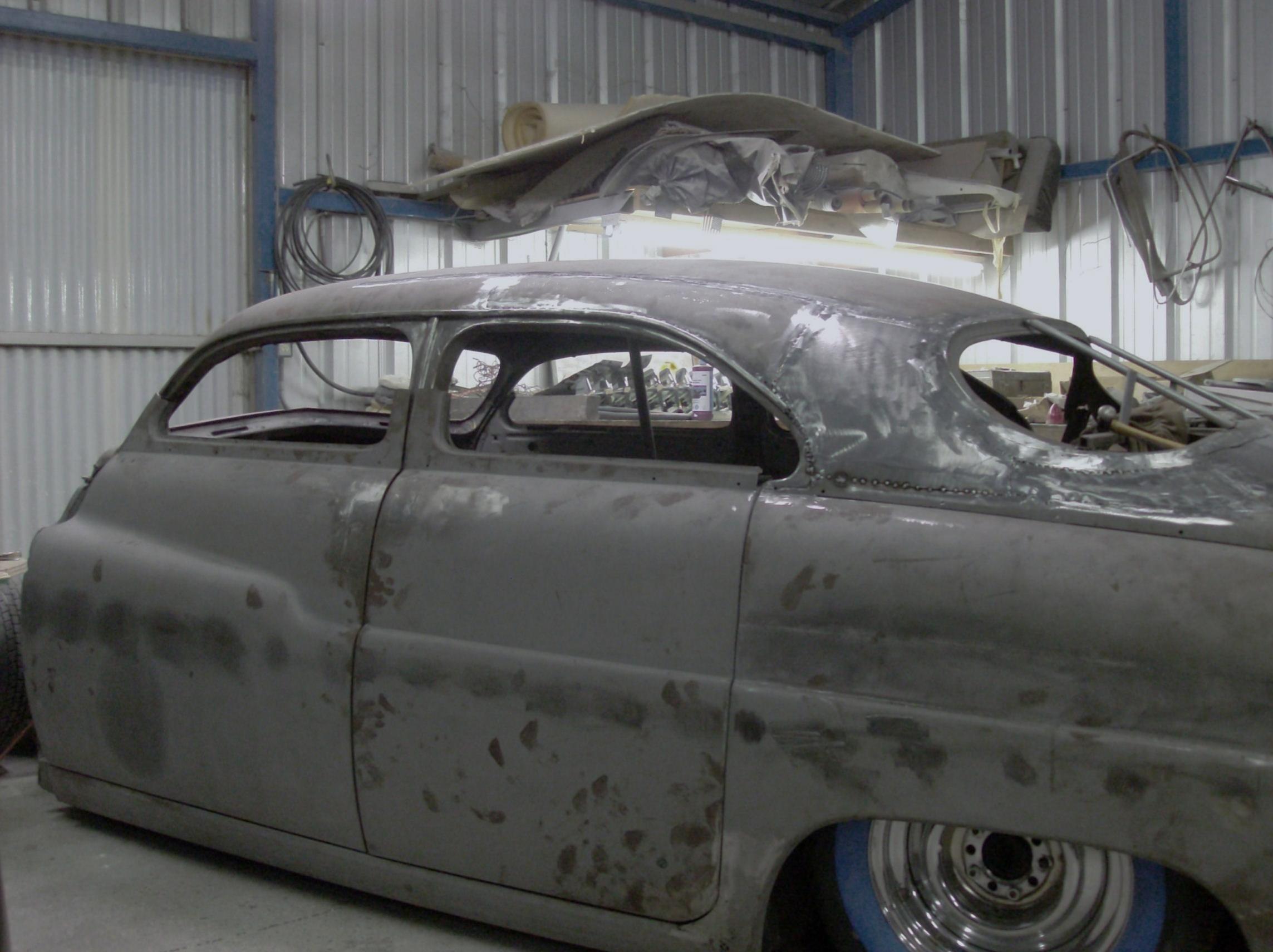

    Can't wait to see Thor ruling the streets. Rick, from a spectator's position, Thor is looking great. Two thumbs up to you!

    Wow what a transformation ! The profile looks great, nice job Rick and you must be getting excited shes looking like a car !!

    quite an improvement. the original builder should be banned from the automotive hobby completely.
    I could see him if he ever saw the car again telling is buddies ""yeah, I built that car... looks like he changed the interior and added bumpers""

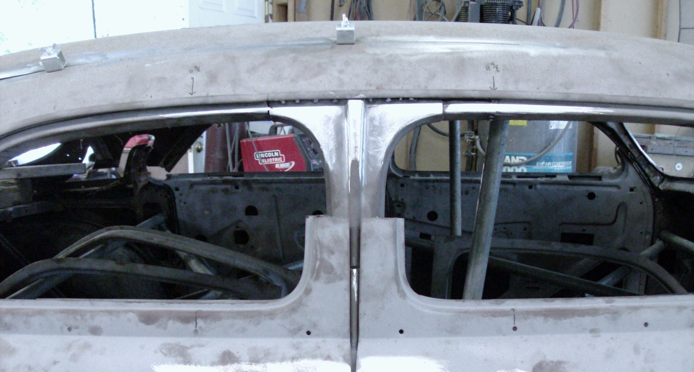

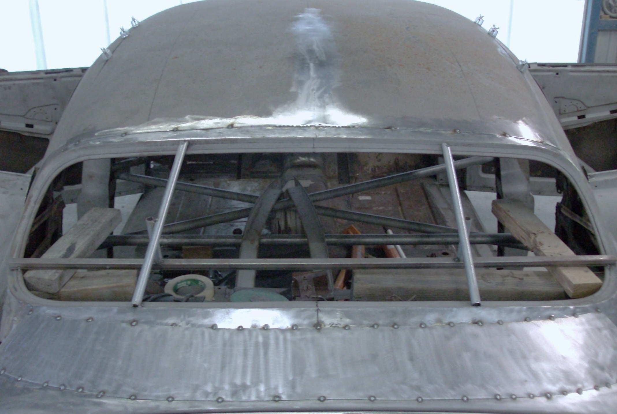

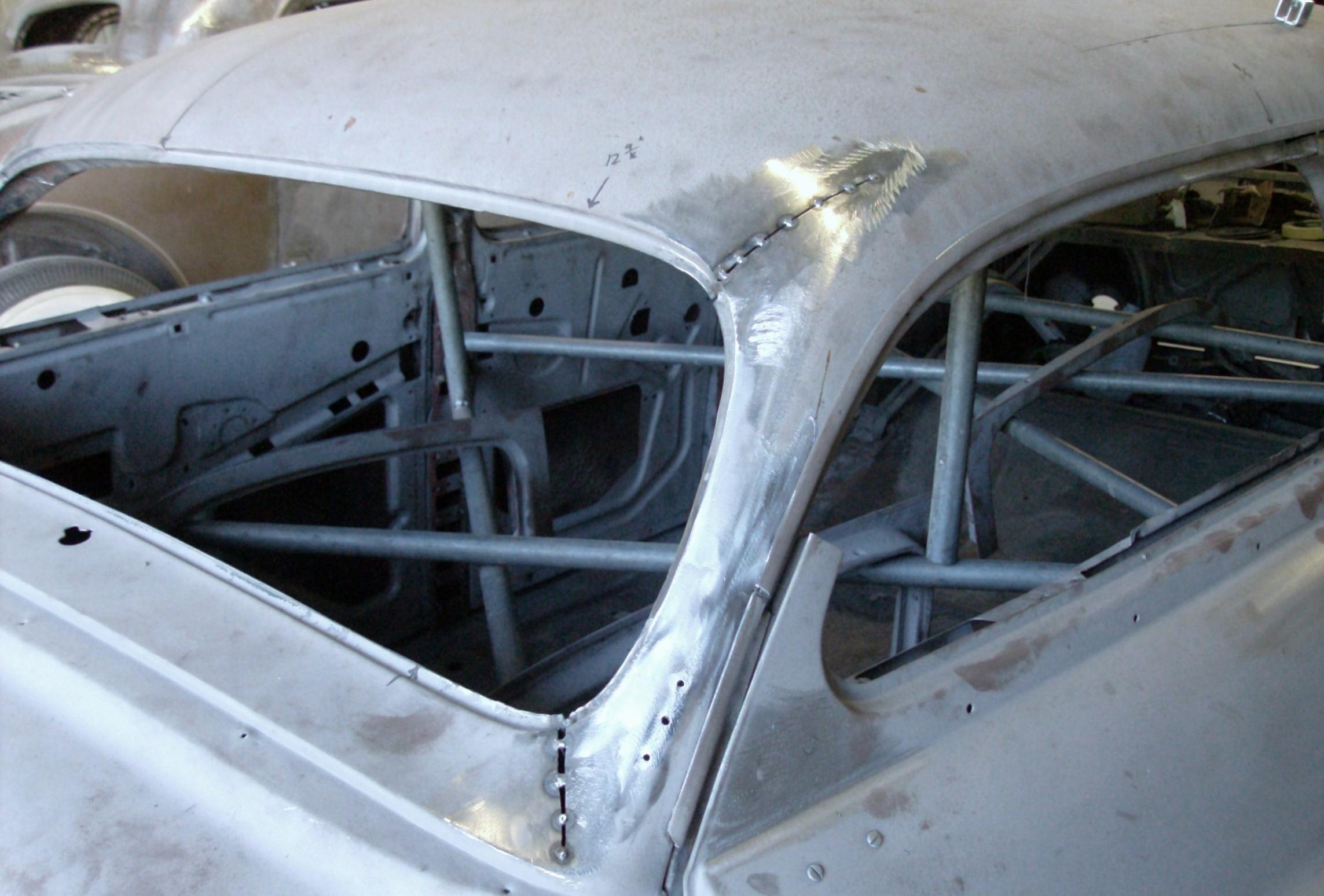

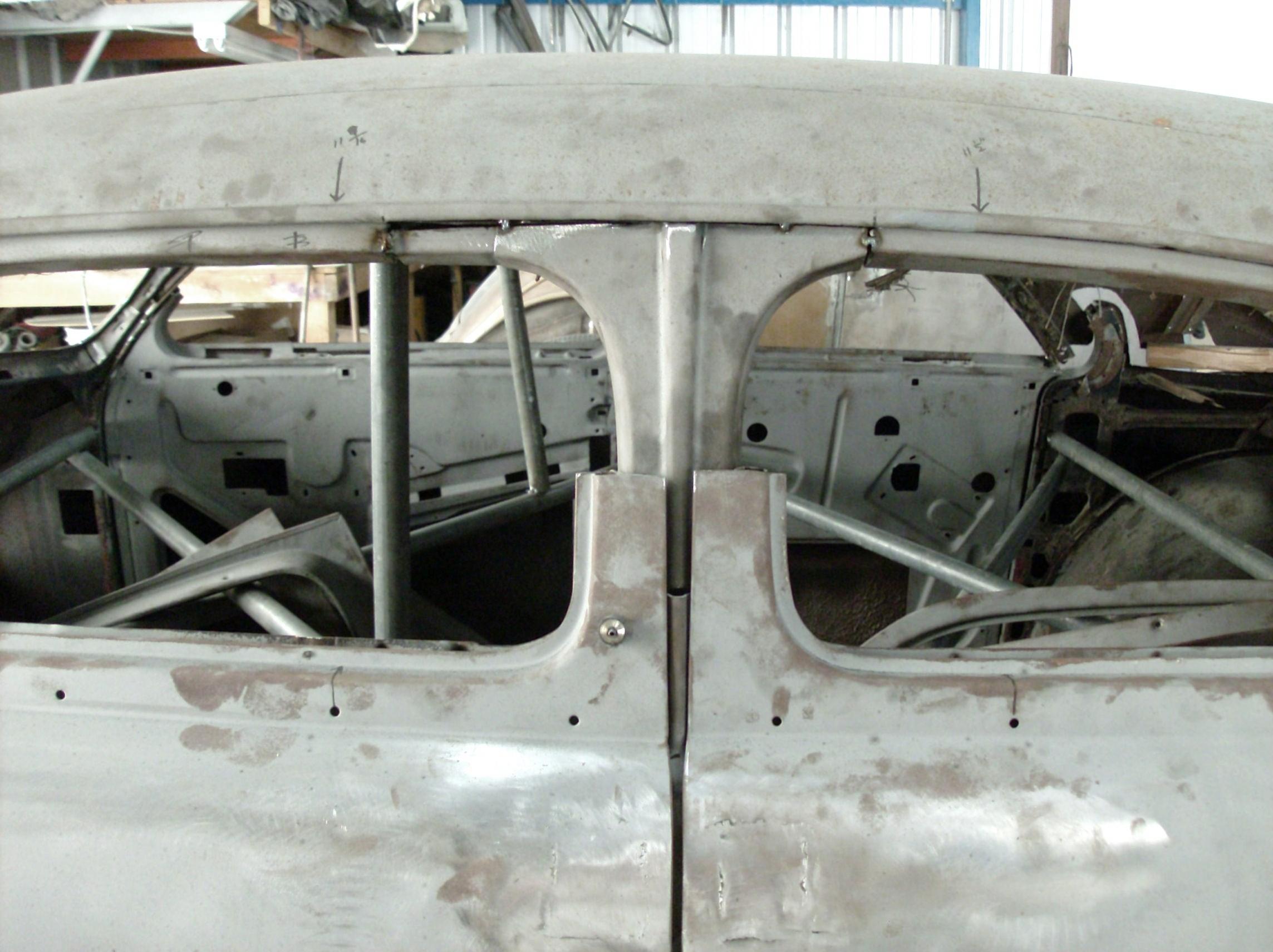

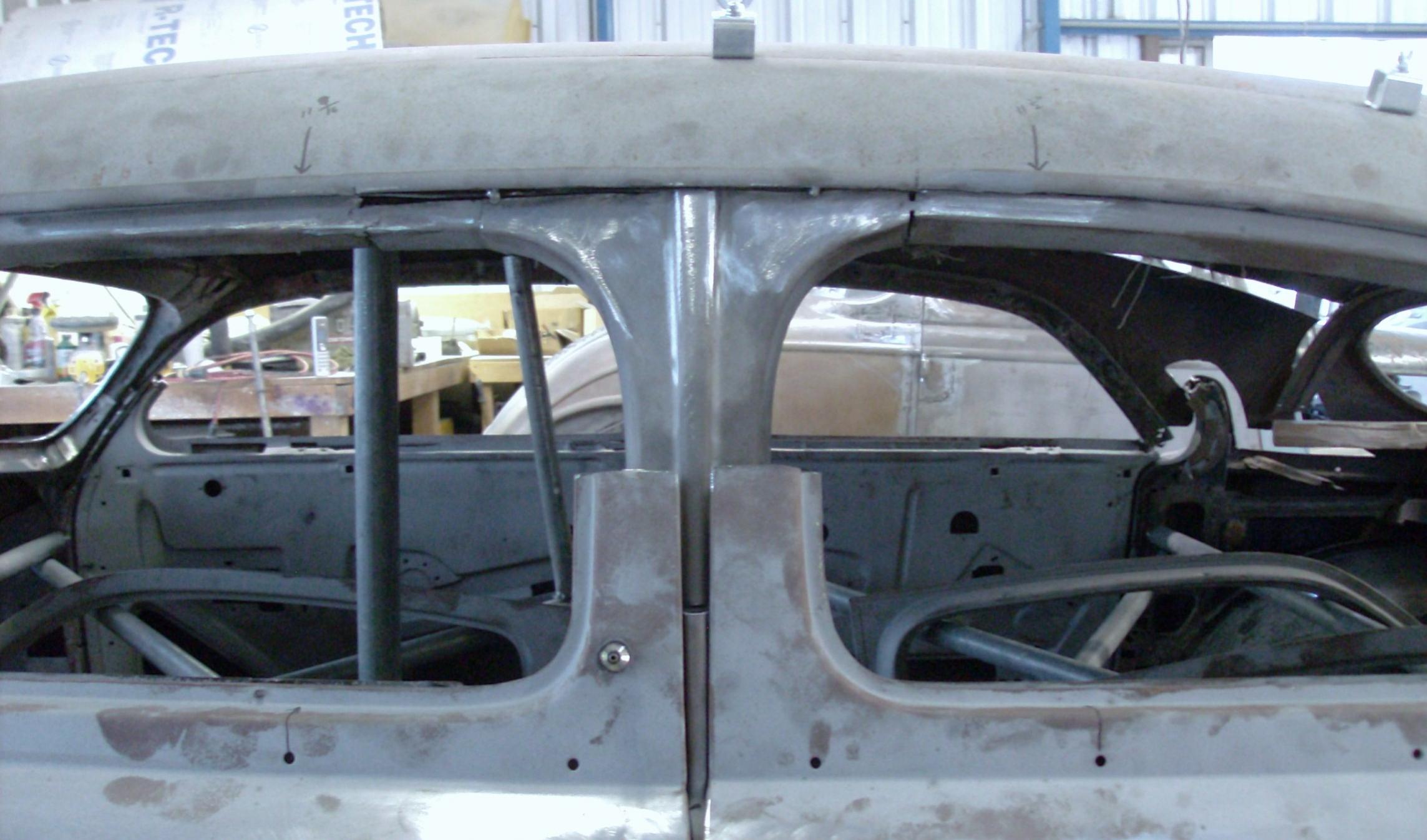

    Hey i just want to say thanks for all the good comments. To answer a few about some tricks i do on a 4dr chop i will do it here so other can know also. One thing i do to all my merc chops 4DR and 2DR that i do not see others do is i weld the lower part of the rear windon onto the package tray as it makes the rear window more solid. I then make a new cat walk that welds to the orginal cat walk and to the window frame. When done it ties the trunk hinge supports and package tray back together simulare to what the factory did. Another little trick i do on 4dr chops with the center door post. I first ruff set the chop on the A pillar and the back. I then measure how far forward the center pillar has moved. On this on it was 2.75 so i cut 2.75 more towards the rear when measured from the center of the pillar and removed it. Then i swaped sides. When done it looks like it came from the factory like that. Hope this all makes since to most of you. Rick Erickson
  8. James D
    Joined: Feb 8, 2007
    Posts: 4,971
    James D

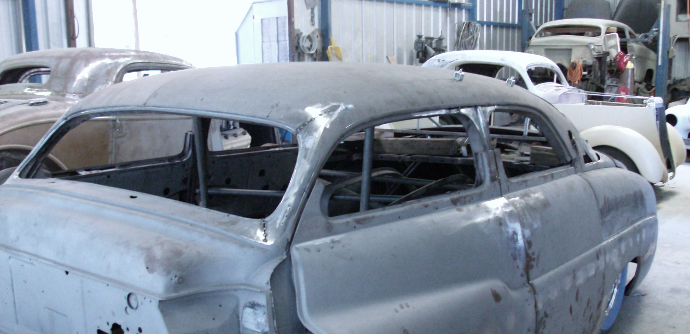

    I´m liking what seems to be going on with the roof profile around the back door. Losing that awkward curve where the door takes a chunk out of the C pillar. Should look much more coupe-like when done.

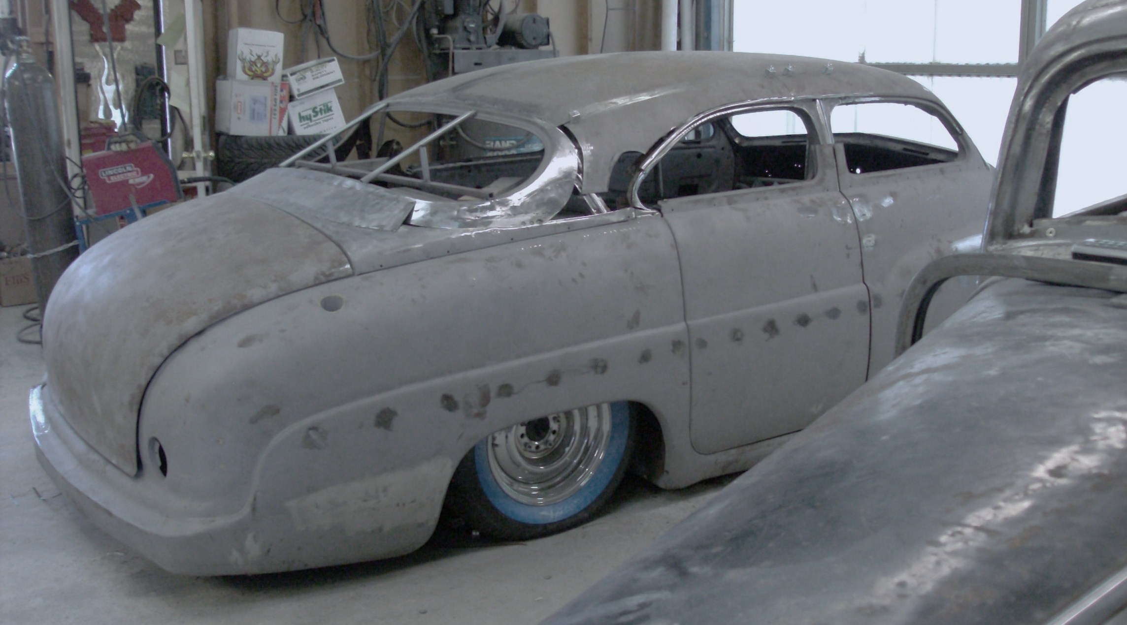

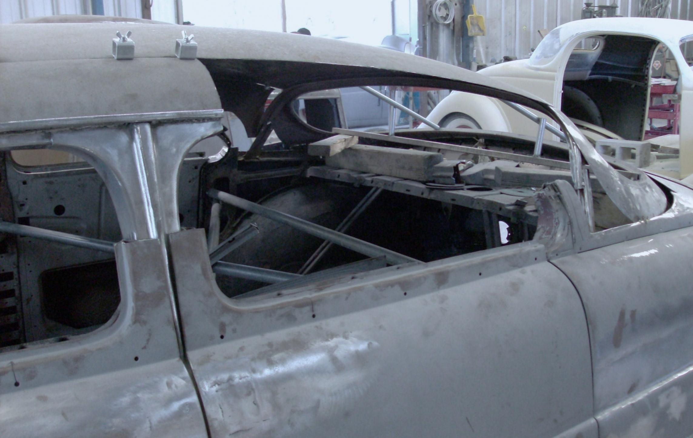

    I got the right rear quarter window openings mocked up this afternoon so you can see more what the window profile i am after on this chop. Since it will have a working rear vent window i keep the rear window long and sleek.

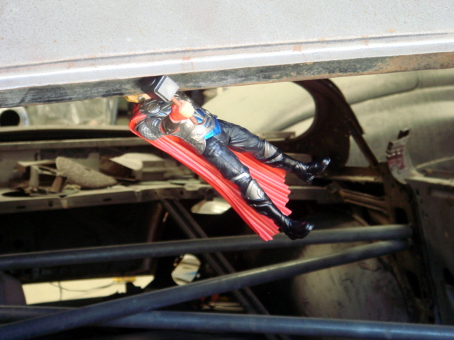

    So I sneak over to EXK, unannounced, and found out who's really working on my car...

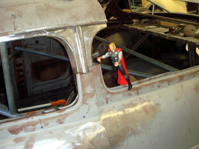

    But seriously, look at this detail, and skill.. EXK, is the real deal.. I wish I could show some of the "famously" built cars Rick has that the owners are counting on Rick to fix :eek:...

    Thor strikes again! Looks like the roof was hit with a big hammer, for sure.

    This is looking sooooooooo much better than what you started with. I am totally digging the reshaped upper door edge on the rear doors. So often the chopped 4drs still have that tight bend at the top of the rear door and just puts a kink in the flow of the top. This will undoubtedly end up being one of the best chopped 4drs out there. Great job!

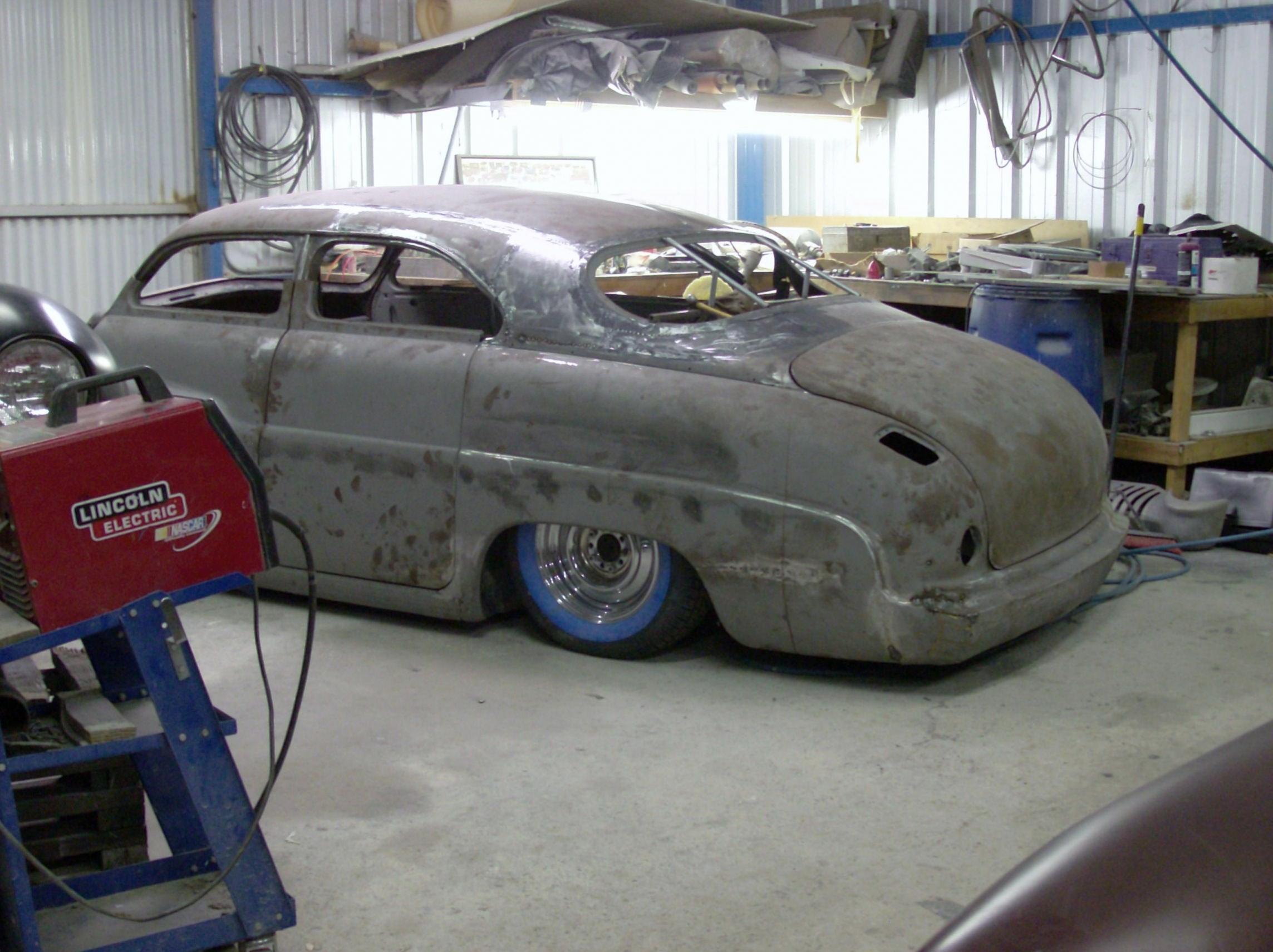

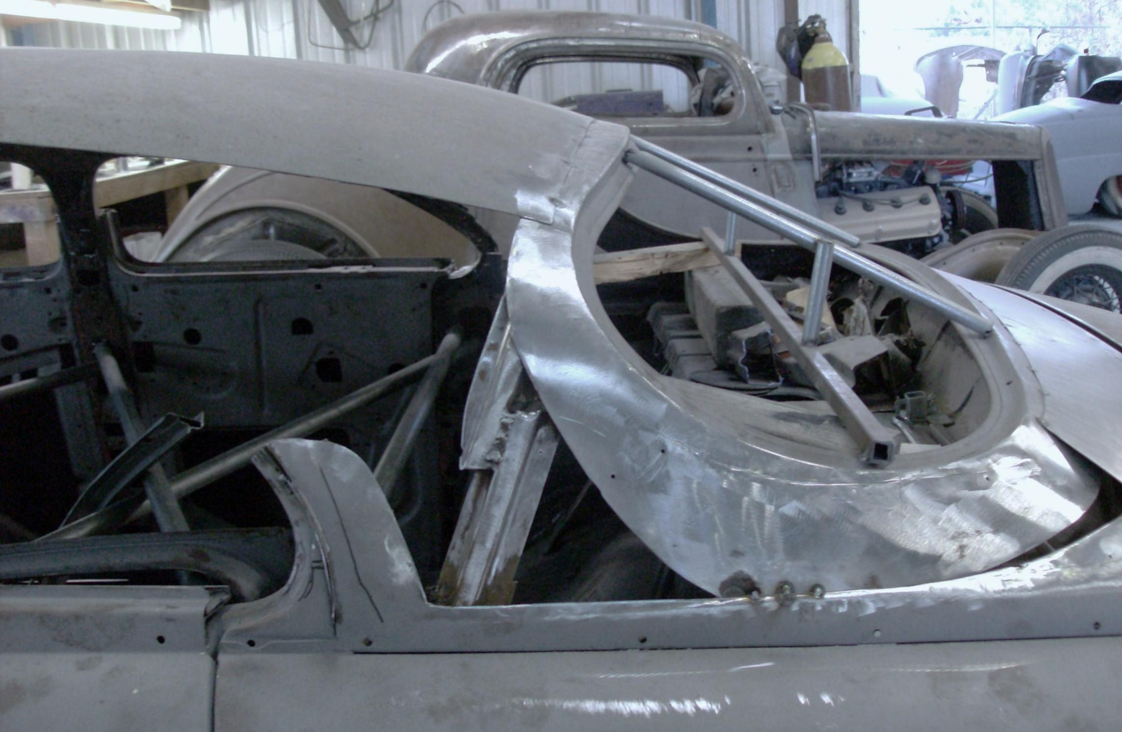

    Sorry people we got a little set back finishing off a few cars for the Motorarma show. That set us back on a few other mercs that we were in the middle of painting. Now thats all cought back up i finally got a break today and skinned in the drivers back half. I moved the rear window forward about 1" but since we are keeping the drip rails and door posts i decided to rework the catwalk area to retaine most of the lower back window revel
