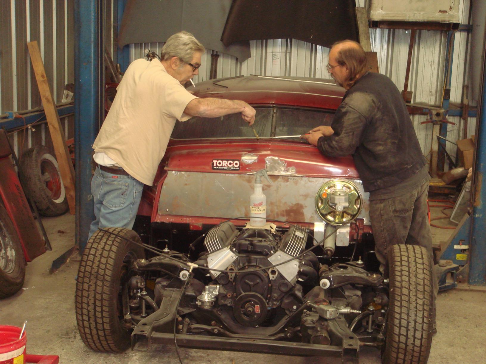

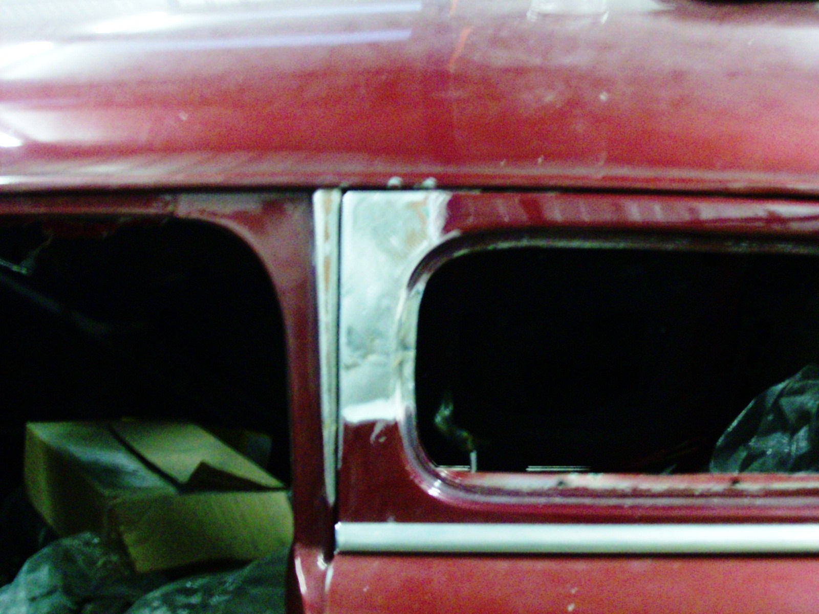

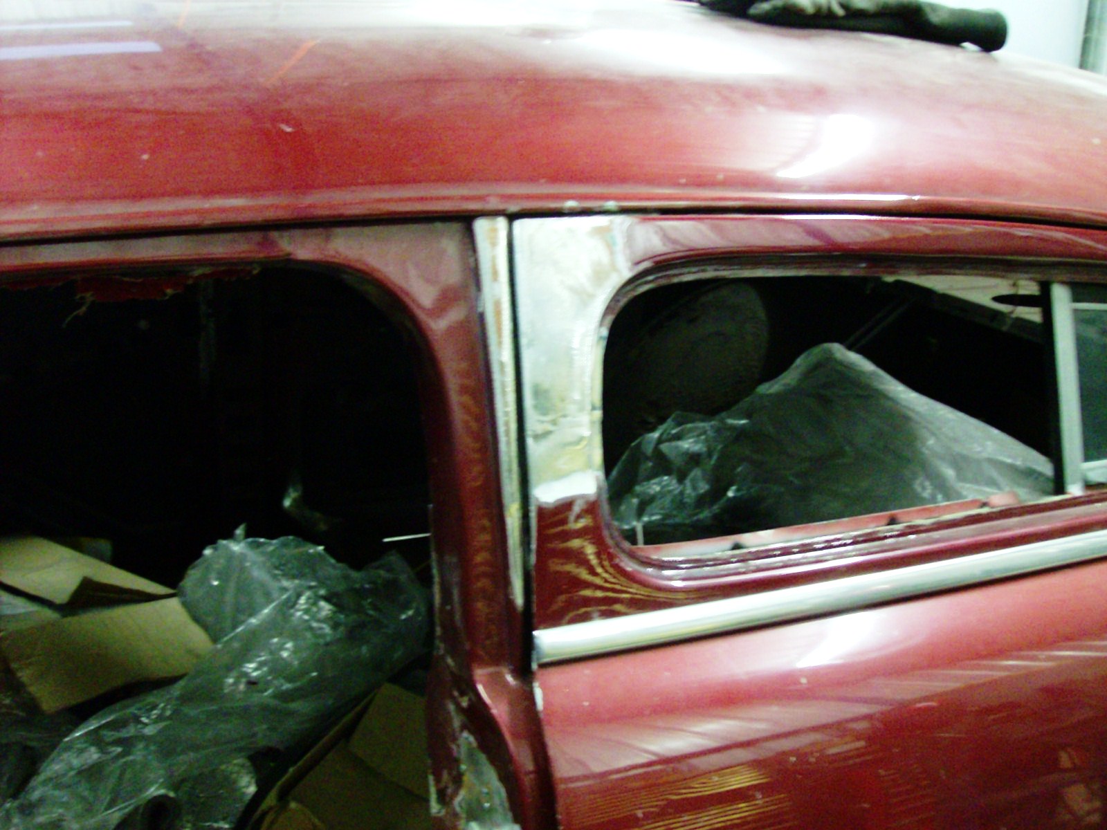

    So I got another Update from Rick today. I was going to write what Rick wrote but I figured I'd cut and paste his email with photos:
    "got that last door hung. What a ***** it was to make it fit correctly but it finally does. I had to cut the door in the old chop line and take 3/16" out of the front of the door. Cut the top front edge of the door off about 1/8" and re weld it all back together. I also had to cut lose and re radius the upper door post and raise it up 1/8" to clear the door. It now swings very smooth and aliens with the body with even door gaps just like the other 3 now do also.
    Thanks, Rick"
    The words speak for themselves.That's my Builder. You can't go wrong with Rick Erickson and Extreme Kustoms..

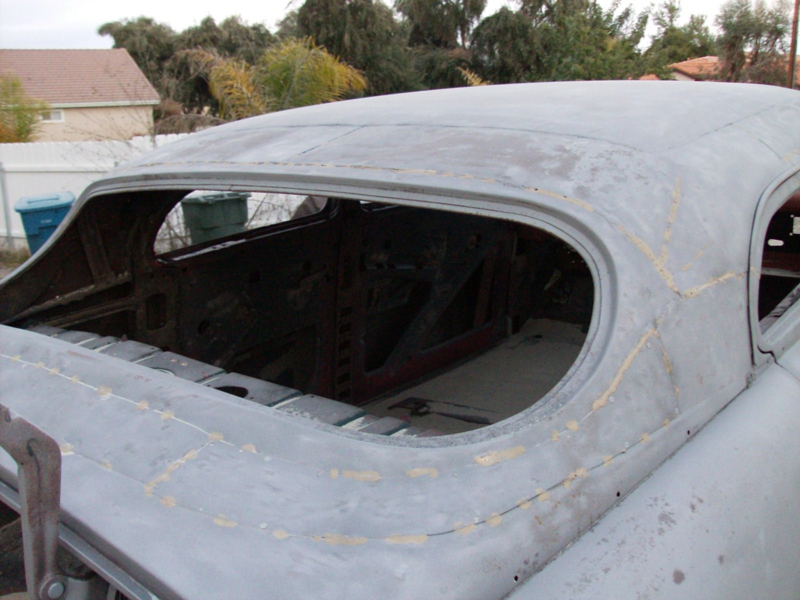

    I just got off the phone with Rick, and he's going to fix some of the top issues when the rear window is changed out and all the gl*** gets replaced. Unfortunately, it'$ ju$t going to be too labor inten$ive at thi$ time to do a complete top, and door fix.
    But, To be honest, I like it, it's not perfect by most peoples opinions, but I really like it, and I can easily live with it, for the next few years..
    Plus Rick is a Prodigy, and he's going to get the windows, and trims, all looking right. I'm not worried..

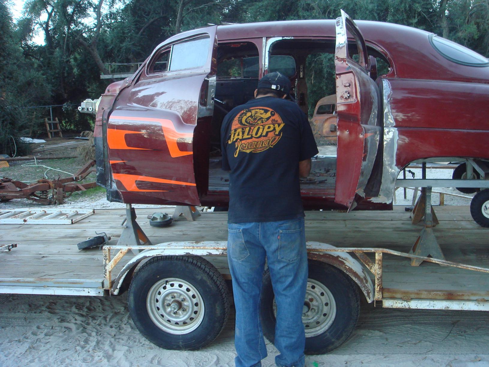

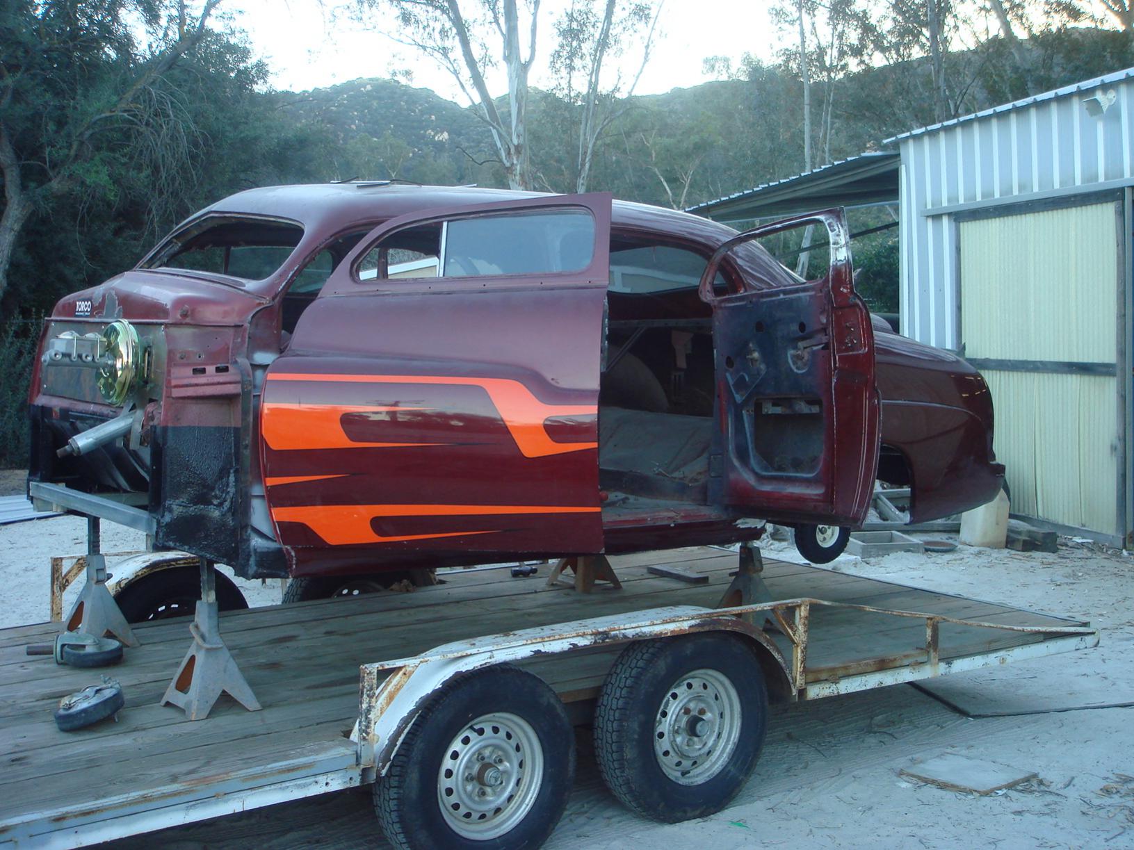

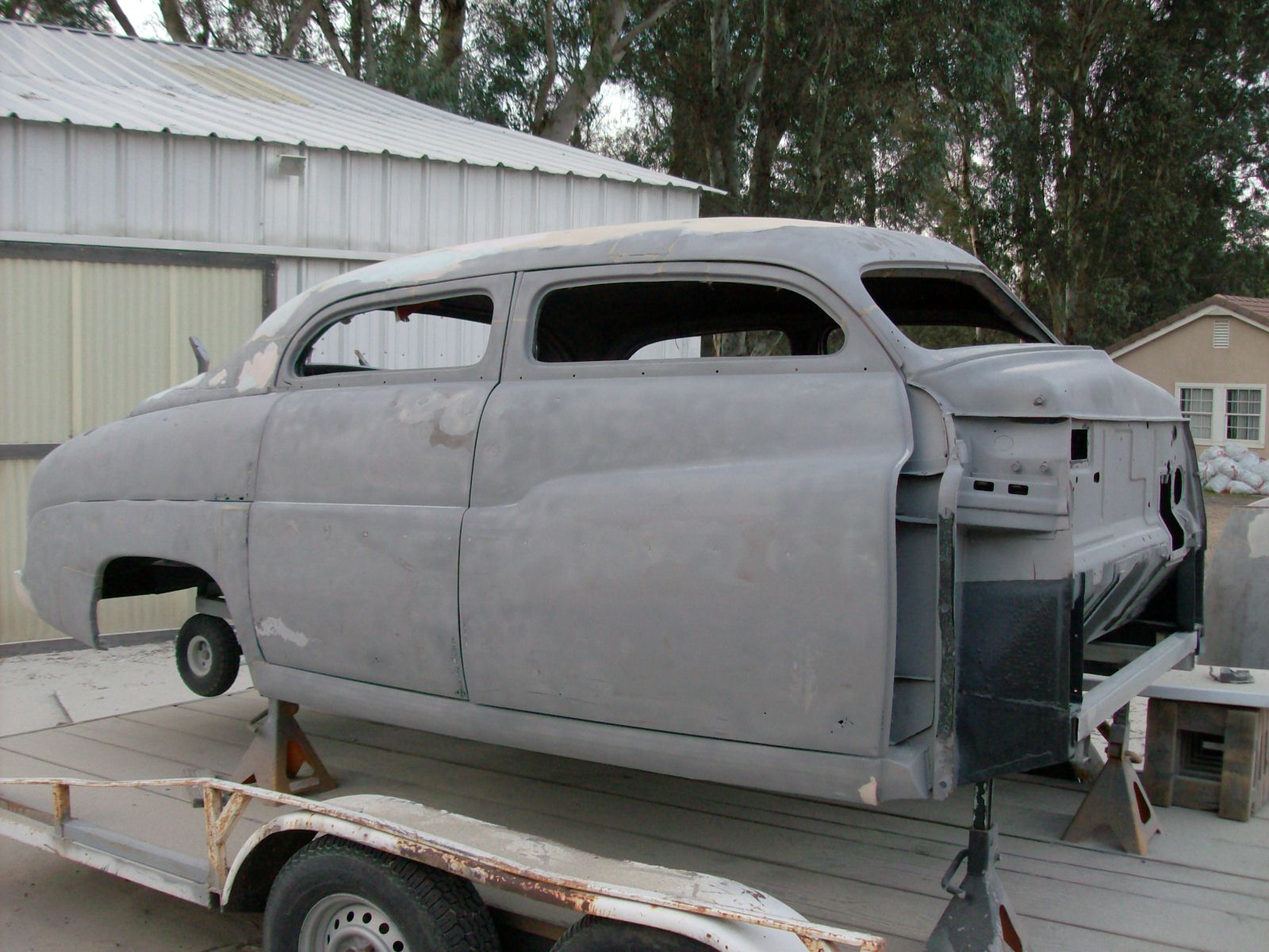

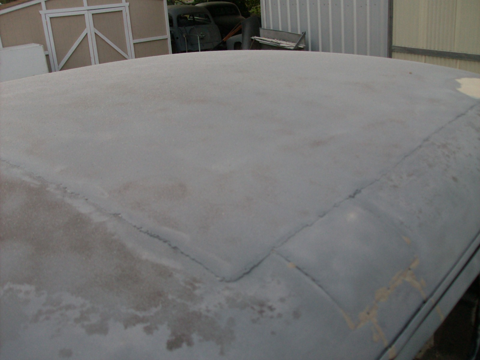

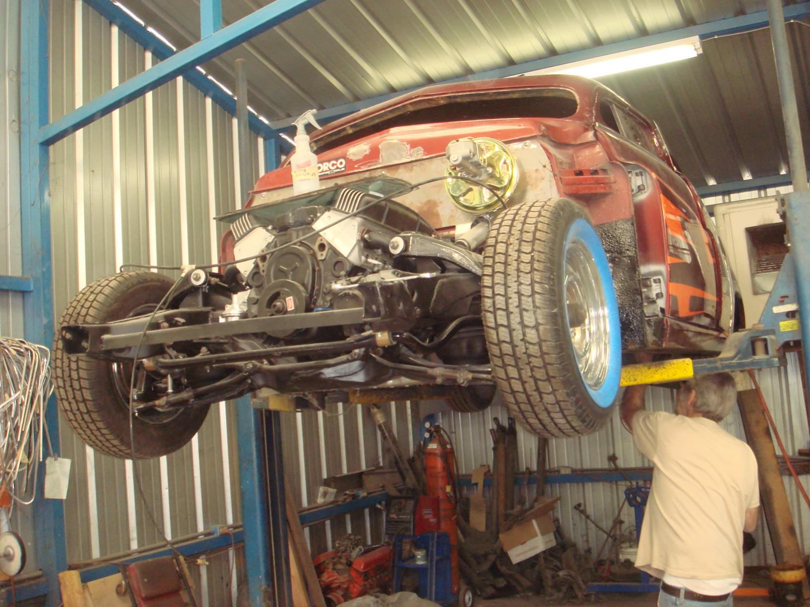

    Soo, After much argueing with Rick at EXT, and in the one picture you'll see I told him I wouldnt let the car come off of his head. He finally agreed to sand blast my car..
    I don't know if this was a good idea, but I couldn't keep on having all this work done to it, without going down to bare metal.. So here are the before shots.. The body has to come off again.. Next time you see her she'll be shining, and hopefully with not too many holes.. Please pray for me...

    A Little Jalopy Journal Love...... I hope by wearing this shirt I will be empowered by all the great builders on this website past and present, and have one bad *** 4 door Merc.....

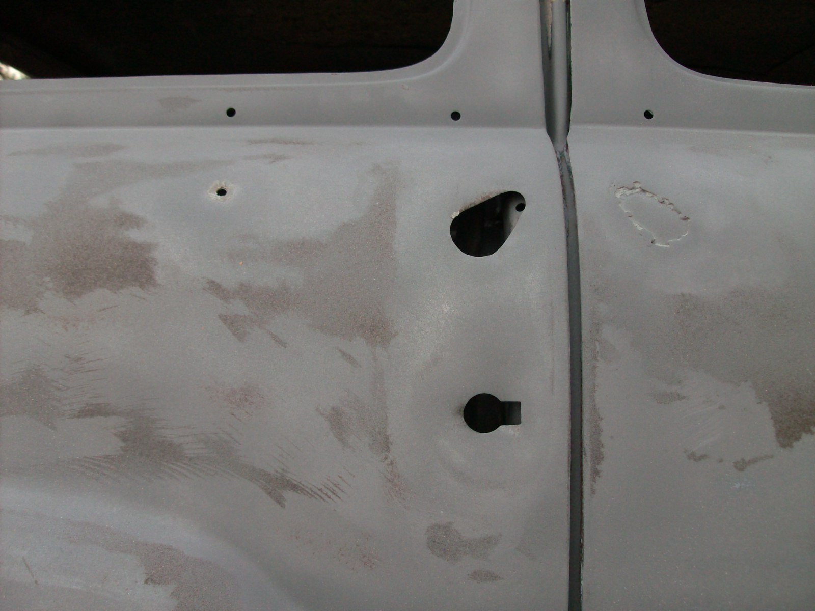

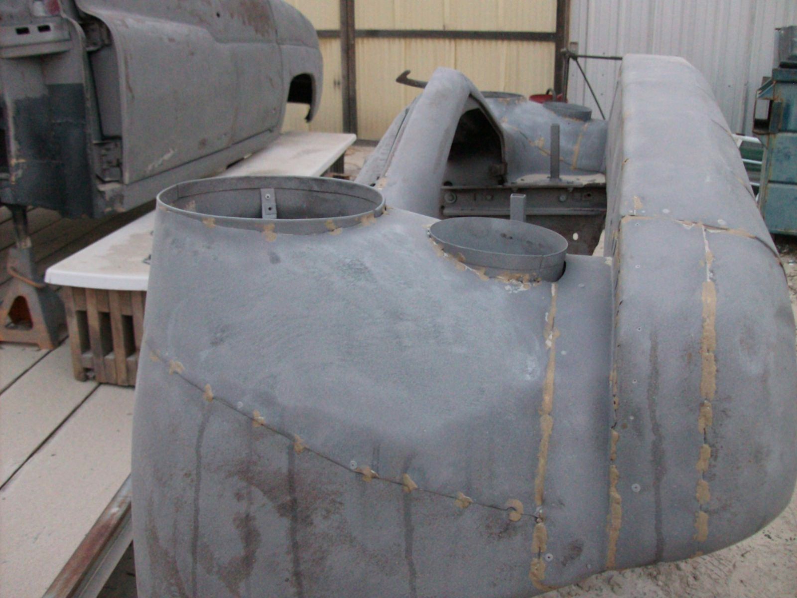

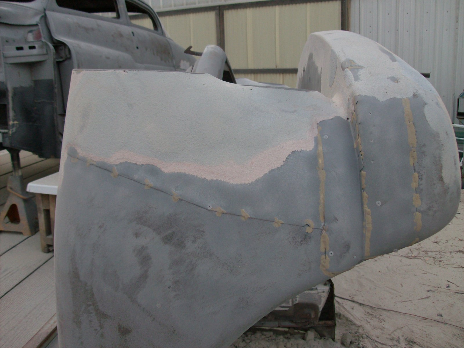

    The car has been sand blasted.. It's not good news.. I'm waiting for pictures, stay tuned... Pictures tonight...

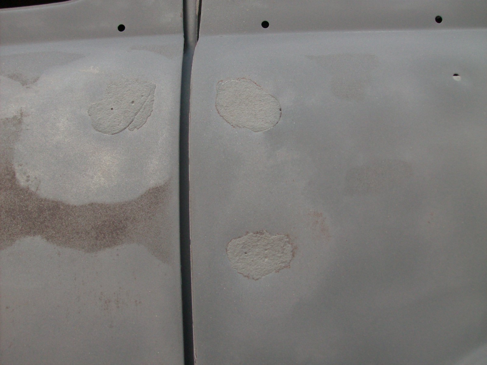

    First off i'd like to say i'm happy to see someone else building a 4 door with great pride! We also stripped ours down to metal and found some horrible bondo/body work. The car was owned by an older lady in Kansas City until 1965. It was purchased new in '50. I'm guessing she didnt know how to drive very well (her husband died just prior to the purchase in a plane crash) and the car was a learning curve for her. When the car was sold off in '65 it went to a collector and i'm guessing he paid someone to fix the dents in the fenders and the door that she smacked the car into.
    Unfortunately no dents were pounded out and fixed, bondo was just slapped on the car by the pounds. as frustrated as we were to keep uncovering this **** we're glad we found it and we're glad we spent the time to fix it the right way and we're pretty confident it will turn out great.

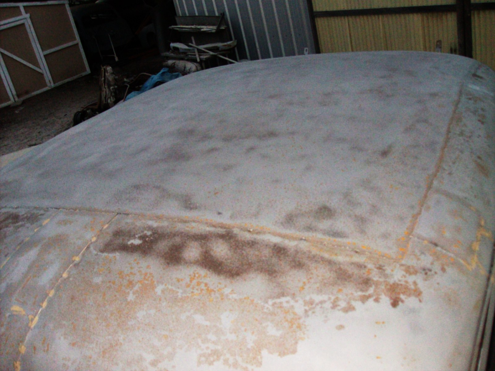

    ****** WARNING! WARNING! WARNING******
    **I Can Not BE Held Responsible For Uncontrollable laughter, and/or Tears**
    I've been crying for 3 hours already

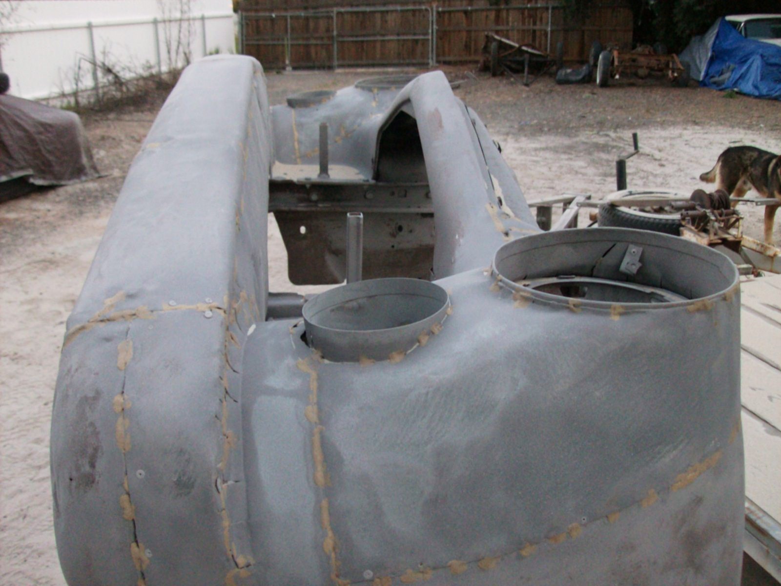

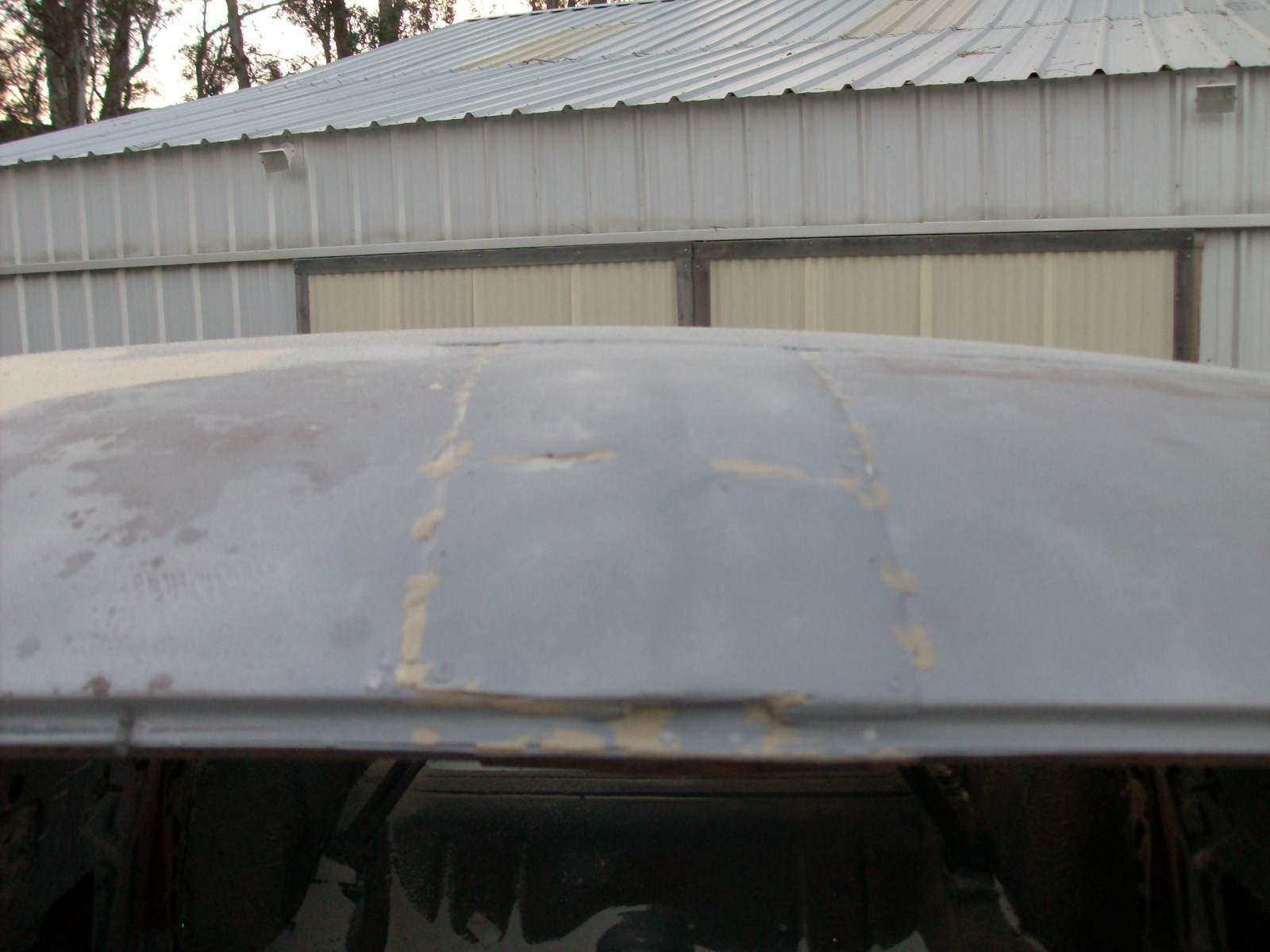

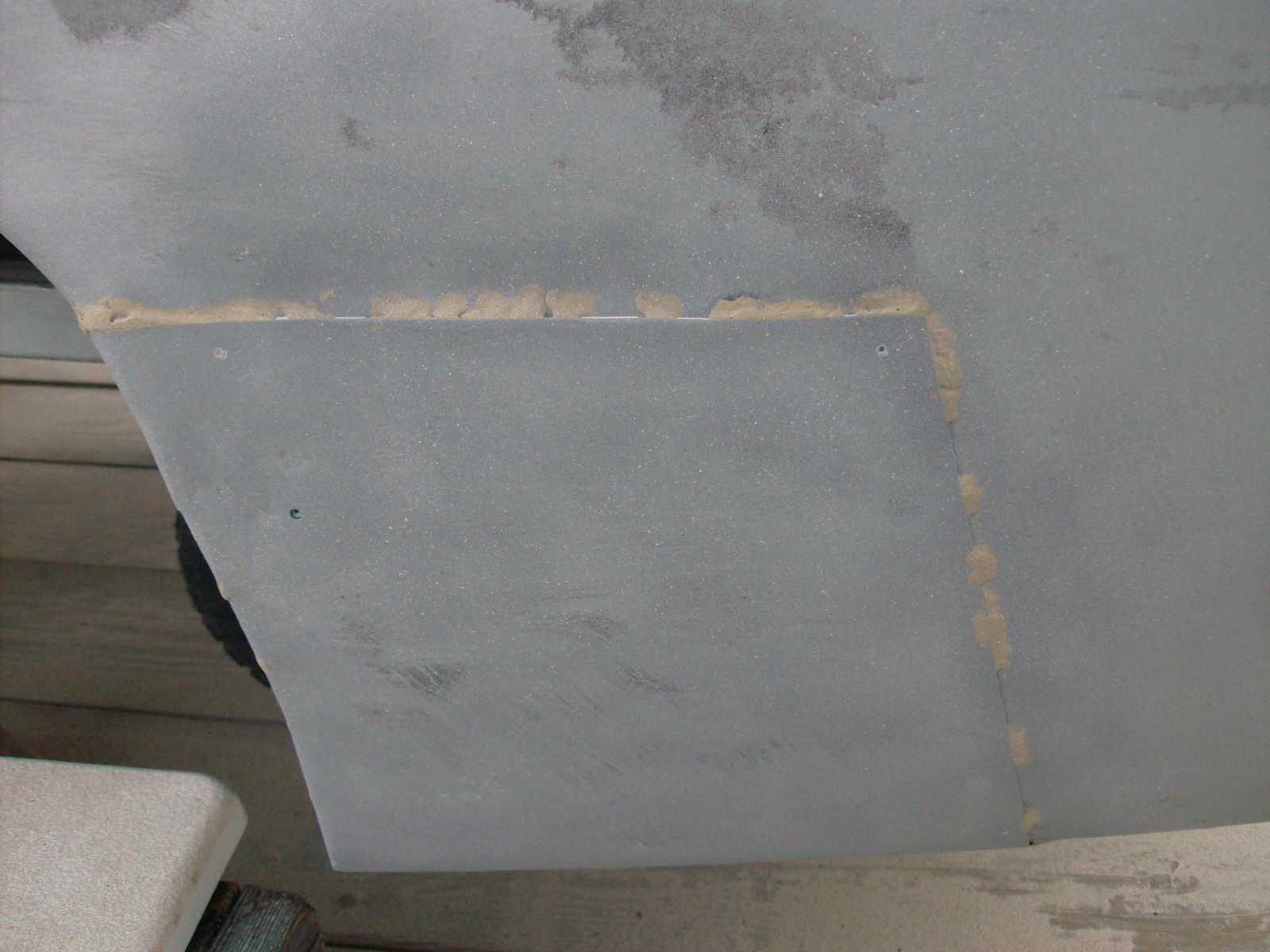

    Day 2.. When your sand blaster says he needs 2 days to finish the car. It's never a good thing...
    Quote of the Day: Rick Erickson, EXK." The guy who built that car must have been a quilt maker"..

    its not that bad...

    at least there is a lot of metal there. you can always fix that.

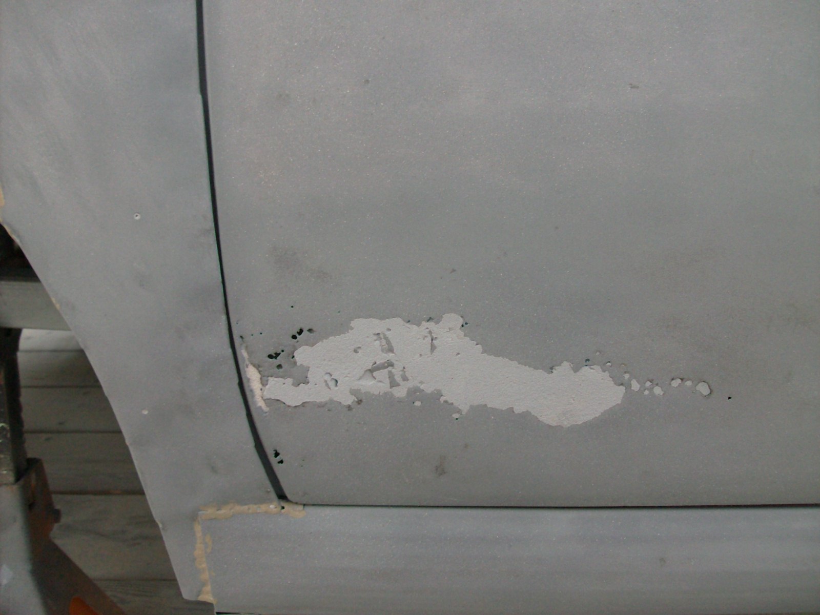

    isn't it amazing what a few gallons of bondo can do?....truth be told, on many decent looking cars....if they went thru the sandblaster or the dip tank....oh ****!:eek: This is where a magnet can tell you volumes......

    rick probably has a top or two laying around, pop the roof off have him fit a new one to it, too your liking, either keep the doors the same or change those as well..im always amazed when i find brazzed tack welds.. i guess they use to call that done.
