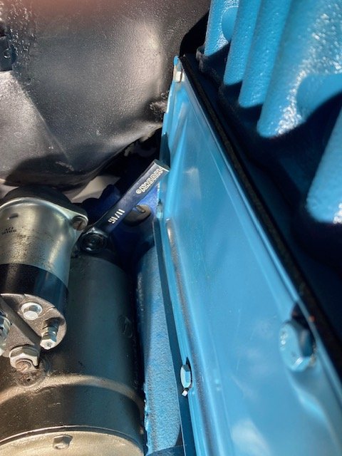

    Had to cut a wrench so I could tighten the upper starter nut. I am glad I put studs
    on the starter holes these starters are heavy.

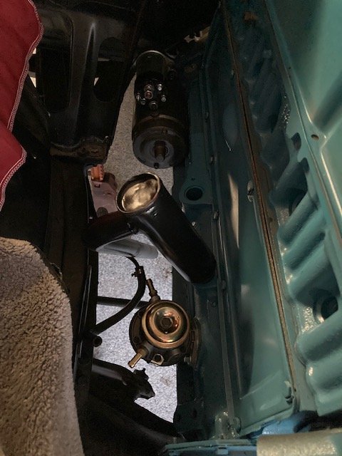

    Fuel pump and beather are on ,
    Squablow, Okie Pete, 6inarow and 2 others like this.

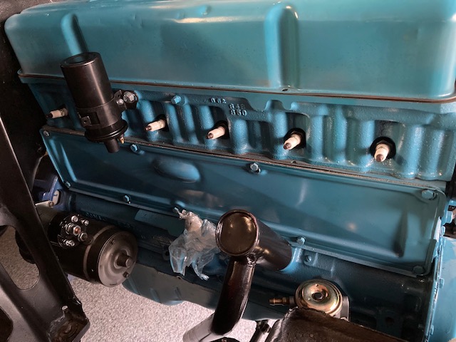

    Plugs are in, coil is on. Going to order a oil pressure switch ,and if i cant get the screw off the points maybe a new distributor

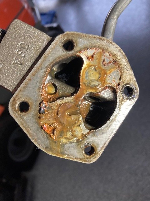

    Sad sad day ,put oil in the engine , getting ready to prime it and i cant get the oil pump shaft to turn. Thought my battery was weak on the drill so i put a screw driver and it did not want to turn. The engine was rebuild about 7 years ago was still in the metal crate we I got it. Going to take the engine out again and see what happen...

    Rust inside the pump.
    Im sure glad I tried priming the engine, cant imagine the damage it would have caused

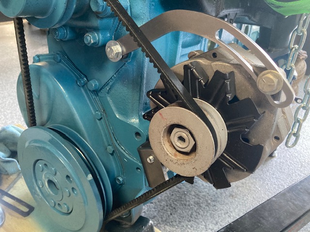

    Maybe move the alternator to the other side of the swing adjuster bracket.
    SS327 likes this.
  24. BoxOfParts
    Joined: Jan 27, 2024
    Posts: 61
    BoxOfParts
    I hope like this?

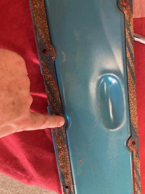

    The side cover was installed wrong, So I am thinking about getting a fancy chrome one lol
