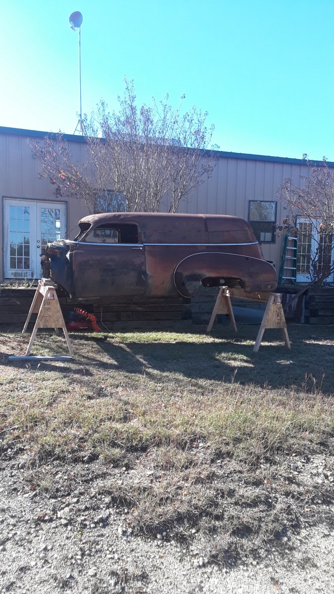

    I don't understand your question. If your asking about the Sedan Delivery body it is waiting in the wings to be sliced and diced and a good portion of it grafted onto the 4 door floorplan. 20181104_100224.jpg
  17. 'Mo
    Joined: Sep 26, 2007
    Posts: 7,432
    'Mo
    Better slice and dice again. That thing has a definite uphill rise at the back junction. :eek:
    49ratfink likes this.
  18. RMONTY
    Joined: Jan 7, 2016
    Posts: 2,640
    RMONTY
    Yes I've been studying that for damn near three years now. That's why I have enough 49-52 roofs to cover all of N. Texas. I'll make it work. You can come help if you want to. It will be fun! :cool:

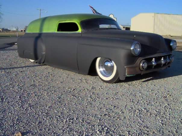

    My chopped 53
